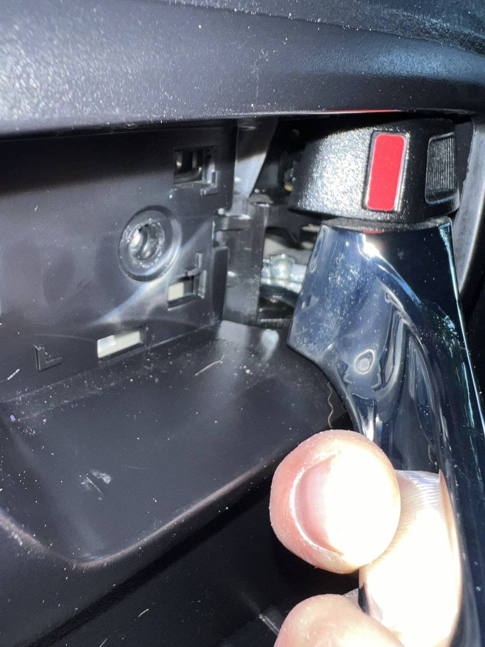

    The ball is in the hole…
    My guess.. it came out of the clips like Brandon suggested.
    Still stumped on fix at this point.
  8. May 17, 2022 at 6:46 PM
    Miles009
    Miles009 [OP] Well-Known Member
    Jan 5, 2021
    #351779
    138
    Miles
    2019 TRD sport
    OME 887 w/ AAL
    OK… After I made that last post about the ball being in the hole. I tried the handle and It opened the door. Going to take the panel off and see what Fuckery is going on. Thank you everyone for your prompt responses. I appreciate this community and all it has to offer

    The door cable will initially click into place. But it is not fully seated at this point. It must be pressed firmly until two clicks are heard. I think I limp wristed it into place. As for why the door randomly opened I have no idea. Luck
