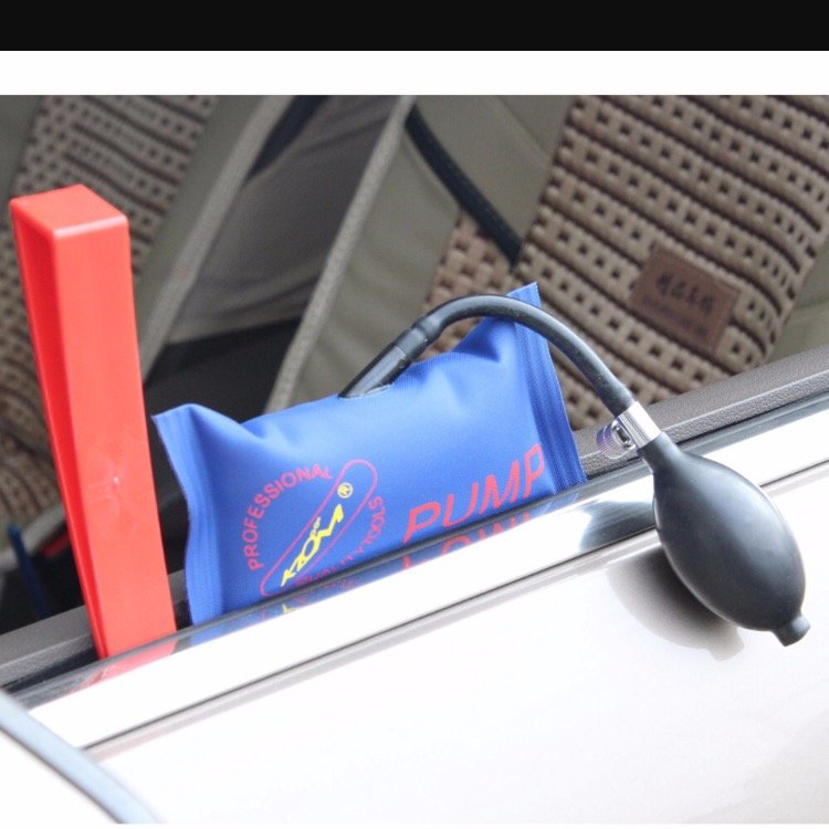

    Me, being the genius that I am, replaced a rear door speaker and when re-installing the door panel the lock cable came loose, wasn't installed properly. So........door is closed and I can't open it. Obviously can't remove door panel when door is shut. If there is a wizard in the world that can solve this problem, my hopes is that they are here! Otherwise I will just have a few beers and saw hole in the door!! I would love any help you may have.

    That did not work. Now I'm obsessed with this problem.

    Put the window down and use a wedge to spread the door open like so: Then use a flash light and see if you can see the cable. IMG_2993.PNG.jpg
