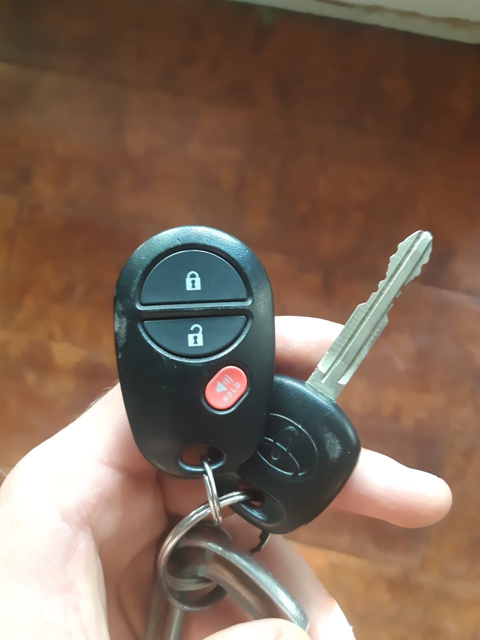

    Most likely your truck has an aftermarket or dealer installed keyless entry or alarm.
    Passive locking is when a keyless entry/car alarm automatically locks the doors approximately 30-60 seconds after the truck has been parked and the dome light has turned off. It is a programmable feature.
    Auto locking is when a keyless entry/car alarm locks the doors after the ignition key is turned on and it usually occurs 5-30 seconds after the key is turned to on and the doors are shut. It is a programmable feature.
    A picture of the remote control is worth a thousand words.

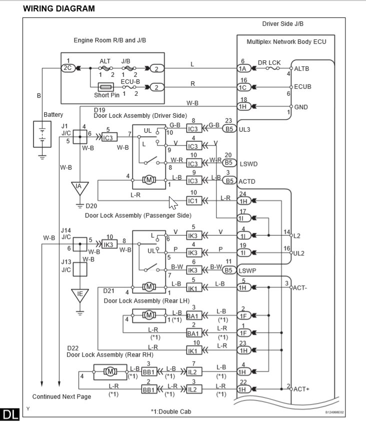

    What the service manual says about automatic locking doors.
    Automatic lock function:
    If no doors are opened within 30 seconds of being unlocked by wireless door lock remote control, all doors lock again automatically.
    Repeat function:
    If a door is not locked in response to locking operation of transmitter, multiplex network body ECU outputs lock signal after 1 second.
    ( My Note Here: Each door lock assembly has a switch that signals that the door is locked or unlocked. If the motor is actuated and the switch doesn't indicate properly the commanded position it will repeat the command.)
    Steve_P and Thgr8alex like this.

    That's the same one my truck has. I went through my old comments to find the model number but couldn't find the post I wrote that had the model. Give me a couple hours (shower, get dressed, etc) and I'll pull mine to get the model number and programming instructions for you.
    It is definitely not the remotes battery.
    Most alarms are programmed using a programming switch, the ignition key, and the dome light switch in the door jam.
    It usually is a new occurrence after the vehicles battery has been disconnected.
    Thgr8alex[QUOTED] likes this.

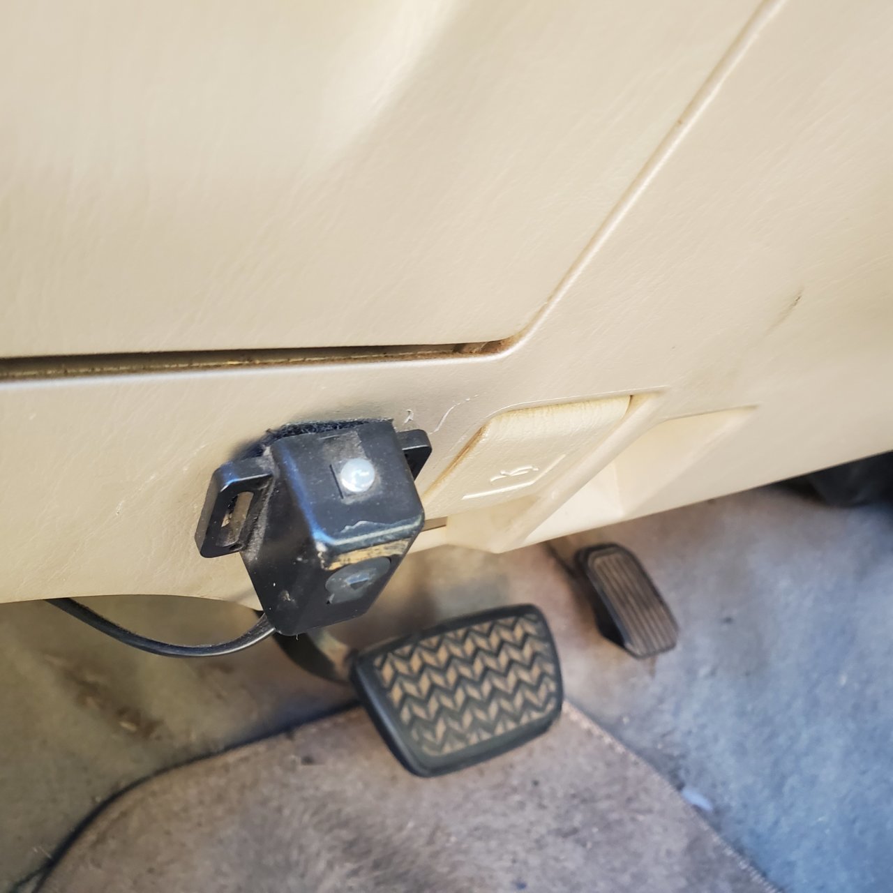

    The alarm owners manual in pdf form:
    http://mikehmayer.com/stuff/xB/KARR 4040a.pdf
    If the alarm is locking the doors and chirping the horn after the vehicle has been turned off it is called passive arming and it can be programmed to not do it. Refer to the owners manual.
    If the alarm is locking the doors when the truck is started its called key on locking I believe, either way it's also in the owners manual.

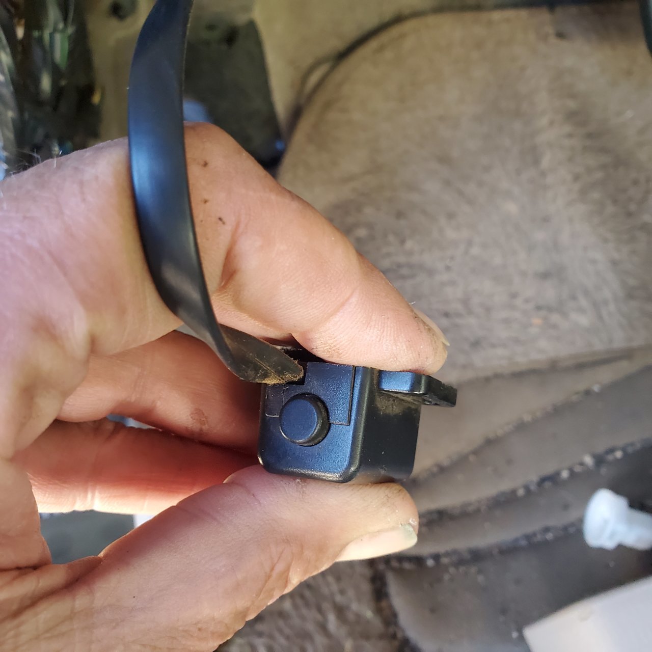

    The programming switch on my truck is on the back of the housing that houses the blue LED.
    If your truck has a red LED the switch can either be separate or the LED itself can be a dual function piece. To determine if your trucks red LED is a programming switch lightly push on the LED, if it is spring loaded it is a dual function LED, if it does not move by lightly pushing on it then the alarm has a separate programming switch.
    These are on the cheaper side of car alarms. In the past 6 months mine has passively armed twice even though it is not programmed to do it. If your alarm is a lot more intermittent I would look for Scotch locks in the installation and remove and replace them all with T taps or butt connectors.
    Programming the remote will have no affect on the locks, the alarm must be programmed and not the remote being programmed.
    Thgr8alex likes this.
