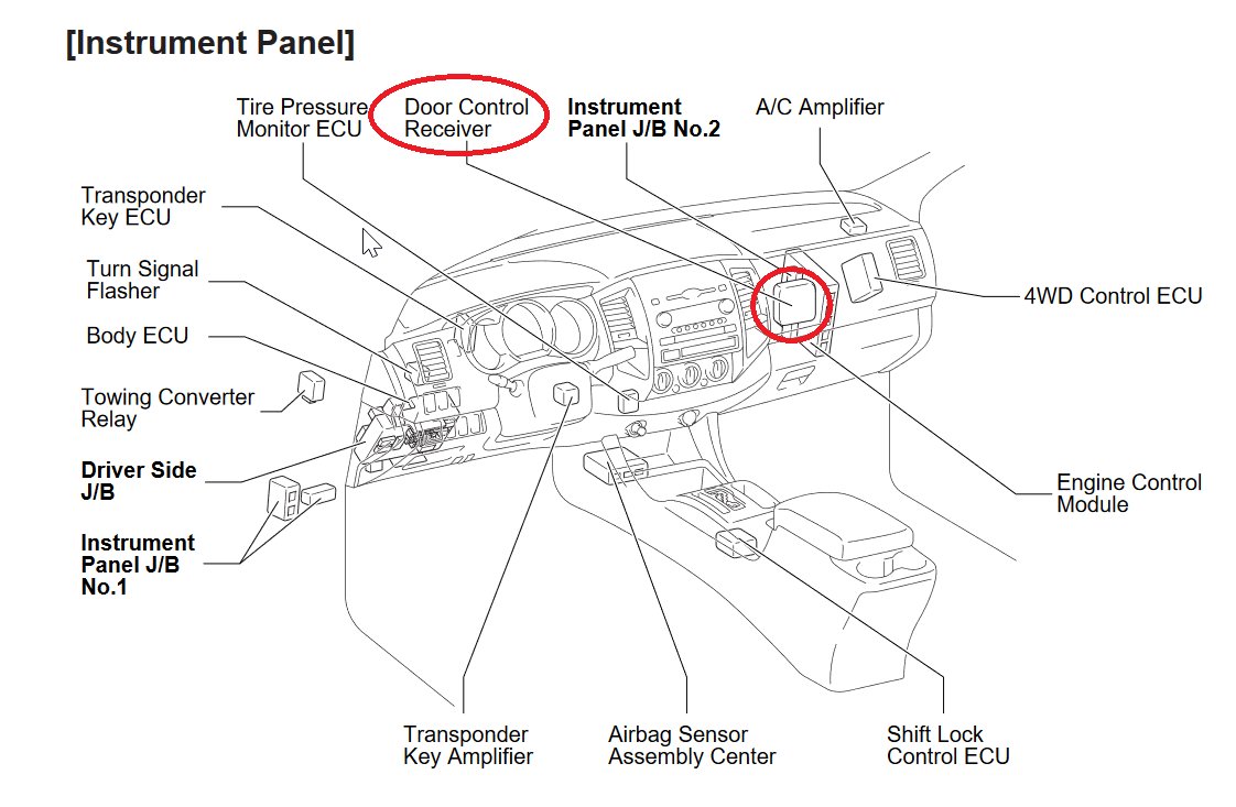

    where would i find the keyless entry module?

    There isn't 1 set spot for it. Most of the time it's in the driver's kick panel on a second gen. It can also be under the dash on the driver's side. It's about 4"x4"x1".

    It is easy to get too. Pop out the glove box and it should be easy to find from there.

    oh okay good to know, was thinking it was remove the dash type of thing. thanks

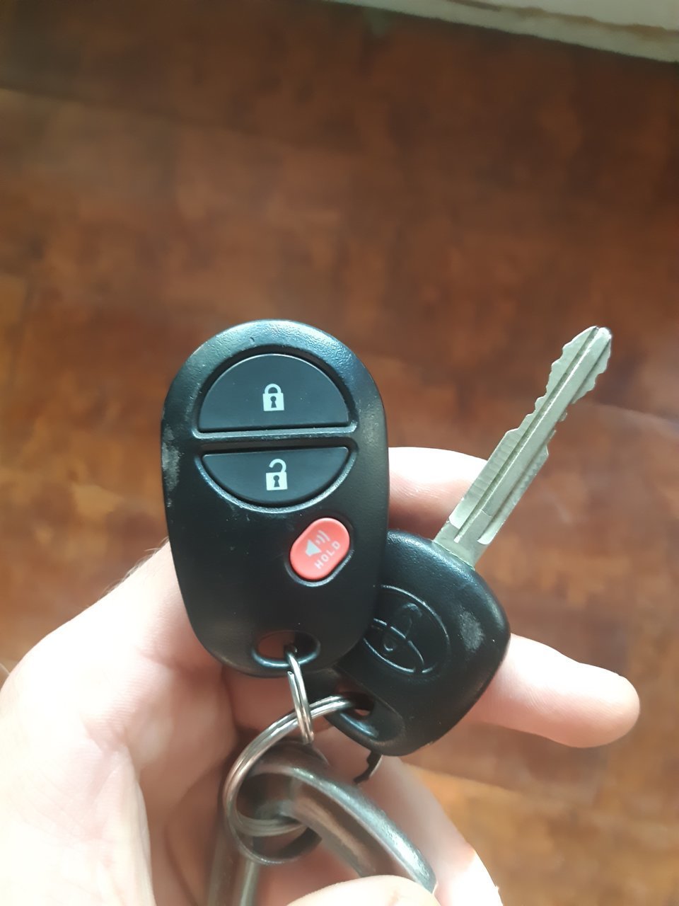

    Are you sure your keyless entry is factory installed?

    i believe so. i dont think its called keyless entry though, isnt keyless entry when you only meed the key in your pocket and you can open the door and it unlocks when it touches your hand? my old vw gti did that. trucks an 06 trd offroad, which i believe came with the fob

    Keyless entry is where a button is pushed on a wireless remote control to unlock the doors. Many aftermarket alarms can be wired up as a keyless entry without the alarm functions being hooked up. There are aIso aftermarket keyless entry (only) systems available. If you post a picture of the remote control I can tell you what you have.

    not my pic, but same as this one from earlier in thread
