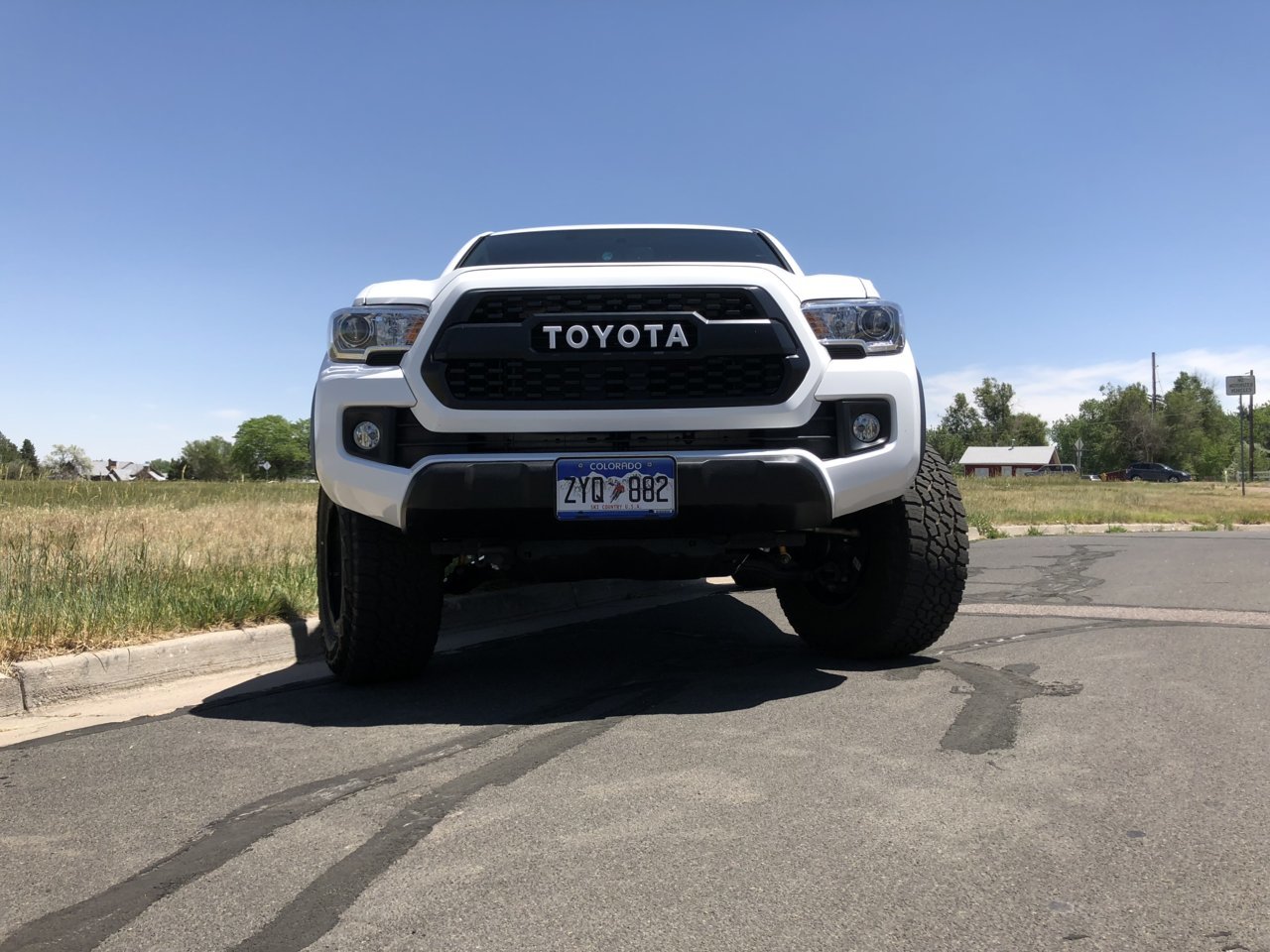

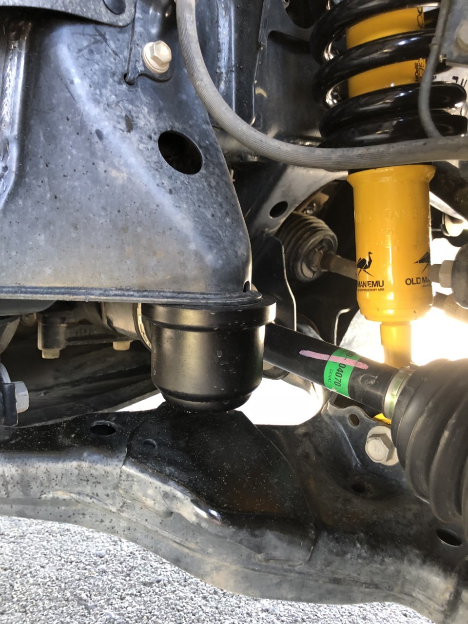

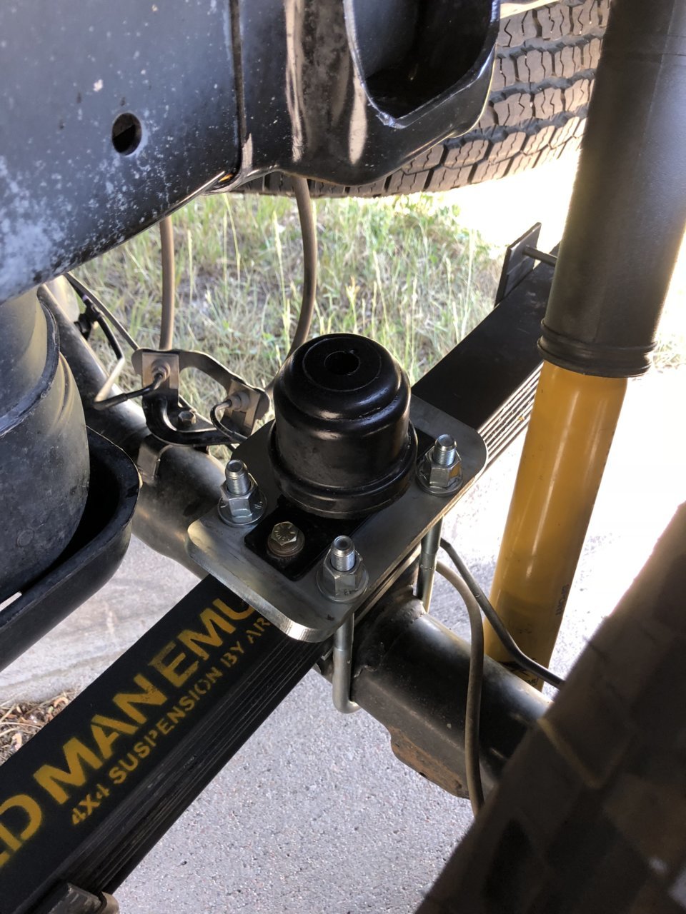

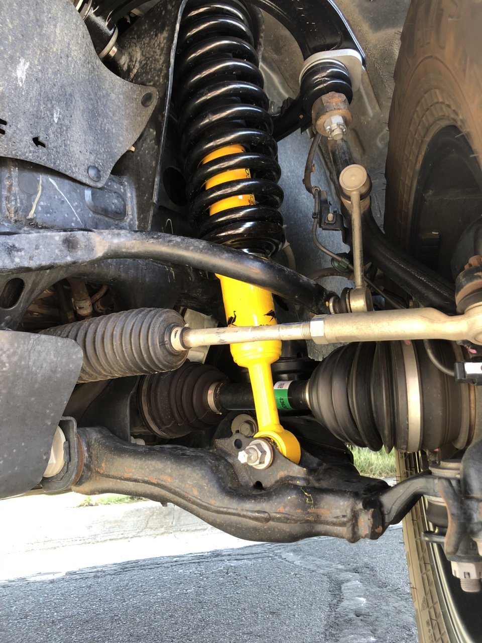

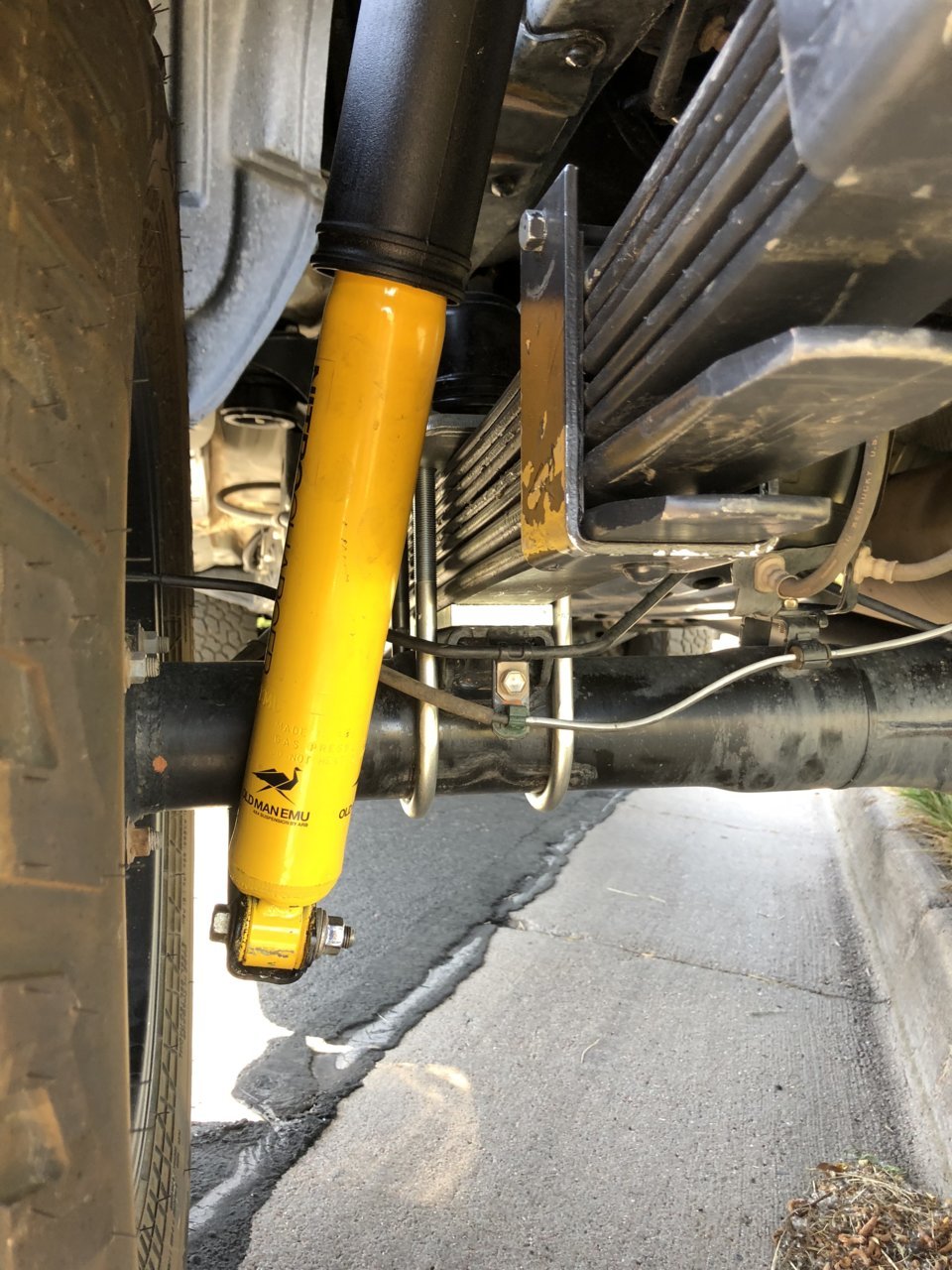

    Got my lift installed about two weeks ago. Ordered the kit from Marie at @HeadStrong Off-Road pre assembled and it shipped quick. Everything was at my door in less than a week. I installed it in a day with a friend in his garage and overall the whole process went extremely smooth. I have spent the last week fine tuning things and will probably continue to do so for the next month or two. I did the 90021 struts and 887 coils with Wheelers Offroad SuperBumps in the front. I also did SPC UCAs to help with alignment and wheel travel. In the rear I did the EL096r leaf pack and I did end up adding an extra EL46XL to the pack. With the weight of my cap, rack and drawers the leafs flattened out pretty quick and I have sliders on the way. I spoke with TR from ARB this weekend at the Toytec meet and he recommended adding the EL46XL leaf after seeing my pack. He also gave it to me for free :thumbsup: In the rear I also added a 3 degree shim to correct drive line angles and have the Wheelers U-Bolt Flip and SuperBumps installed to boot!
    Currently I do have about 2 1/2 inches of rake from front to back. I am going to let everything settle over the next 1000 miles and readjust then. I think I will like add a 1/4 spacer on the top of the strut to get another 1/2 of lift in the front and bring the rake down a bit and do another alignment along with the ECGS bushing at that time. Additionally I think the rear is still a little high because I only put the extra leaf in yesterday and have only put 20 miles on the truck since.

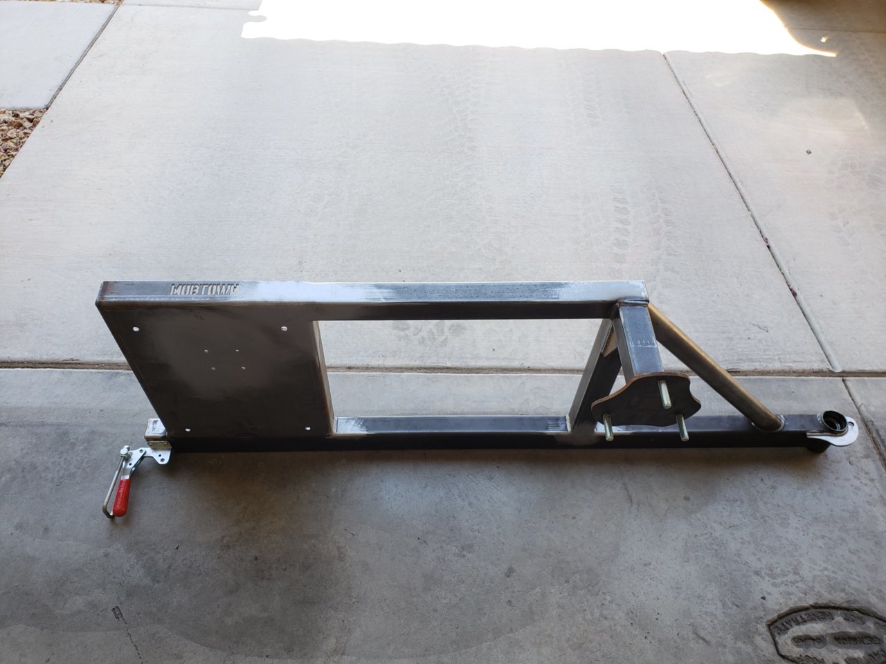

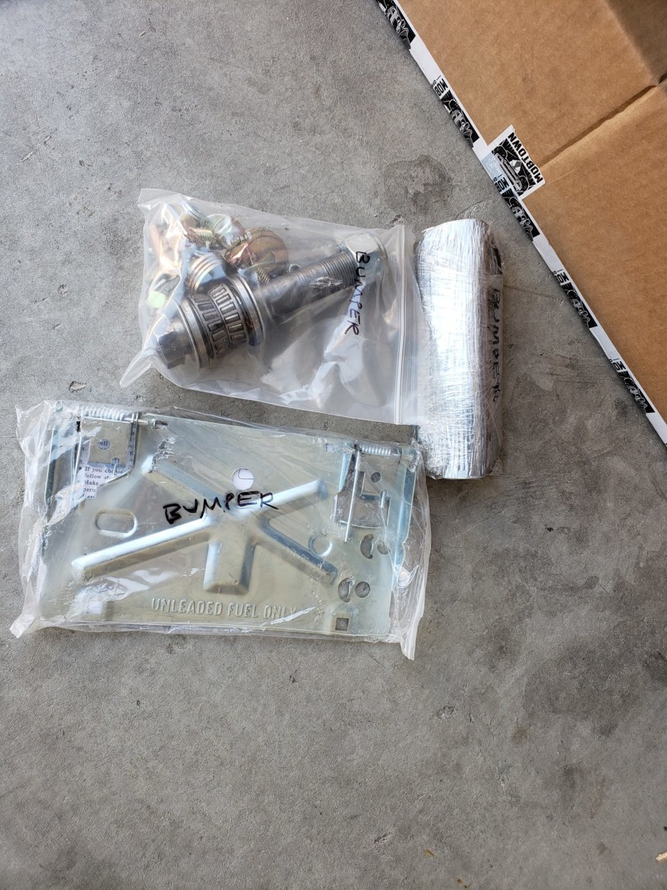

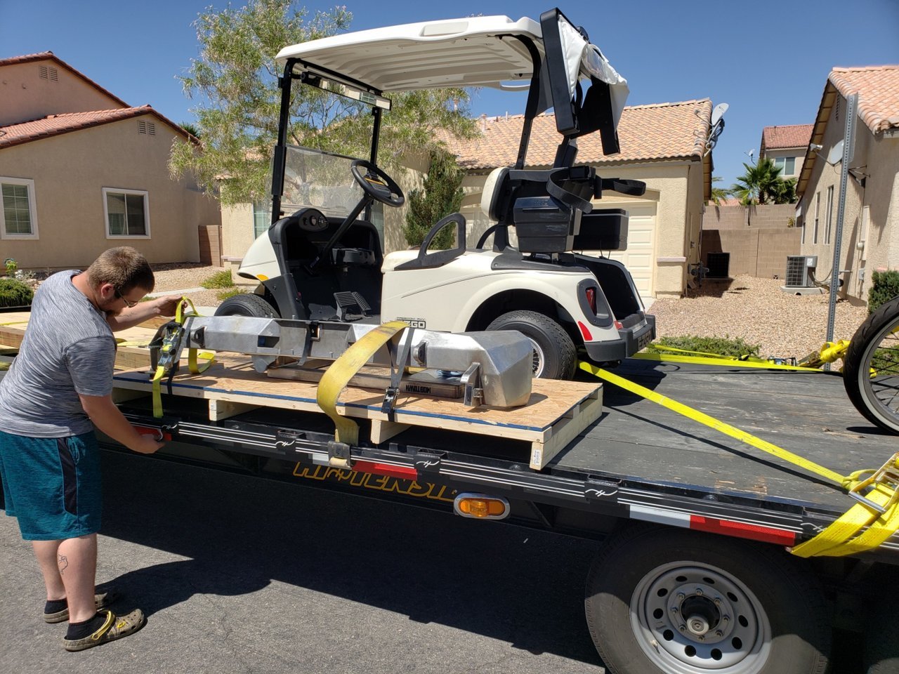

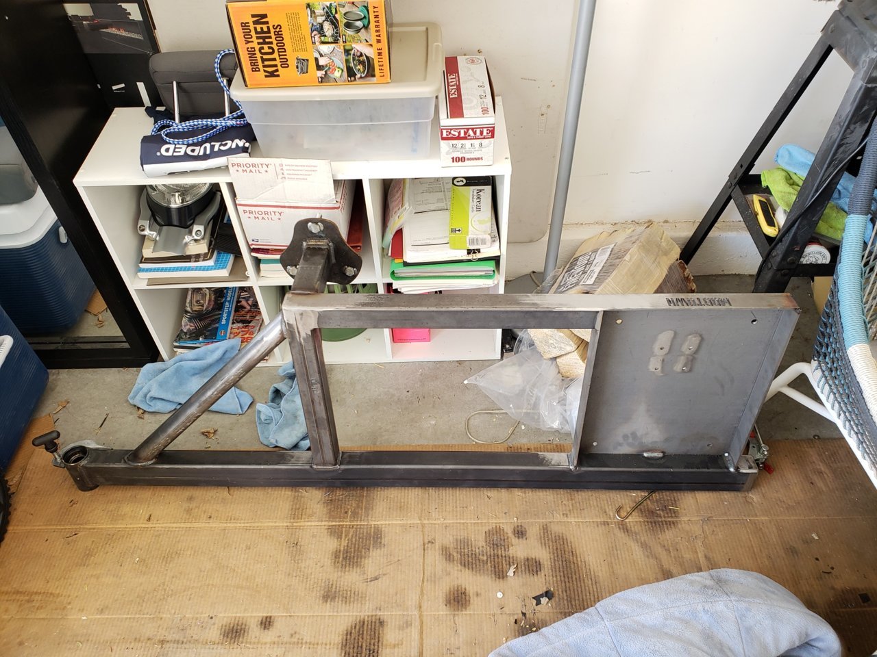

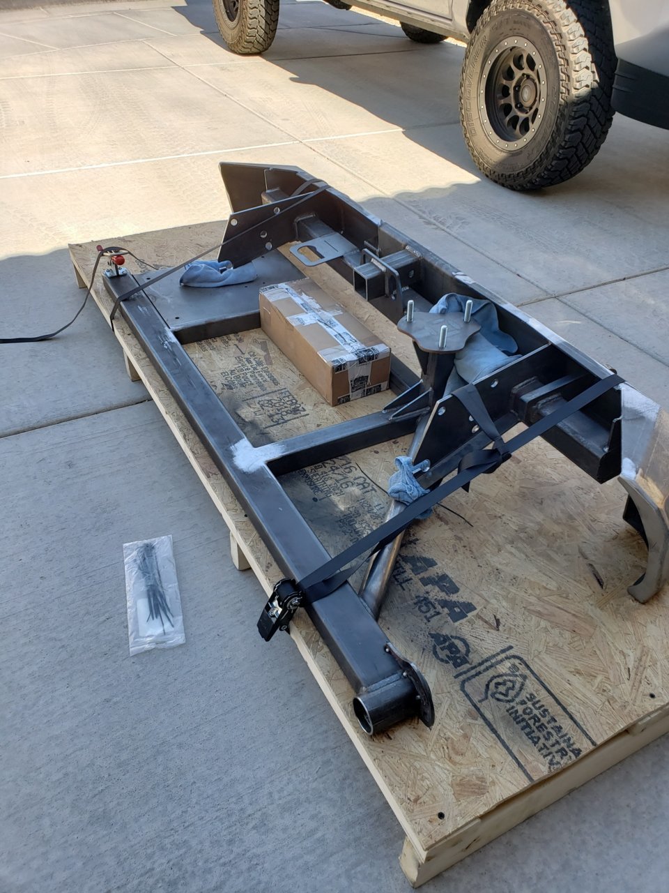

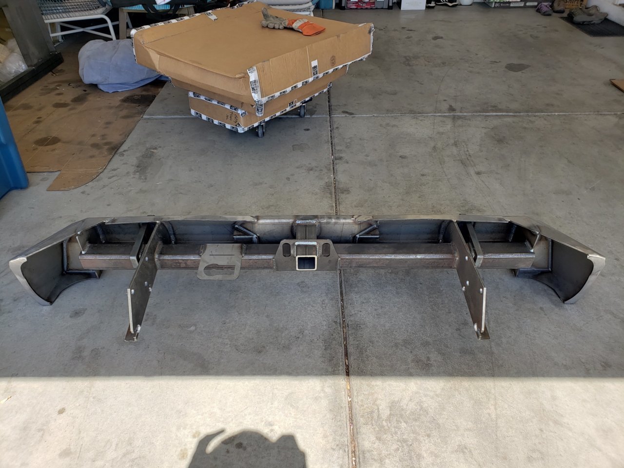

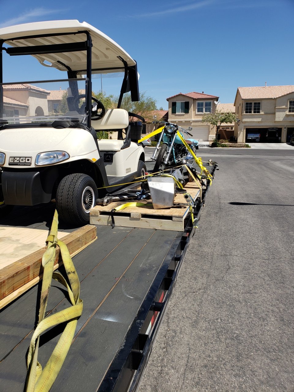

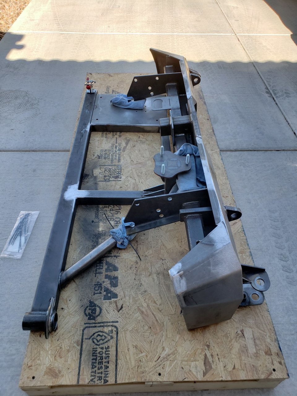

    First off, huge shoutout to @jeffkimkp for working with me, shipping a bumper like this is not easy! I bought this brand new Mobtown Bumper off of Jeff after he had a change of heart on his build and I could not be happier. I am psyched to get it in! Here are a few photos he sent me, should be here Thursday or Friday!

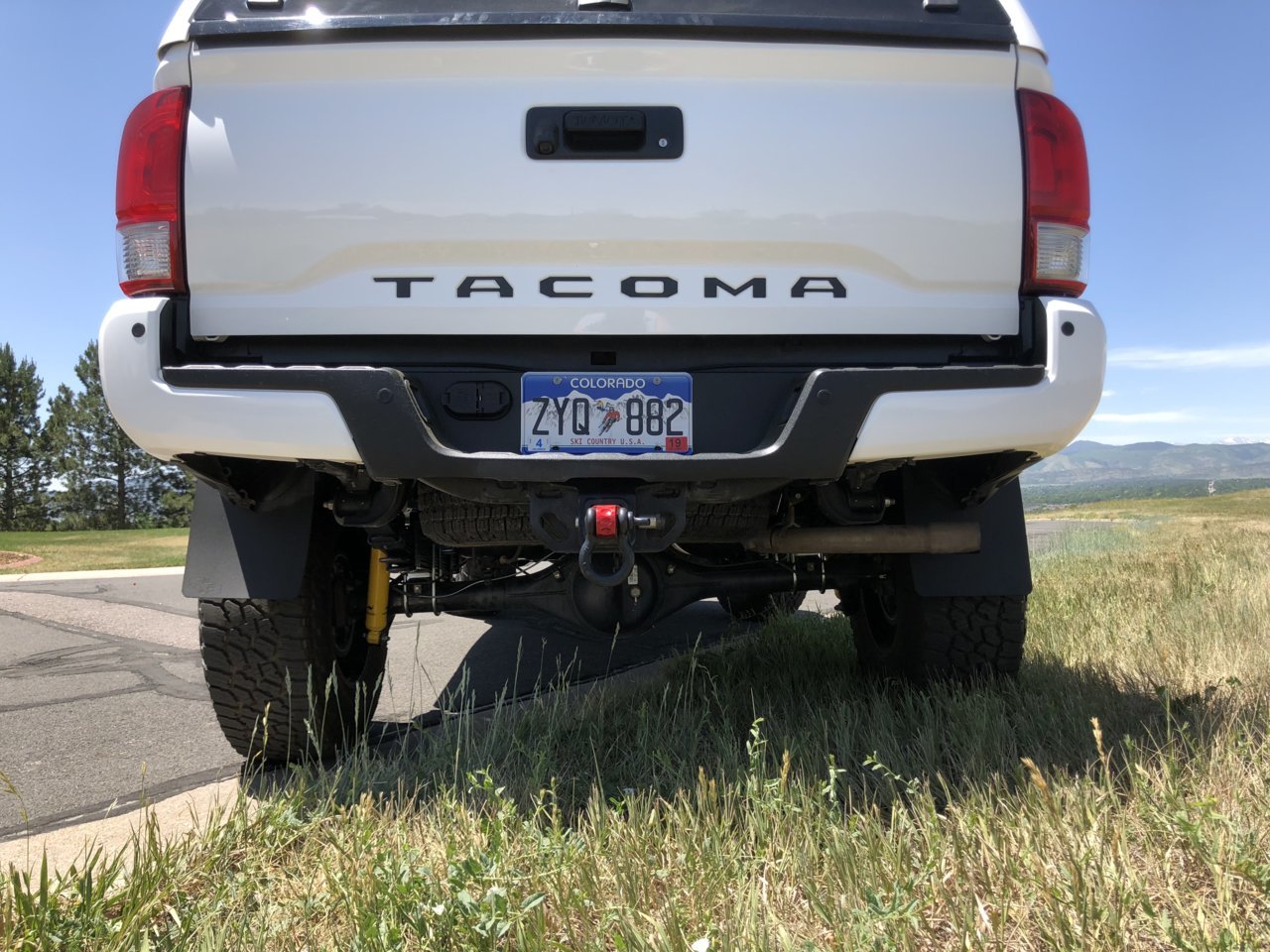

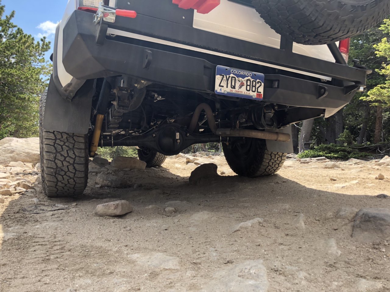

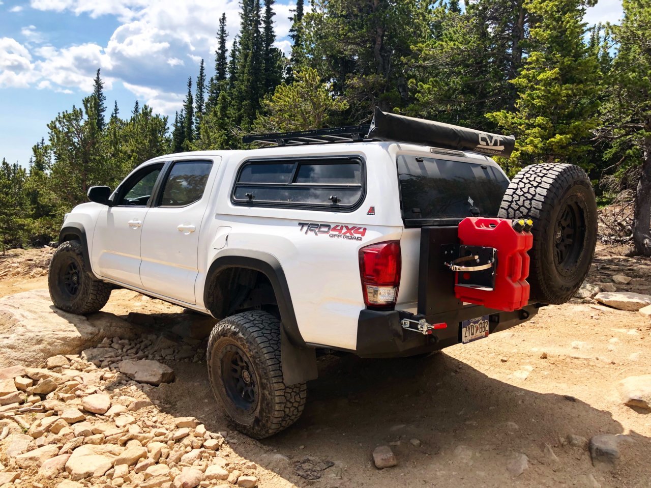

    Update 7/13/18:
    Filling in some of the stuff I have skipped over recently as work has been stupid busy
    DIY Drawer system is done! It took a long time but I am super psyched with the results. I'll put some pics in below but please check out the very detailed build thread here:
    https://www.tacomaworld.com/threads/doozy4212s-better-truck-drawer-build-guide.534258/
    AND the pics of my lift!
    • Old Man Emu NitroCharger Kit
      • 887 Coils Paired w/ 90021 Struts
      • SPC UCAs
      • EL096r Dakars w/ 1 additional EL46 Leaf
    • Wheelers Superbumps
    Mobtown Rear Bumper with Swingarm
    Pelfreybilt Fuse Panel is in and functional but I still need to hook my electronics up to it. I still have a lot of little stuff to do here and there but I'm enjoying the process!
