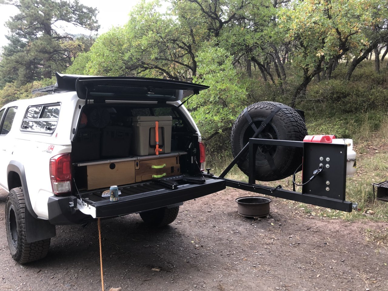

    Its low, like 22” by the time i have a sleeping pad and everything in there but I don’t often sleep in the back, i prefer my ground tent

    Thanks man, everytime i use it i comment on how it was the best $100 spent out of the thousands i have in the truck

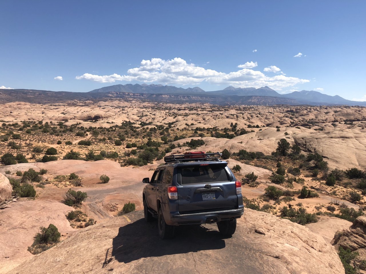

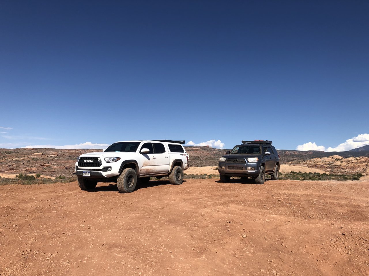

    Moab trip with the guys in the books! We took a lot of pictures. Here is just a teaser, much more to come!

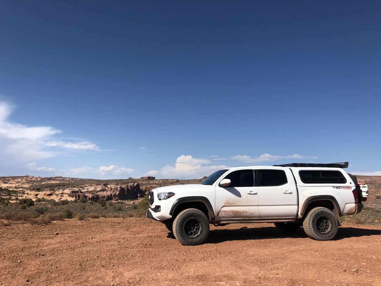

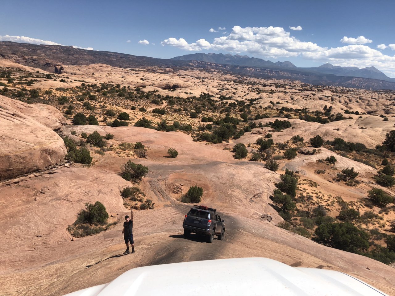

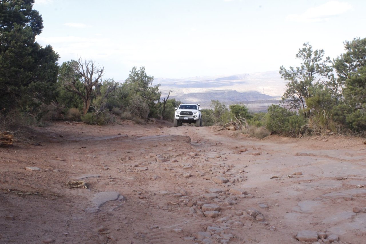

    Update: 10/1/2018 - Moab Trip Report (9/13 - 9/16)
    Moab, as always, was RAD! This trip was especially rad because it was a guys trip focused on driving some of the most notable trails in Utah. We tackled Onion Creek, Fins and Things, Hells Revenge, and Top of the World Trail.
    The group for this trip consisted of myself, my dog, and my two good friends/co-workers. We departed on Thursday around noon from Denver and drove straight to Onion Creek with only one stop in Rifle, CO for gas. Once we got to Onion Creek, we drove straight up the trail to the Onion Creek Hide-Out Campground, WHAT A GREAT CAMPSITE! This trip coincided with a new moon and holy moly were the stars incredible! I did have to take some time away from my stargazing to install my new RCI sliders at camp that night as they were not delivered to me in the time i was promised. Honestly it worked out for the best as I picked them up before powder coat and a good thing because these guys took a beating on this trip!
    We did not get many pictures on Onion Creek as we were trying to get to camp before dark but here's what I have.
    The next day (Friday) we went and did a quick hike at Corona Arch Trail in the morning and then made our way over to Fins and Things. This was my favorite trail of the the trip hands down. After getting over the initial pucker factor it was just fun! Lots of steep climbs and descents on the the slick rock and some steps and more technical obstacles on the backside of the trail!
    https://www.instagram.com/p/BnjA9lBhwf3/?taken-by=drewz_the_doozy

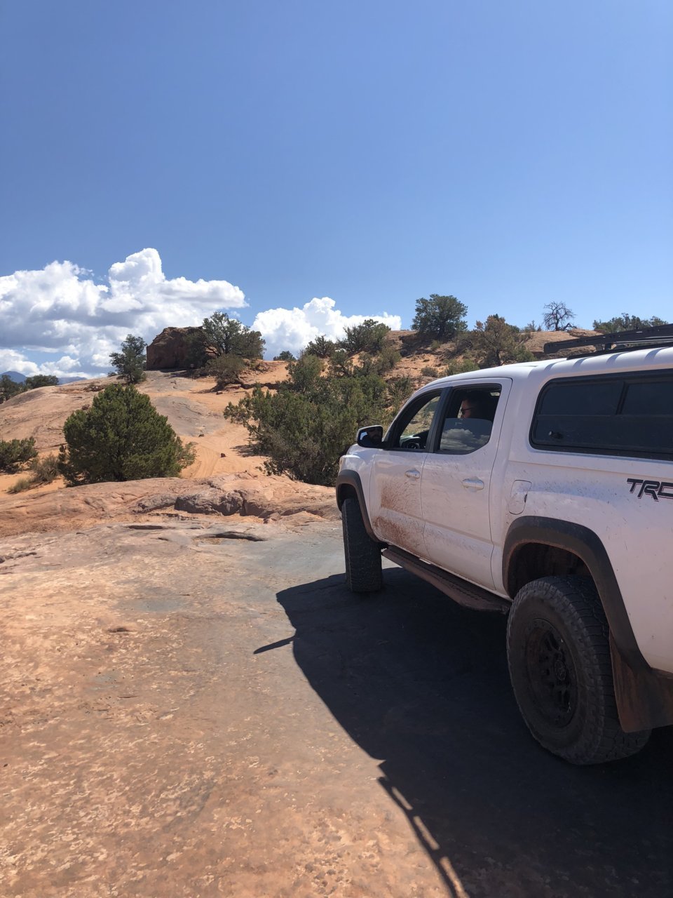

    Saturday was our big day! Hells Revenge in the morning and Top of the World in the afternoon!
    Hells Revenge was super fun, it was not super crowded which was nice and we were able to really enjoys all parts of the trails. The only portions of the trails that I did not run were Hells Gate and The Escalator. Hells Gate may happen one day but I'll never take or get this truck up The Escalator. All of the other obstacles were pretty easily doable. I even did one of the hot tubs but unfortunately did not make it out to my third attempt which was cut off in the video. Oh well.
    https://www.instagram.com/p/Bnq9Hu3jsy6/?taken-by=drewz_the_doozy
    The last trail of the trip was The Top of the World trail. This trail was a ghost town which was quite nice but the trail was hard on us especially considering the day we had already had. We got on the trail so late we ended up coming down in the dark. Regardless, it was totally worth it!
    Thanks for watching!

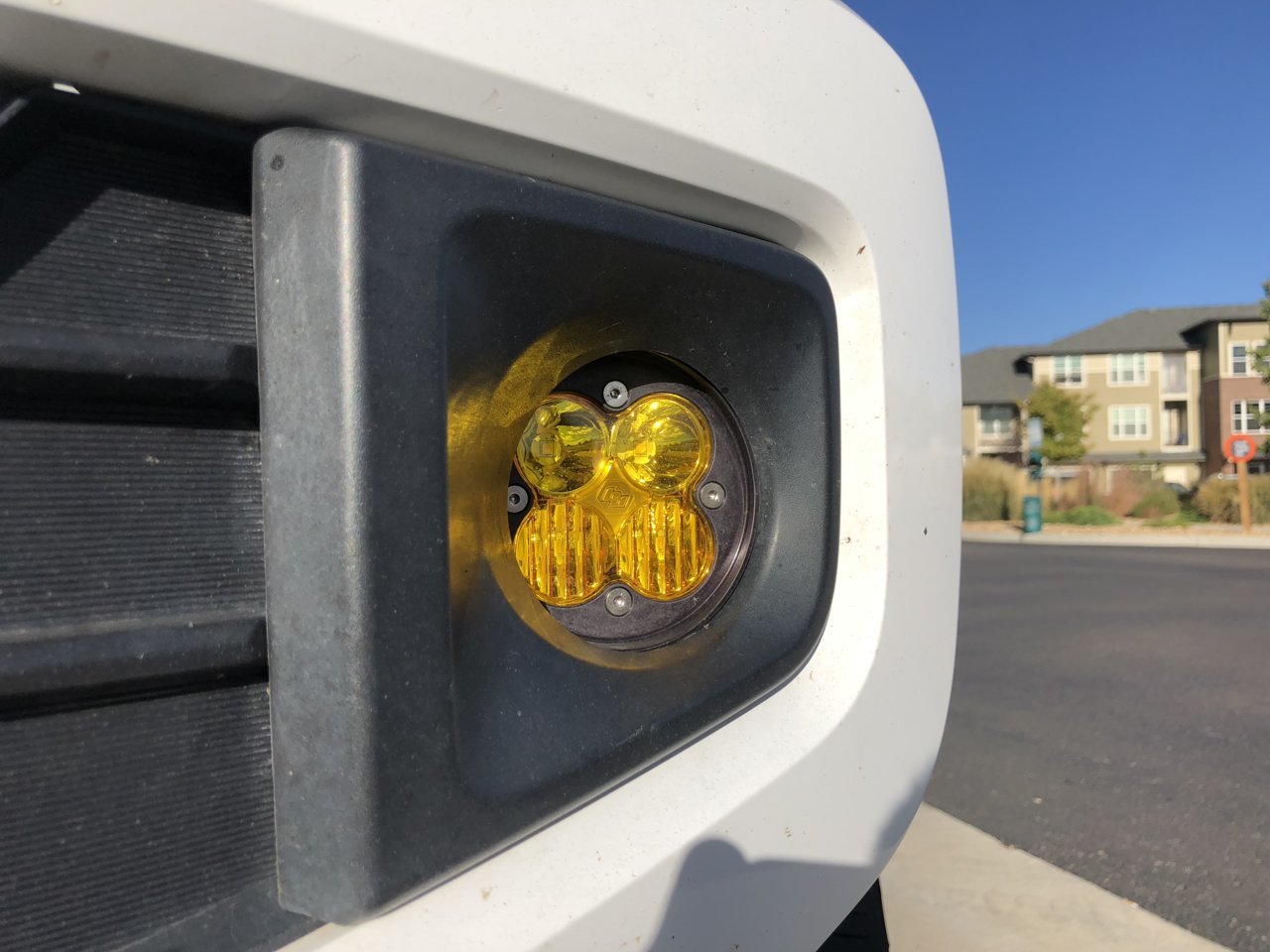

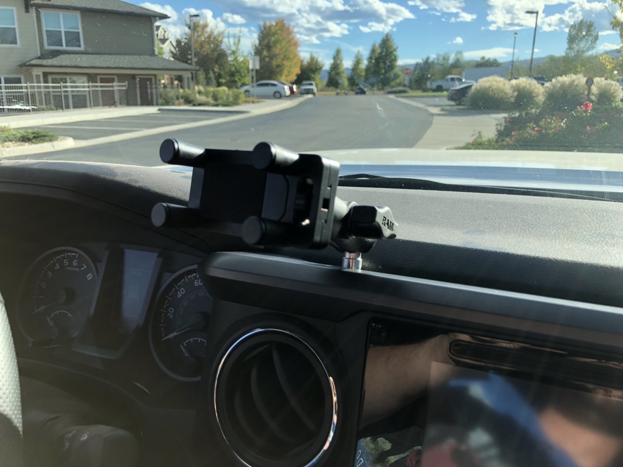

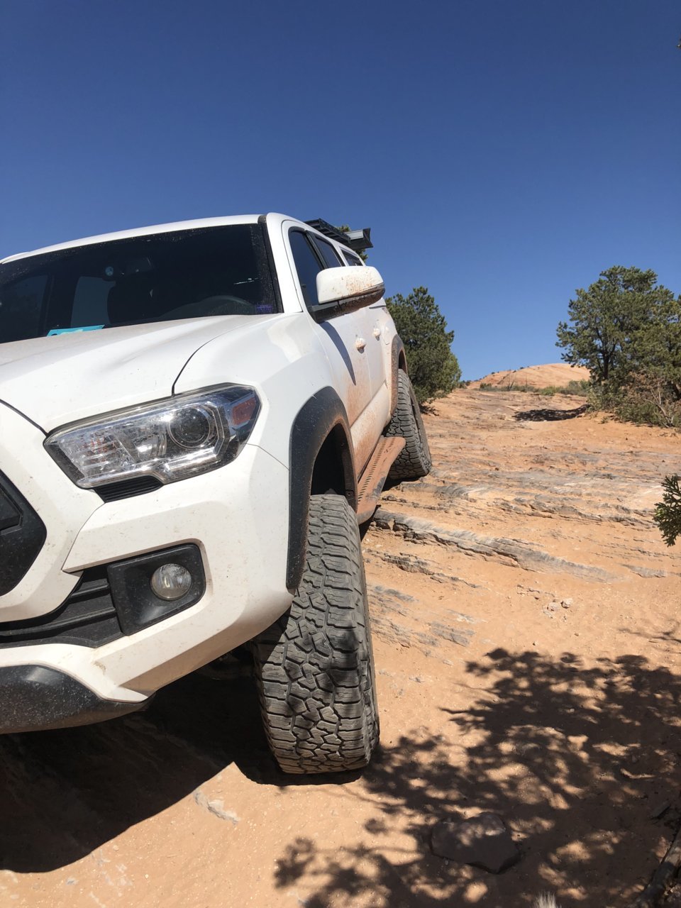

    Update 10/5/18:
    I haven't done a ton to the truck recently but I have a few pictures to show the build progress.

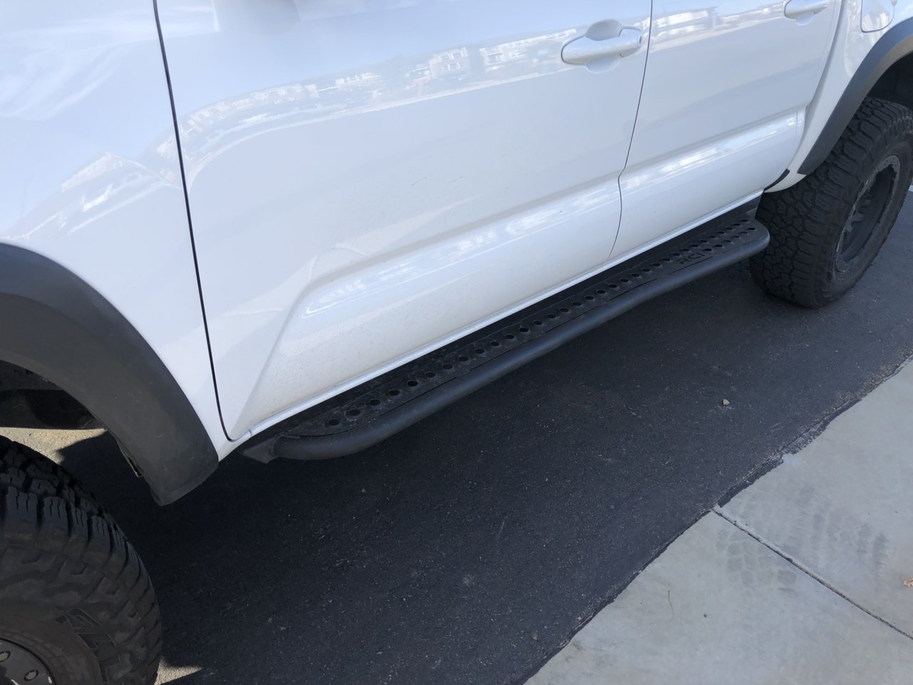

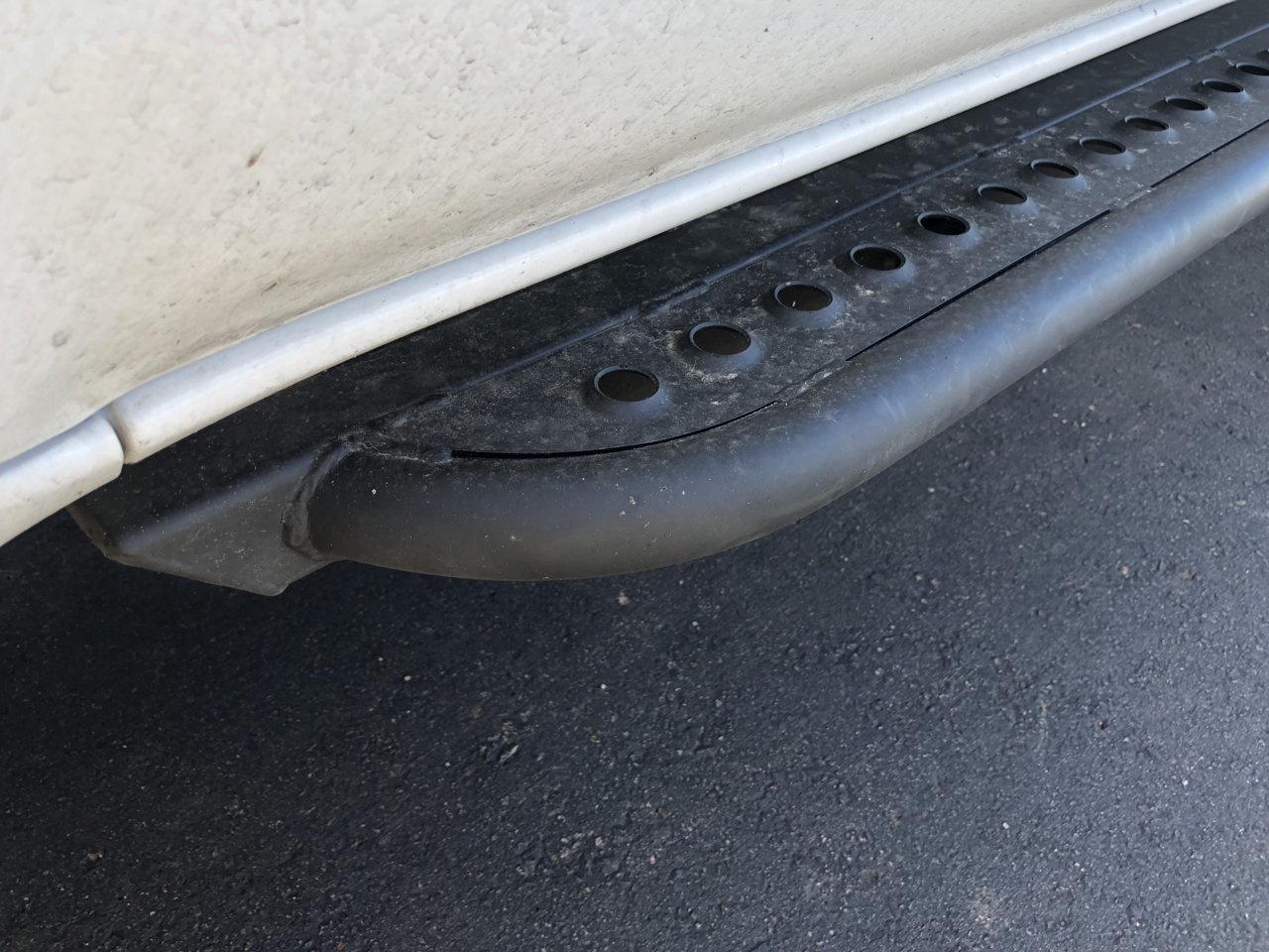

    First, I got the RCI sliders off of my truck after Moab and got them all cleaned up. I love these sliders and how they're overall shape compliments the truck. The legs of the sliders also tuck up super close to the pinch weld on the bottom side of the cab for maximum clearance. I bought the 5 degeree option with top plate so these can double as a step for my 5' 2" girlfriend. I power washed them and then hit them in spots with a wire wheel to take off some of the surface rust. Once clean I wiped them down with acetone and put down 4-5 coats of self etching primer. Once the primer was down I let it dry for 24 hours before putting down 5-6 coats of the Rustoleum Pro Enamel Flat Black Paint. Here are the results.

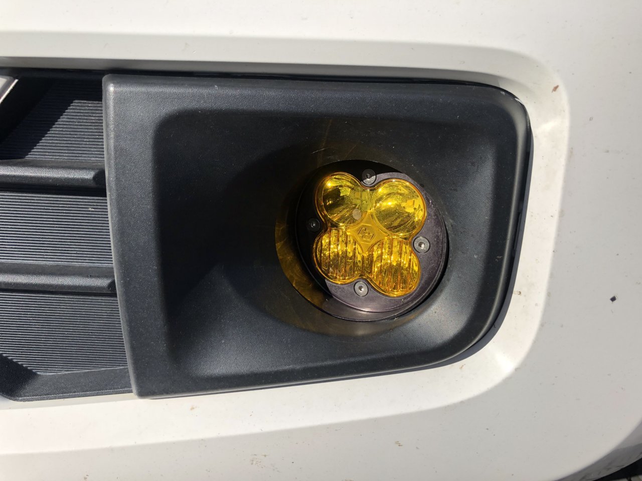

    Also, I finally pulled the trigger on the Baja Designs Amber Fog Kit. These things are stupid bright but they do not overpower my Xenon Depot HIDs nor have I been flashed yet. I'll try to get some output pictures up soon!

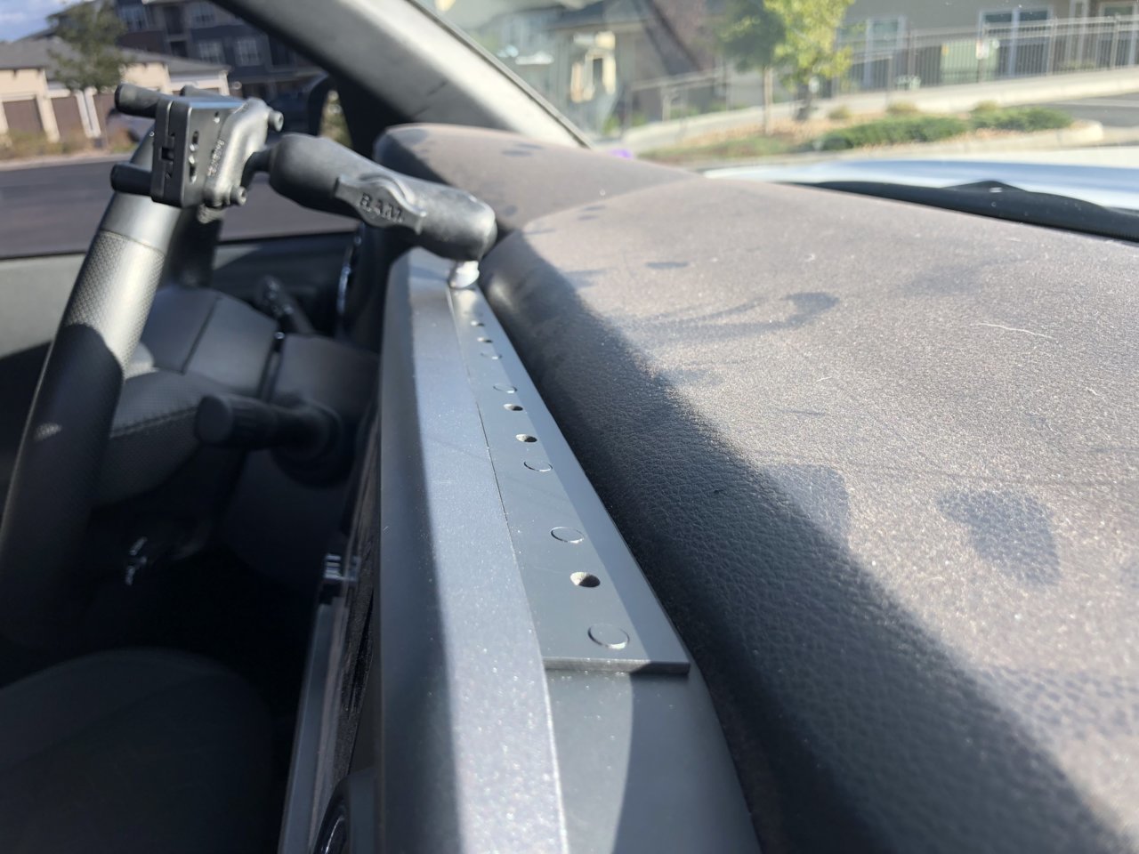

    Lastly, my favorite little mod that I have done is the DMM mount from The Taco Garage. This was a super quick and easy install. Paired with the DMM I also have the Perfect Squeeze phone mount and these two make for a super secure mount for my phone. I won't use it all the time but when I need GPS or I'm on a long drive this is where my phone will live. (PLEASE excuse my disgusting dash as I have not cleaned my truck since an impromptu trip to Moab last weekend, that damn moon dust gets everywhere)
