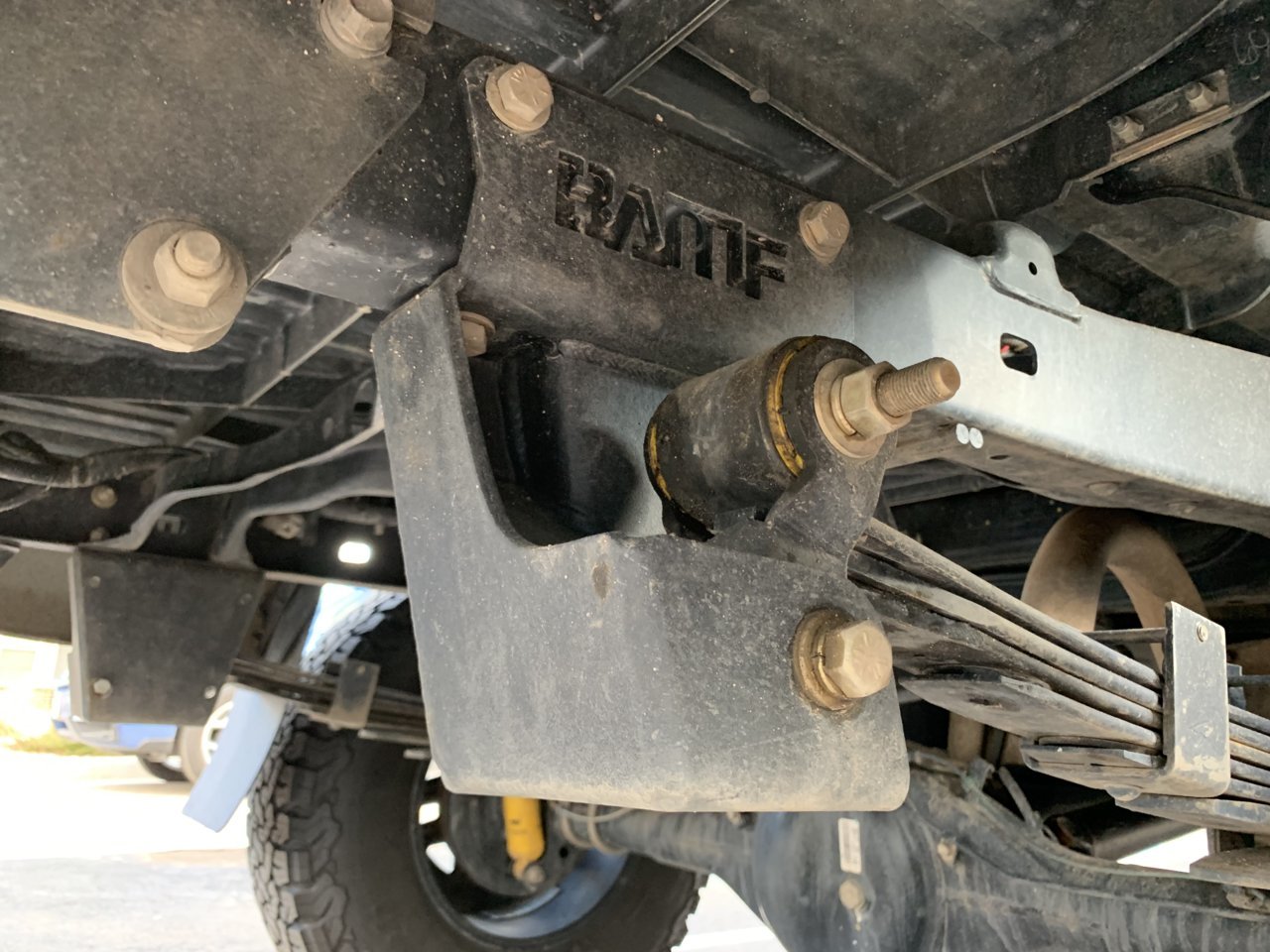

    All the things...click the link in sig
    Got the passenger side hanger on today and it went pretty smoothly. Drawers will probably start the weekend after next!
  9. Feb 17, 2019 at 7:15 PM
    #169
    literallynothing
    literallynothing I tow my new truck around with my old truck
    Aug 27, 2017
    #228243
    2,156
    Noah
    2017 DCSB
    Steel and 37s
    Nice! Were the rivets as much of a pain in the ass as everyone says?
  10. Feb 17, 2019 at 7:28 PM
    #170
    upTOPOverland_Drew
    upTOPOverland_Drew [OP] upTOP Overland Technical Design and Application
    May 22, 2016
    #187612
    2,708
    Drew
    Littleton, CO
    2017 TRD OR DCSB SUPER WHITE
    Honestly, no. The rivets were quite easy but accessing them is a different story. I took an angle grinder to the hanger and cut off the hanging portion so i could drill straight in. That was a bit of a pain in the ass and lining up the 4 1/2" bolts for each hanger was a bit of a struggle, the rearmost bolt on the bottom of the hanger specifically. Other than those two things and the freaking snow that fell both days I did this install, it was really pretty simple.
    Oh and I had to trim my dakar's which added a little time to the install.

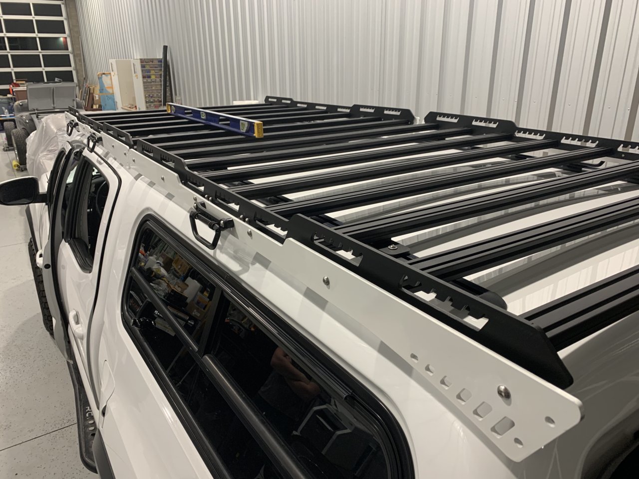

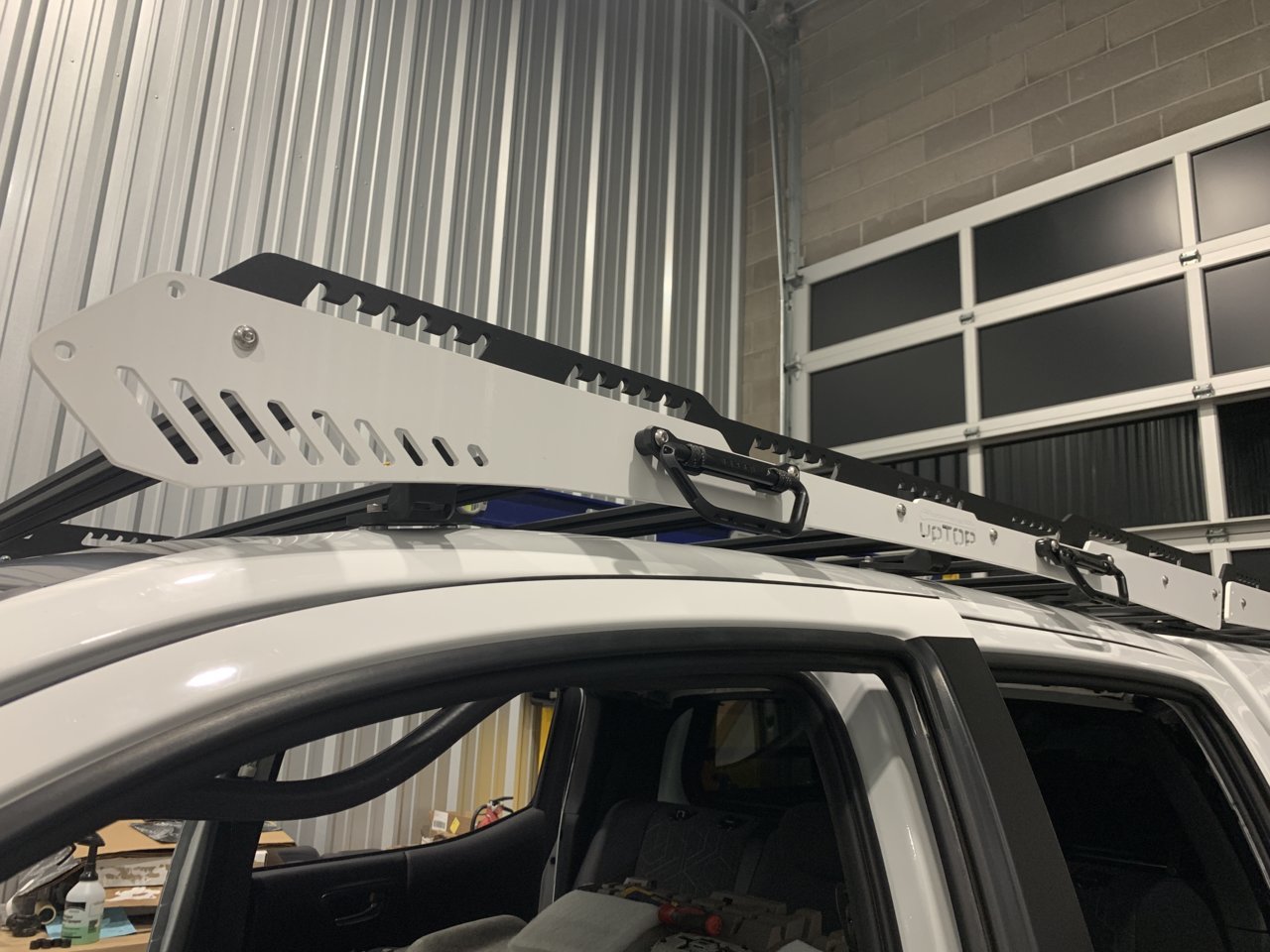

    UPDATE 3/1/2019:
    Lots of changes to the truck coming! I have been talking and spending a bunch of time with @upTOPoverland as he develops a new BADASS roof rack for the double cabs! He is also using my truck to develop a rack for toppers too to compliment the rack on the truck. I can't spill the beans yet, but you better prepare yourselves....
    With all of that being said, I have gone hog wild on a quest to be ExpoAsFuck (#EAF). I have two 10" Baja Designs S8 light bars, a pair of flush mount S2s and a sPOD with touchscreen coming in the mail next week. In addition to enough light to outshine the sun itself, I also have MaxTrax and some other goodies coming in the mail too.
    Drawers are on standby for the moment but they will be getting worked on shortly thanks to the help of a new friend with CAD software and a CNC machine :thumbsup:

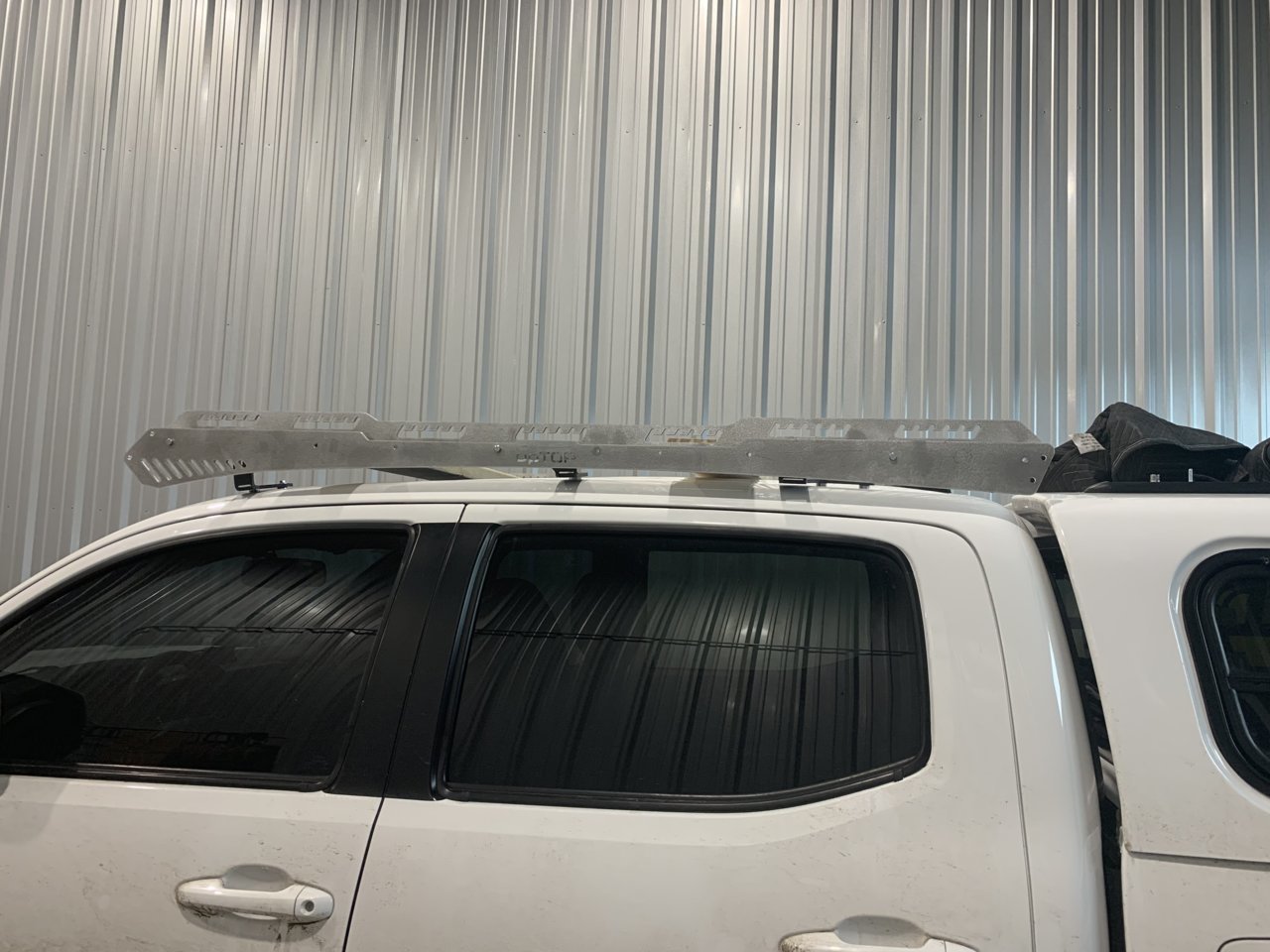

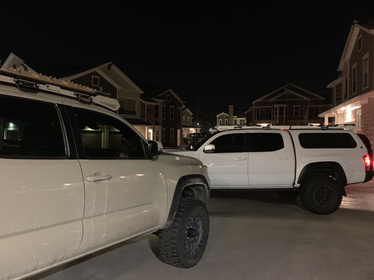

    UPDATE: 3/3/2019:
    Just a little update as to how I was spending this snowy Sunday.....

    UPDATE: 3/19/19
    TONS of stuff changing with my truck at the moment. I have a bunch of pictures that I need to get uploaded. What I have done so far:
    1. BAMF HD hangers and shackles installed
    2. Help design and prototype the new @upTOPoverland Alpha xL and Alpha eX racks for the 2005+ Tacomas and short-bed caps
    3. Final install of rack with all components powder coated.
    4. sPOD Bantam with touchscreen installed.
    5. Pelfreybilt auxiliary fuse panel trimmed to accommodate easier access to sPOD Bantam that is mounted to stock engine bay fuse box.
    6. Dynamat Extreme installed on roof of truck.
    7. 3M Satin black wrap installed on roof.

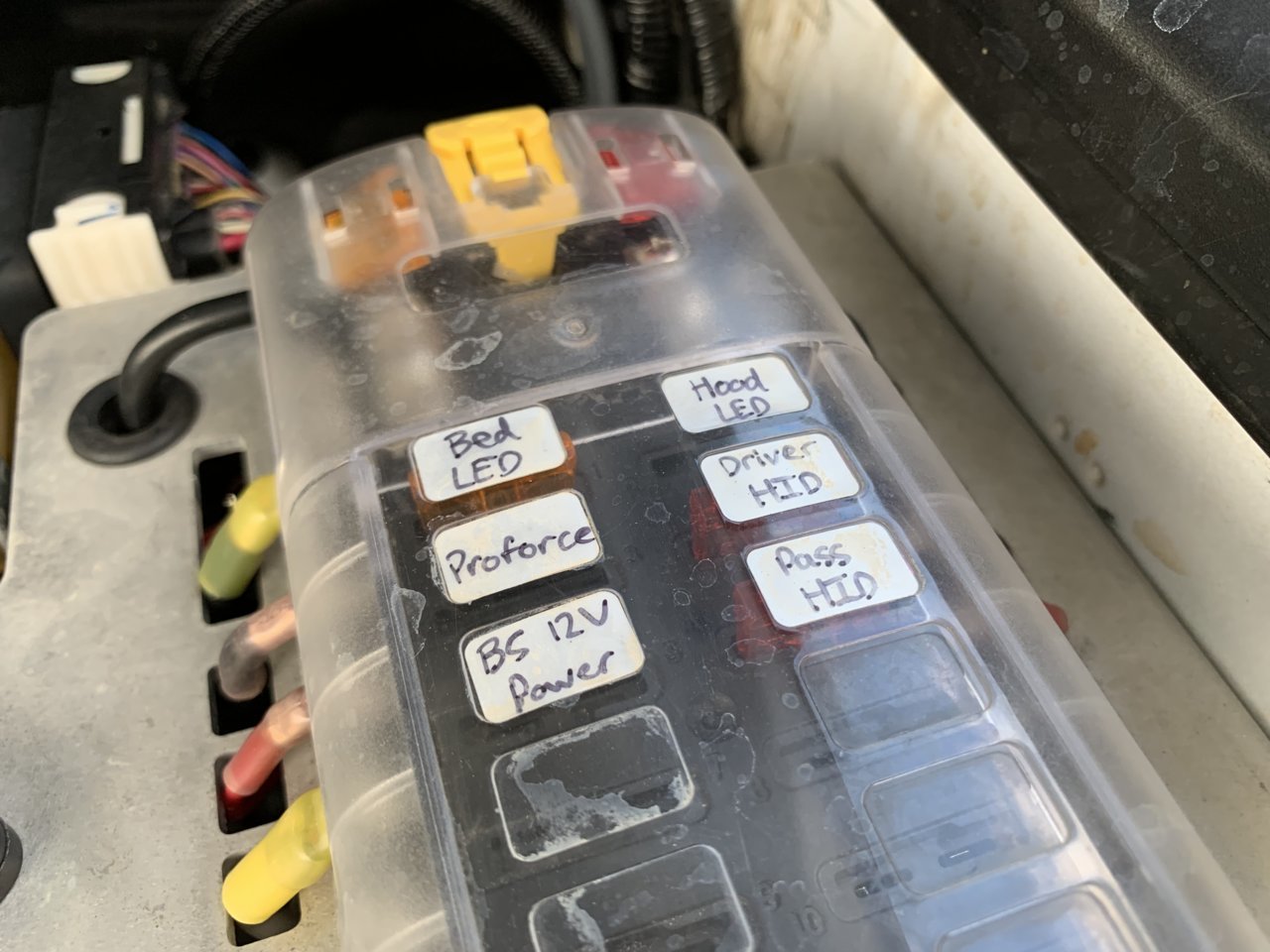

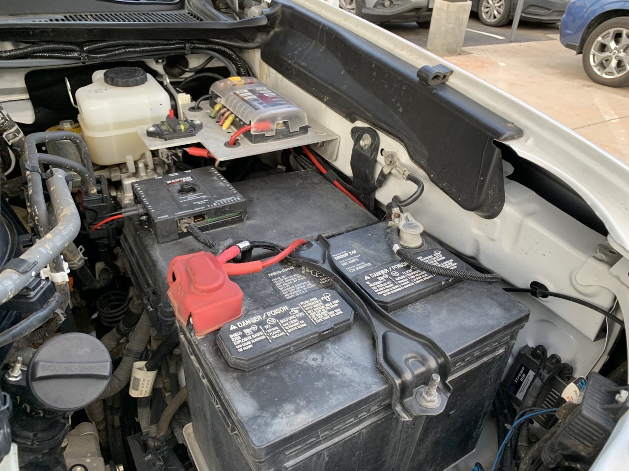

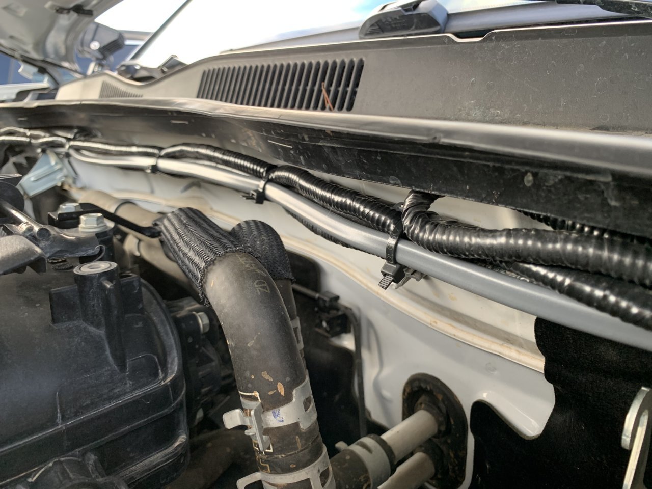

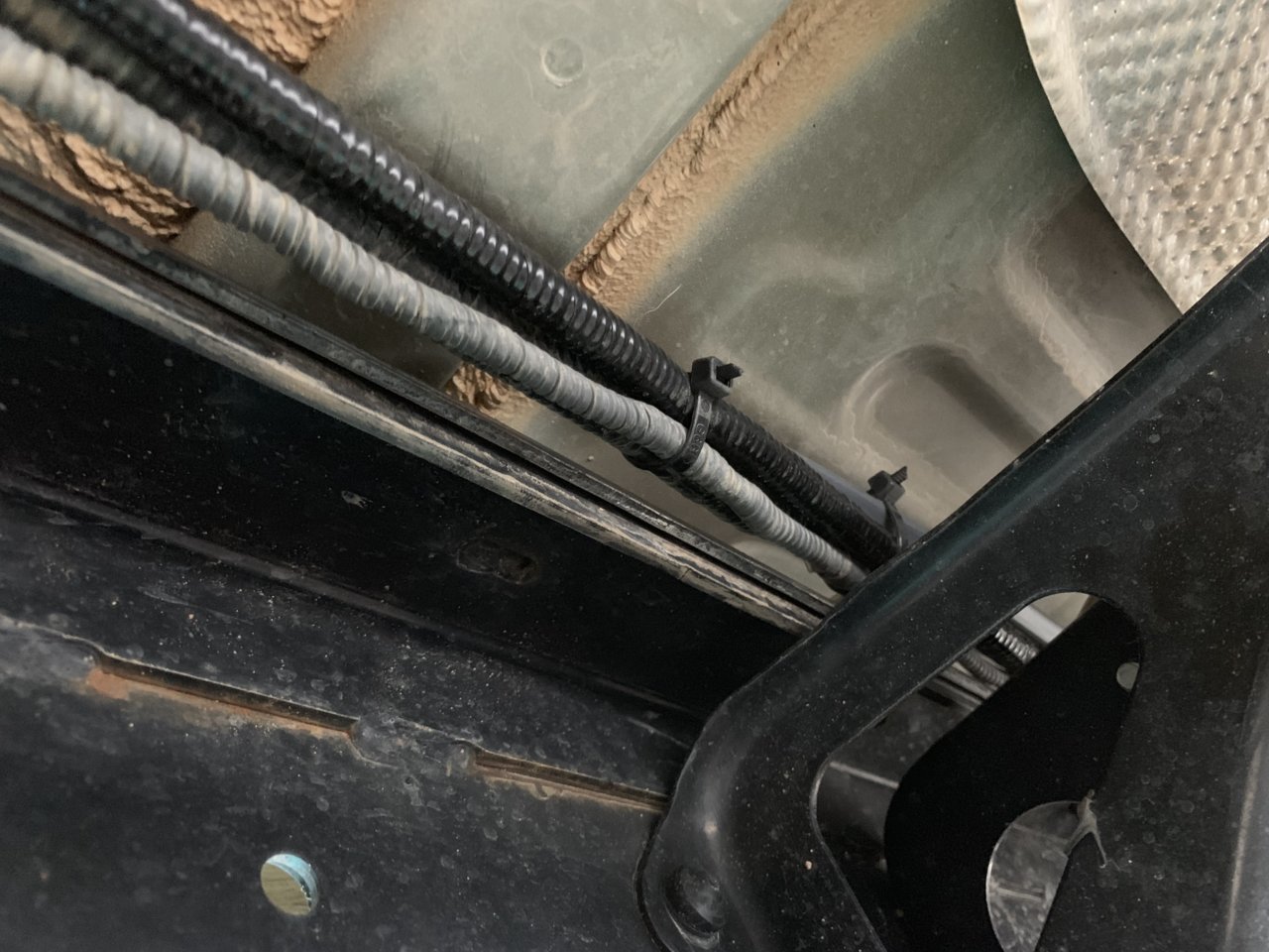

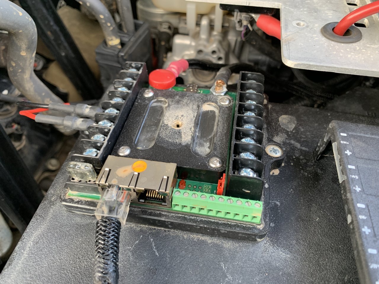

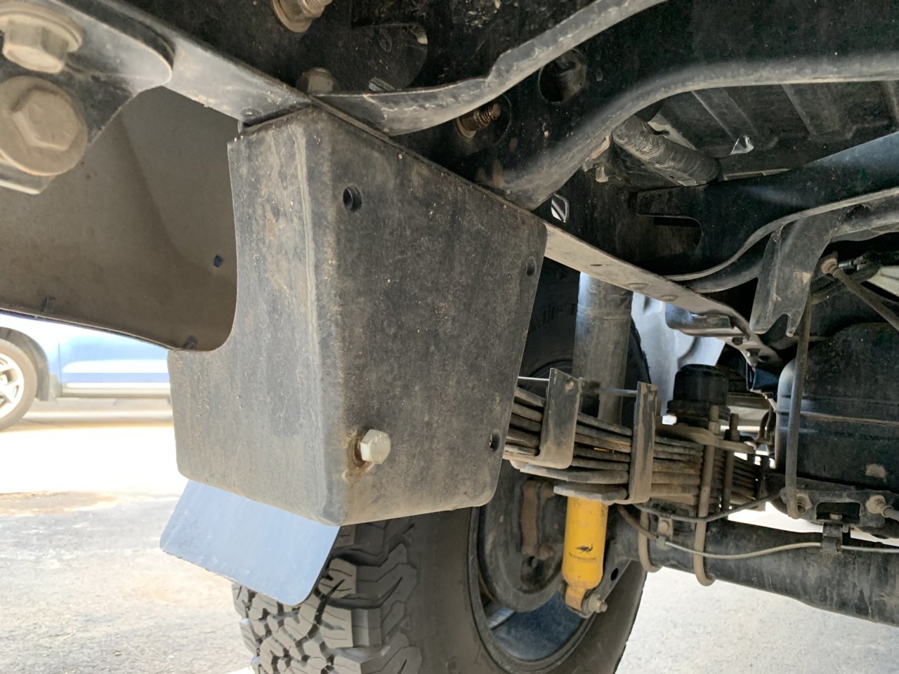

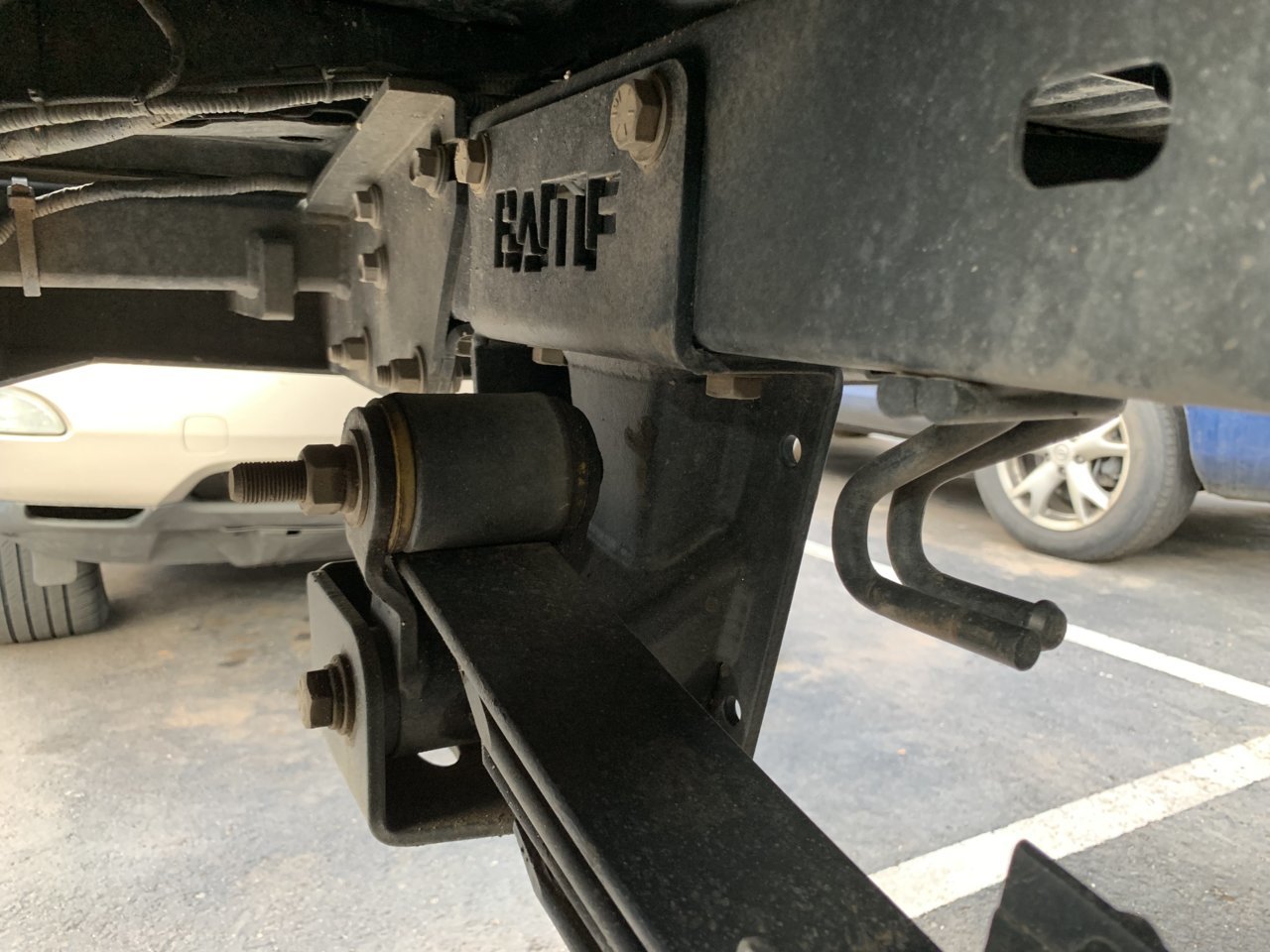

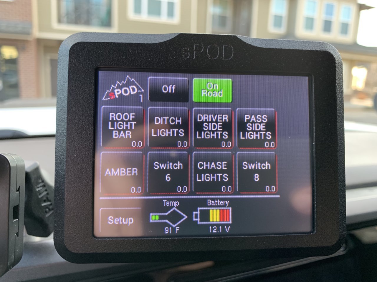

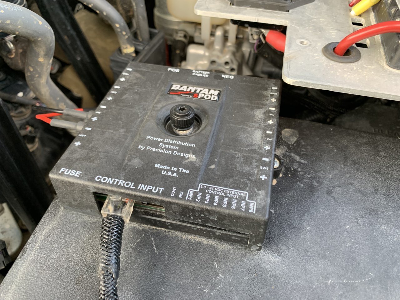

    UPDATE 3/19/19: ROUND 2
    PICTURES!

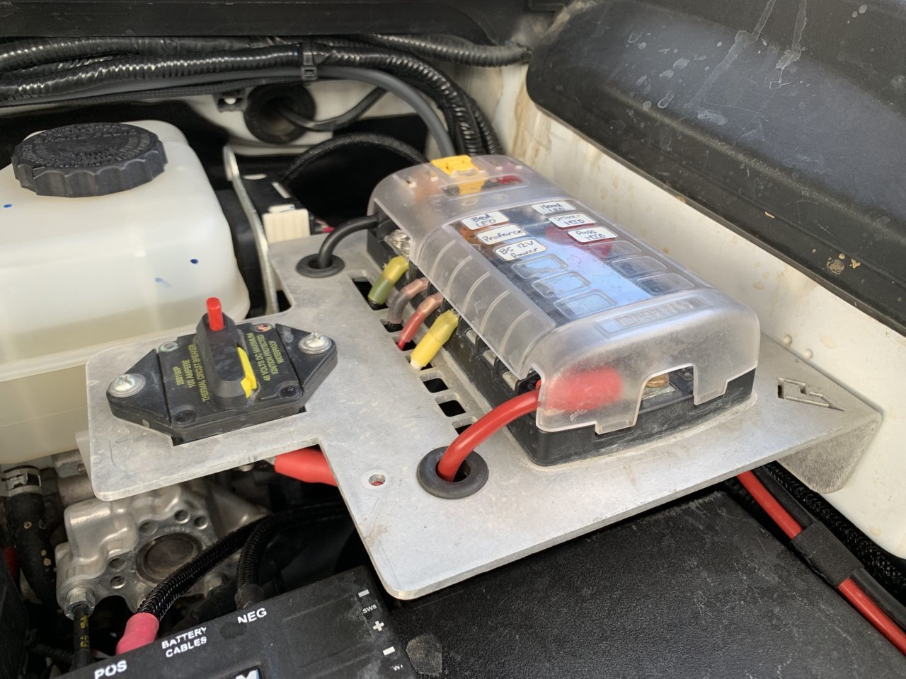

    I cut the lower corner off of my Pelfrey Fuse Panel to allow for easier access to my new sPOD.
    Before:
    After:
    sPOD:

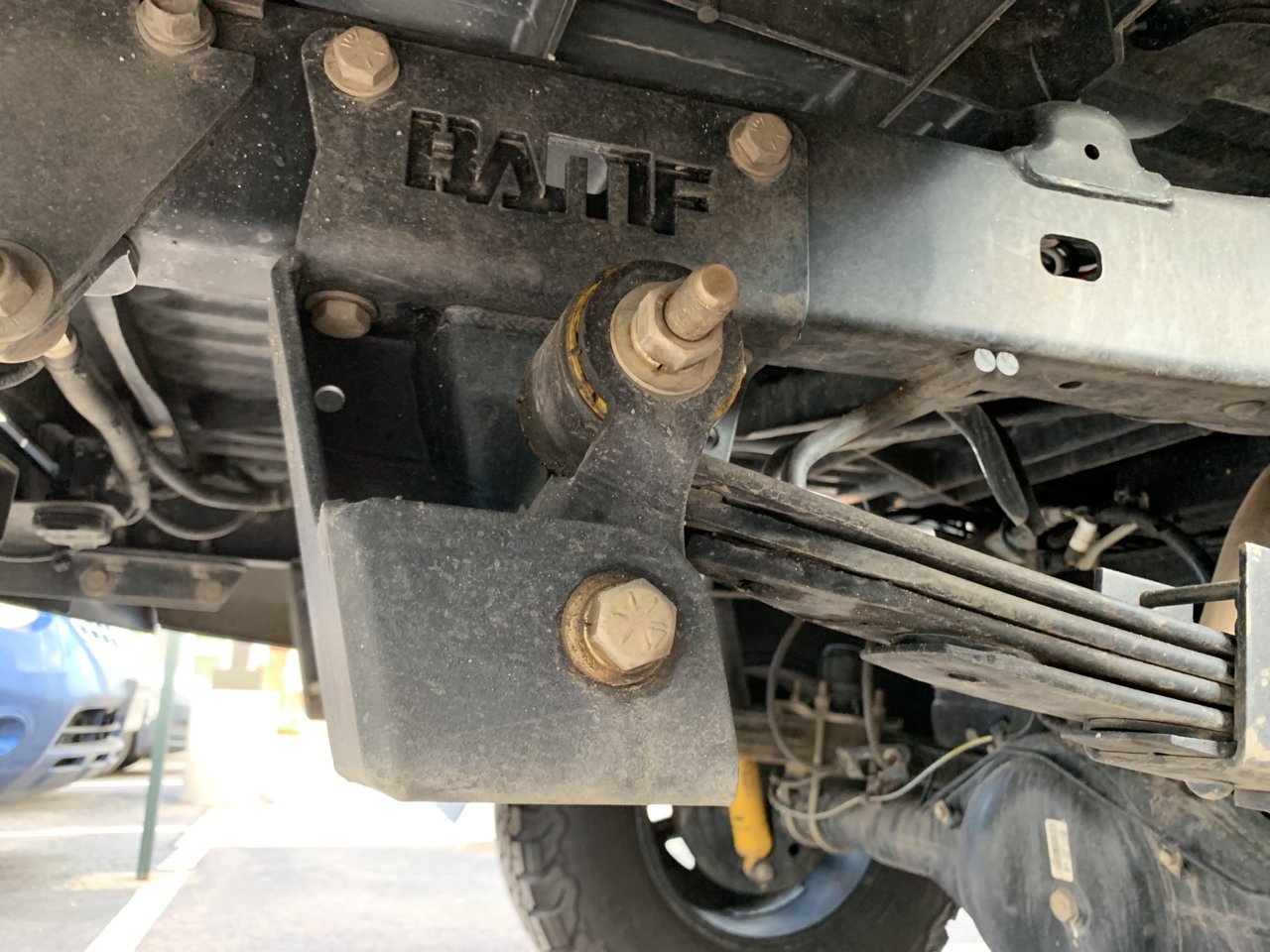

    I also ran the wire for the 12V Blue Sea power panel and @ProForce onboard water system to the back. As clean as I can do :)
    BAMF Hangers and HD Shackles:
    That is all :thumbsup:

    Too many to list. See build page. Link in signature
    There's an easier and better way to silence and maintain your springs than rebuild them periodically.... jerked/greasable bolts
