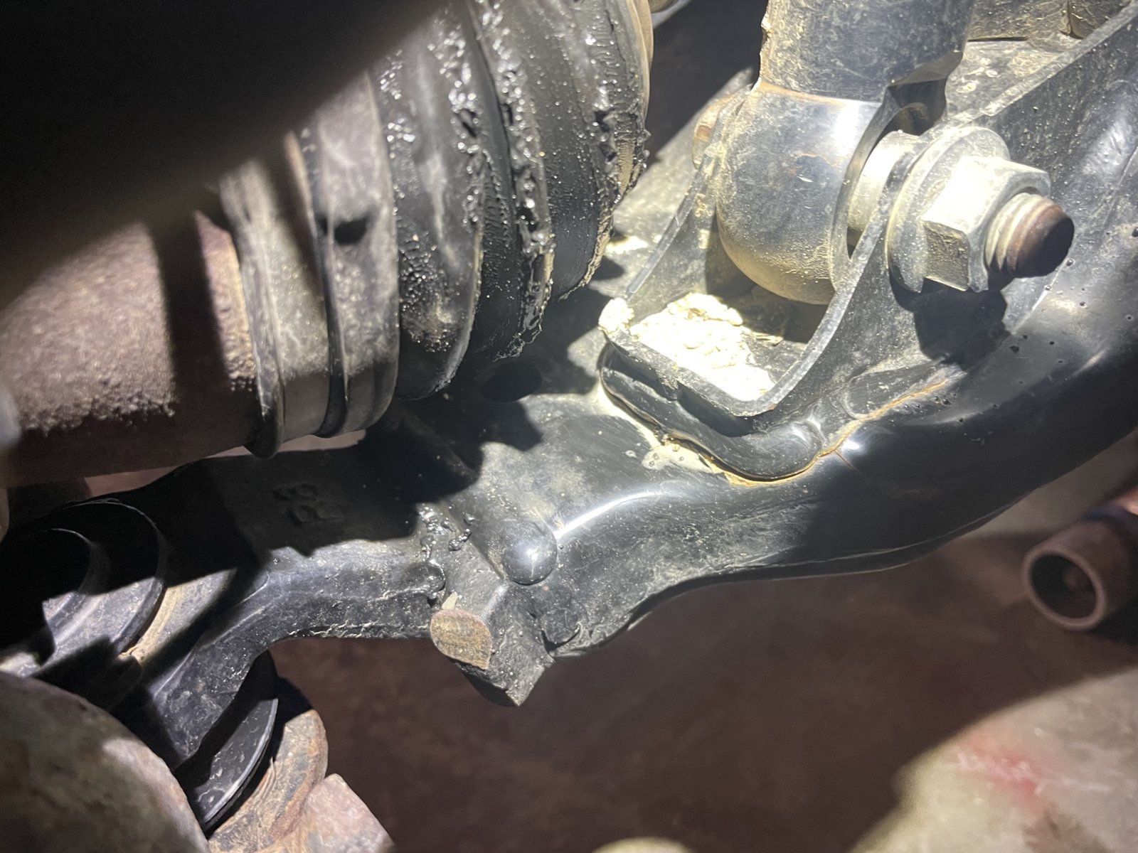

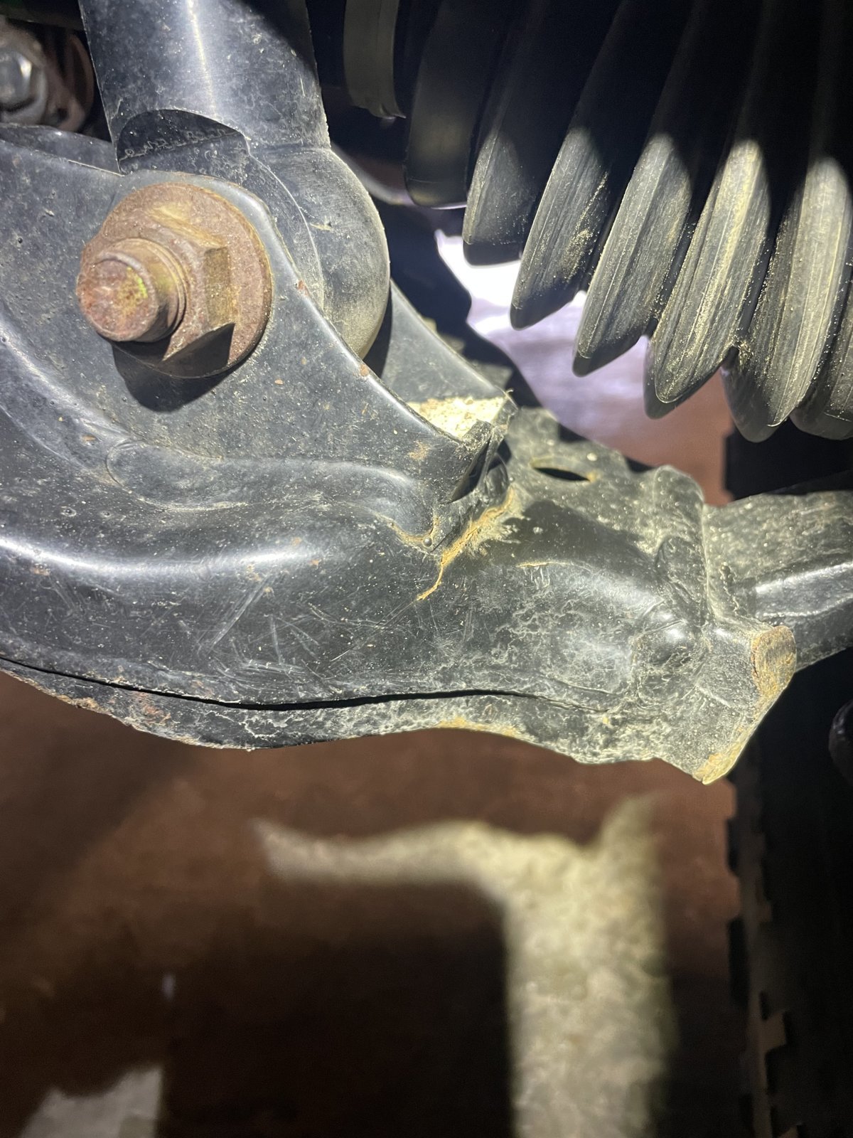

    I was in there to change an aftermarket axle that was junk and found both my lower arms with 500miles on them broken at the shock mount tabs. After buying oem to replace them with I did the hammer test on the mount tabs. The Dorman arms fold like butter the Toyota metal does not!!

    Holy shitty welds batman!

    It isn’t just the welds. They are cracked at the “hump” too.
    BTW OP, you should address that CV when you do the new LCAs.
