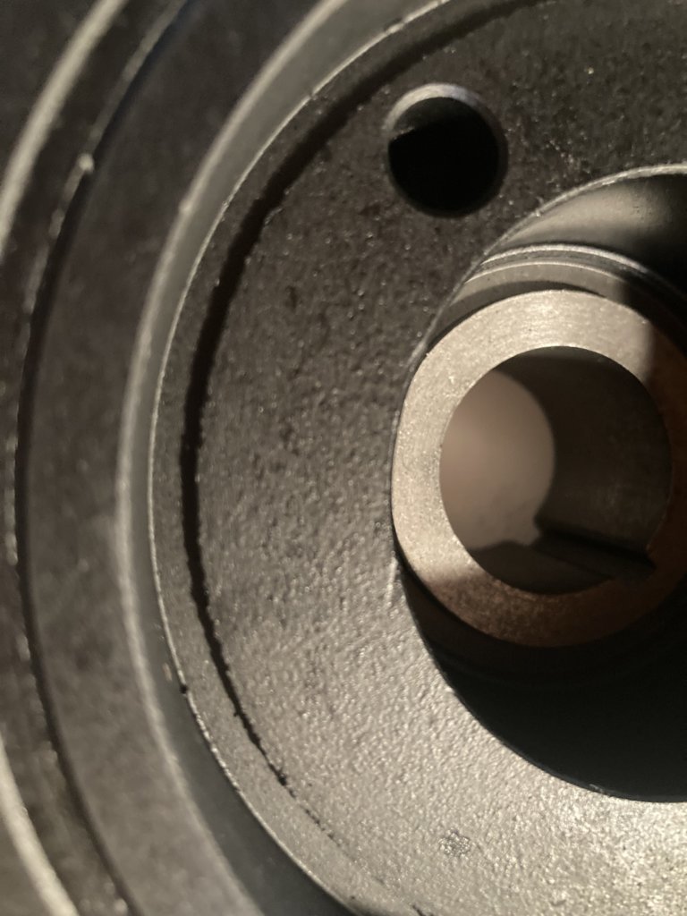

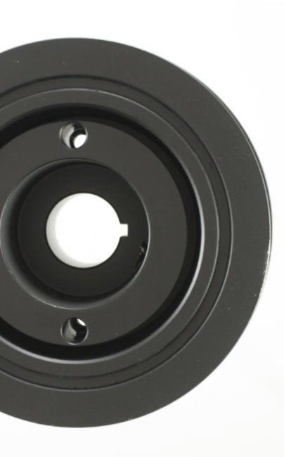

    I have had one Dorman installed & inspected two others, each being off in similar ways. I decided to try a pioneer. Seems solid, level, no funky rubber issues, etc.
    I did notice this dif however.
    Dorman
    Pioneer
    I know not why there is a space of this depth around the Dorman hub. The stock one has it as well. One could think not having it, like the pioneer, would make the part more solid. On the other hand, it may serve some necessary purpose.
    Any experts out there with an answer besides buy a Toyota csp?

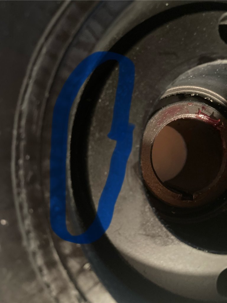

    Well, it looks like I’ll be calling pioneer again. Didn’t think to look on their site at pics of the pulley -
    Sure looks like it has that void to me! :facepalm:Hopefully the tech has some great explanation…. I just finished torquing it down….

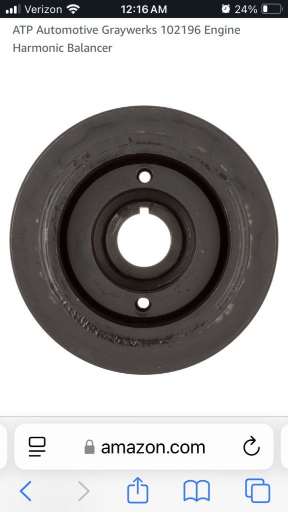

    I have a new ATP one sitting in a box. It doesn't have that void. Looks good to me.

    Well that’s interesting. I went to Amazon to look at various HB’s to see if there were any that did not have that void. One of them was the ATP, with said void. Not sayin I don’t believe you. Just wondering if it’s a new thing & these are old style pics….

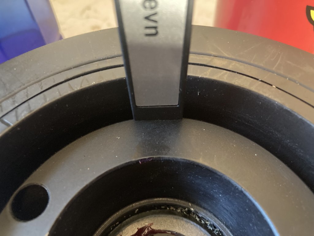

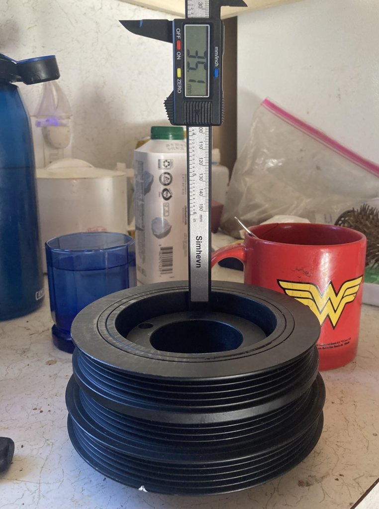

    This is the space/void -
    The pioneer is installed, so I can’t do pics. If I did, the caliper would read 2-3mm
