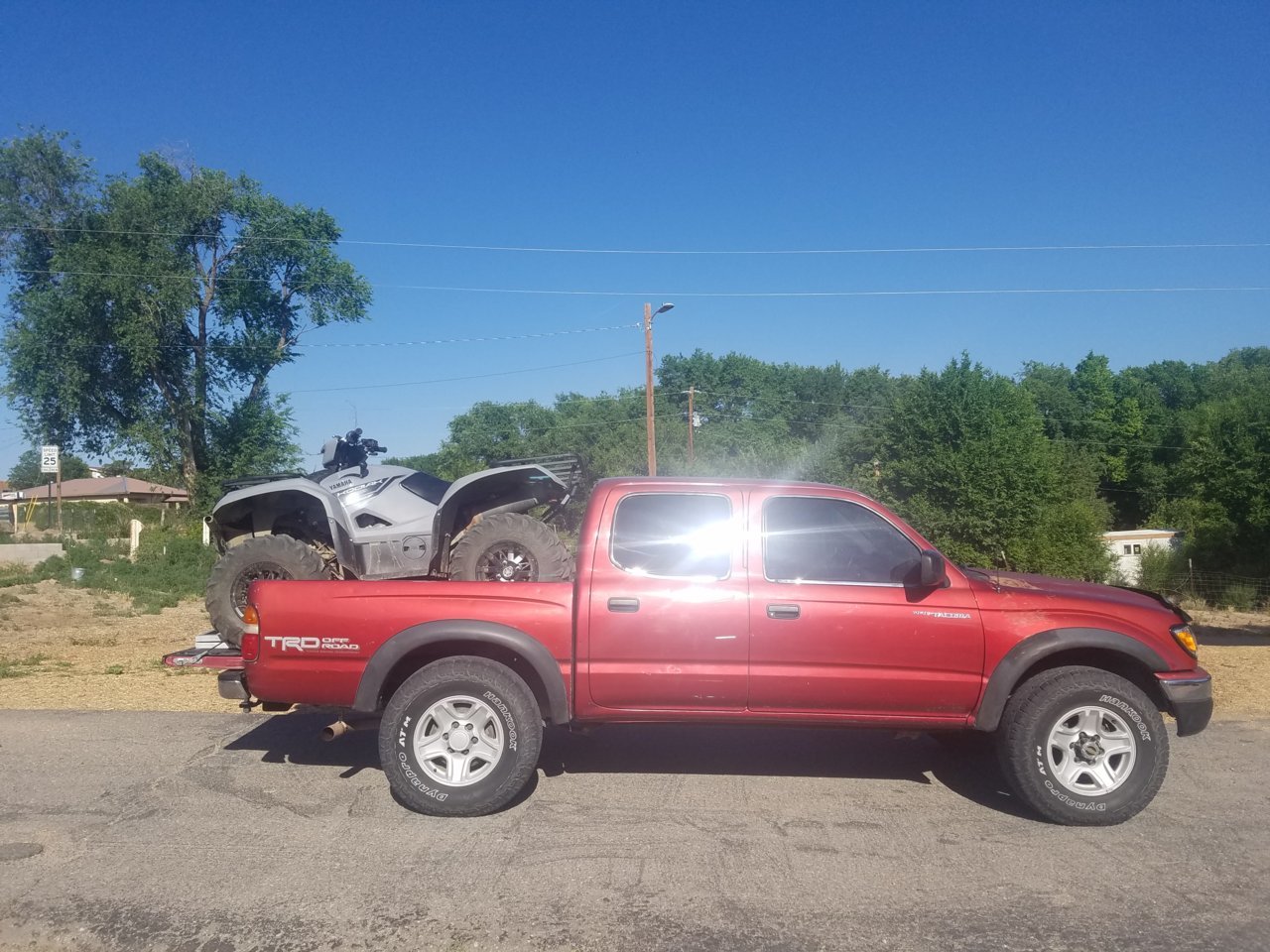

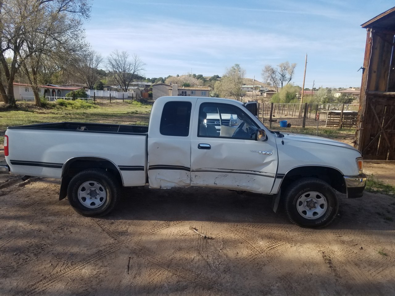

    Picked up a 02 prerunner dcsb on the cheap. Been wanting another one after I sold my 03. I had been looking for a 4x4 but in my area they are gold, 8-12k of you can find them. Always wanted a manual in my old one anyway. Then 2 weeks later I bought a 95.5 with a blown 3rz. It had alot of parts I needed for my swap (manual hubs, manual trans, ect) $800 bucks and it was mine. Then the following day a T100 with a 3.4 popped up for $600. One owner, garaged , ex cab, 4x4, auto, but it has just been t-boned and was rolled on its side. So long story short I bought 3 trucks for $4900 and shipped be able to build 2 out of 3. That's was my plan

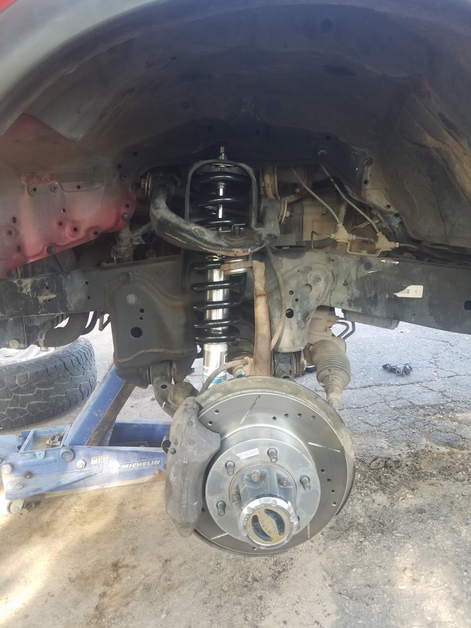

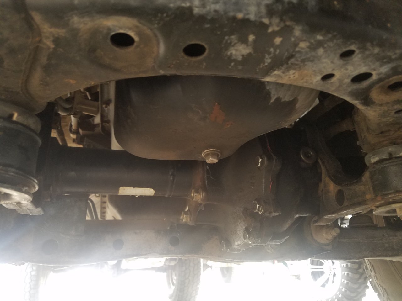

    Found a good deal on some 4runner limited wheels and 265/75r16 dynapro tires for 150, ordered new ball joints, tie rod ends, rotors and pads and new brake lines. Since I was going to have the front end torn apart anyway I figured it's a good time to swap in my front axle from my 95.5 doner truck. I found a set of 4.56 diffs on Craig's for $350 but the rear was making noise and needed a rebuild. I installed the new front diff on the non add tube, replaced the seals and put the mounts on. I put new inner seals on the hubs, replaced the bearings and installed all 4 cv boots.

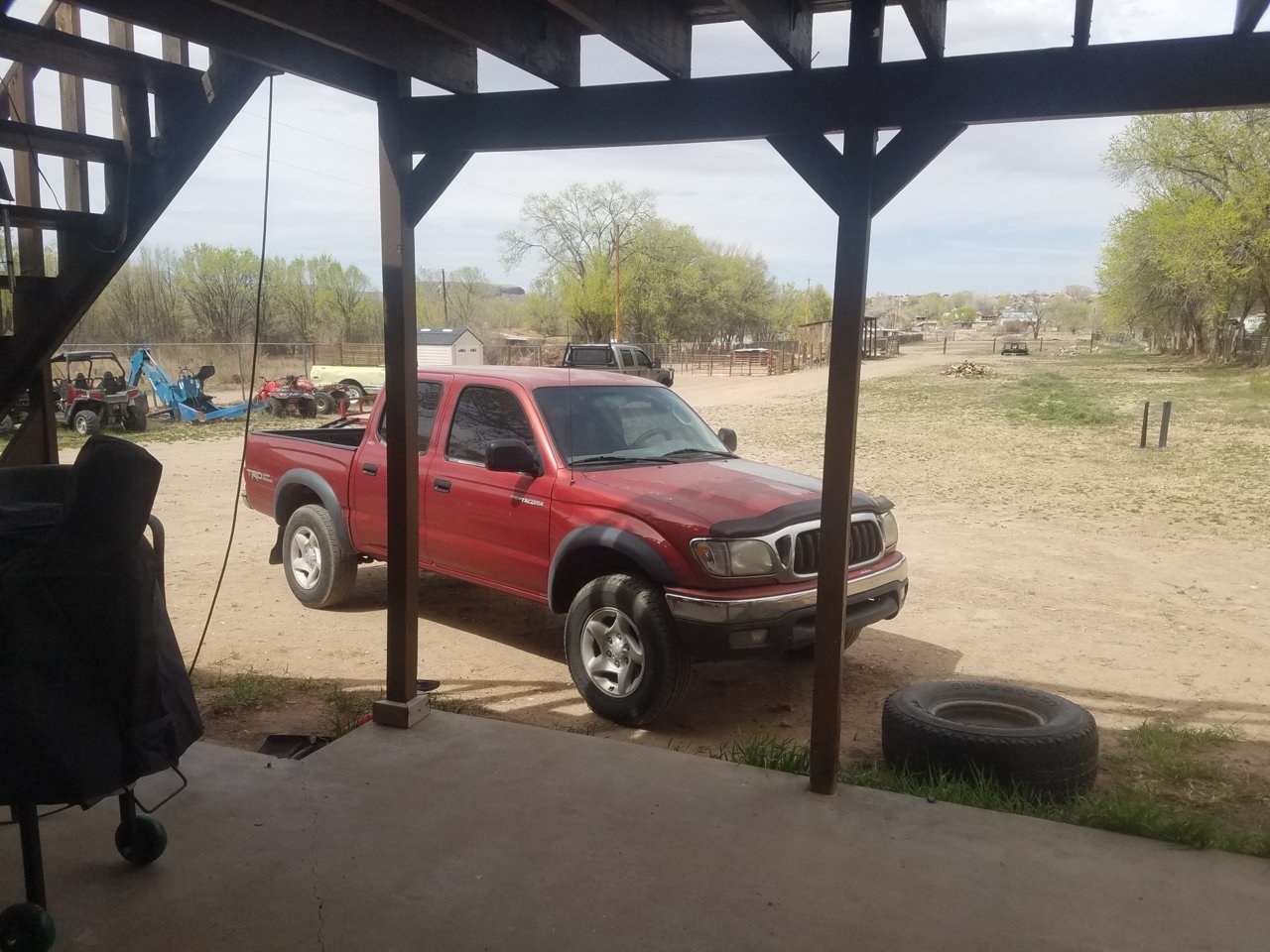

    The war on chrome has begun. Need to derp the bumpers next

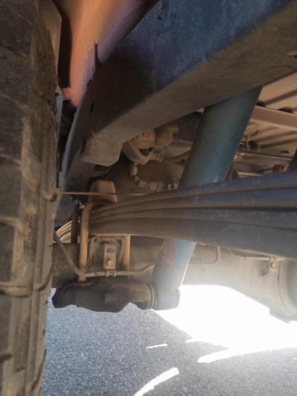

    Carrying around a few things I noticed the rear leafs are on the weak side
  7. Aug 4, 2018 at 9:06 PM
    pairodice
    pairodice [OP] Well-Known Member
    Jul 8, 2009
    #19456
    1,490
    Jay
    SF NM
    02 DCSB prerunner 4x4 manual

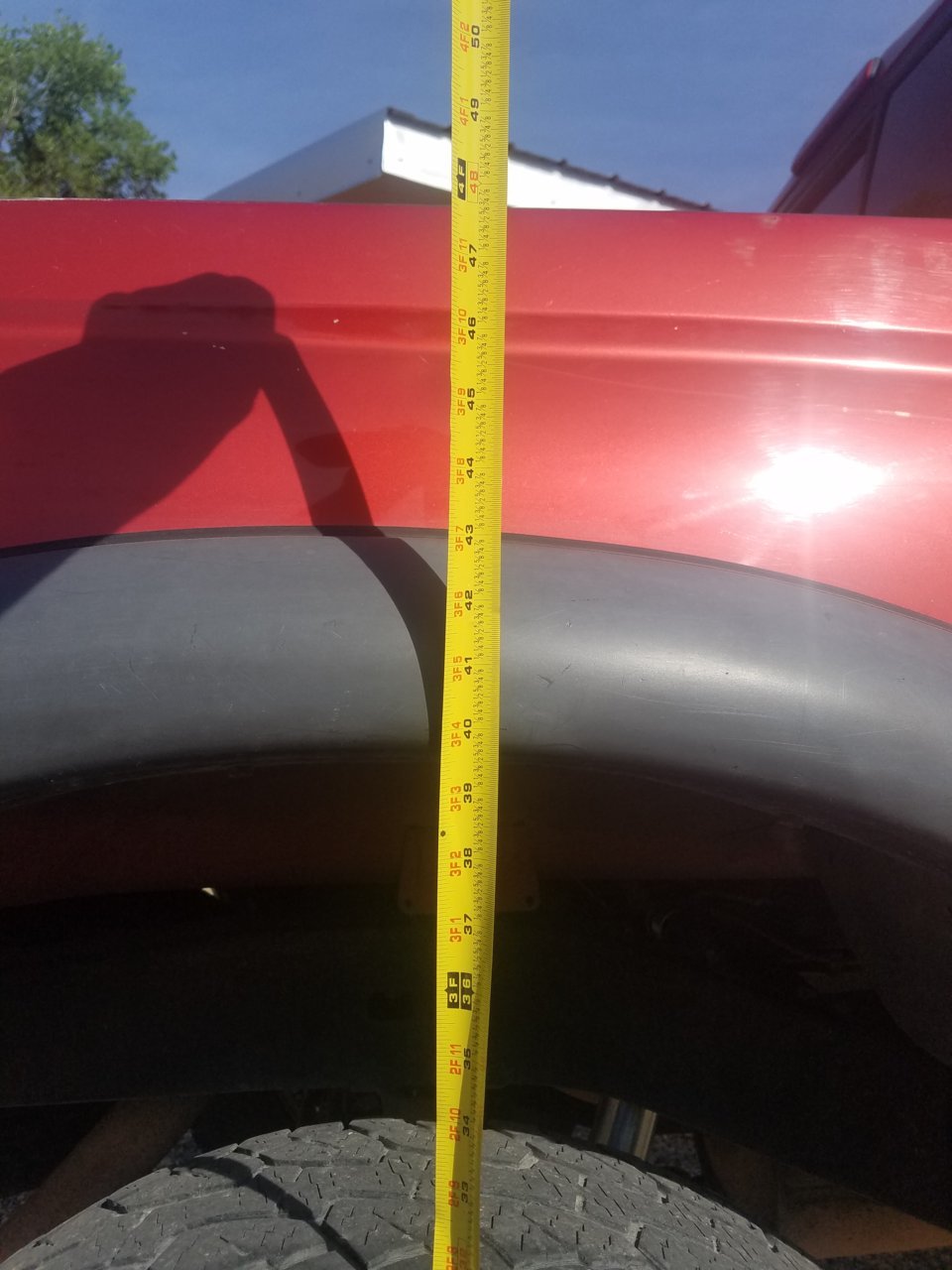

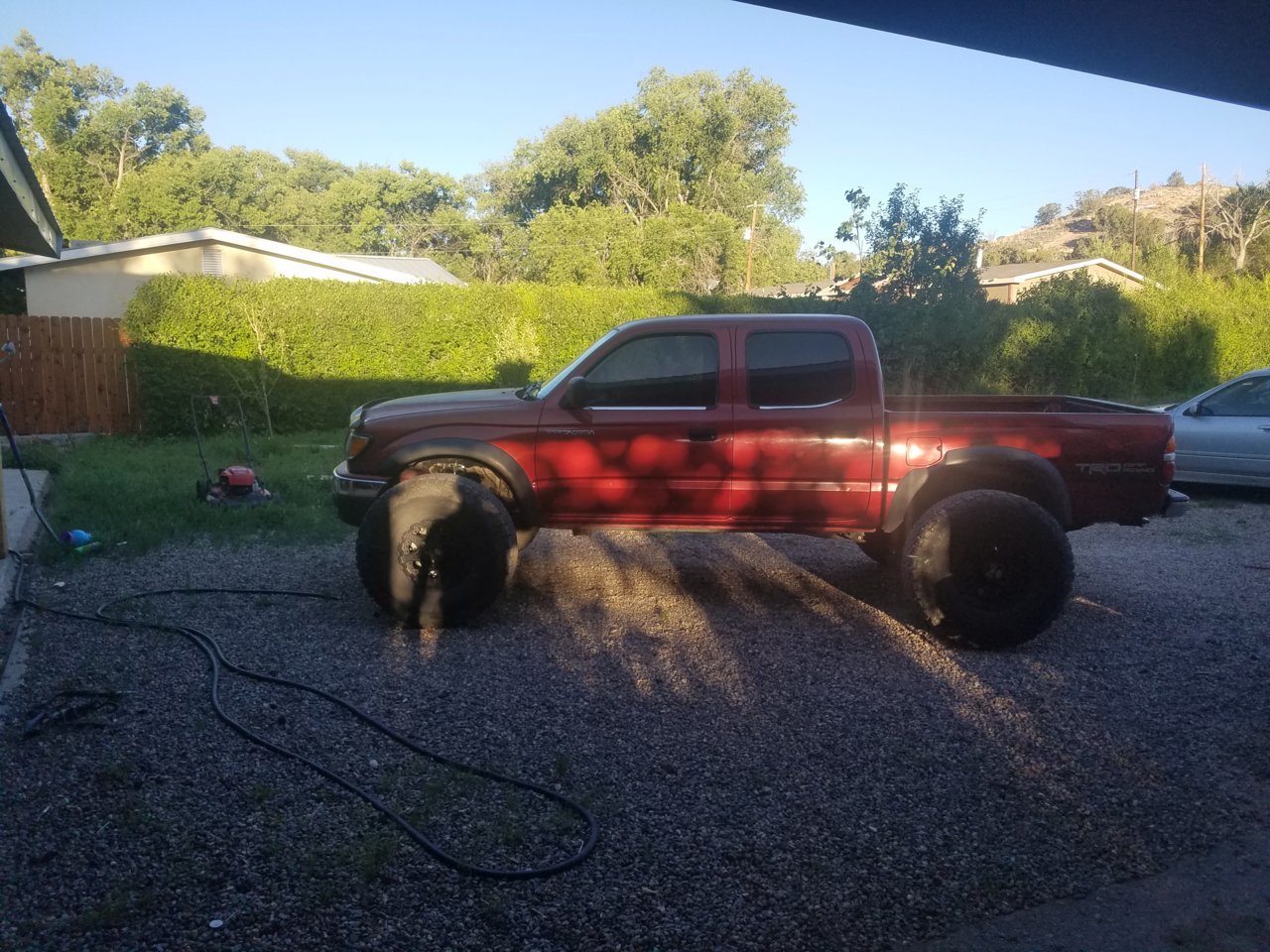

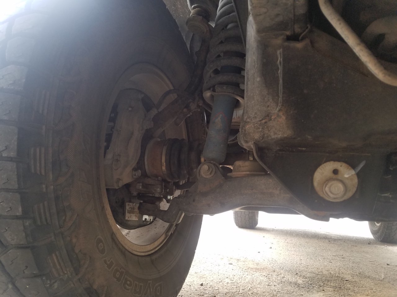

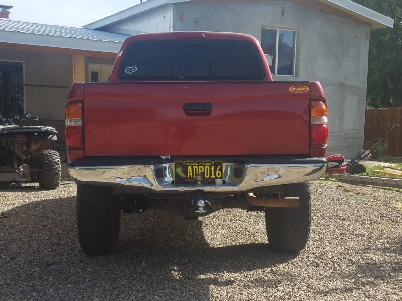

    I put a call into wheeler's offroad, got some 5100's, 883's, daker leafs, u bolts and shackles. Install went smooth since luckily my truck is from the desert and has zero rust. Got it aligned and I might need some uca's too get the numbers perfect but it's damn close. It was almost perfect level stock about 1/2 inch taller in back. Also removed sway bar. Had the 37s off my other truck and decided to roll them over and see what it would look like. I couldn't imagine how much cutting and lift it would take to get them to fit

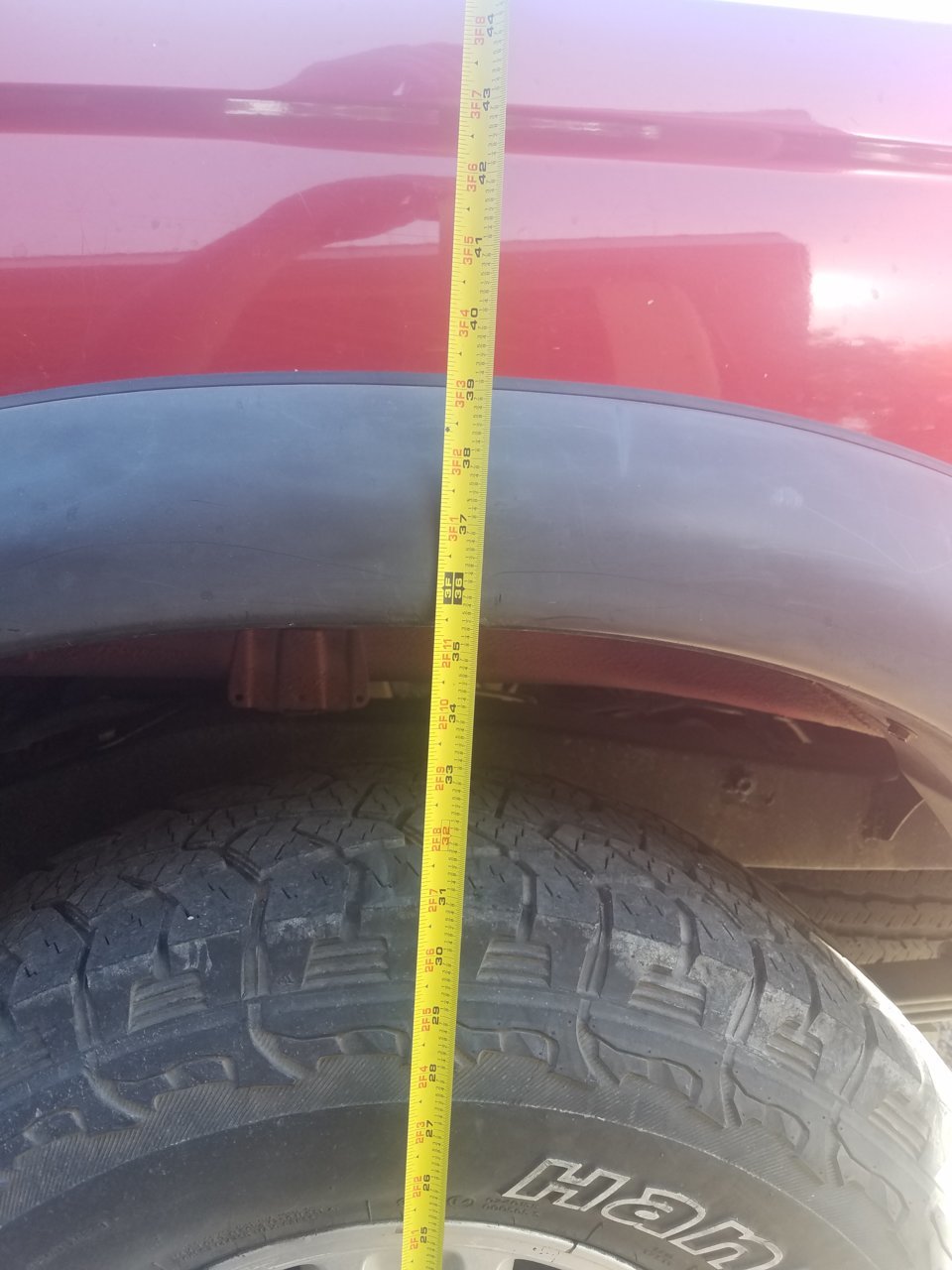

    Rear lift before and after

    883's and 5100's

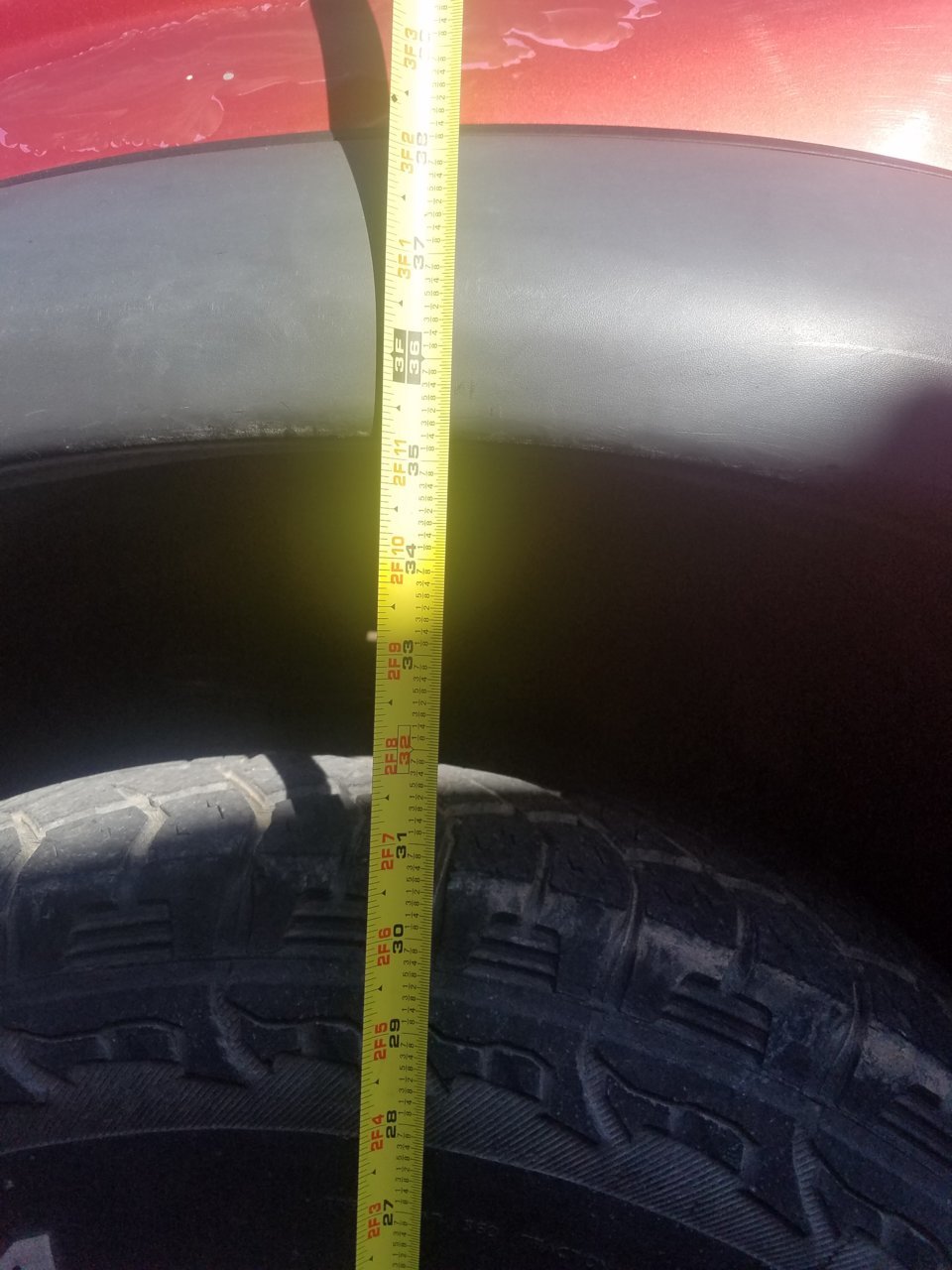

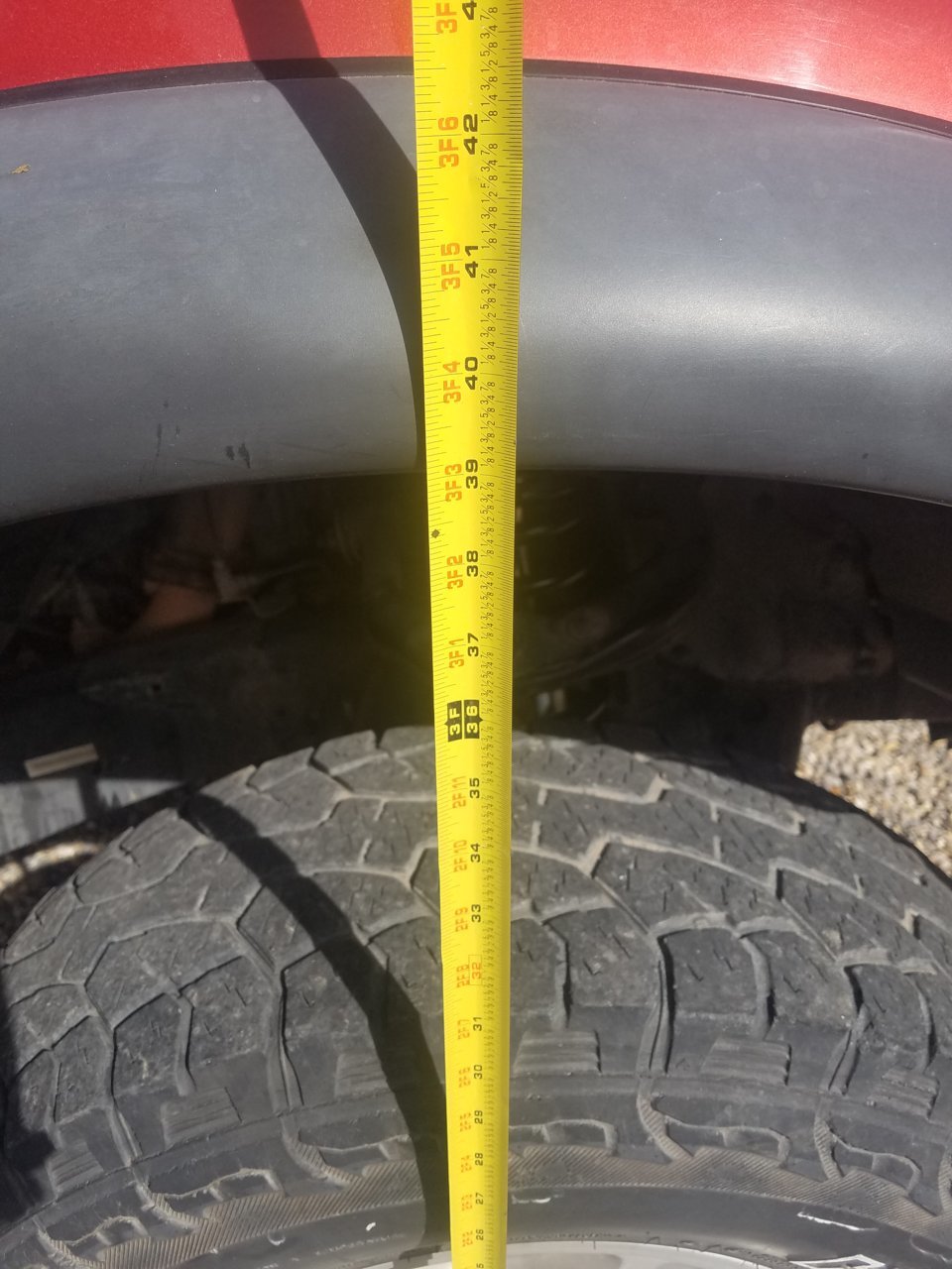

    Front before and after

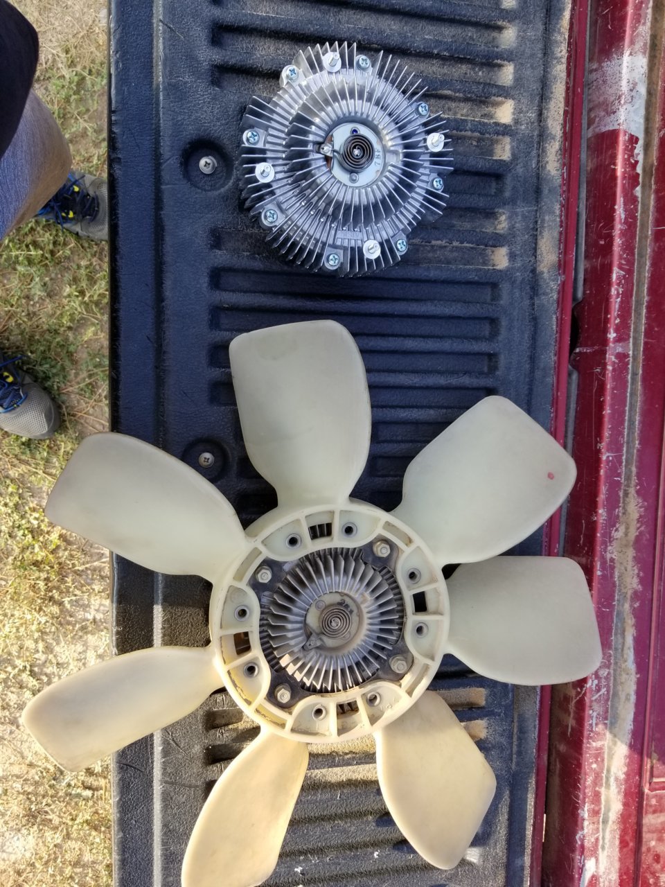

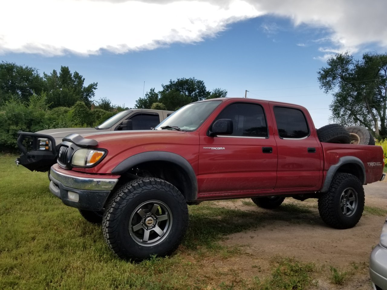

    Next on the to do list, rebuild rear diff so i can have 4.56's out back to match the front. Also I think my fan clutch is about to shit the bed. Ac only works when I'm moving. Also looking at tires, I've narrowed it down to km3, ko2 and duratrac. I'm not sure if I should get spacers for the wheels I have or just find some wheels I'm planning on running 285's

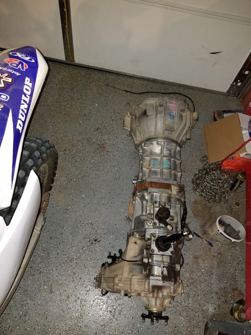

    Trying to round up the last few parts so I can do the manual trans swap. Its amazing how many parts that won't work, do your homework kids. So I thought the shifter boot and bezel from my 95 would fit since it's gray interior, nope. Basically the only parts I've been able to use is the front diff, manual hubs and CVS and clutch pedal. So right now I need clutch , flywheel, rear driveshaft( i might just chop mine down to size), shifter bezel and boot, front driveshaft( I've read they are all the same but not 100% sure) i have one from my 95 but it's a 3rz. It has a m59 trans but t case is the same j shift. The ECM is by far the hardest part to find. I've only seen 1 on Ebay for 700 bucks, no thanks. I got the trans, bell housing and t case put together today finally

    I would short there rear shaft.
    And ether front shaft should work.
    T100 shaft would prob need shortened as well.

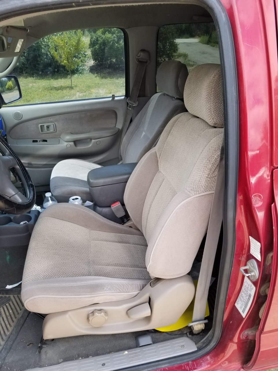

    On a side note I installed one of the T100 sport seats. I had to cut the 2 seat mounts near the tunnel from the Tacoma off, and weld them in place of the T100 mounts. They fit like a champ, I did have to drill and swap the seat buckle bolt and latch.

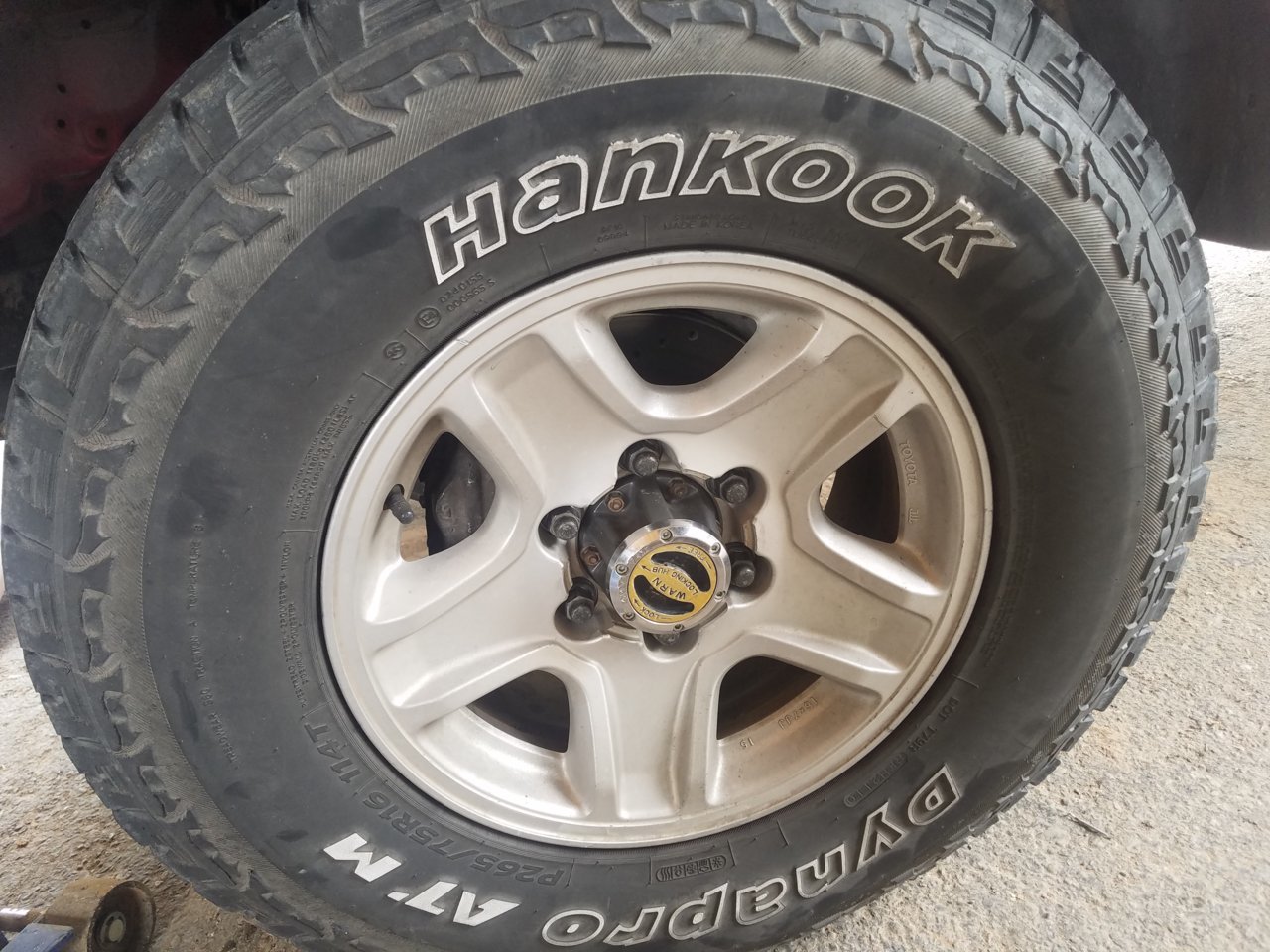

    285 bfg ko2 w/ level 8 16x8

    Swapped out the fan clutch, a/c stays cold while not
    moving now
