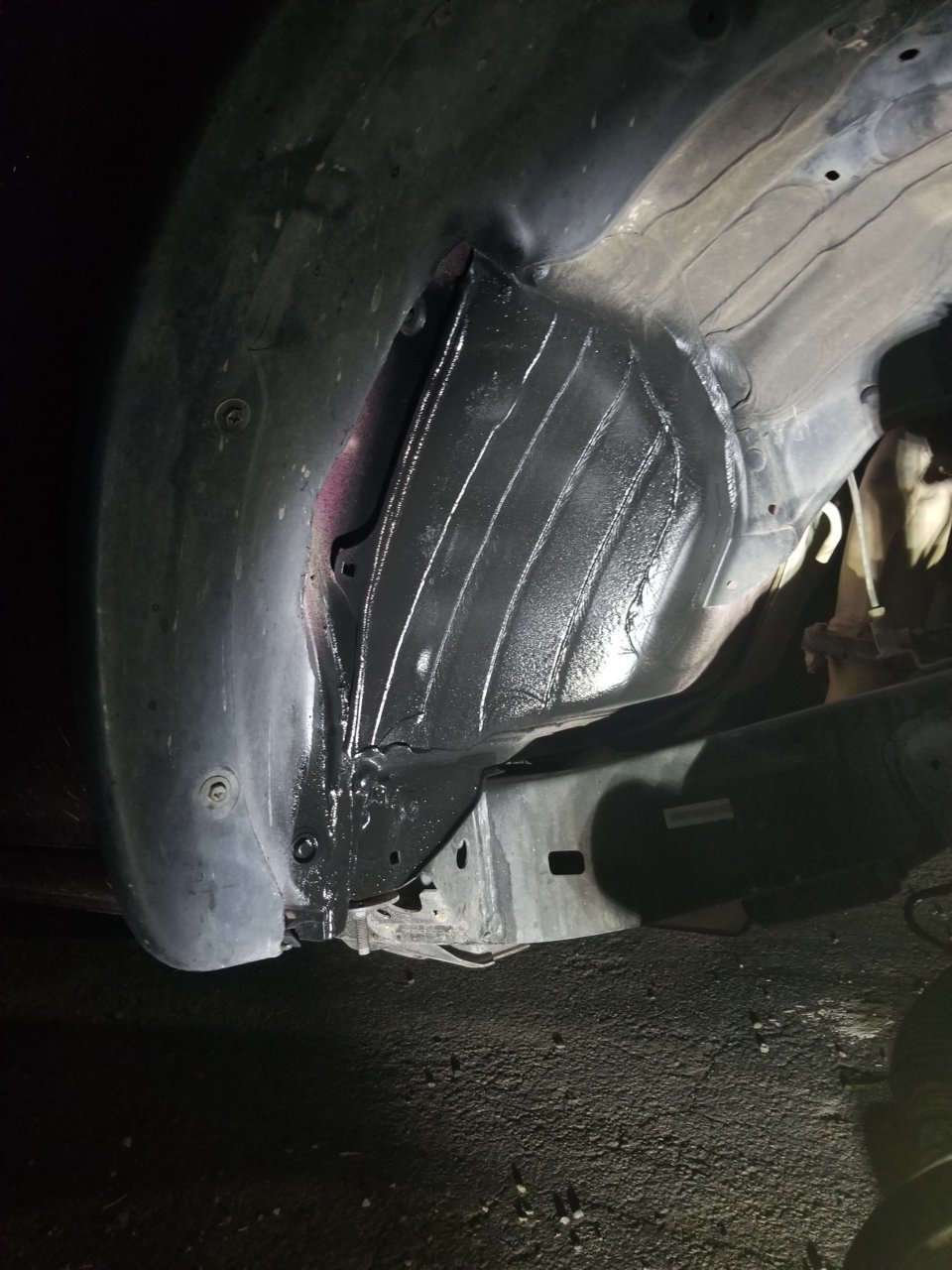

    Midnight pinch weld mod

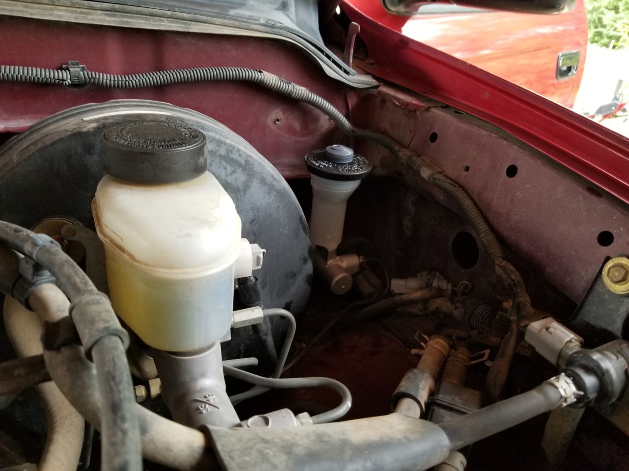

    Clutch kit, slave and clutch master cylinder showed up today. Going to tear it down this weekend. I started by draining trans fluid and removing center console

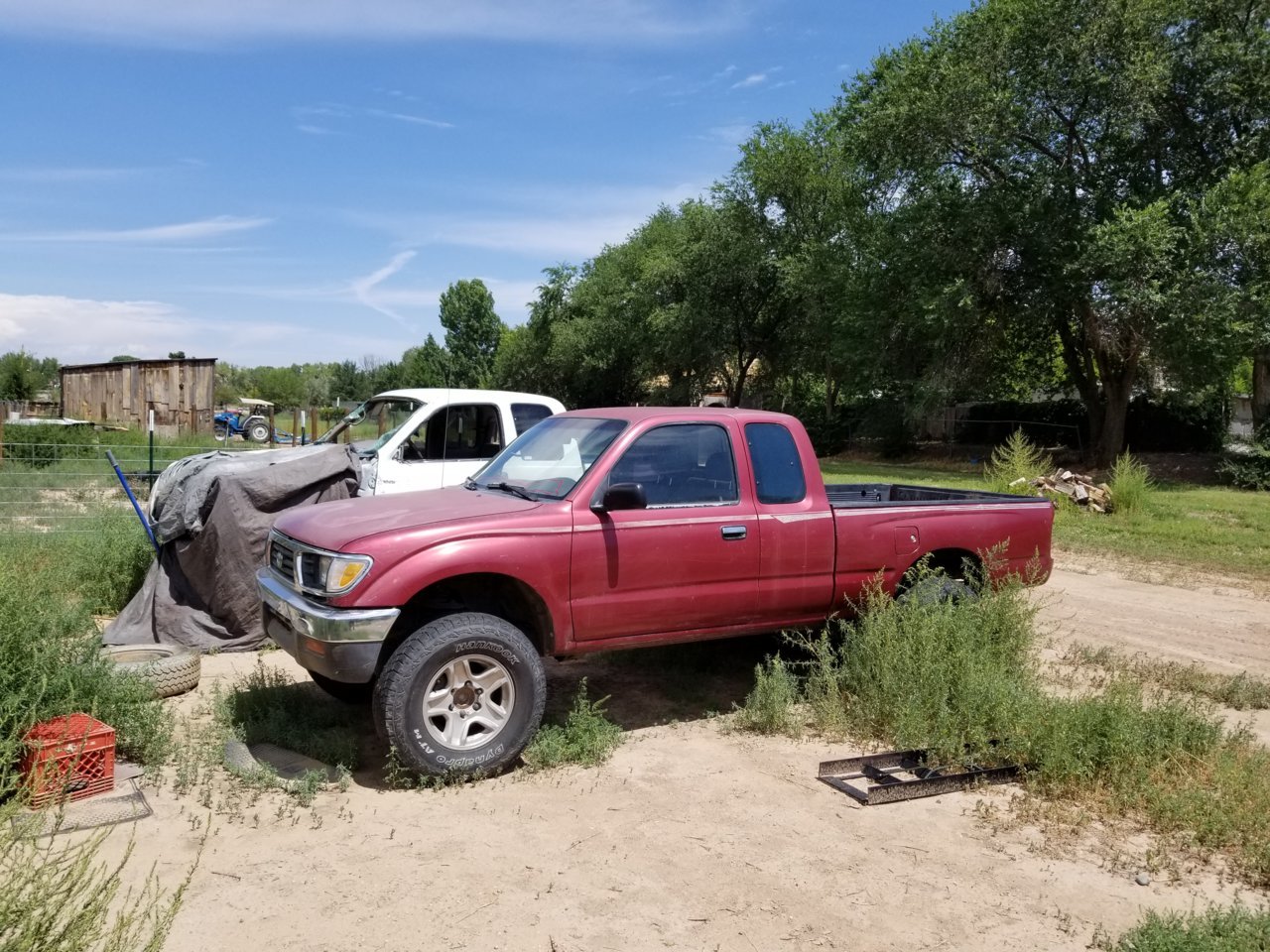

    This is the next project 95.5 2.7 4x4. I'm going to do a 3.4 swap w/ auto and sas w/ Toyota axle

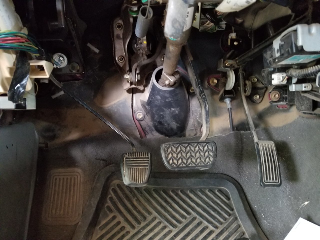

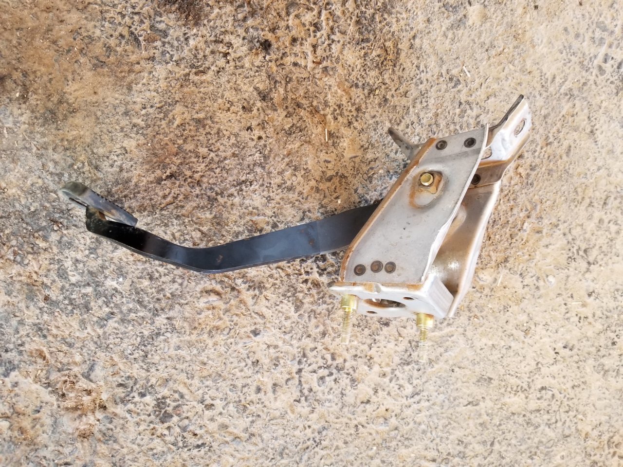

    Clutch pedal all cleaned up. I made a template from the 95 to drill the holes. The holes for the mount aren't in the same spot so I had to ream them out. It's a shitty spot to begin with, dash had to come apart and still not much space. I removed the driver seat but the fuse box is in the way. My right angle drill just fit. Ive heard this is the worst part and so far I must concur. I took longer to get the pedal and master than to pull the trans out

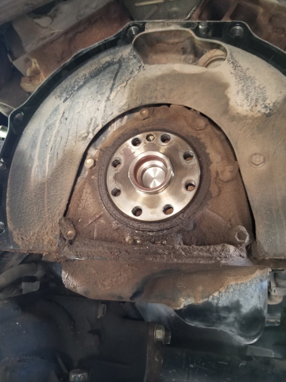

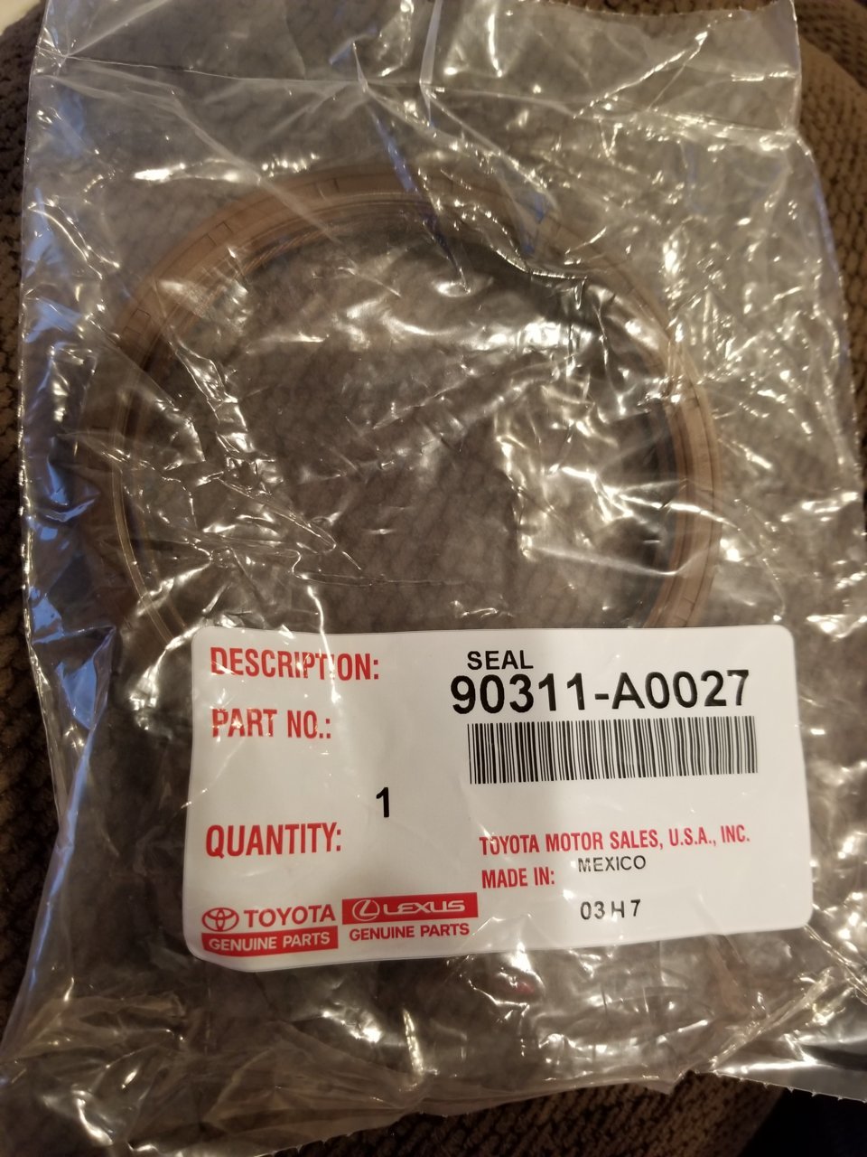

    Rear main leaking

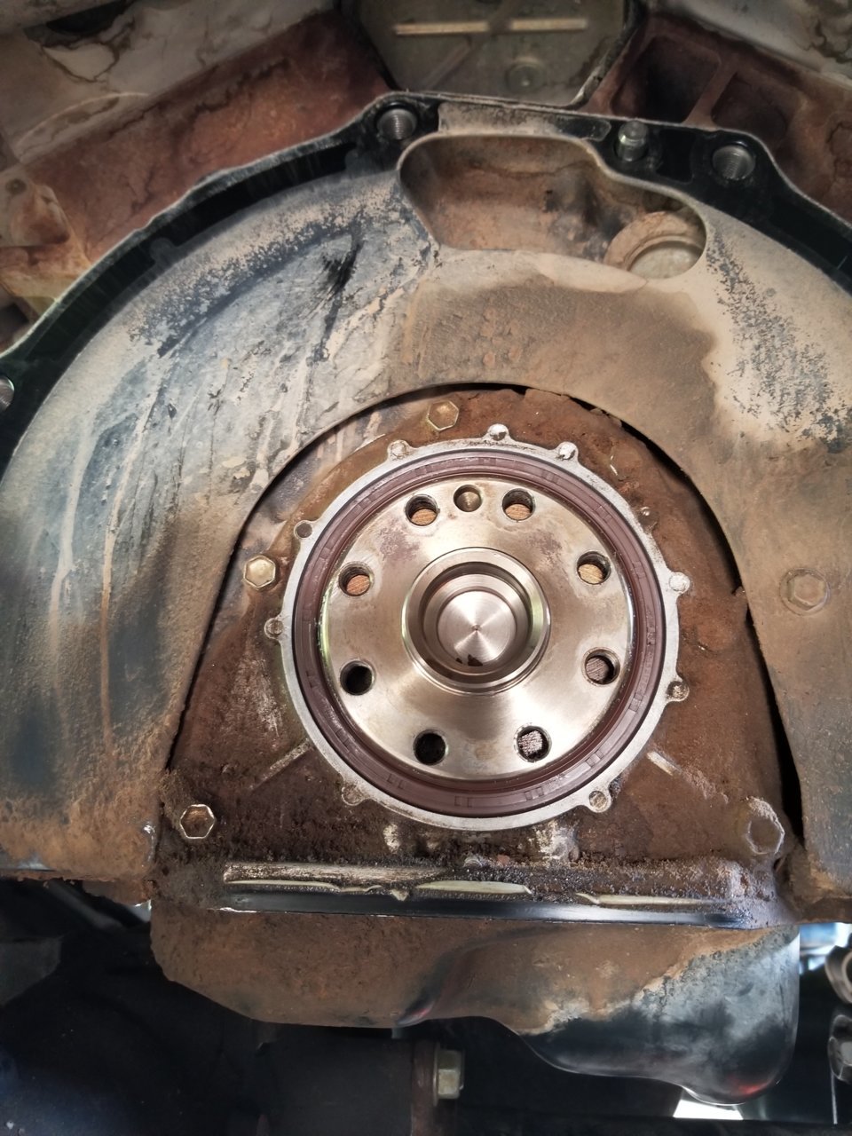

    Got my rear main changed out. Here's the Toyota part # if anyone needs it. About $65

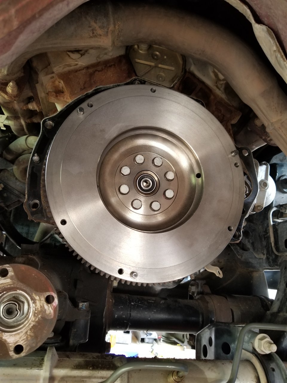

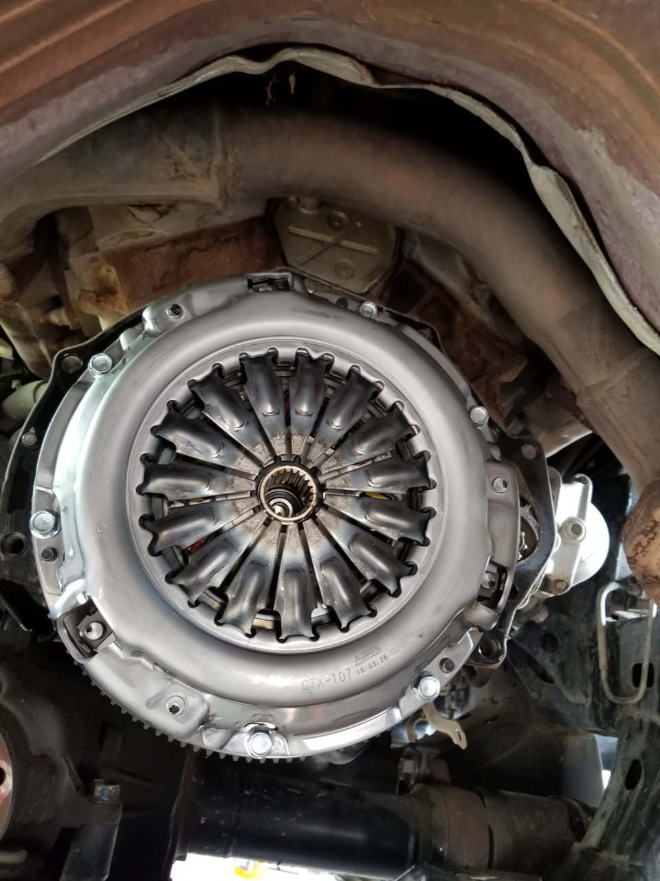

    Flywheel torque spec 63 ft-lb per fsm
    Pressure plate torque 16 ft-lb per fsm
    Installed pilot bearing

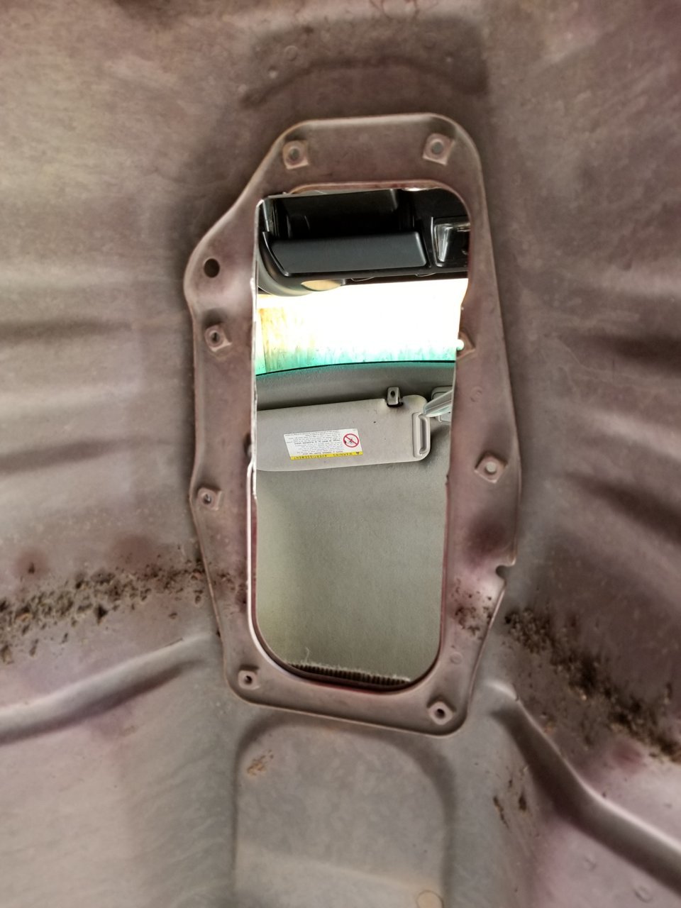

    Shifter cutout
