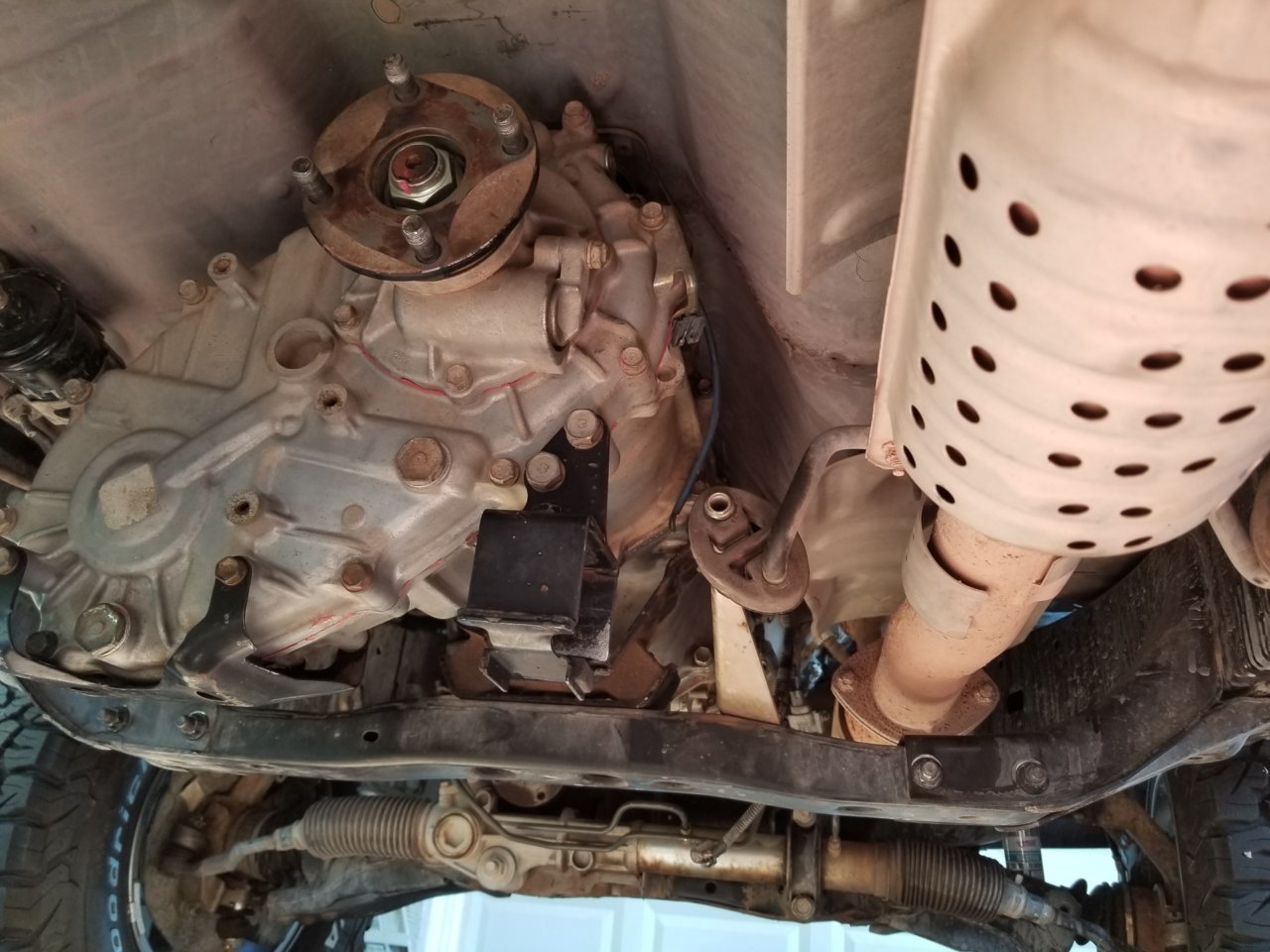

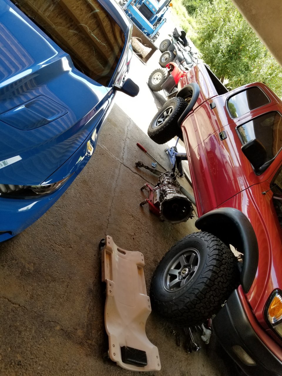

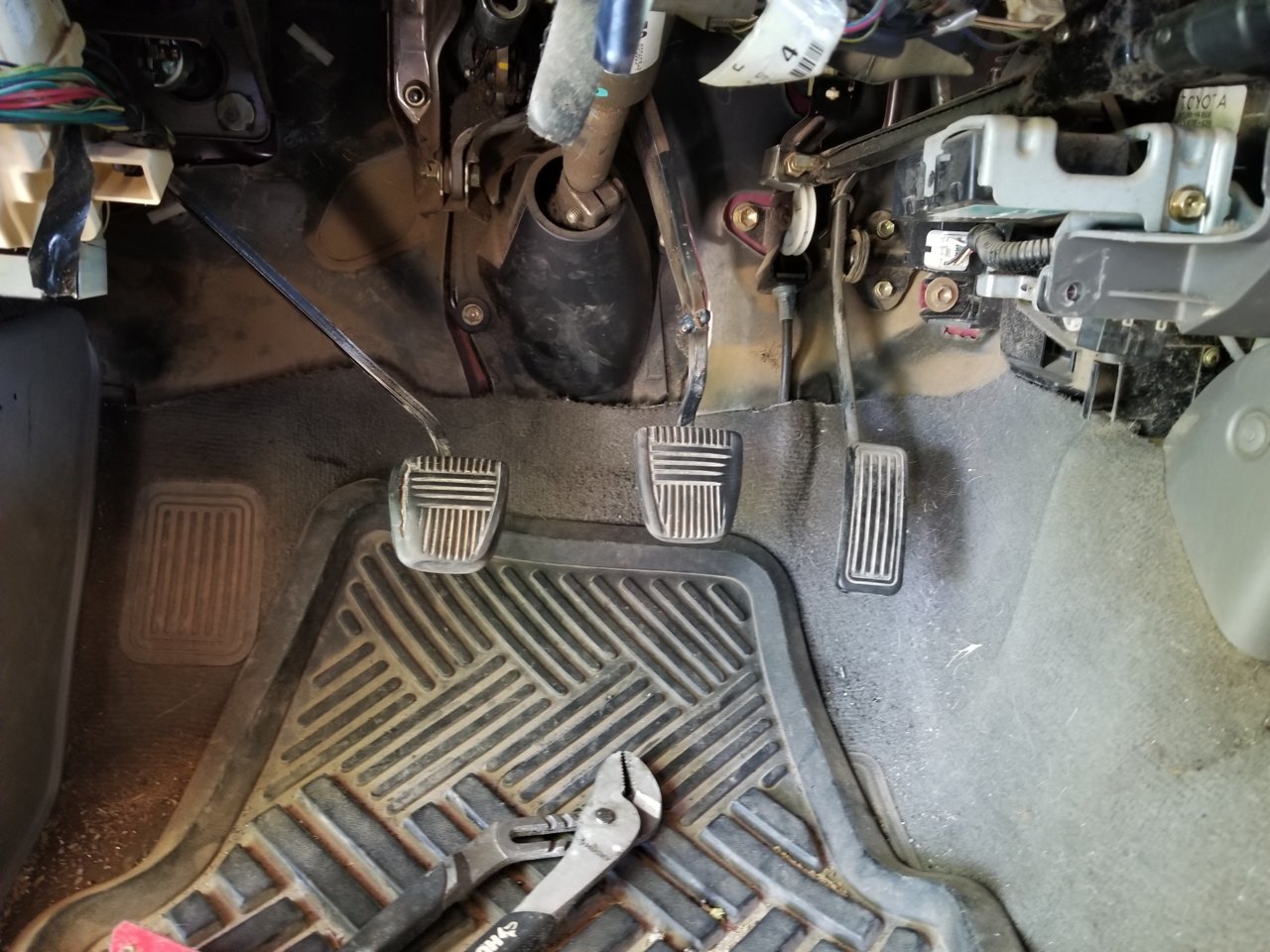

    Trans, t care and x member bolted up. I'm waiting on the 3 long bell housing and 1 long starter bolt. I'm going to work on the clutch lines and brake pedal next, then on to the electrical. At this point I have 8hrs into the swap of actual wrench time ( after hundreds of hours of research on the interweb). I need to take the rear shaft to get shortened and balanced this week but living in the sticks its 100 miles one way from me. I think the only parts I'm missing are the vss and a donor pig tail. I have a manual brake pedal but it's from a older truck so it won't work without modification. Older trucks have a different master cylinder w/ short rod no linkage.

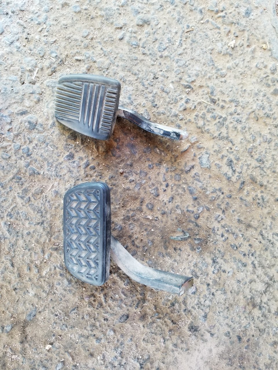

    I chopped up the doner pedal, took the sawzall to mine and fired up the welder. I also burned a small washer under the dash so I can use a brake return spring instead of the torsion spring it had stock

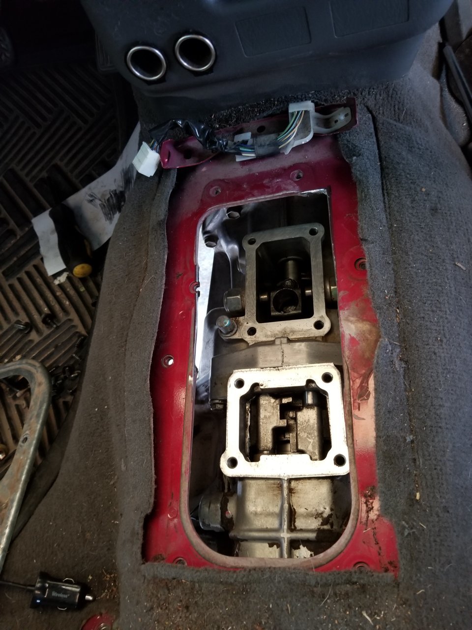

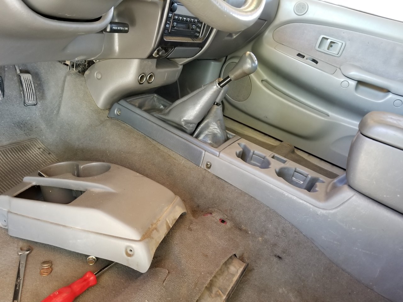

    Got the shift boot mounted

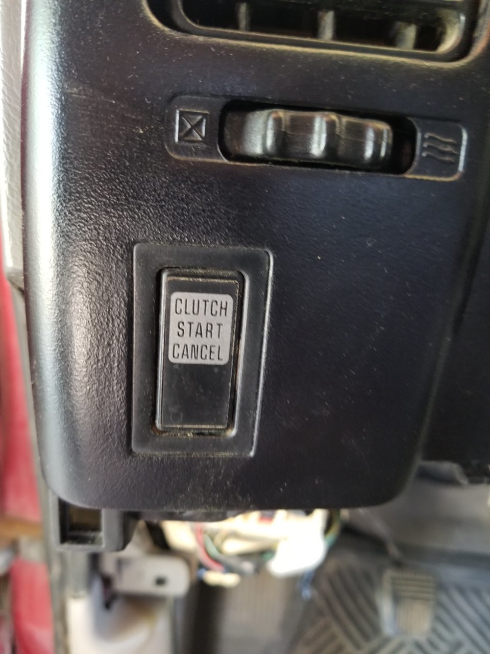

    Swap the ect button for a csc button. I may try to connect it at some point

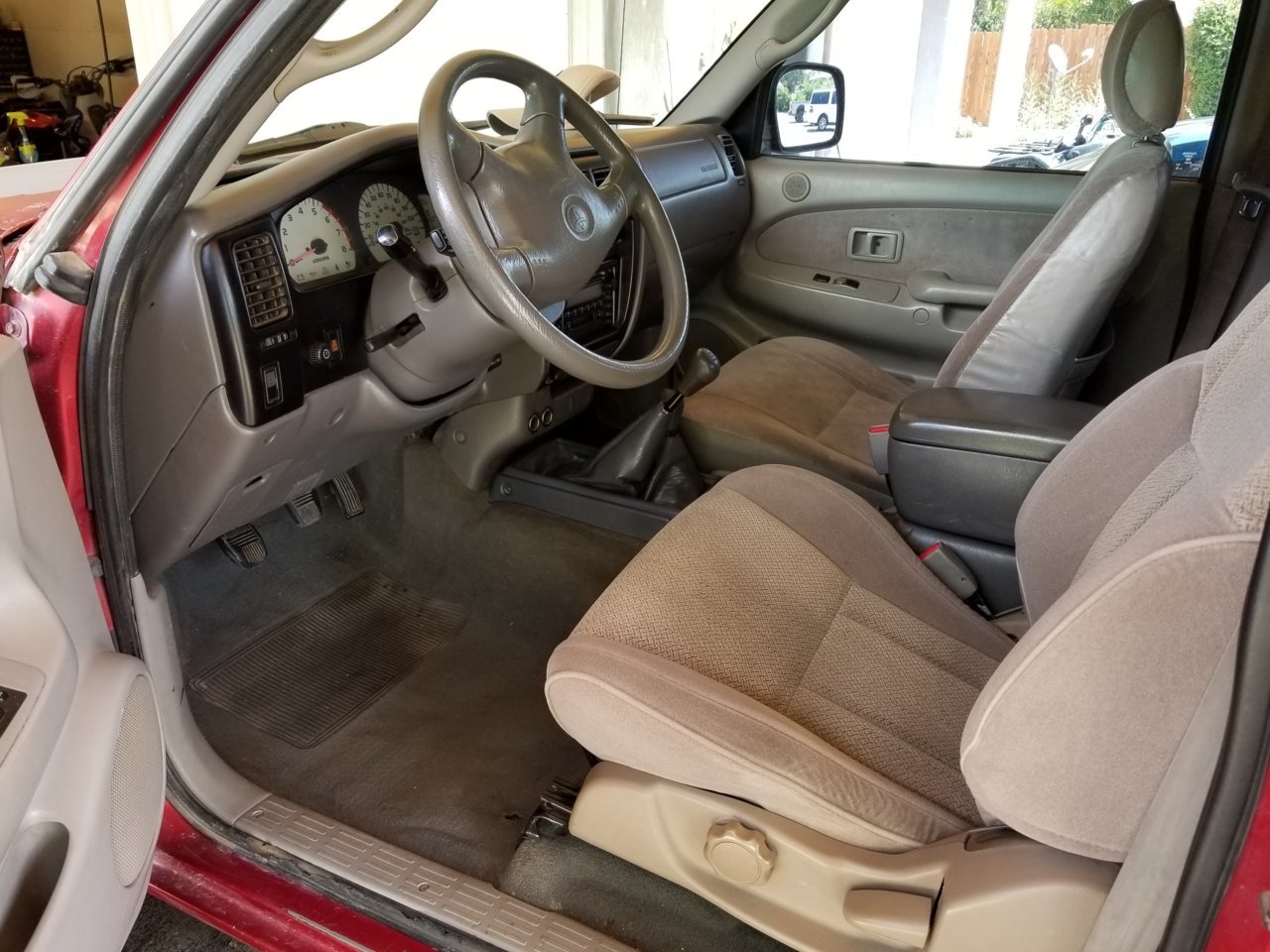

    Cup holder delete mod. Interior back together. Looked like the po had 17 dogs in this truck all at the same time. I pulled to seats for more space and I could make a sweater with all the hair, nasty. I was surprised the shift bit trim from my 95 fit the 03 center console. It's a different color grey but I don't really care. My truck isnt going to win any beauty contest anyway.

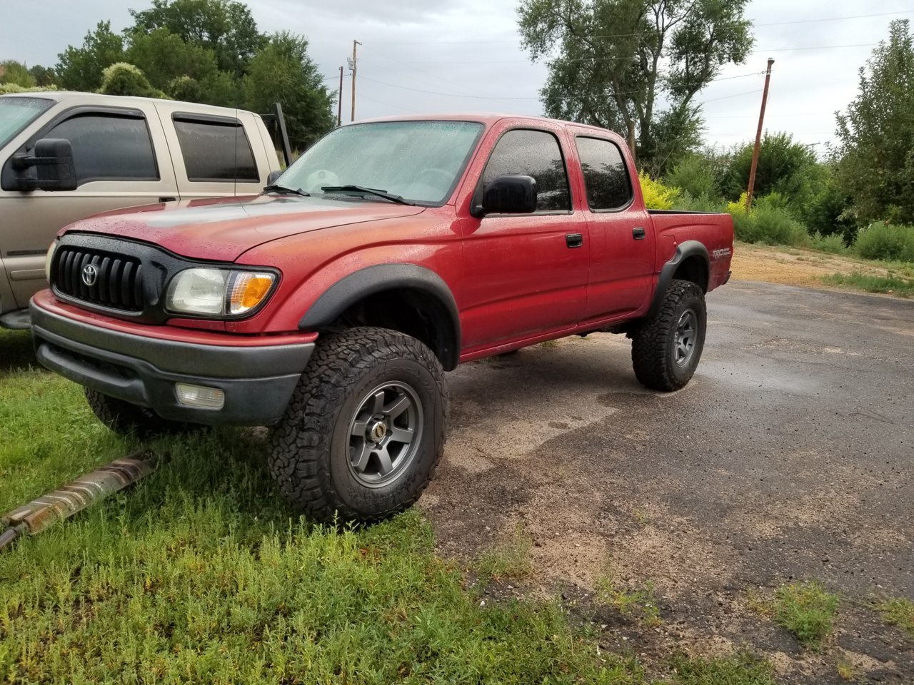

    Derped bumpers to match wheels, used duplicolor graphite. Looks very close to poverty spec tacoma bumper color. Also finished debadge

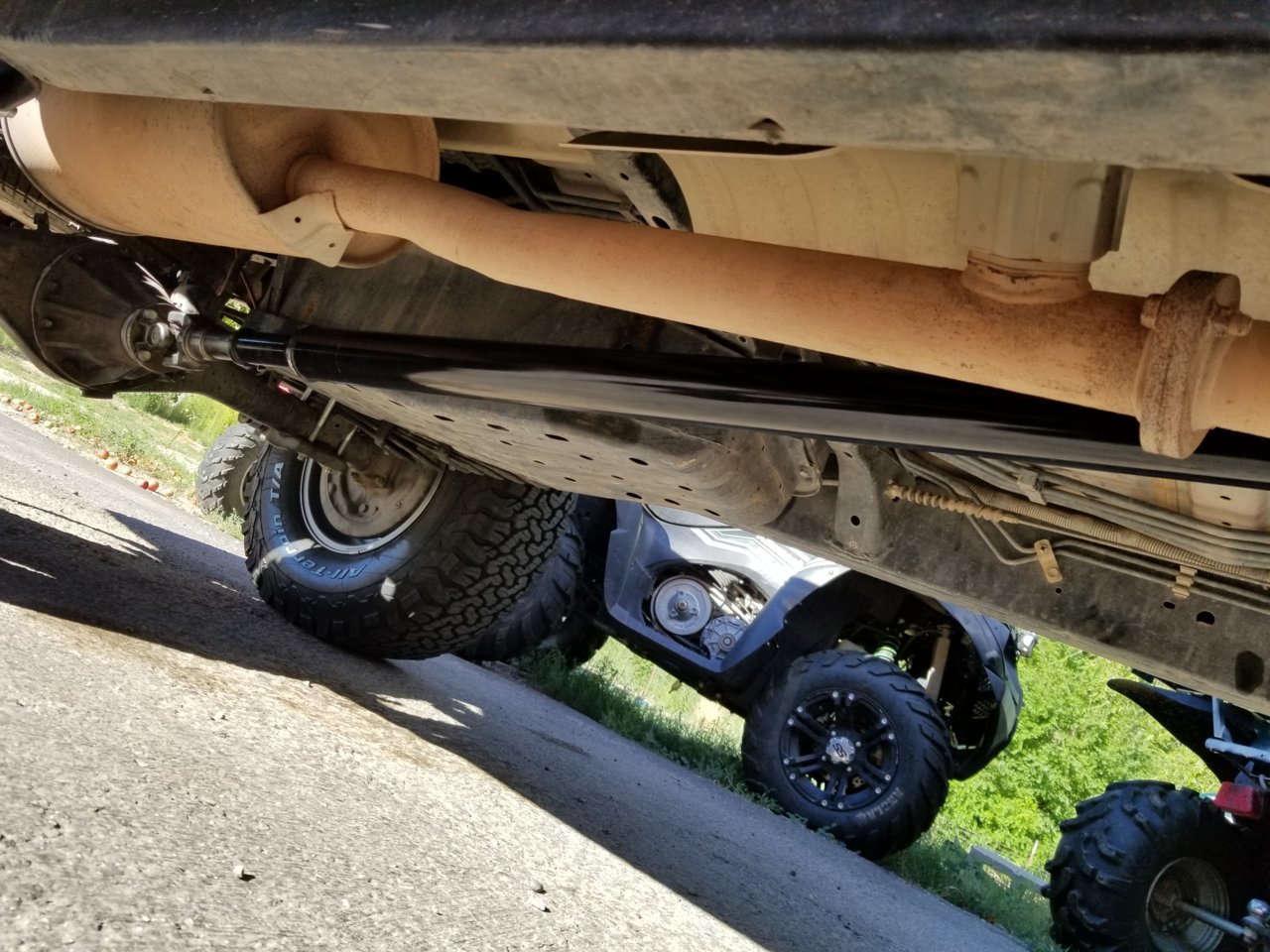

    Got my driveshaft back. Installed it and drive around. I converted the shaft to a 1 piece. Dumped the carrier bearing and double carden. No vibes , not sure how fast I was going( I'm guessing about 75, 2750rpm, 285s w/4.56s) I still need to find a vss and a pigtail

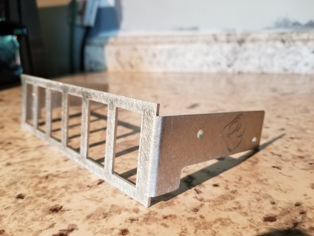

    ] paranoid switch panel
