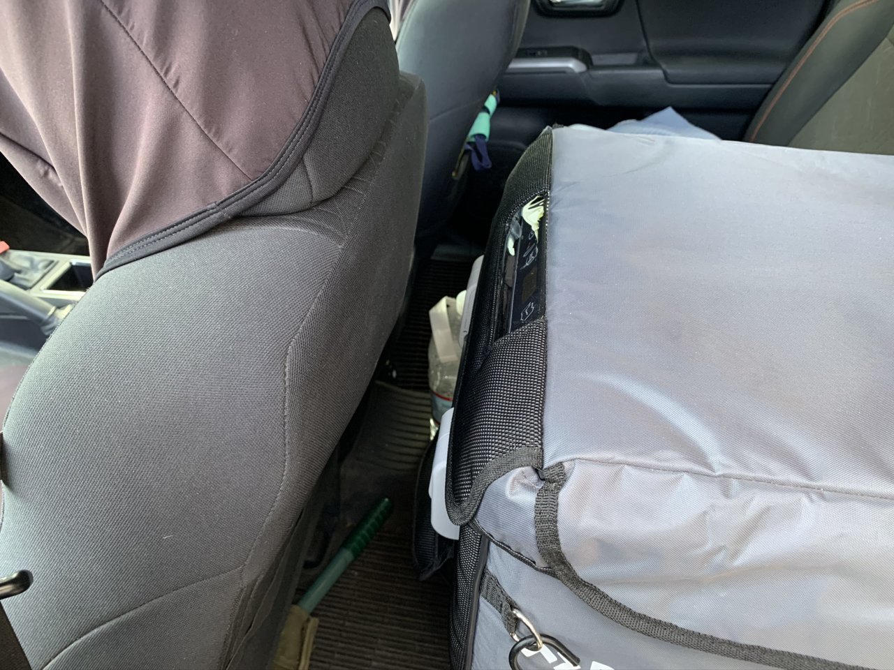

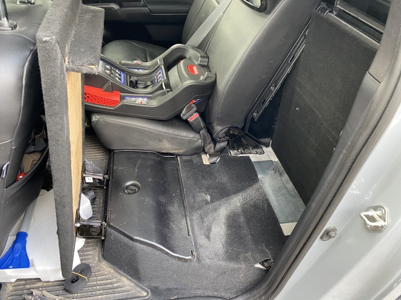

    I just installed my CFX35 which is about 1.5” shorter than a 50, on a platform similar to the OP’s. I have the panel behind the seat with the plastic storage bin in place, and a recovery gear bag in the bin, but enough clearance so that with the rear seat in, the seatback closes and latches. With the seat out and my fridge platform in place, and the fridge slid all the way back, I can push the driver’s seat all the way back and recline it 4 notches. I normally drive with the seat 2-3 notches off upright. So if you remove the rear wall panel and keep nothing back there, your CFX50 will be tight but should fit. This is on TRD OR ... not sure if other models have thicker or thinner seats or other slight variables.

    Perfect! Very helpful and now I and confident it will be worth tackling this. Will miss the behind the seat storage for tow strap, arb tire kit, and fire extinguisher but I’m sure I’ll find another way.

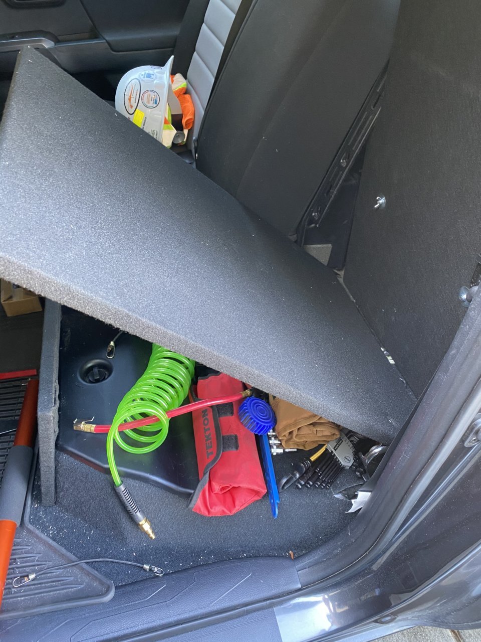

    I like what you did here. I am waiting for my fridge to arrive to see if I want to mount the platform as low as possible as you did or use the seat mounts like the OP. Do you have a recommendation?
    How did you secure that bottom platform piece? Was 3/4“ material used for both upper and lower pieces?

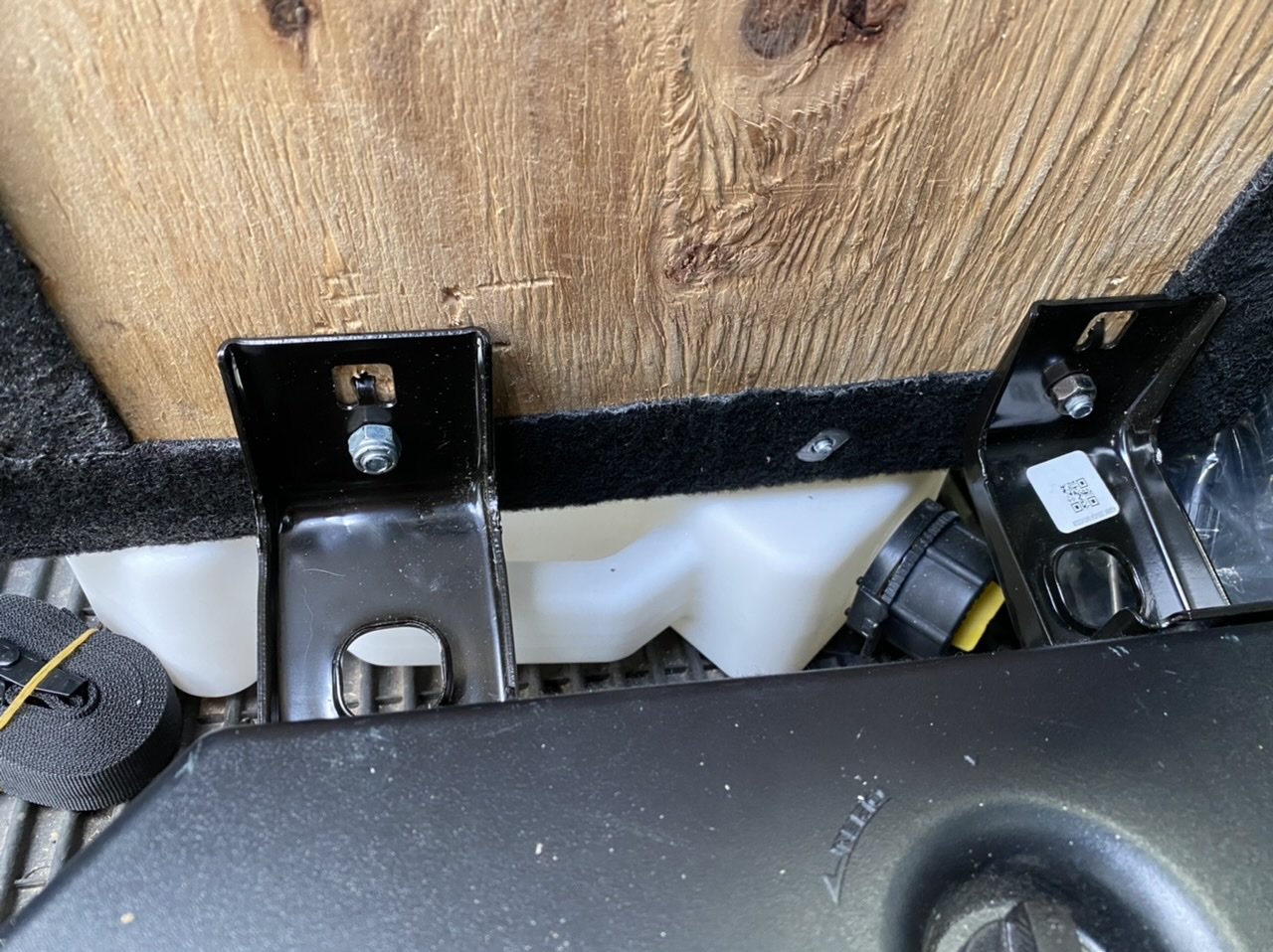

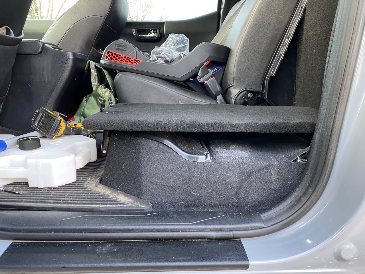

    I haven’t posted a picture of what I did, but I decided to just mount on top of the rear seat hinges to get the support. I used a pretty thin (3/16”) piece of MDF which seems adequately strong, though it’s only been a week or so, and I haven’t fully loaded the fridge nor gone off road. If the platform seems too weak in bending, I will reinforce it with a few ribs of additional 1/4” wood or even a few metal strips. Note that the CFX has little feet so the load is distributed front and rear near where the platform is supported, so the platform doesn’t need a lot of beam (bending) stiffness.
    At the front, I used a piece of 1/2” ply that’s bolted to the vertical wall that the seat cushion hinges attach to ... I counter-bored the plywood so I could reuse the seat mounting bolts, otherwise they’d have been too short. Although I could open the fridge lid wider if I moved the platform down, I like having the space under it for storing stuff that is still easy to pull out the side. And, I can even manage to open the lid on the underseat cubby and reach stuff there too. Thanks again to the OP for sharing a simple effective solution that doesn’t require cabinet maker skills!

    I like both ways, but I built my platform prior to my fridge, and my cooler lid wouldn't open unless I mounted it as low as I did. I also like how easy it is to get stuff in and out, and the fiance is vertically challenged, so she likes it. The front is mounted with some L-brackets and eye bolts, using the factory seat mounting locations. This mounting method is something I saw from another member here in another thread, so I can't take credit for it. The board (1/2in plywood I think) just rests along the floor board and is not secured in the back. There is no bending or flexing due to the multiple contact points. Also, I elected to remove my cubby compartment door from the floor on that side. This help it stay as flat as possible. I only strap down the front of the fridge with two straps, to the eye bolts as shown previously, and I've never had a problem with it moving. I wrapped my plywood in automotive carpet found at any auto parts store for $10.
    I too was worried about weight, but overall it wasn't that big of a deal for me. I took an effort to place my water and heavier items in my bed closer to the passenger side.

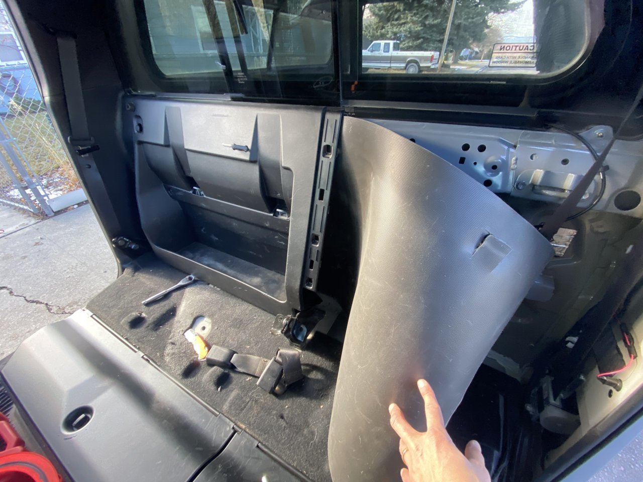

    I will steal your ideas about removing the cubby plastic. If you want to go low as possible that seems like the best way. Looking at your mounting, I wonder if there is a style of hinge which would along the platform to be secured with the factory bolts like yours but would allow the rear of the platform to hinge towards the drivers seat. Just thinking when I’m not carrying the fridge, I could still easily access the cubby space. If anyone thinks this hinge exists please let me know.

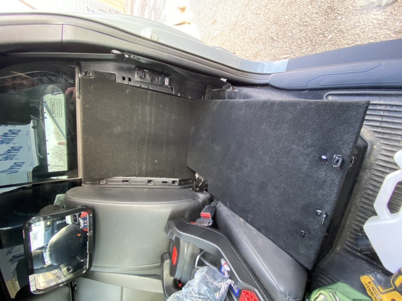

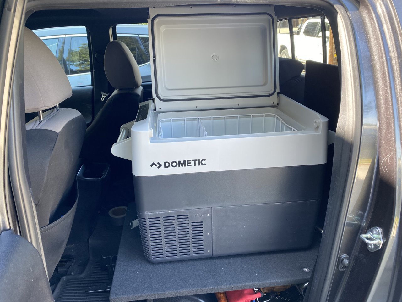

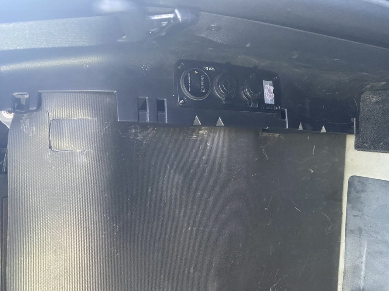

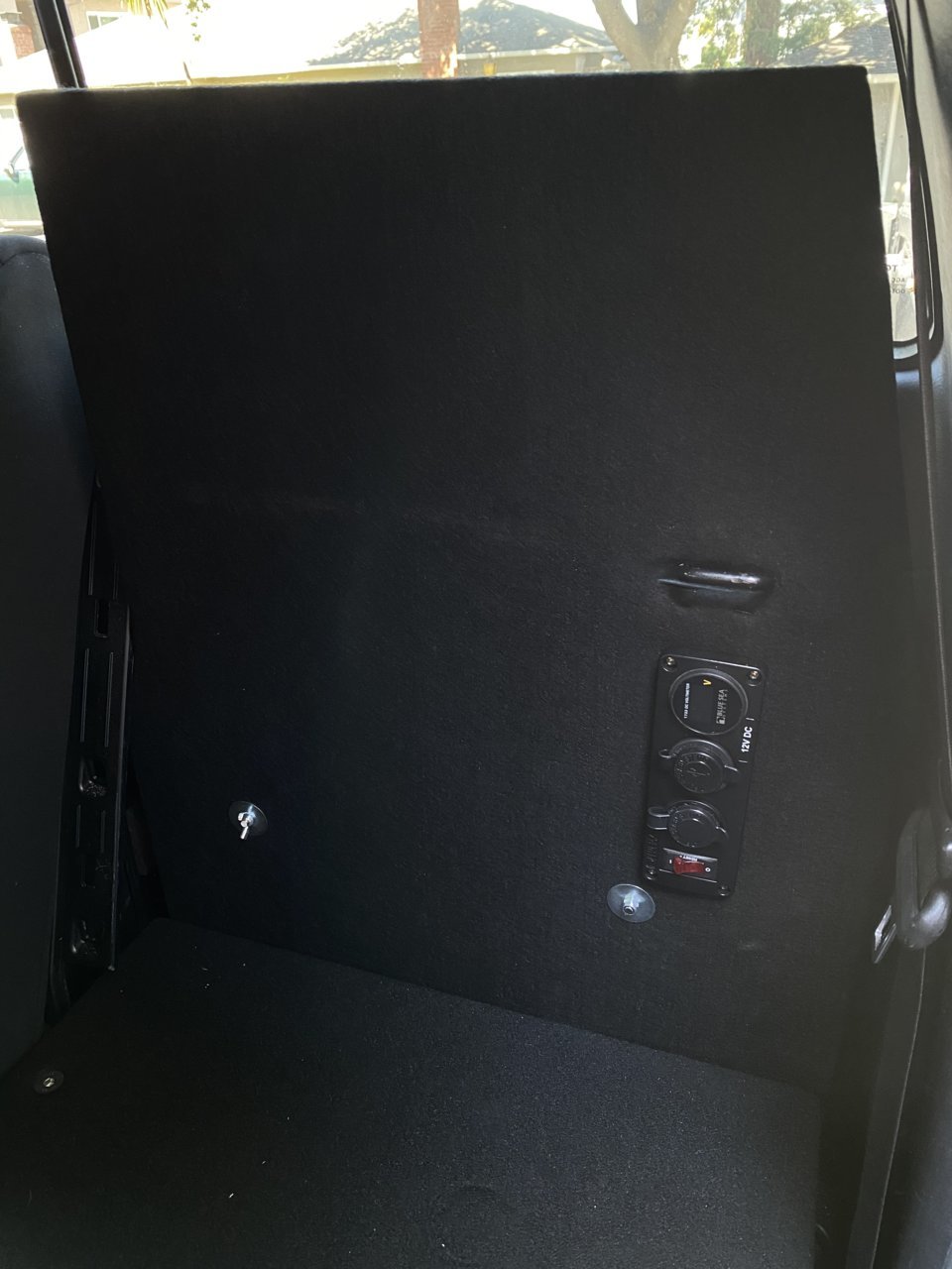

    Finally finish up my setup. Thanks everyone for the inspiration! I wouldn’t have even bought a fridge if I didn’t come across this thread but needed one to store breast milk for an upcoming 3 week road trip.
    CFX 50 with plastics removed. CCD sound deadening tiles installed on back wall then Second skin Luxury Liner.
    3/4” plywood for base and 1/2” plywood for back wall wrapped in the marine carpet posted earlier in thread.
    So happy with how this turned out. Still have enough room under the platform to slip in the arb tire kit, extra cloths and gloves.

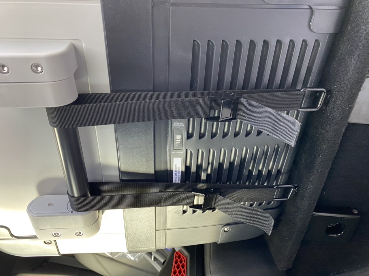

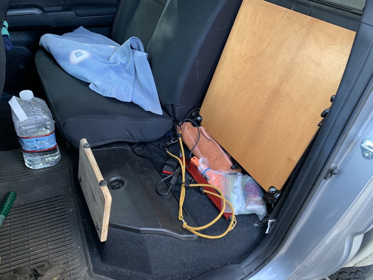

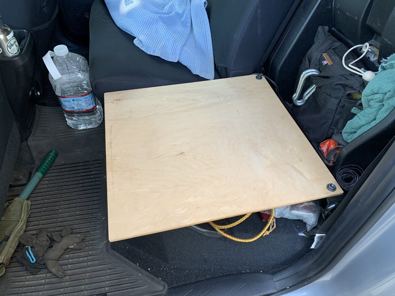

    Here are some pictures of the quick and dirty install I did based on inspiration from this thread. Just stuff I had lying around, no hinges (except the existing seatback hinge) or carpet. Fridge is a CFX 35. The front seat is in my usual position at about 5’10”. As you may be able to see in the first photo, I added a small bungee loop over the grab handle to hold the lid open. Not enough clearance to pull out the fridge basket but good access otherwise. The bungee just hooks over one of the lid latch tabs.606047A8-C8C8-4510-AF80-E3F7CB5C582B.jpg 411E1F63-7A41-4797-A915-0BE452D8881B.jpg 679ACB08-579A-4595-9CFB-5554C89017FC.jpg 8C7ECF5D-051C-416D-BE02-950B80740915.jpg

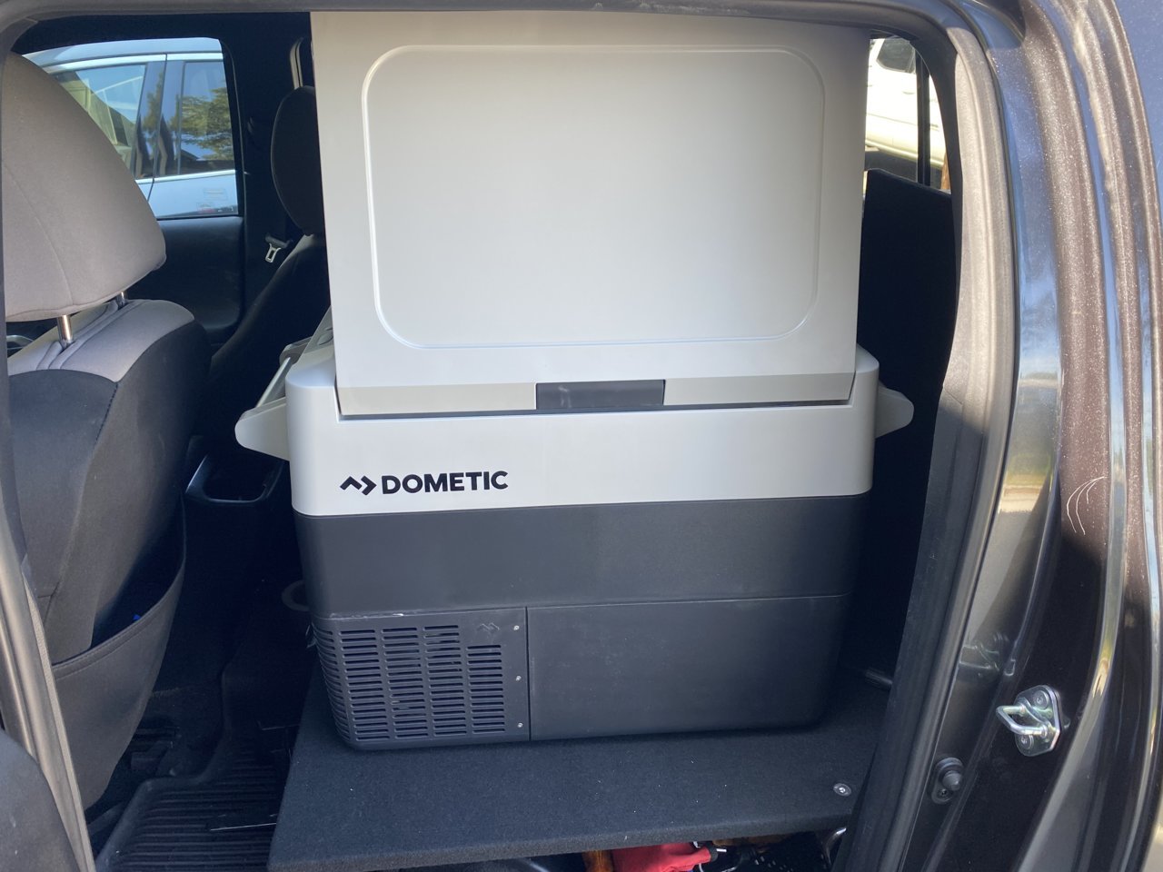

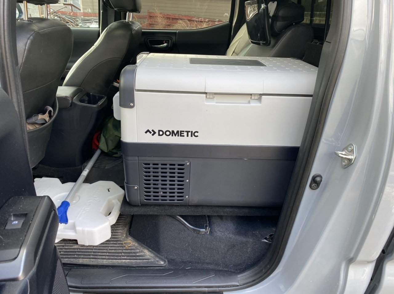

    Got inspired by this thread and threw this together last weekend. Lots of storage space underneath the platform. I have the CFF45 and it fits perfectly
