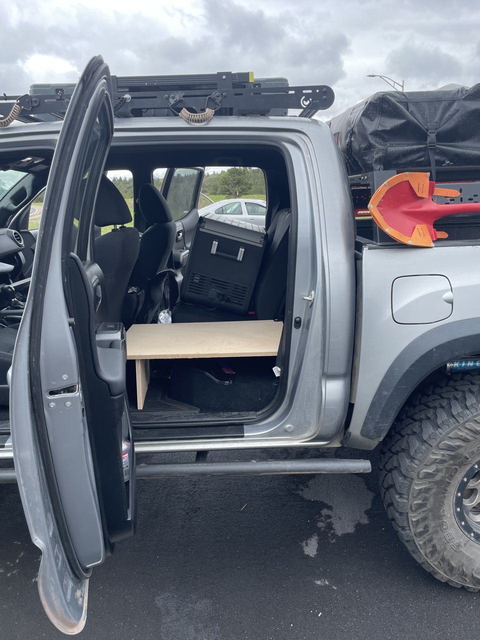

    Prinsu Cab and Top Rack VO Drifter LED Interior, License Plate, and Reverse Lights Huskyliner Weather Beater floor mats Salex Center Console Organizers 35% Front/15% Rear Tint Debadged and De-stickered Anytime Front and Rear Cameras Brute force front bumper BAMF HC Dual swing out 285/75r17 BFG KO2 Front: ADS 2.5, EXT, RR, Clickers Rear: OME Dakar HD, ADS 2.5, EXT, RR, Clickers Stainless steel brake lines (+4 in rear) Wheeler's Offroad Superbumps Front and Rear Wheeler's Offroad U-bolt flip ECGS CV Axle Bushing SCS Stealth 6 17x8.5 wheels, matte dark bronze

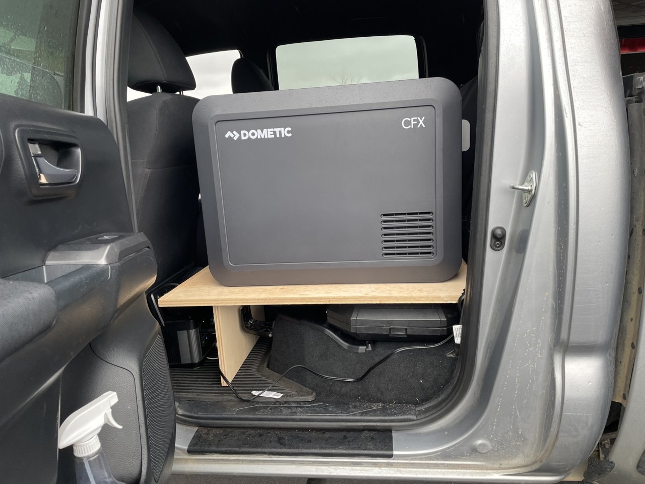

    Reviving this old thread because it helped inspire my platform. Kinda shitty pics but I took the path of mounting the bottom plywood to the forward seat brackets, and removing the plastics to replace with plywood. I used 3/4” plywood all around, but it basically rests on the floor so I’m confident it could be 1/2” plywood if needed. Roughly 20” wide for the bottom with some notches to clear the back rear brackets. I did it out of a 48” long piece of plywood which worked fine. The bottom piece is about 26” long but doesn’t quite reach the back piece, but it’s long enough to fully support the fridge. I sprayed bed liner on it instead of carpeting and attached foam sound deadened on the back rest piece.
    I’m so happy with this little project. We have had our fridge on the back of our folded down seat for years and it’s kept us from being able to position the driver seat ideally and from being able to fully open the fridge. I can’t believe this took me so long to do!
    Here's how it was positioned before for reference. It's a CFX55.

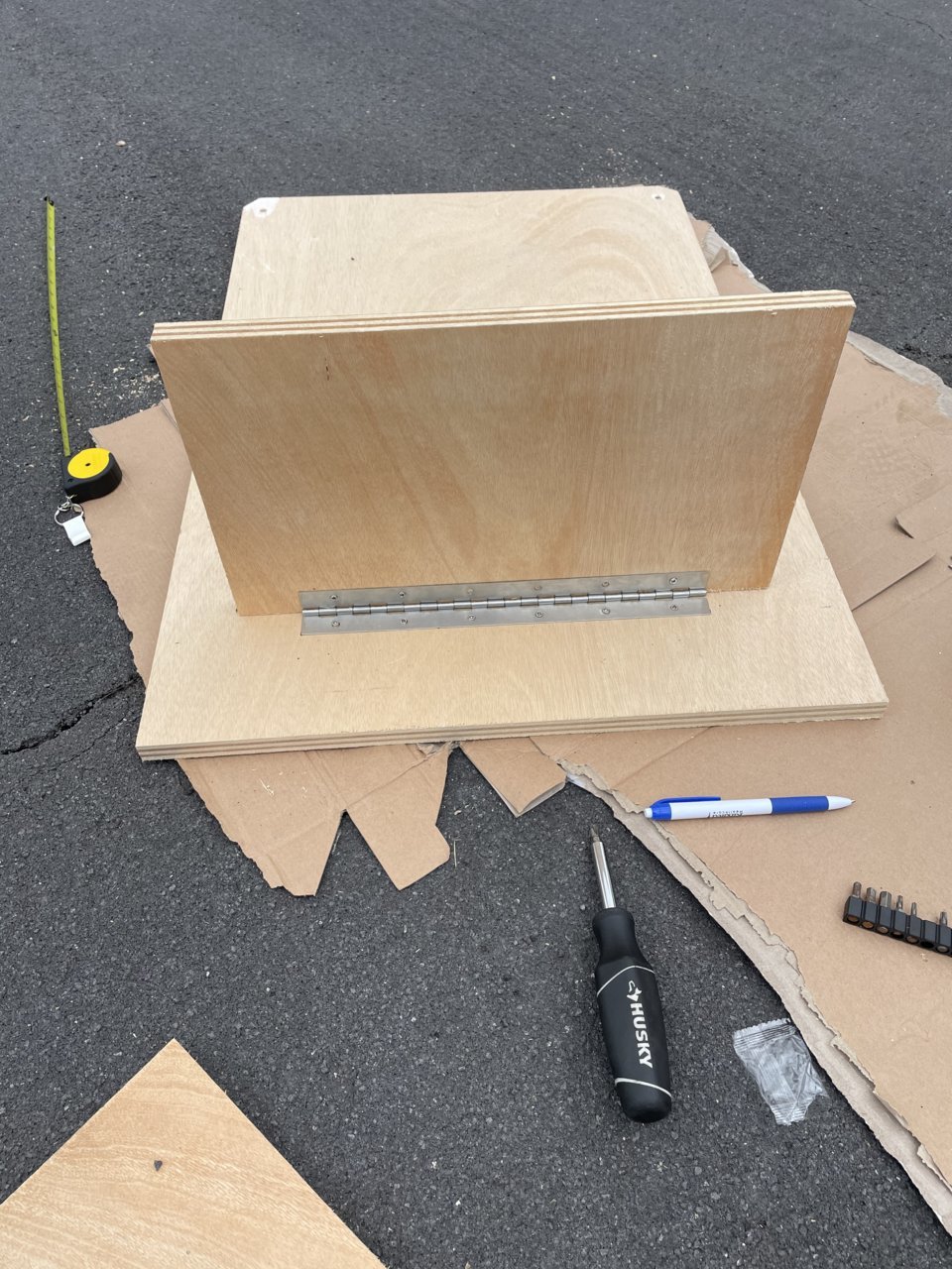

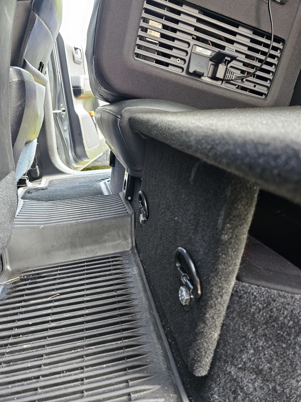

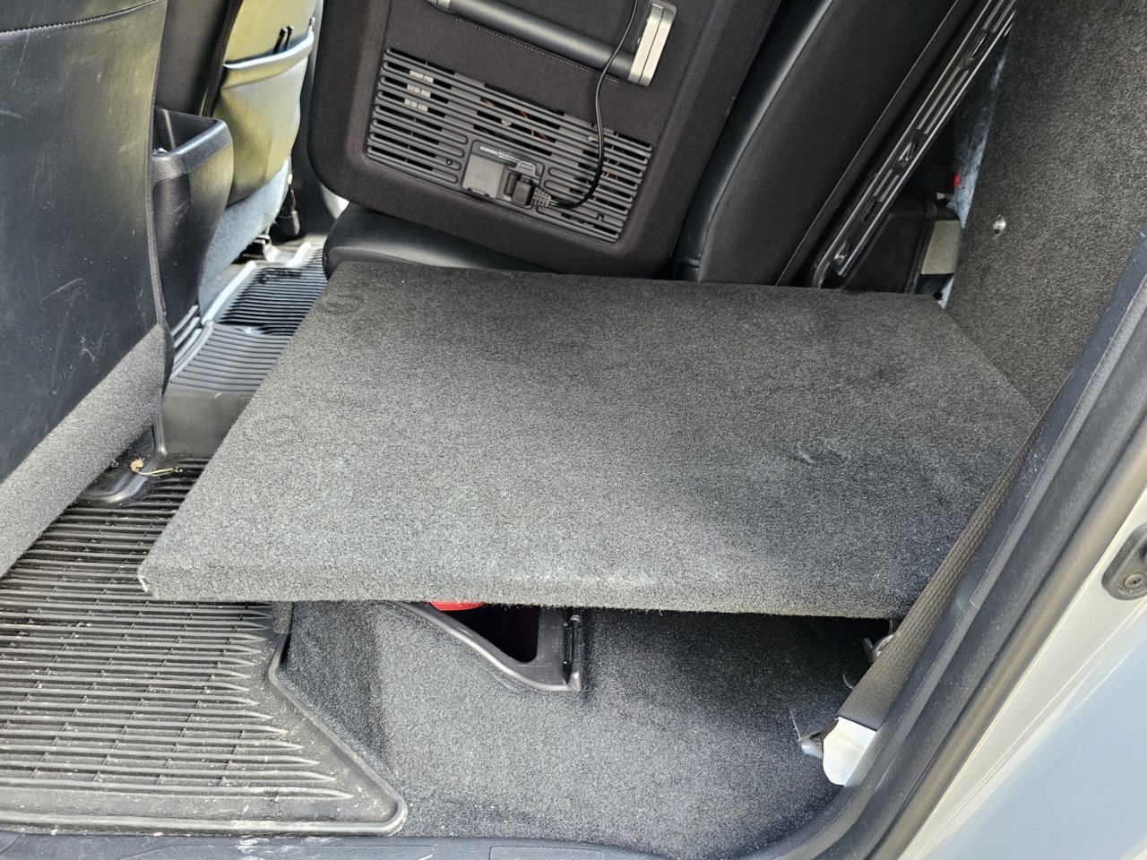

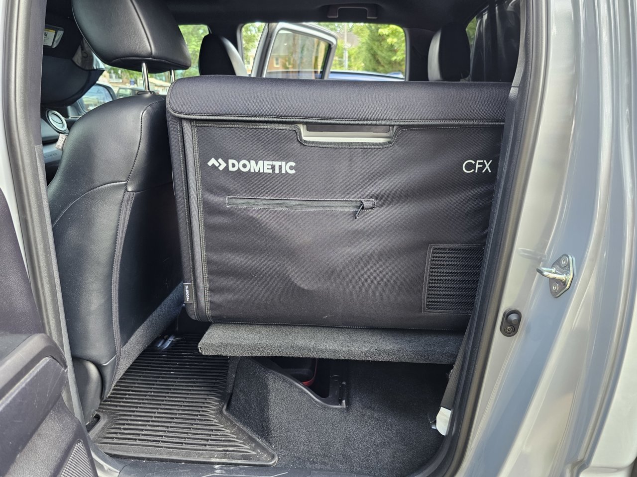

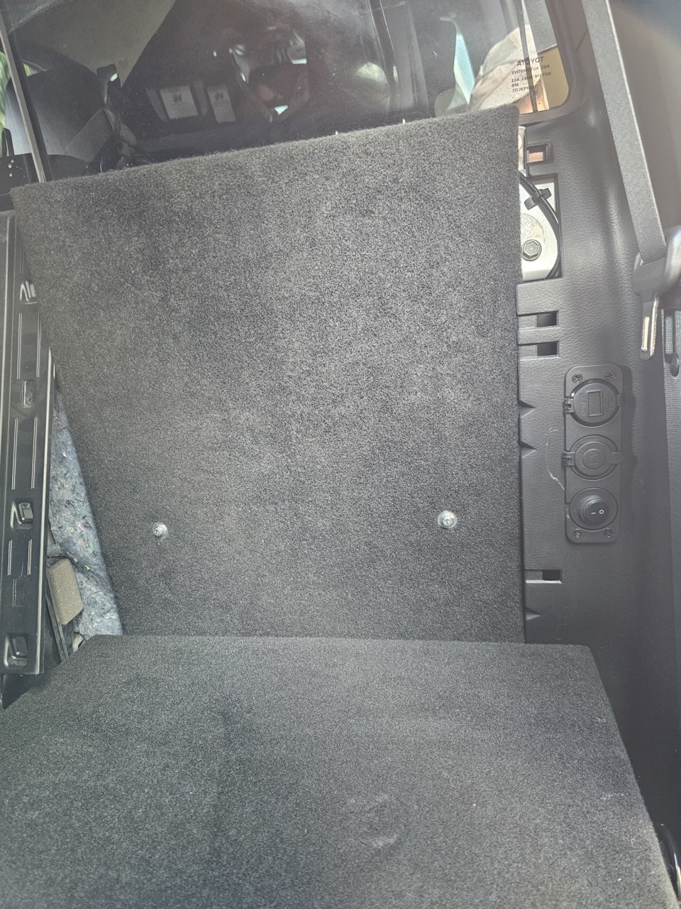

    Funny enough I did this project yesterday and took a lot of inspiration from this thread. I opted to use the hinges for the platform thinking that I'd use the space underneath for storage, but I kinda don't like the fact that I can't open the lid all the way......idk what to do now.:annoyed:
    Separate question, will the cooler be okay with the vents faced back or do they really need lot of free space?
    20230704_164002.jpg 20230704_164252.jpg 20230704_164301.jpg 20230704_164256.jpg

    Nice build! You could flip your fridge around and reverse your lid. Then your vents would be at the front.
