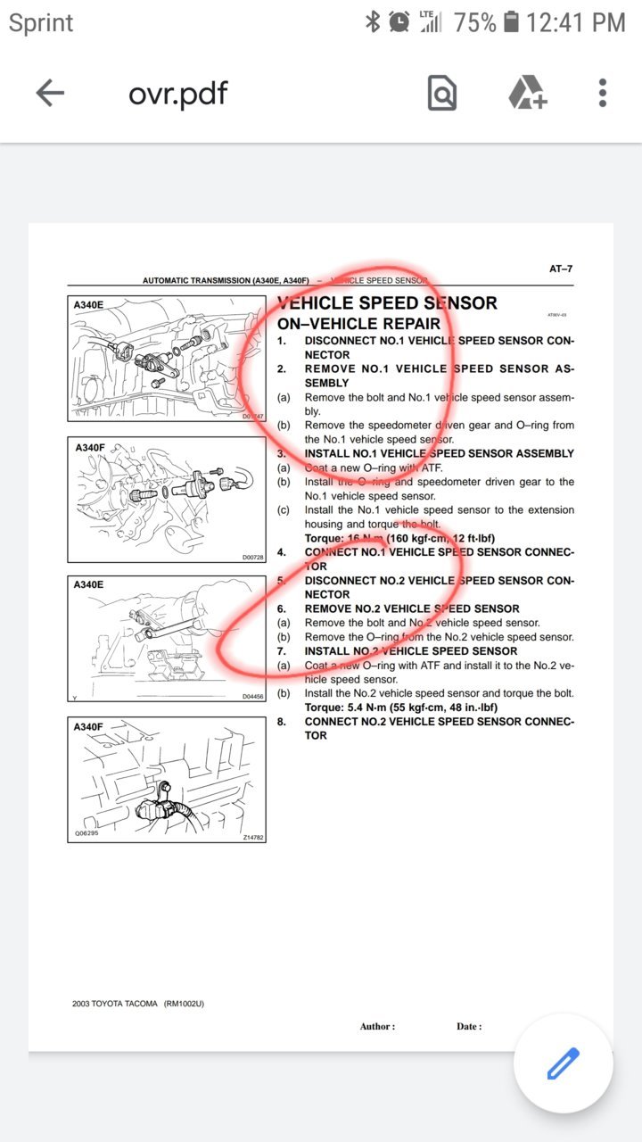

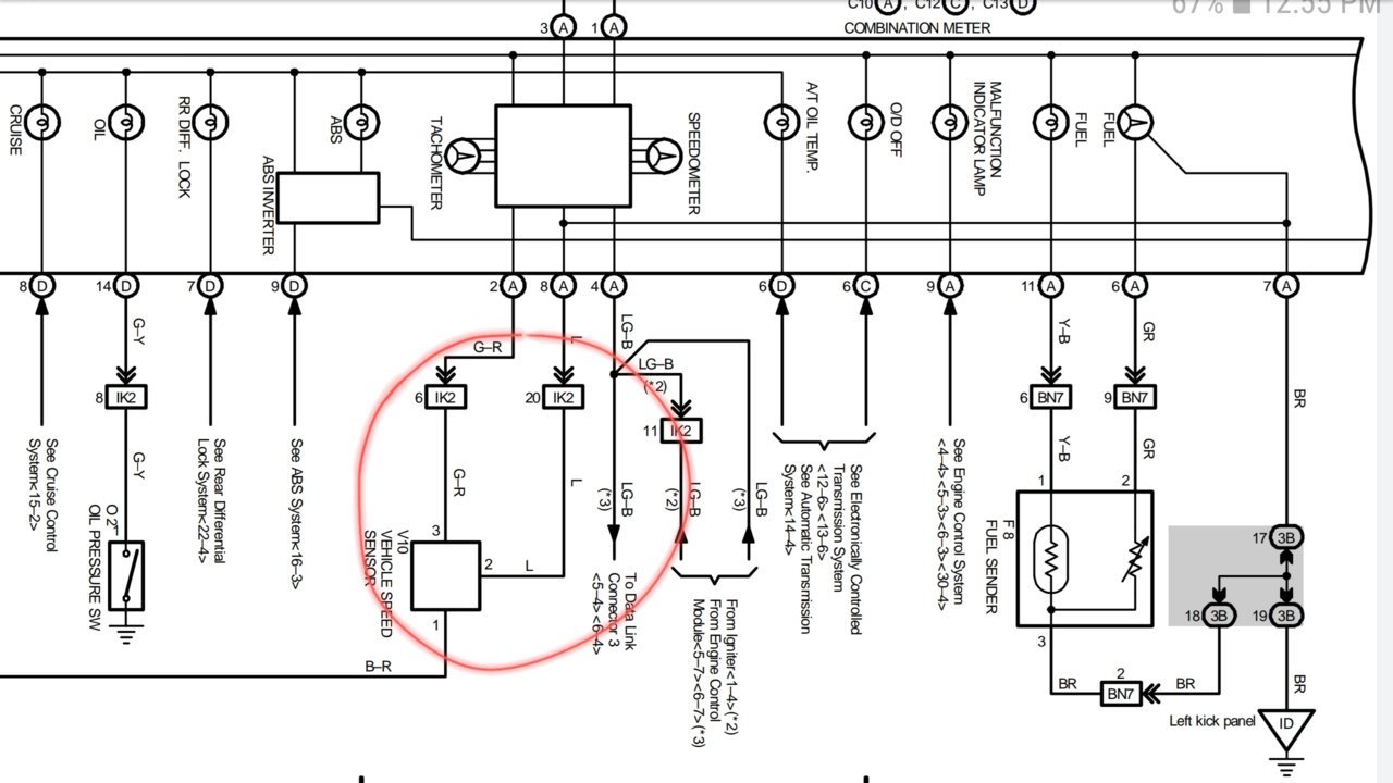

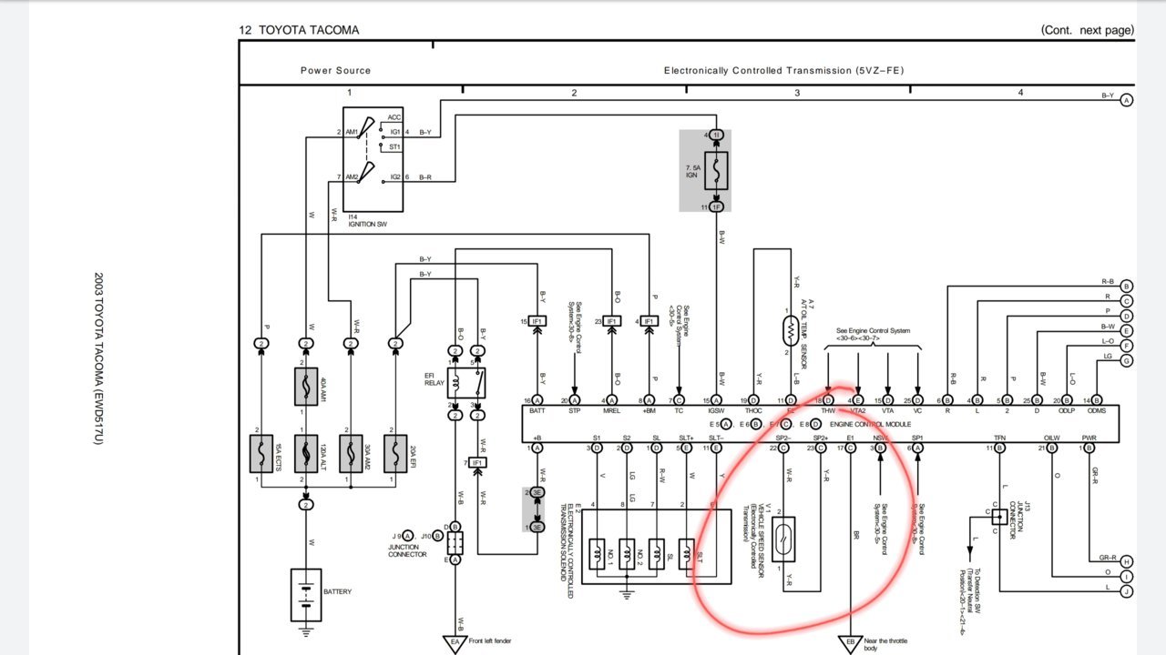

    Tell me what are you going to do with this second speed sensor on the automatic
    trans?
    Here's the normal one for the speedometer.
    Here the manual talks about both of them.
  16. Oct 16, 2019 at 1:44 PM
    #36
    TMFF
    TMFF Well-Known Member
    Dec 7, 2011
    #68368
    2,587
    Tim
    Thornton, CO
    01/02 DCLB
    Stuff and junk and things...
    Nothing, that's a shaft speed sensor for the trans to operate and shift properly. AFAIK it has nothing to do with the VSS that is on the Tcase that is what the speedo uses. I haven't seen or researched how that can cause a CEL.
