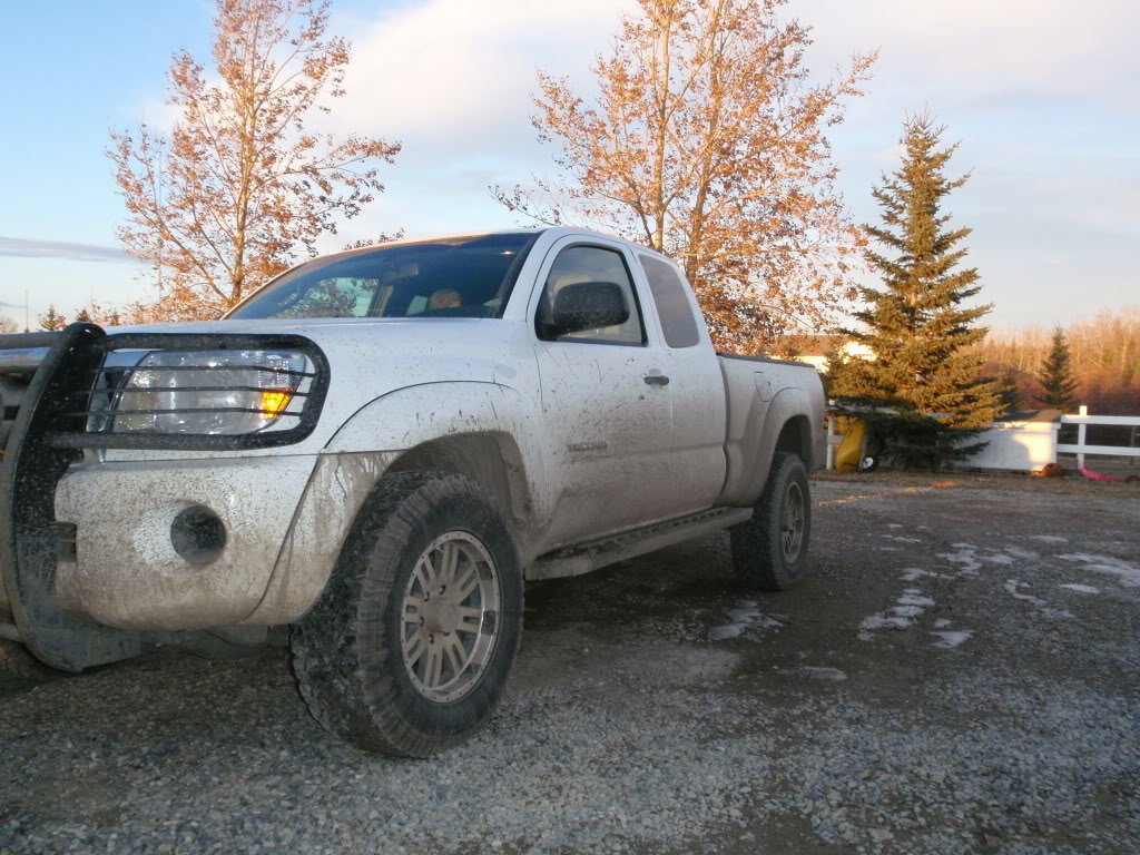

    Yes they will work.
    You have to move the rear mounting point forward (there are pre-existing holes in the metal tracks) and they will line up with the mounts in the body.
    I have done it before, running boards off a 2006 onto a 2009.
    Just make sure that there is the open holes between the second and third mounting brackets.
    not the best picture, but doublecab running boards on an access cab.
