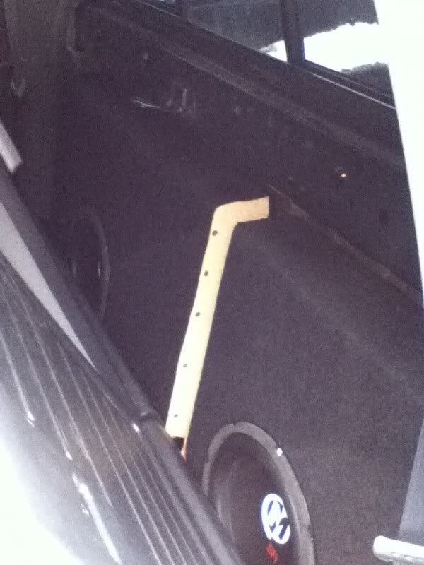

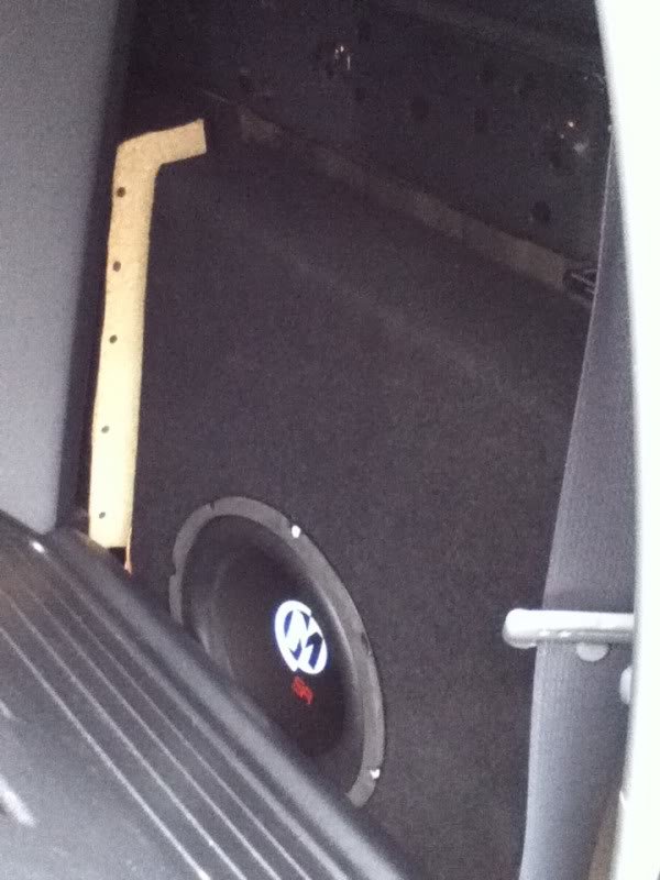

    I know there is one just over everyone's setup which has a few double cabs in it but here is mine.

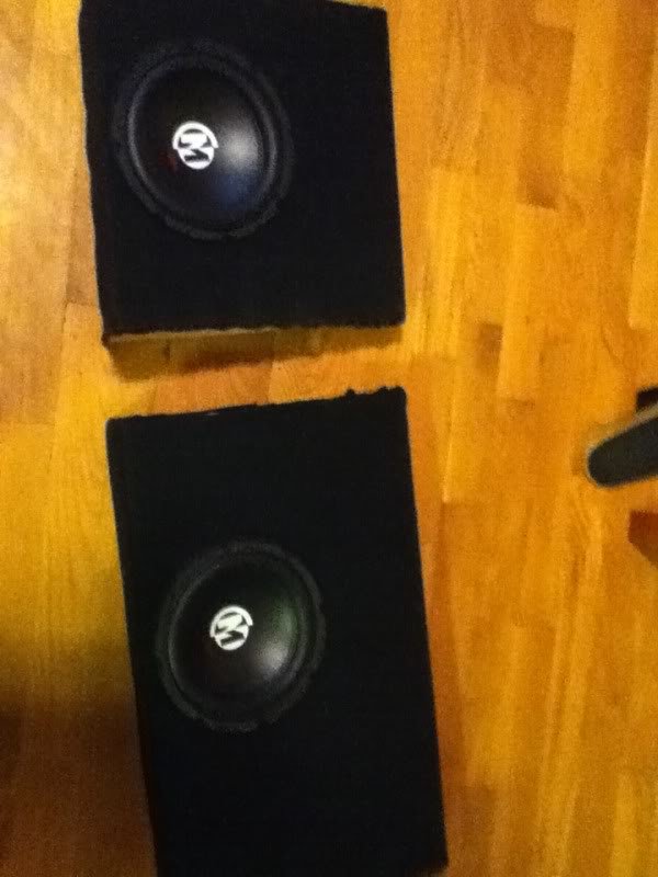

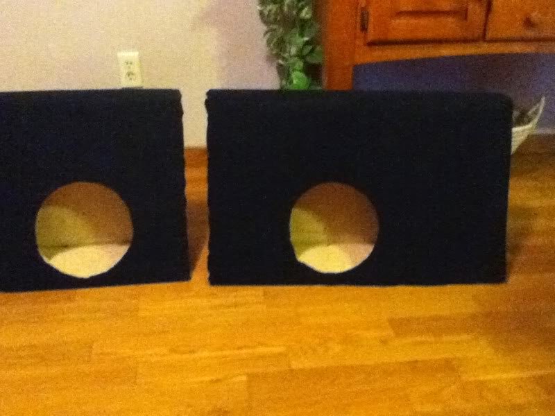

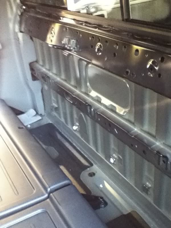

    Did mine fairly easy, just make sure you measure twice and cut once. Make sure you make enough clearance in the back to clear the beam across the back of the cab and make sure you separate them into two boxes do to the bracket that holds the seat down to the bottom of the cab (found out the hard way).
    Other than that 25 dollars and a couple hours and you have yourself a box.
