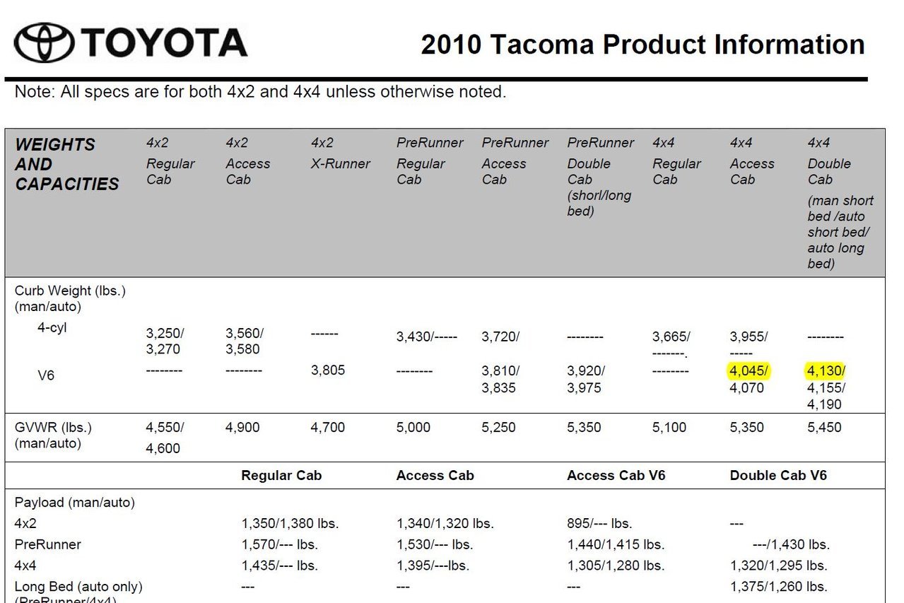

    I found some info online and a spec sheet says my truck weights in at 4130lbs and his at 4045lbs. My fat ass probably has 50lbs on him so my truck probably weights 135lbs more with me in it. He tends to carry tools and crap behind the seat and both beds were empty when I drove them. I have never replaced the coil packs. Ill have to ask him if he has.

    Here's the spec sheet for the 2010 Tacoma, I am sure its similar enough to a 2005 for the sake of conversation.

    Access Cab is heavy for its size because there is no fixed B-pillar. The roof and rear doors need to be reinforced to take seat belt loads, roof crush loads (rollovers), and side-impact loads. There's a bigger weight difference between 4x4 and PreRunner than between Access Cab and Double Cab.
