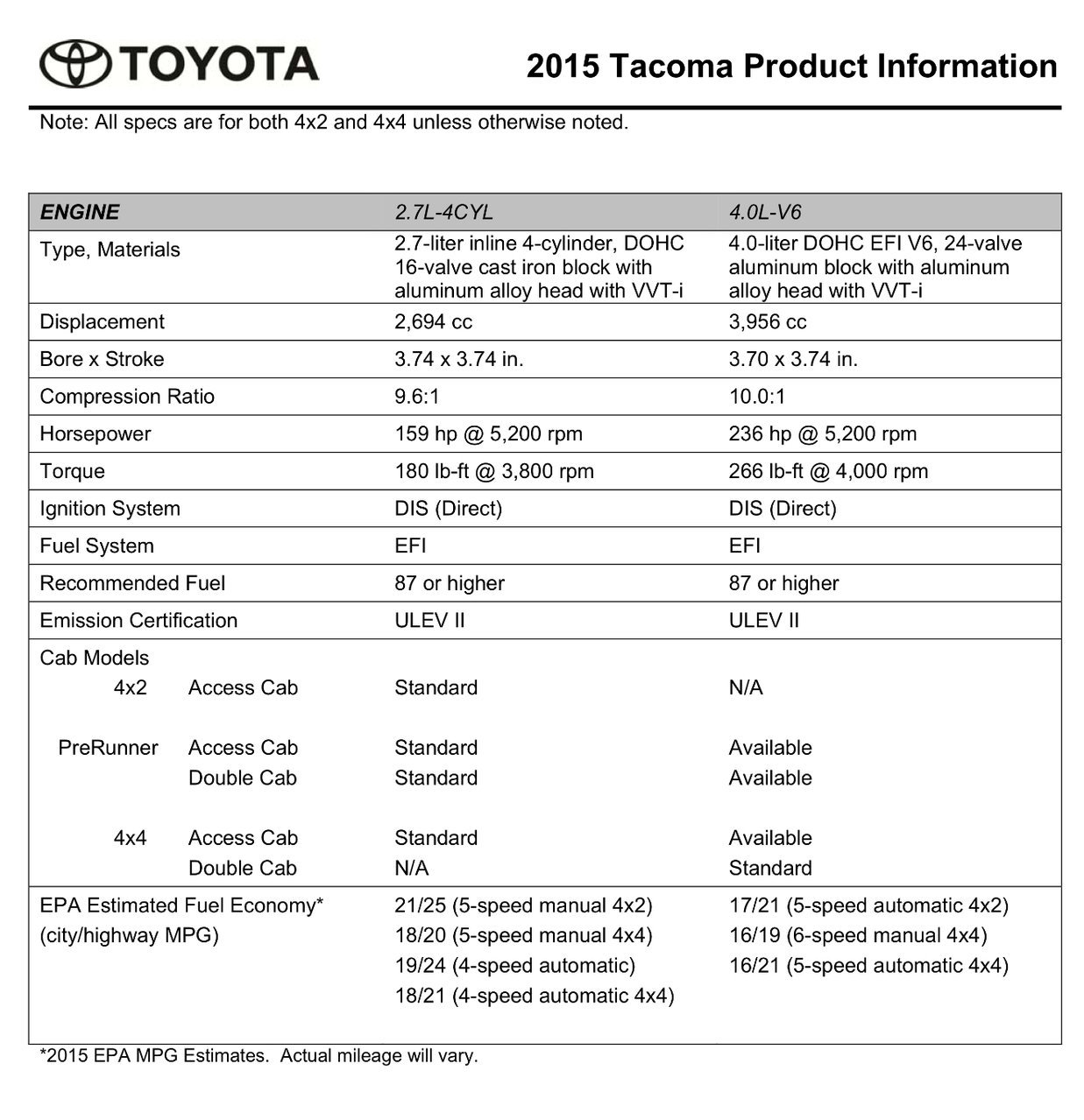

    Pretty sure the ecu adjusts based on knock or ping detection with lower octane fuel then retards the timing to compensate. If you run the lower octane usually then in practice, outside of a reset/battery disconnect of the ecu and running several tanks of higher octane....I think your timing would remain....slightly retarded. I’ve found that when I run premium for trips over 2 full tanks my mileage is also better by 1.2 mpg.

    Granted this is for the 2015 model year.
