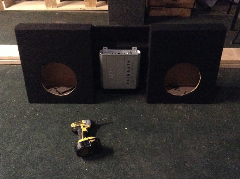

    You can buy boxes like this for around $150, or build one for about $45. Still let you use the anchors, and amp can be mounted in the middle.
