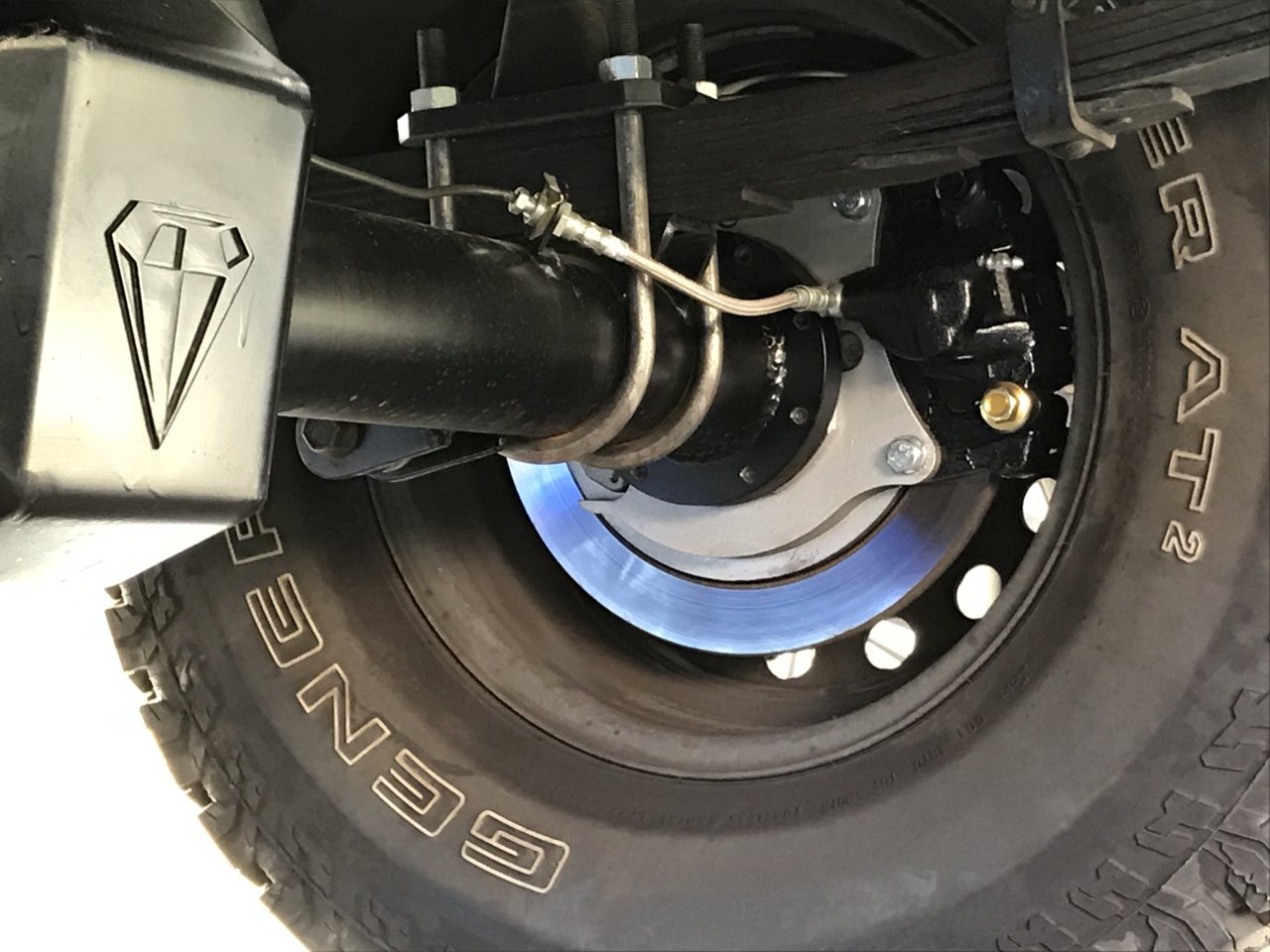

    I have a set of Deavers in the rear and I do not have shims. I have zero drive line vibes. I am a RC though... no carrier bearing to deal with.
    Here you can see the bottom of the leaf pack sitting flat on the axle perch:
