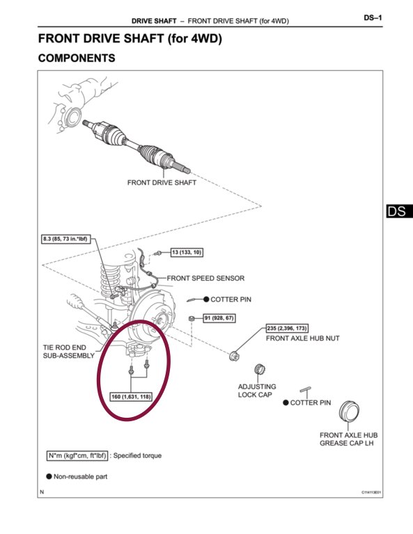

Double check a bolt for me, please.

    yes they are 19mm

    Yes they are. What diameter, pitch, and length?

    i dont have them in front of me. (i work 80 miles from my truck) but they arent fine threaded from what i remember...like at all

    If they have a 19mm head, they are not called 19mm bolts. They need to be really strong bolts. Not something you're likely to find at an auto parts store. Probably need to go to the dealer or Fastenal.

    M16x1.5 possibly. Length unknown.

    Ya, no way I'm trusting hardware store hardware for that job. To hold the abs clip, that's another story.

    Yes I stated in the OP that the bolt head was 19mm.
    Yessir. I've got four coming to the dealer Monday. Appreciate the information everyone!
