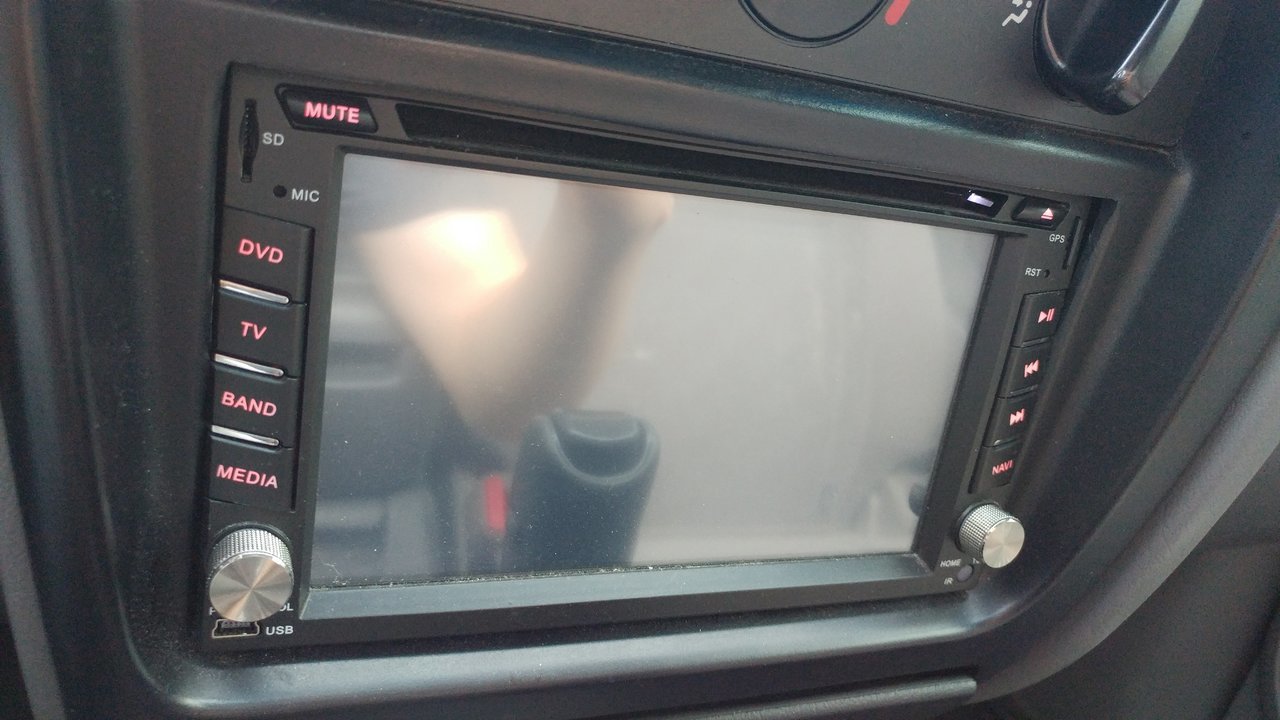

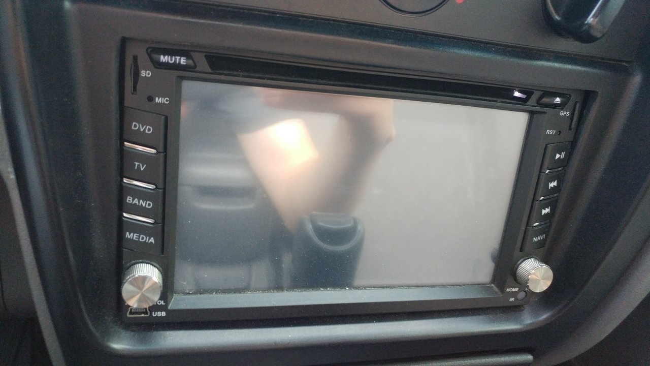

    Hello everyone, I am new to this forum and new to Tacomas, I just purchased my 04 xtracab a couple weeks ago as my first car and I am looking to install an aftermarket deck as the screen that is currently installed is not working. I am not sure if the screen is just burnt out or if there could be some issue with the wiring harness that is preventing the screen from turning on and radio from working. If anyone has any recommendations for a double-din deck that they have or know is good could you please let me know, Thanks! I have been looking into the pioneer AVH280BT and am planing to buy it soon. Bluetooth and auxiliary is definitely something I am looking for and preferably something with a monitor.
    http://www.pioneerelectronics.com/PUSA/Car/DVD+Receivers/AVH-280BT
    Here are some pictures of what is installed right now
    20170716_170521.jpg OFF
    20170716_170512.jpg ON, buttons are illuminated, but screen gets no power and it wont even play CDs
    Also if I was to purchase a new deck similar to the pioneer one is it likely that the harness used by my current deck would fit the pioneer? or will I have to purchase one specific to the pioneer deck, sorry guys if these questions are dumb, I am still a bit of a noob lol.

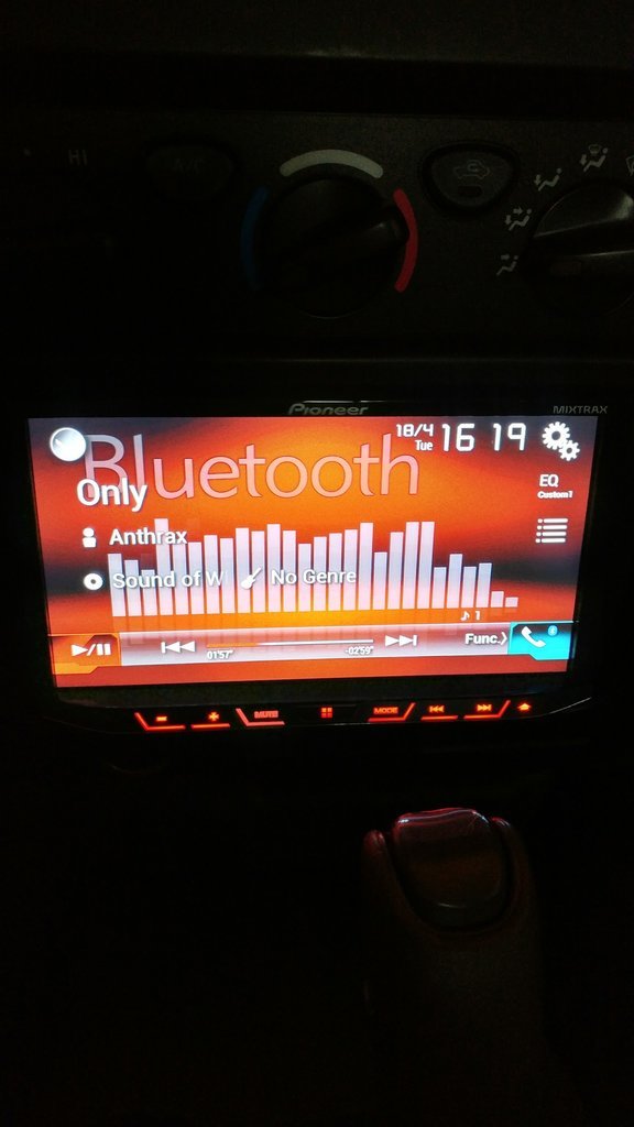

    Hi, everyone thanks for the replies and contribution I haven't logged on in a while but I finally installed a deck myself about 2 weeks ago. I ended up going with the Pioneer AVH-280BT which was my original decision mainly based on its price and its availability in stores near me (bought mine at Walmart for $290 CAD plus tax) so far I am definitely not disappointed with it, price considered. It has all functions I wanted such as radio,bluetooth connectivity,usb connection,auxiliary connection. The usb and aux connection is in the rear of the deck but i just used the usb extension cable that the kit came with and fed it through into my glove box and did the same with an aux i had laying around. The installation was a bit of a problem as it was my first time doing any sort of wiring. I started with removing the plastics on the dash around the radio and ac controls. It's quite simple,plenty youtube videos on it (https://www.youtube.com/watch?v=dJ0-KrKdJTQ) then took a couple hours to figure out how to connect all the wires due too poor labeling and instructions that came with the pioneer deck. After a couple hours of playing around with wires (battery was disconnected) and looking at videos and wiring diagrams it all made sense and i wired it up quick using the factory harness, aftermarket harness and some plastic wire butt connectors. Everything works great and music sounds pretty good, although i cannot compare it to anything because i bought the car without a working radio. The problem with the old deck which was in when i bought the car seemed to be poor wiring and installation but it needed a upgrade anyways.
    Ill post some images that someone might find useful as far as wiring goes.
