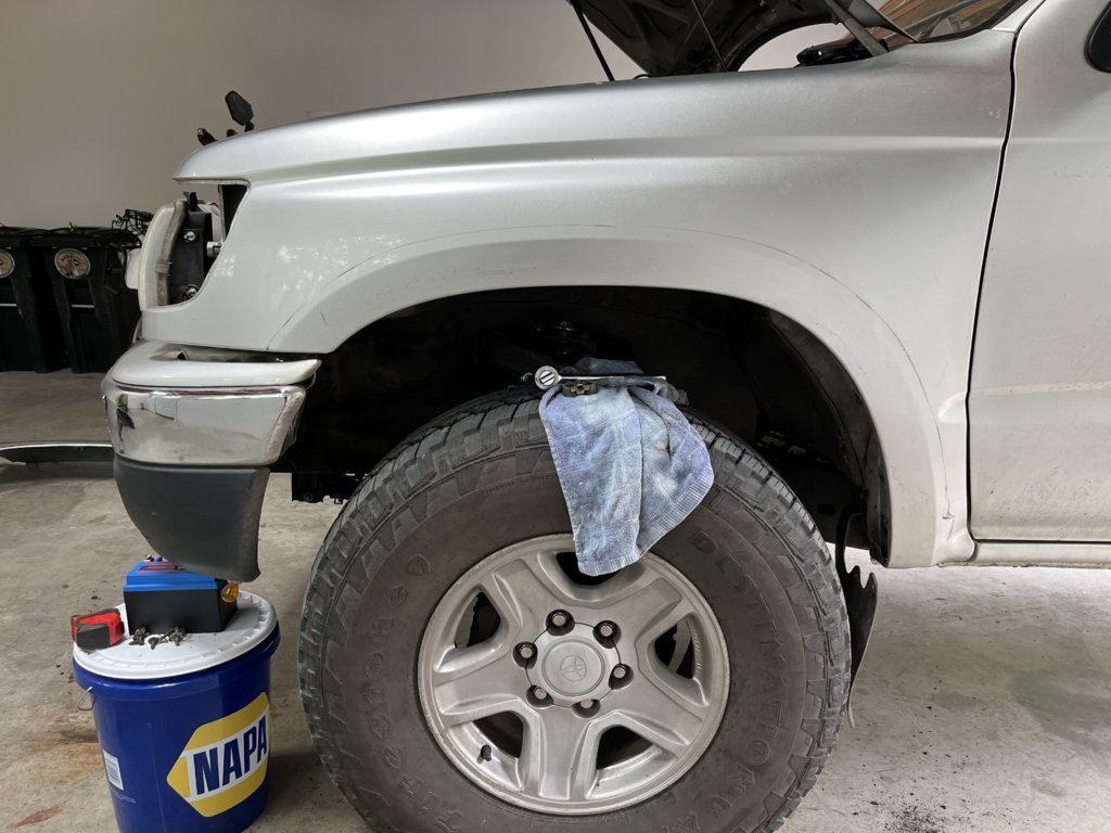

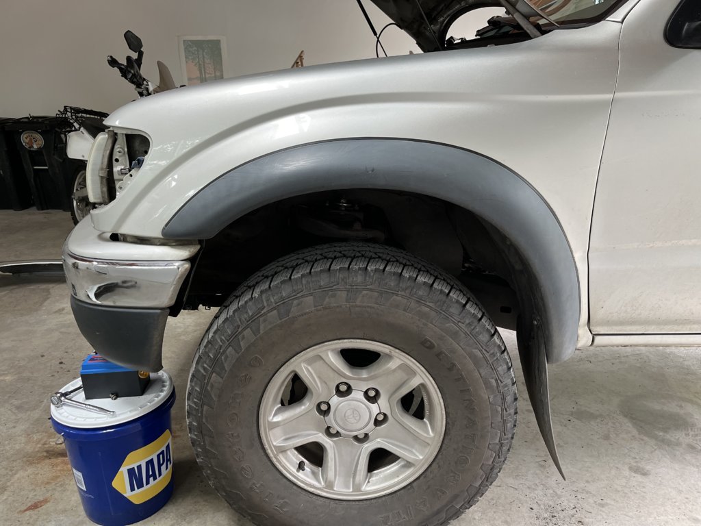

    I dont have a good angle shot, and obviously its not quite conventional‍, but heres the hood and fender lines, lol
    I am having some gap alignment issues since I haven't swapped bumpers yet

    Lol, okay, so partial donor
    I would pull that drivers side headlight and see if you can get it to bolt up to the Tacoma core support. Thats the only question mark in my mind.
    Fenders w corner lights, liners and flares, bolt right on, use the front fender supports as well
    ditto hood w hinges and hood latch, bolt on
    head lights and grille are the unknowns, could always just swap the core support instead of fucking around, maybe pull the donor and get them side by side to see what lines up and whats different
