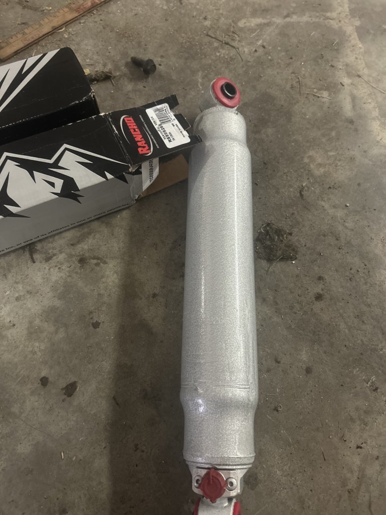

    New rear shocks showed up, rancho RS-9000 adjustable and rebuildable units.
    They are speced for a 2005 dodge ram 2500 4x4 and match my measurements within a 1/4 inch.
  5. Nov 4, 2024 at 1:04 PM
    #65
    Dare Devil Diablo
    Dare Devil Diablo Well-Known Member
    Aug 2, 2020
    #336417
    404
    2000 TRD Offroad MT
    I'm interested to see how these work out for you. The Fabtech shocks that are made for this lift kit are too short.

    Yeah these are 17” compressed and 27.5 extended if I recall correctly

  9. Nov 4, 2024 at 3:17 PM
    #69
    Double O’ Taco
    Double O’ Taco [OP] Well-Known Member
    Aug 20, 2024
    #455525
    169
    Paul
    2000 Tacoma V6 5spd 4x4 club cab sr5
    Lift, wheels, leds, grey wire mod, E150 rear springs, antennas, subs, etc…
    Okay shocks installed, you have to push out the steel eyelet sleeves and then drill out the polyurethane bushings to the size of the shock mount. They work awesome.

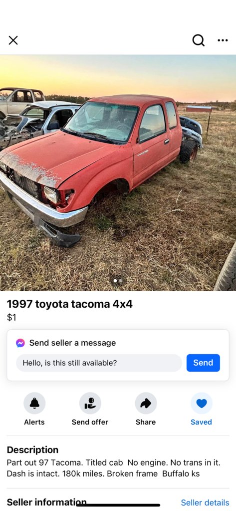

  11. Nov 6, 2024 at 5:14 PM
    #71
    Double O’ Taco
    Aug 20, 2024
    #455525
    169
    Paul
    This is the parts truck I’m trading for.

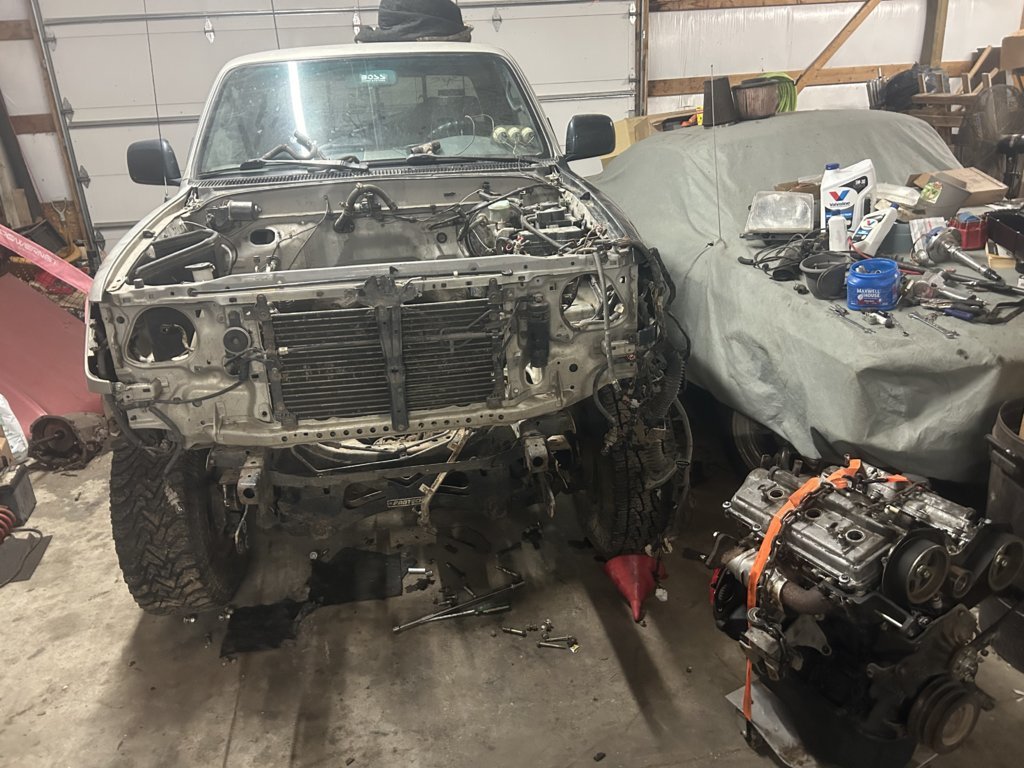

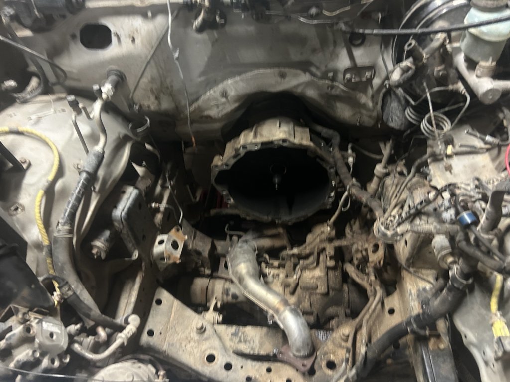

  12. Nov 7, 2024 at 3:13 PM
    #72
    Double O’ Taco
    Aug 20, 2024
    #455525
    169
    Paul

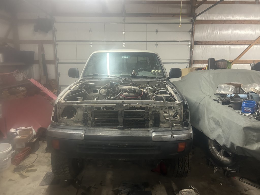

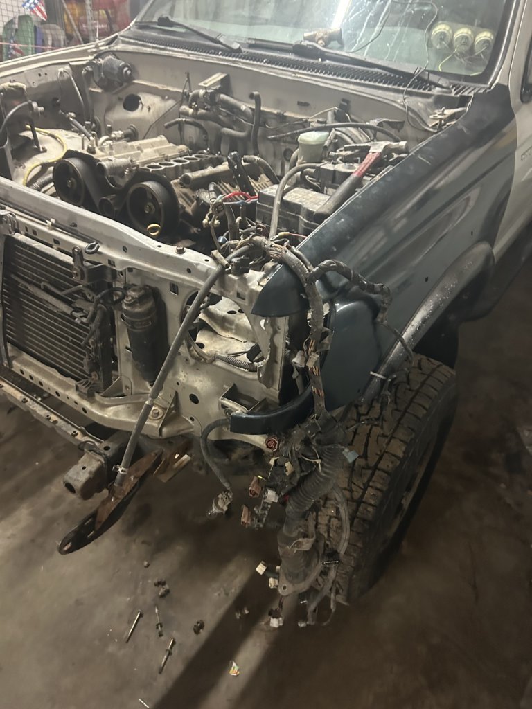

    Progress so far

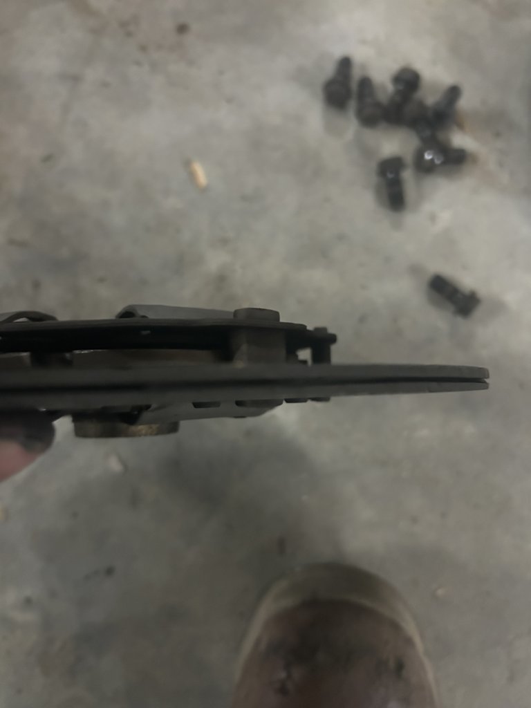

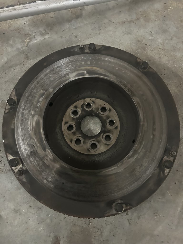

  13. Nov 9, 2024 at 8:27 PM
    #73
    Double O’ Taco
    Aug 20, 2024
    #455525
    169
    Paul

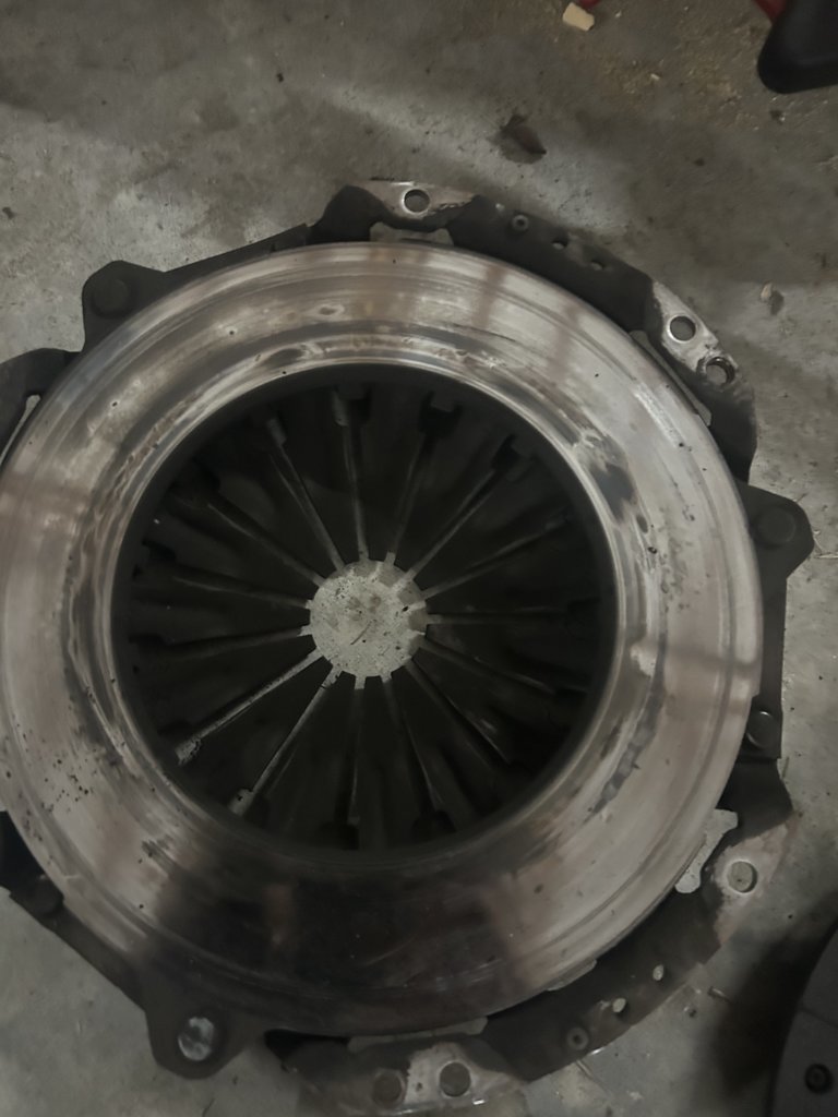

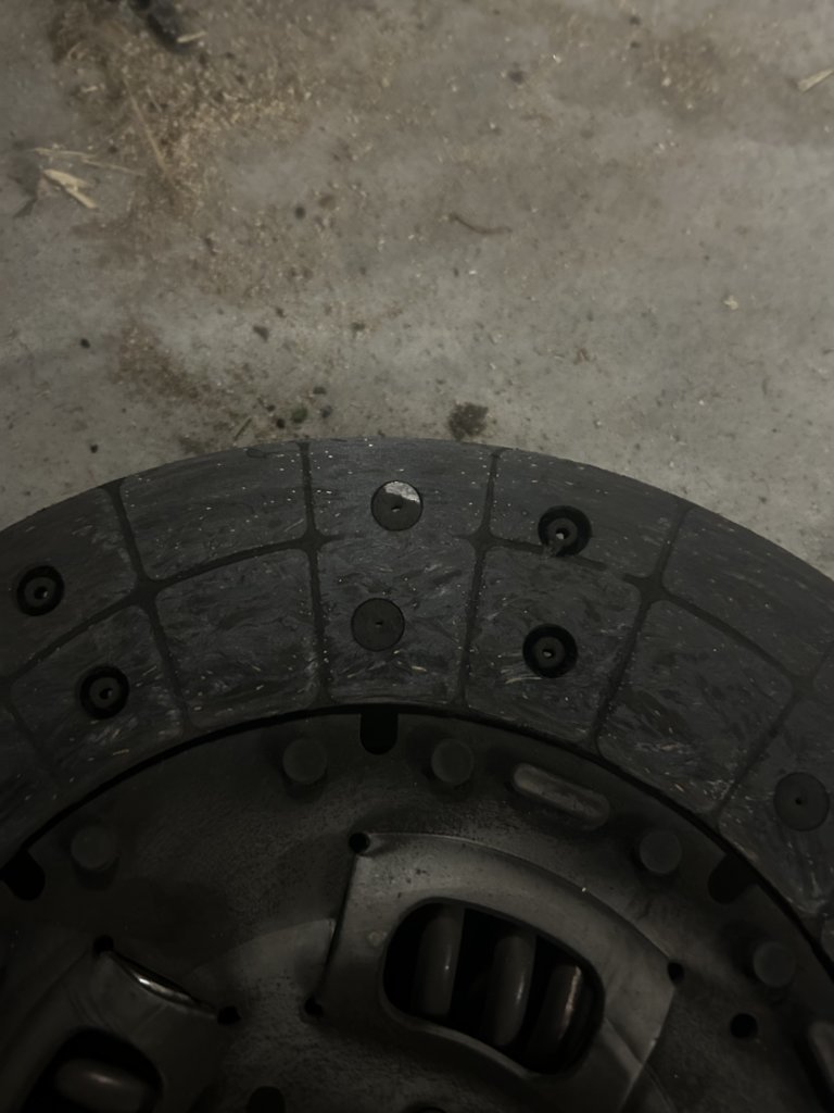

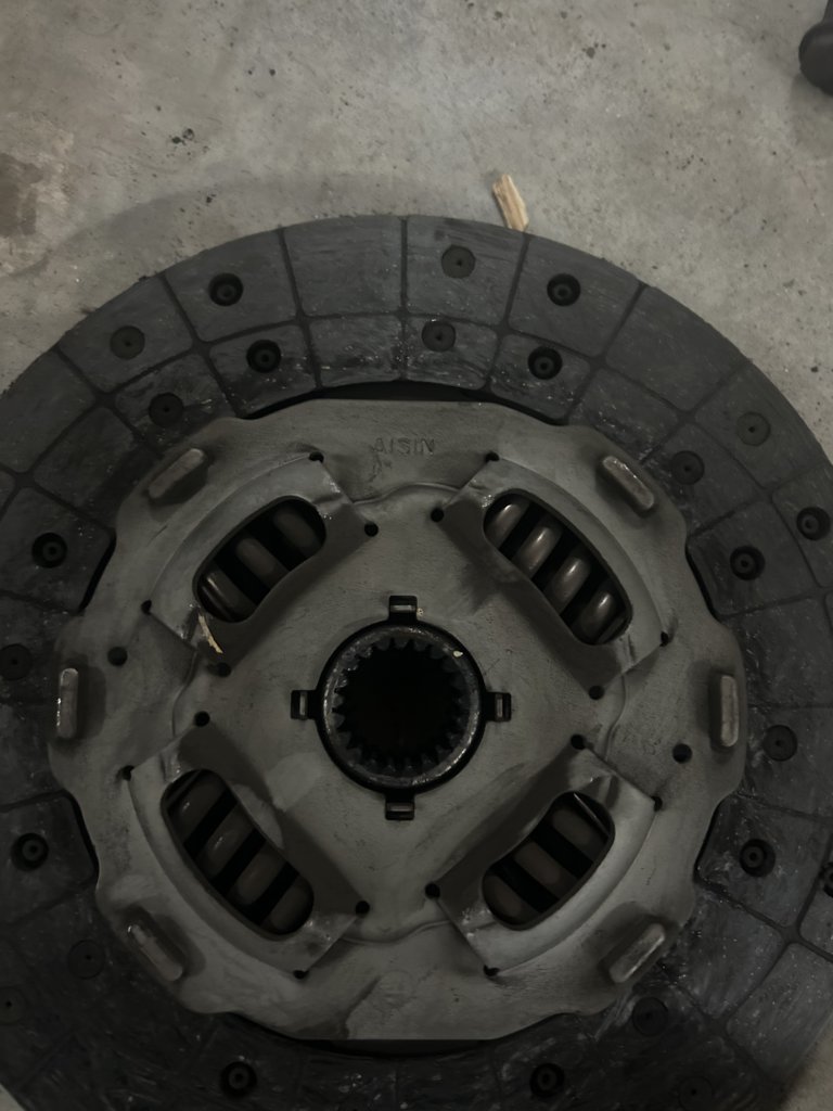

    Got lucky here the clutch had just started to contact the rivets and there isn’t a groove in the flywheel. IMG_1289.jpg IMG_1291.jpg IMG_1292.jpg
    Surprisingly it had an Aisin clutch in it.
    The throw out bearing was growling pretty bad.

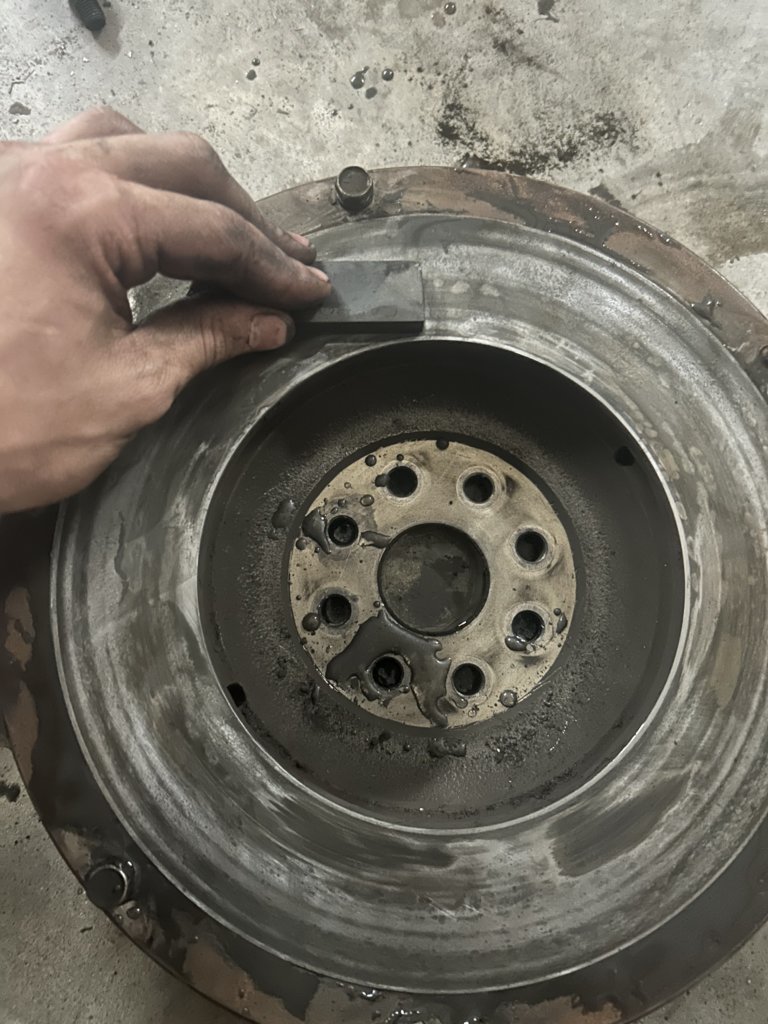

    How should I go about cleaning up the friction surface of the flywheel here in my shop?
    What sandpaper should I use?

    Decided to clean up my flywheel with an old whetstone as it is better than not doing anything to it at all.

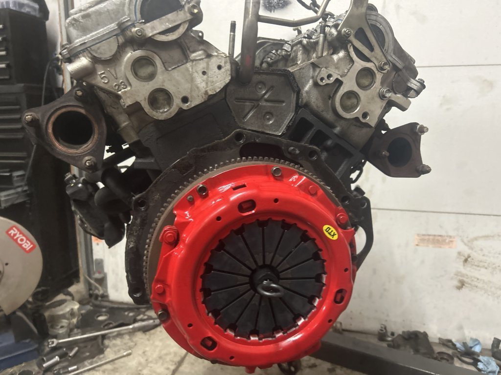

    Stage 2 clutch installed

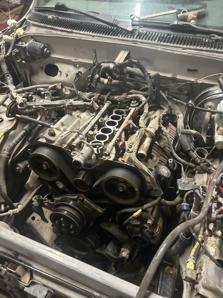

    This job is such a pain is the dick that once this motor needs replaced then I am just gonna put an ALH 1.9 TDI into the truck.
    Whoever designed the firewall and bell housing area with the crossover pipe in the way of the bell housing bolts, there is a special place in hell for you.
