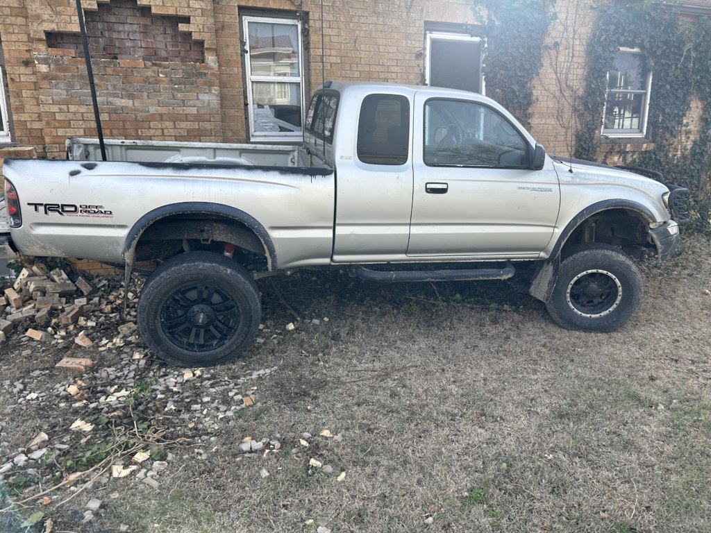

    Okay I have ordered enginetech rod main and thrust bearings for a combined total of $43 and I’m just gonna roll them in with the motor still in the truck.

    yesterday I also got the rear wheels on and I am now just waiting for the front adapters to get finished.
