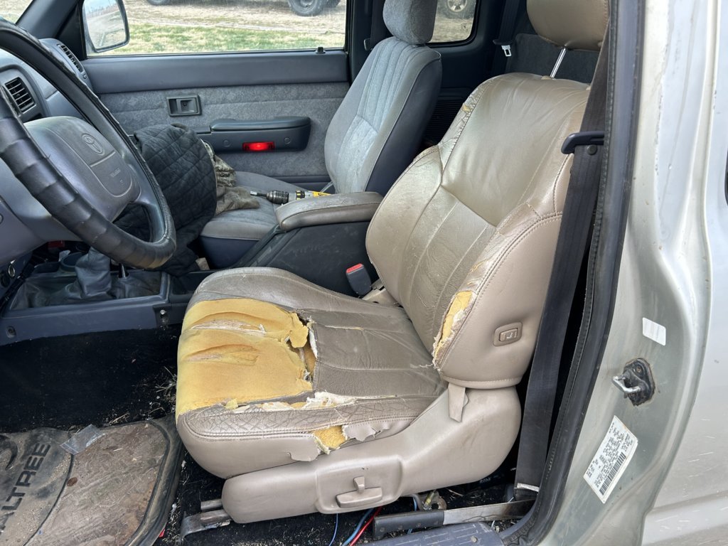

  3. Nov 27, 2024 at 7:19 AM
    #123
    Double O’ Taco
    Double O’ Taco [OP] Well-Known Member
    Aug 20, 2024
    #455525
    169
    Paul
    2000 Tacoma V6 5spd 4x4 club cab sr5
    Lift, wheels, leds, grey wire mod, E150 rear springs, antennas, subs, etc…

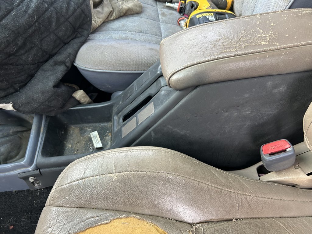

    Finally got around to doing the seat swap.
    The outer front and rear seat brackets have to be cut off and remade and you have to use the seat belt latch off the old seat. I have it installed and wired into the trucks harness so the seatbelt light still works.
    I sanded and spray painted the center console black and I am going to buy a new grey lid for it and I am going to replace the lower foam on the seat and get some mossy oak covers for both seats.

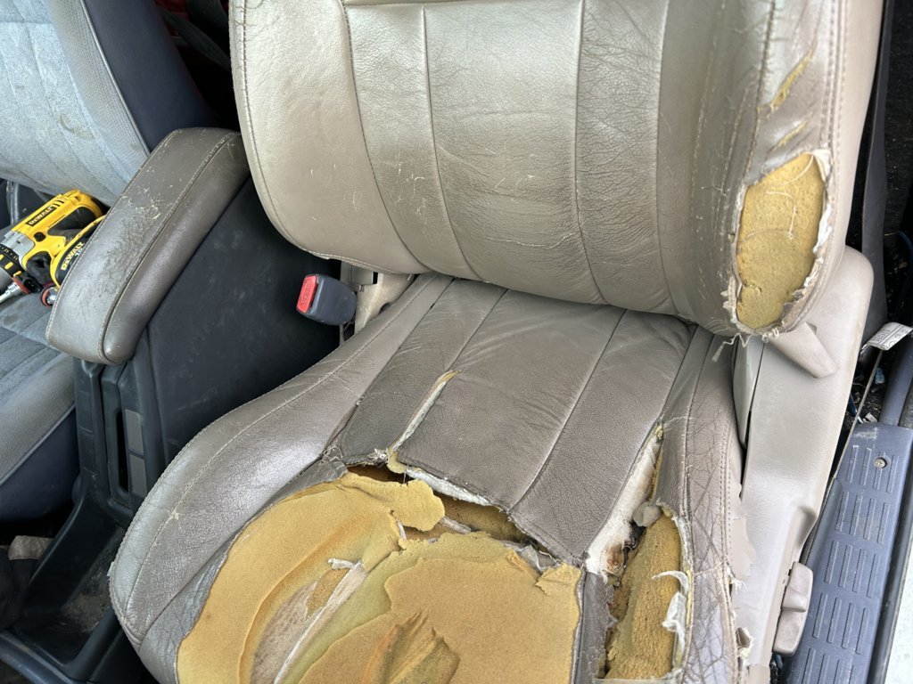

    If anyone wants my old seat it is for sale it just needs cleaned well. It has a broken spring in the seat back from my spoiled little shit of a brother throwing a fit and kicking the seat while I was giving him a ride home from school, let’s just say he walked the rest of the way home that day. I’d take $75 for it as the upholstery is flawless

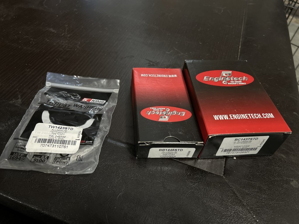

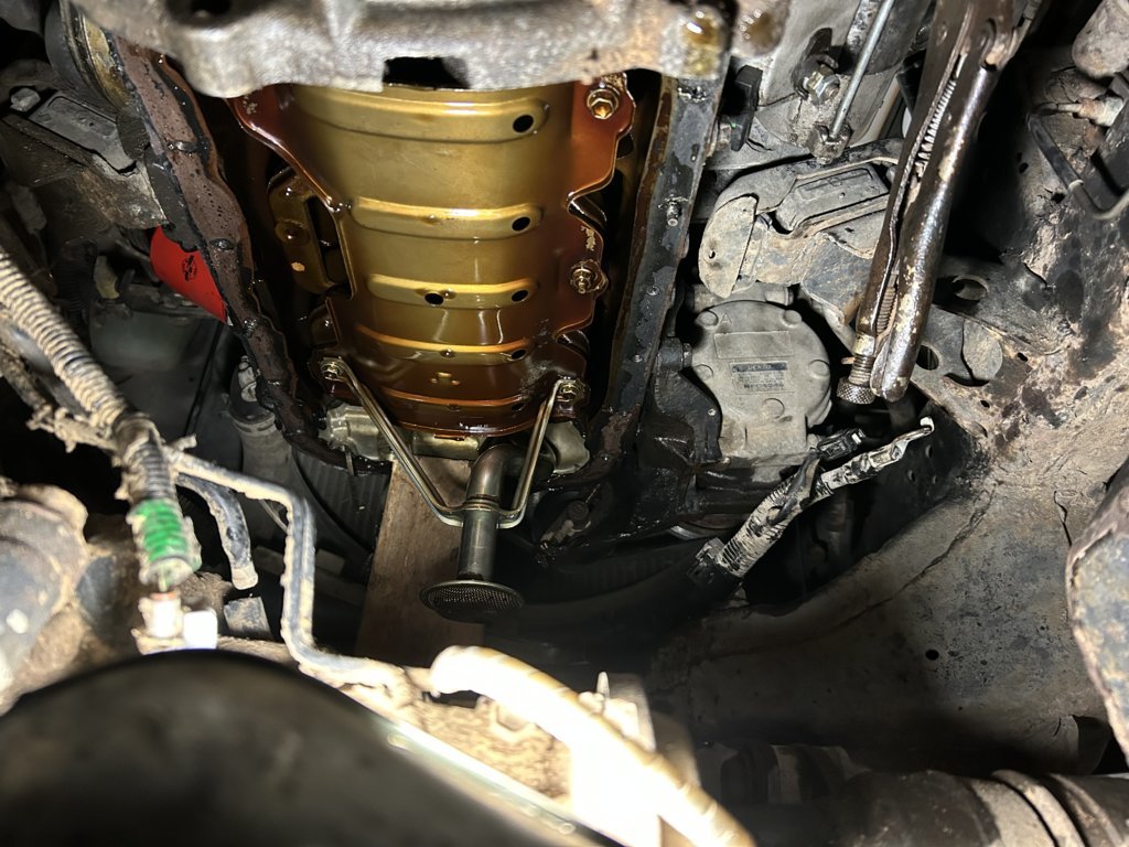

    it took an hour to get that pan off.

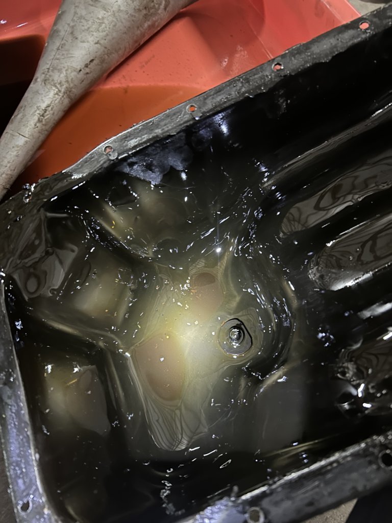

    i’d say that’s my damned Rod knock:censored:

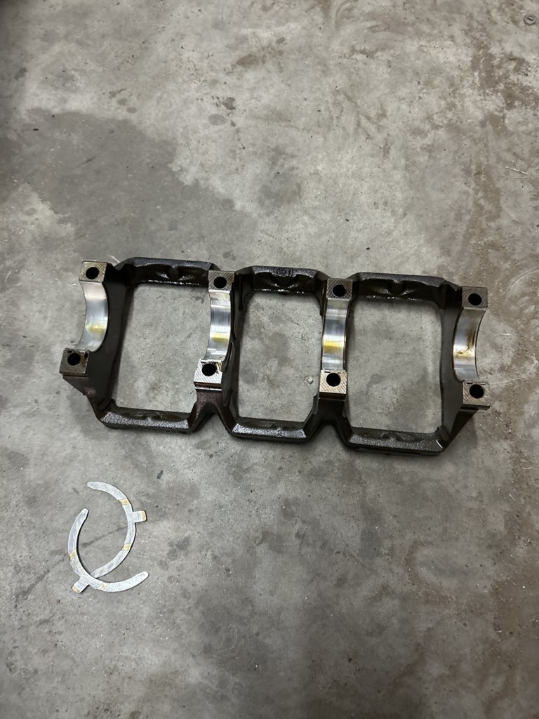

  10. Dec 2, 2024 at 12:03 PM
    #130
    Double O’ Taco
    Aug 20, 2024
    #455525
    169
    Paul
    Okay I’ve replaced all the rod bearings but didn’t find the smoking gun, I have unbolted the main girdle but it just wiggles side to side and won’t come down.
    What do I have to remove to get it to come down? I don’t want to force it if it is hung up on something.
  11. Dec 4, 2024 at 10:25 AM
    #131
    Double O’ Taco
    Aug 20, 2024
    #455525
    169
    Paul
    Okay if I Can I’m about to try and take the lip off the rear main plate to let the main girdle come down.

  13. Dec 4, 2024 at 10:59 AM
    #133
    Double O’ Taco
    Aug 20, 2024
    #455525
    169
    Paul
    well, good news. Bad news. Good news is the bearings look fine. Bad news is I still don’t know where the fuck the metal shavings are coming from.

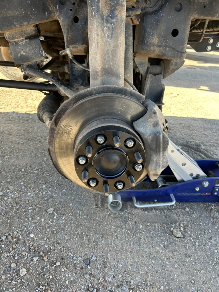

  20. Dec 11, 2024 at 7:12 PM
    #140
    Double O’ Taco
    Aug 20, 2024
    #455525
    169
    Paul
    New wheels are on finally. Those adapters were a real pain to make apparently.
