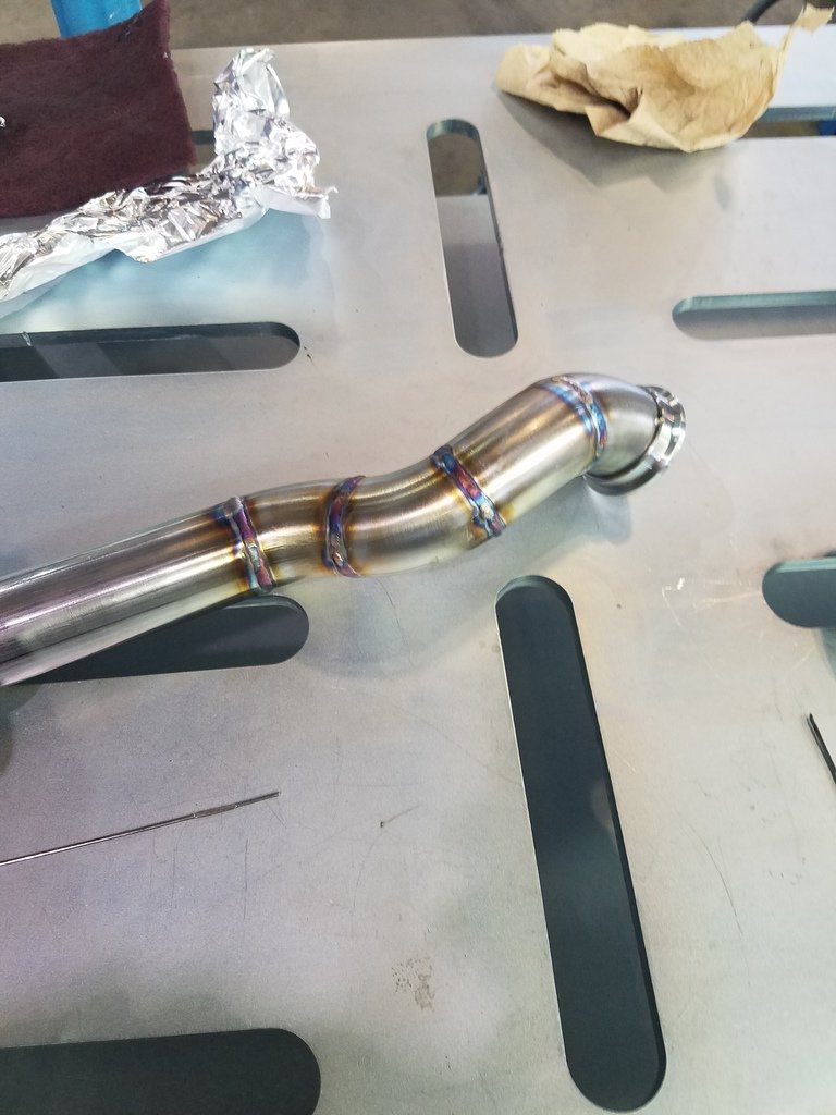

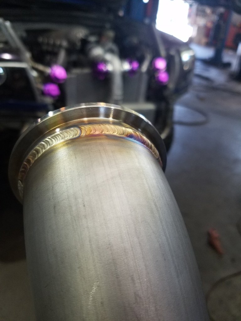

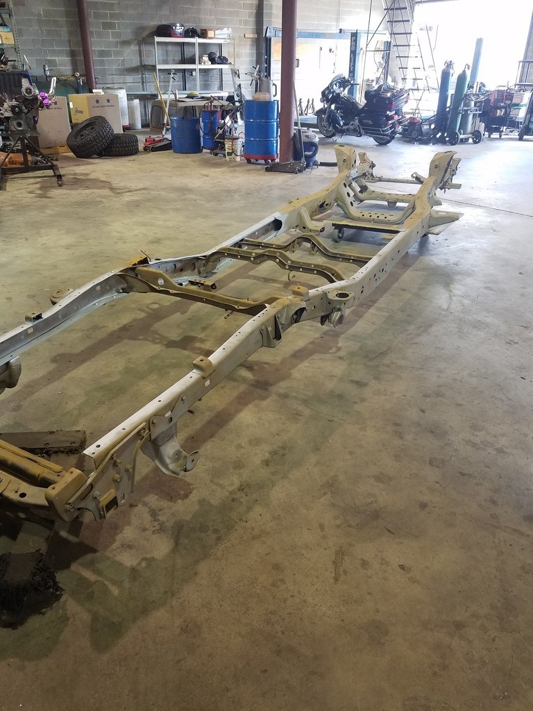

    So its been requested by a few that i do a build thread on tacoma world and not just xru.http://www.xr-underground.com/threads/doubllds-juggernaut-build.54051/

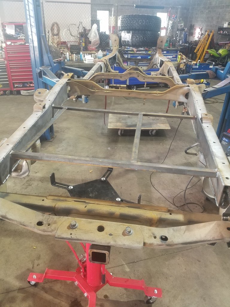

    Im gonna be brief on why i started with the LS swap. I blew my v6 after a very extensive build and decided i had enough. Ask @Torspd he has my old engine.
    So i love turbos and a v8 so i wanted to go all out and do the build once an do it all.

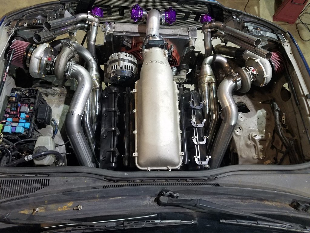

    Build parts so far

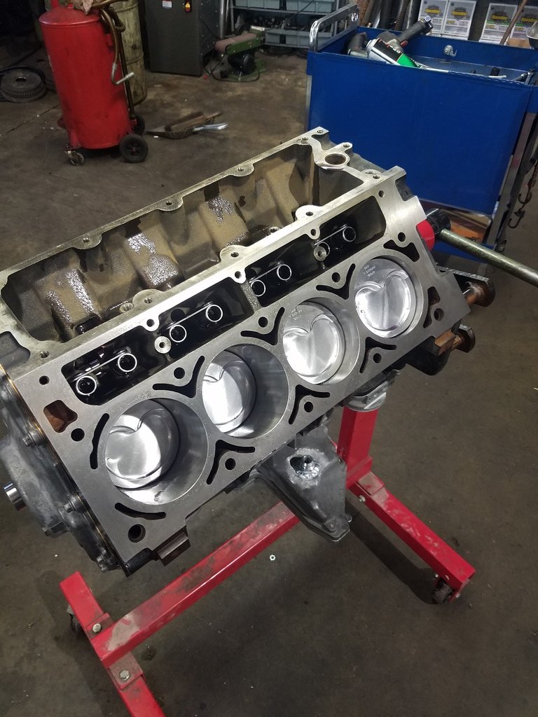

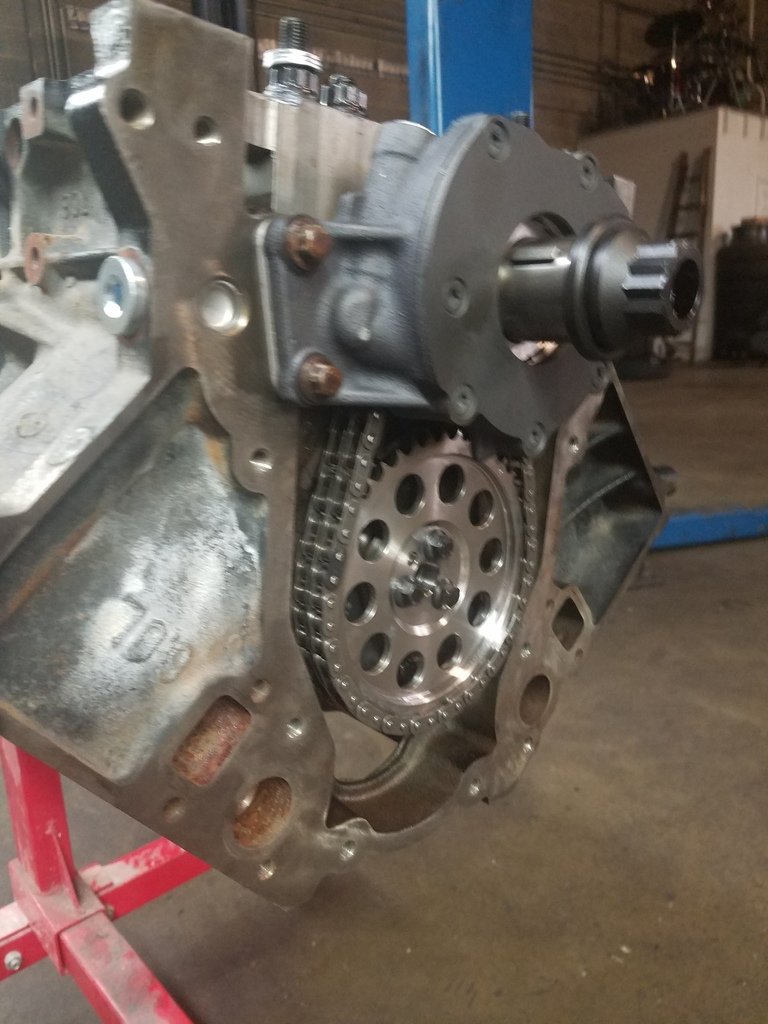

    6.0 iron block. Fully built by me with texas speed rotating assy. bored .030 stroker crank 4.000
    making it a 408
    4l80e fully built trans. with monster trans billet convertor. Controlled by a PCS standalone ecu
    moser custom ford nine inch rear end with 4.11 gears and full locker. and 4 piston rear calipers
    full icon remote res lift with dakar leaf packs

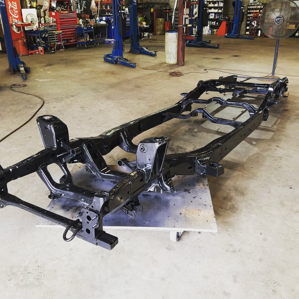

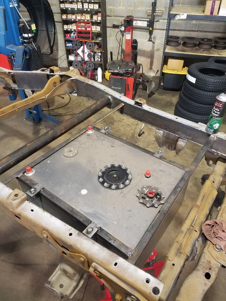

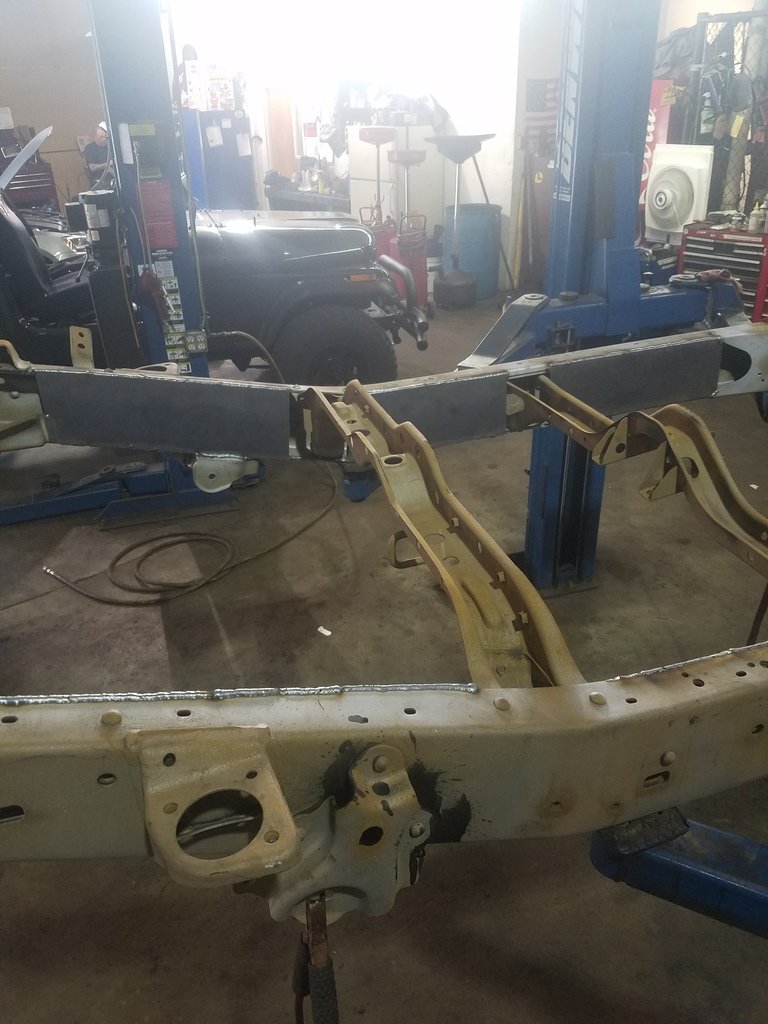

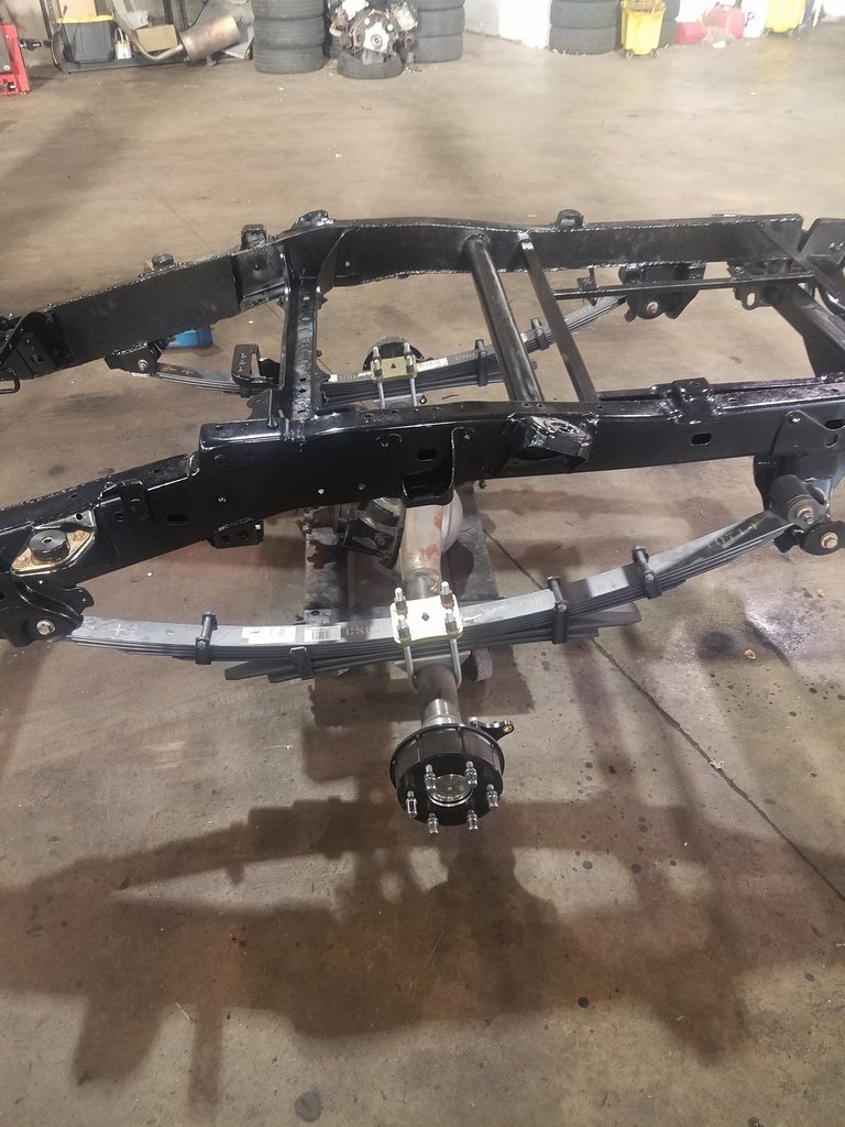

    i fully boxed the frame and coated with por15 and made a custom fuel cell mount. added extra bracing to make it stronger
    IM GONNA forget alot so just look at the pics. Build is super extensive. I do my own fabricaton and welding etc.
    14577_zpshfyy4wby_8eb101dc8fd2847cc93c1de8387de911ff36c2c4.jpg2016061395192854_zpsrcrl42fq_3c6736d2edbbb4e0841d50e55b9fa3e18c7d7276.jpg

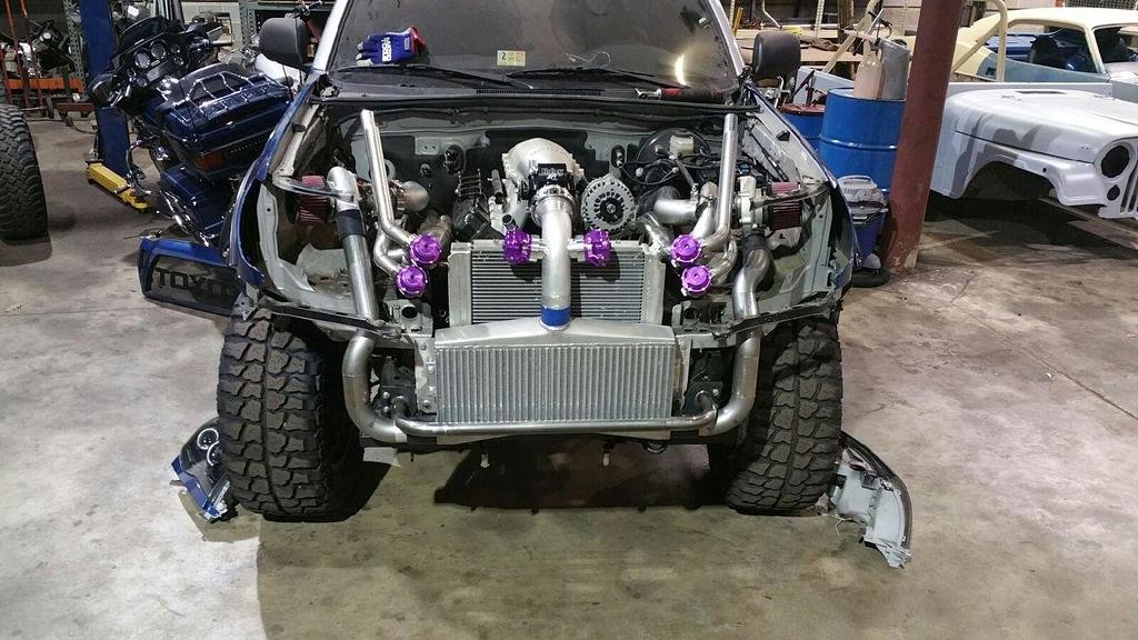

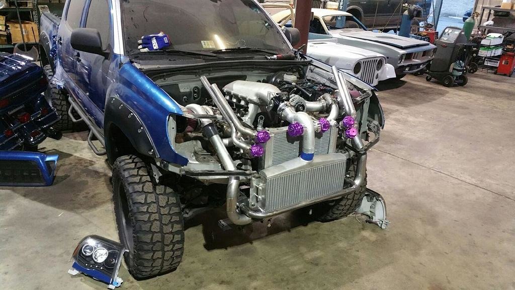

    also could a moderator fix my thread an maybe put all the pictures in one spot it wasnt letting me
