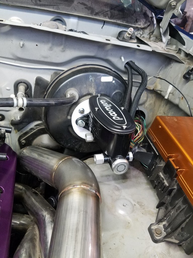

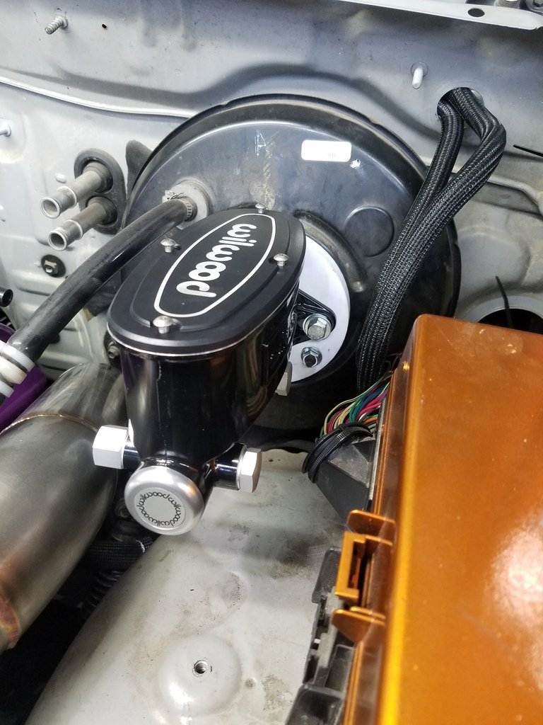

    so had everything 3d printed all fits perfect pedal travel is awesome. no pedal stop will be needed. i found adapters for the factory lines to the master cylinder. i also had a stock tacoma in the shop the other day an did a test fit it fits perfectly and the factory lines will be able to be moved to attach to the new master. some pictures of it on my truck. 20170202_102843_zpstagsofwr_be7ac2d08e0a76a17ee44eb7ae9910cca5e44dc7.jpg20170202_102853_zpstgoeclzw_9e5686f8a310ef8efaeec2d2aaebb240e19e71d2.jpg
    having one made out of metal now and will install on a truck and will test drive to compare feel and stopping power in a week or so.

    Remind me please. Does this encompass the reservoir for the clutch?
    Besides that, it looks great!

    it doesnt but getting a separate res. shouldn't be a issue.

    also technically could tap into the side of the res. an put a threaded nipple into it.

    For the autos, that will be perfect as is. For the manuals, I wonder if they have a dual resi similar to the one you have?

    or maybe a nice independent res. for the clutch master?

    Awesome. I'm wondering for those with aux fuse boxes if it will hit. I'm assuming that the orange cover is the stock fuse box in the pictures.
    Here's mines, do you think the reservoir would hit? I'm thinking it would.

    Yes.

    Meh little hacking and adjustments it would fit.

    yes it would hit.
