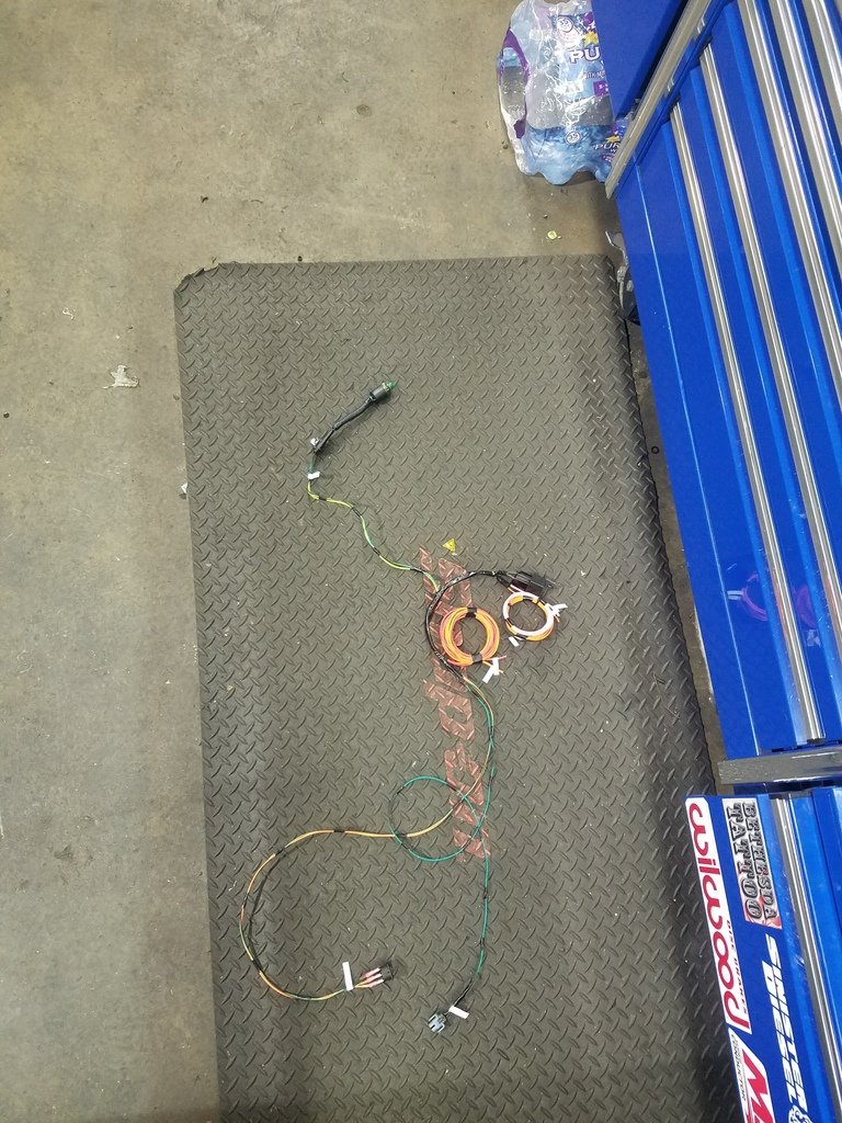

    so i was back and forth with if i wanted to have ac in my truck. i decided to figure it out an get it done. ill be mounting a remote condenser in the bed of my truck. compressor fits in factory location on engine. i had a standalone harness made that controls fans and compressor with a trinary switch.
    the factory gm ecu controls the compressor and fans. i have a aem and didnt want the headache of getting it to work through that.
    i will have lines made after i get it all in place.
