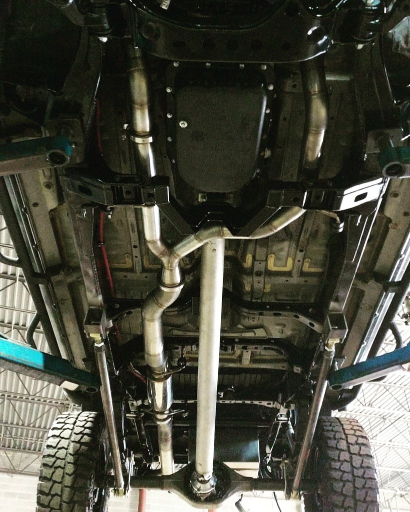

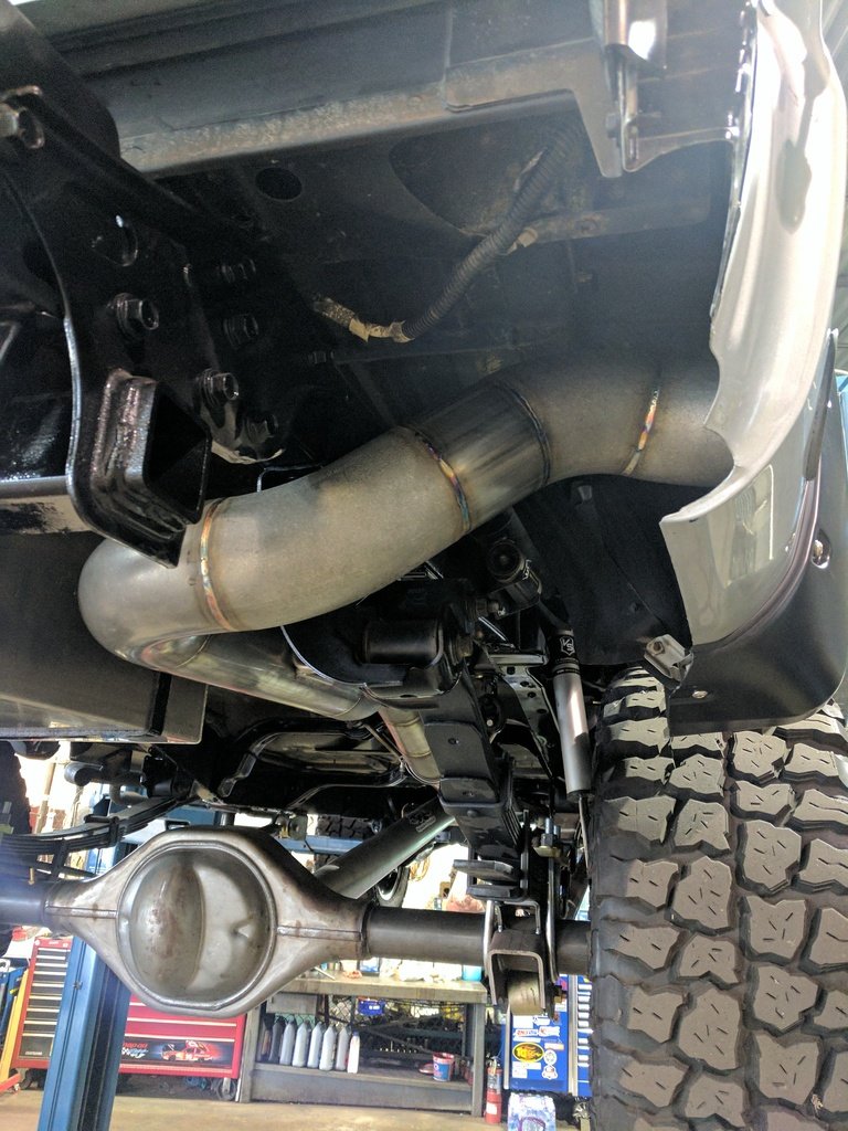

    IMG_20170802_225543_132_zpswhxcunls_c1861107dcba79aaba4243b6aff03d0eede5ea91.jpgIMG_20170802_162003_zpsv4bizhv1_13c945a8dea369547877d46d63079ec0bdbd293c.jpg
    the rear section took a ton of time to get it around the frame up and then back for the bedside exit

    That looks terrific! Excellent fitment.
    I only have one recommendation to add. I don't see any flex couplings. At least one just after the "y-pipe", or two in the Y. I know that would be a hassel though, since it is already placed where you want it. One post Y would be easiest.

    no need for a flex section i have it setup in such a way there is plenty of movement in the exhaust system. the engine is pretty much solid mount same with the trans.

    damn is that 3" exhaust

    3inch from both turbos merged into a 4inch

    I was going to ask about that! lol I've stared at that area for hours laying under the truck imagining how it would be ran.. :thumbsup: amazing work man! beautiful.

    Been working away on it. Almost completely done with all the plumbing.
