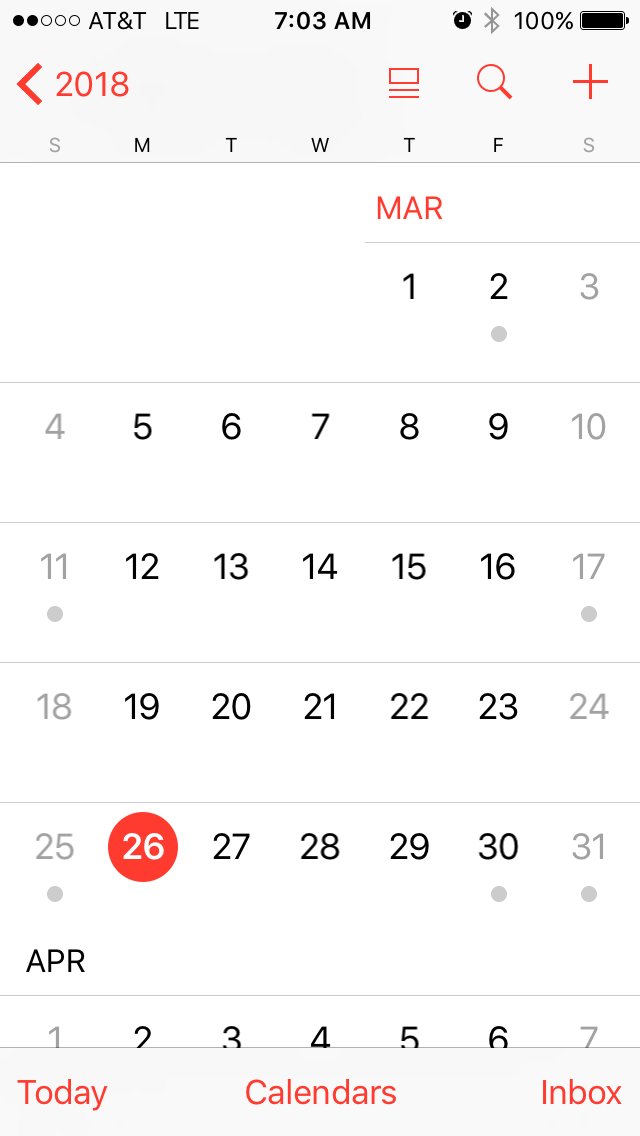

    Tune week has arrived. 5 more days!!!

    that is has. got a few items I need to take care of before saturday. im excited and nervous.
