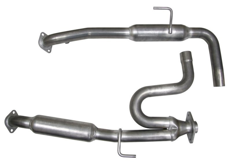

    I am seriously considering getting a Doug Thorely Pipe Bomb y-pipe. The Pipe Bomb looks a little weird because it goes way back and around the transfer case, but it's the only one I could find that maintains my ground clearance and looks like it will work with my BudBuilt skid plates. I had the exhaust relocated by a muffler shop to get rid of the low hanging crossover and to clear my skids, but I'm not happy with the results.
    If anyone has pictures of a Pipe Bomb installed I would be grateful to see them. even better, if you are running one with BudBuilt skids and can confirm that it all fits, I will order the y-pipe and get it installed.
    Thanks!

    Never mind...it's not going to fit. Moving on to a custom Y-pipe.

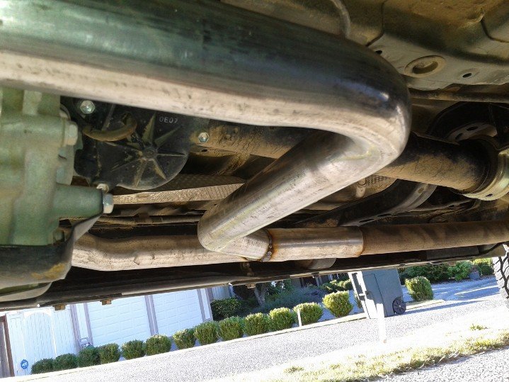

    Nope. The one they show on the website is actually for a 2WD, and the crossover won't clear the transfer case. The 4WD version, shown below, goes under the oil pan and won't work with a skid plate.

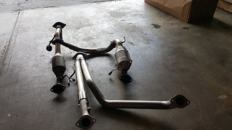

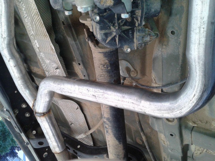

    I went through this same thought process 4 years ago and ended up getting some custom pipe welded in after the cats. Good to hear I didn't miss out on any new products to solve the problem.

    Would you be willing to share some pics?
  9. Jun 30, 2017 at 8:43 PM
    penguins_cc
    penguins_cc Well-Known Member
    Aug 18, 2010
    #41874
    2,360
    Will
    Bellevue, WA
    Timberland Mica Limo!
    Perkins Performance Sliders, Warn 9000, Brute Force Fab front & rear bumper, OME/Dakar lift, full ATO skids and hi-lift mount, satoshi, Wet Okoles, illuminated 4x4 switch, Diff Breather.
    Why most certainly
