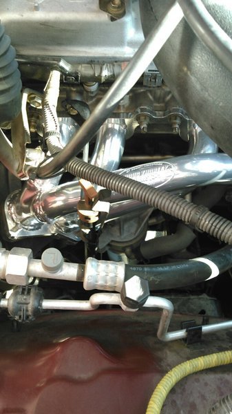

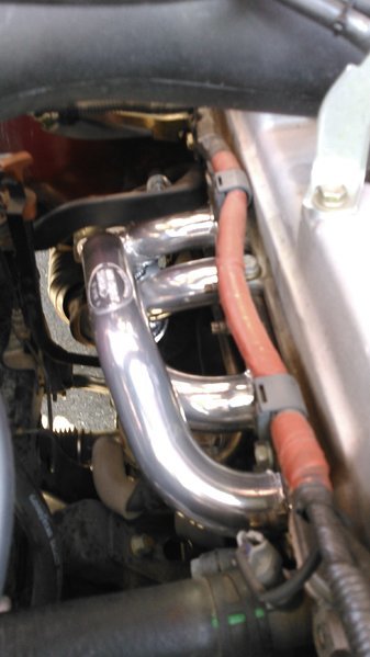

    Here's mine ... Had a hi perf muffler shop install mine , took 3hrs and cost me $80 labor

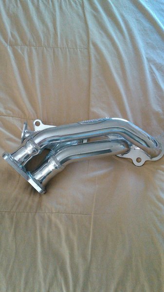

    To answer your question the Doug Thorley header I've got which is a TRI Y Shorty header came with all hardware and header gaskets needed for an easy install

    My 2.7 is Supercharged either on a 4.5psi or 8psi tune , this creates a lot of heat for the header . The nickle coating doesn't show any heat damage and the header has been in the motor now since June 2016
