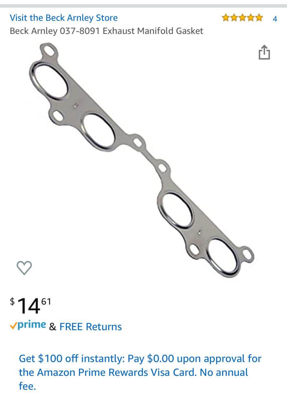

    Make sure you buy a new gasket the Doug thorley gasket supplied is horribly designed , I bought a beck and arnely which was half the cost and looked oem

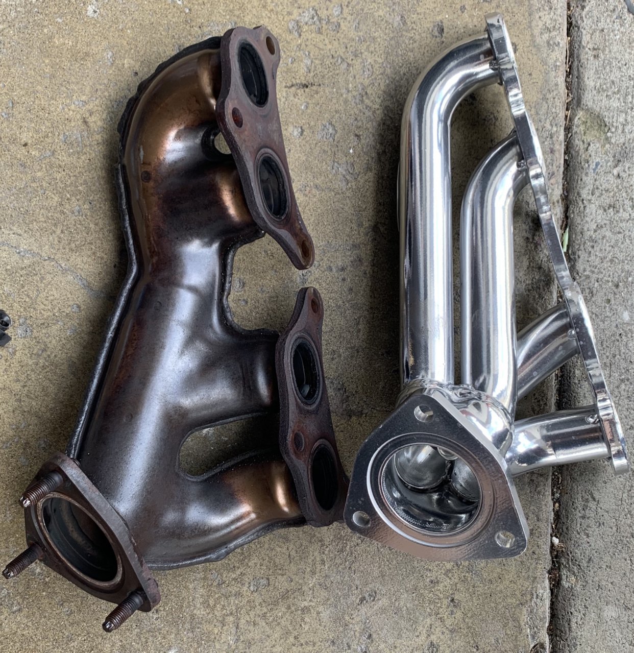

    LCE short-throw shifter kit Hurst shifter, knob, and Superboot, home-made console Volant CAI Redline Tuning QuickLIFT hood supports DJM 3/4 drop with their upper control arms Doug Thorley Header American Racing 605 16x7 wheels--not big but perfect for me Belltech rear shocks KYB Monomax front shocks McLeod clutch Sachs flywheel LCE flywheel and pressure plate bolts Two-inch diameter cat back dual exhaust Throttle body bored .003"
    The Thorley header was the easiest one I've ever installed on any vehicle. Just unbolt the exhaust manifold and install the header. You'll need a new gasket between the header and the down pipe. I ordered the wrong one, so my truck had a horrible-sounding exhaust leak for the first week until I received the correct one. And I see no need to raise the engine; I didn't have to.

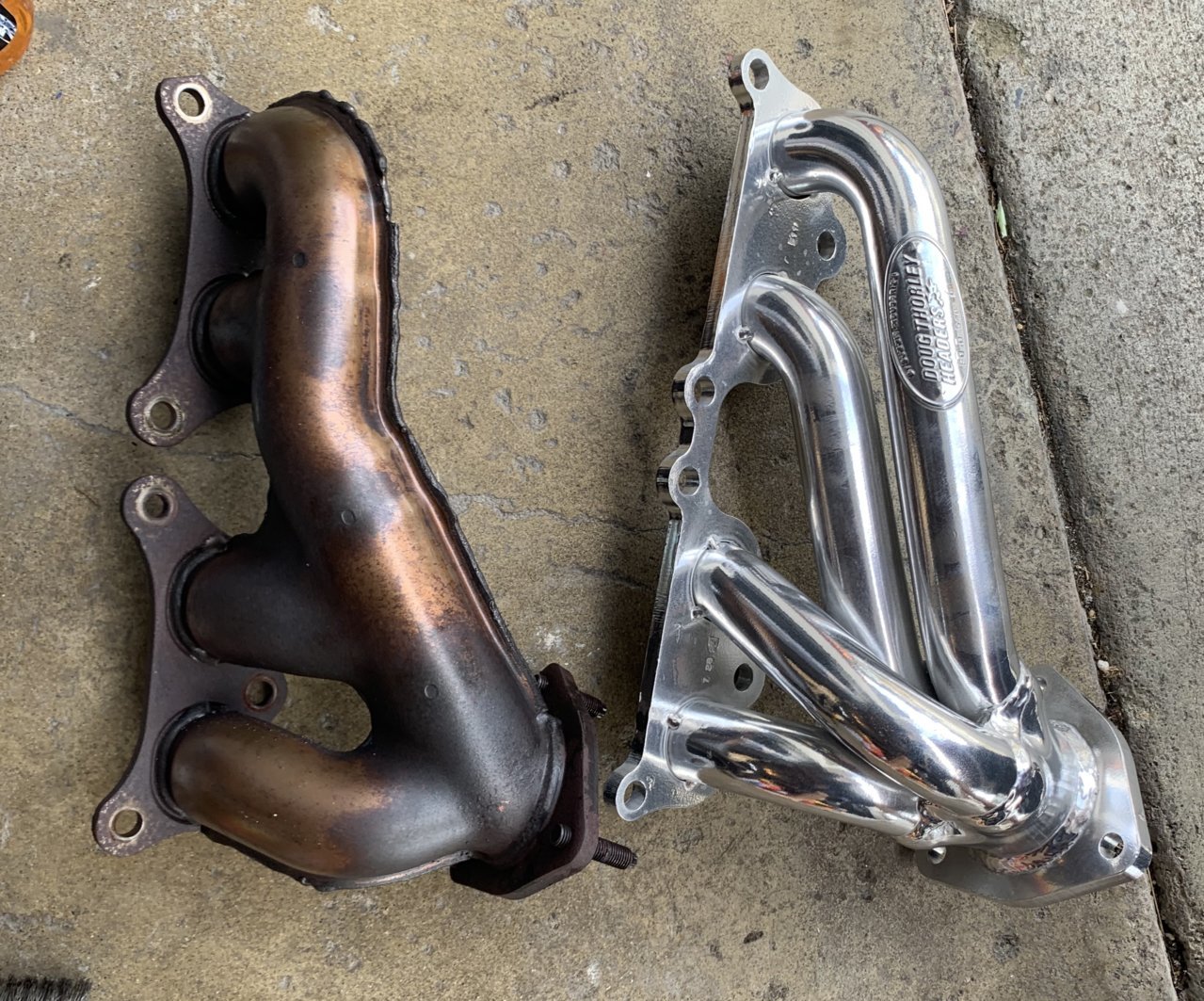

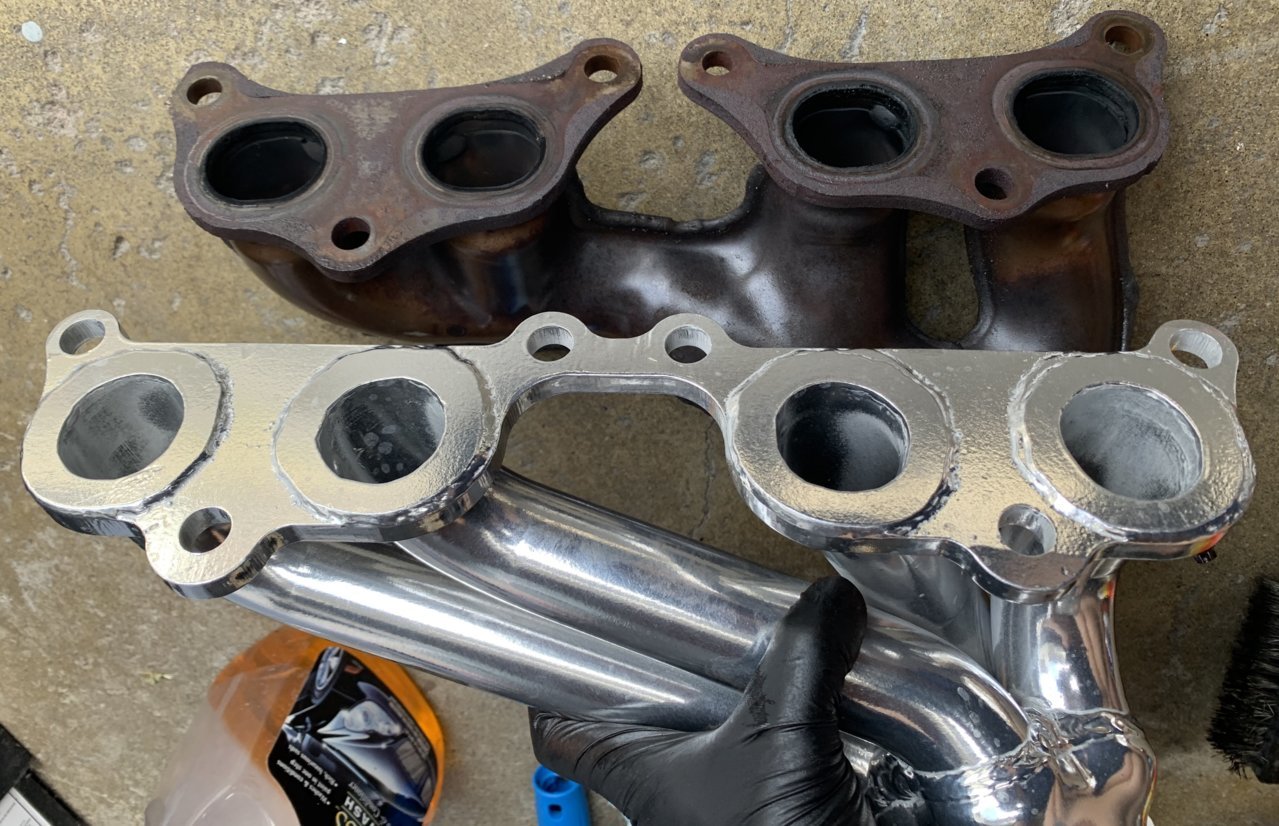

    I sprayed all the bolts with pb blaster and let it soak overnight. Everything came out without too much trouble.
    i just have to figure out how to re attach the exhaust clamp, because I can’t get it back around the bracket. So I’ll most likely just get a different clamp.
    The included gasket is a fairly thick and doesn’t look nearly as sophisticated as the OEM one. All header bolts were torqued down to 25lbs, except the lower left bolt, which had to be tightened by hand due to space limitations.
    Took the truck for a spin and it feels slightly upgraded from “really slow” to “regular slow”. I’m sure the 4-speed automatic isn’t doing me any favors. there is a slight throaty growl at WOT, plus a little more headroom at the top end. Can’t tell if any bottom end torque is different.

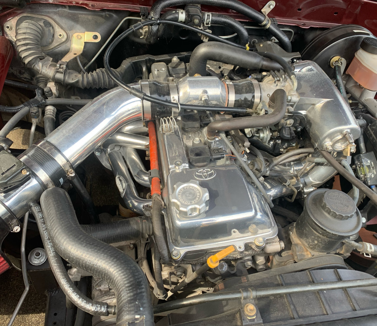

    I installed mine this weekend. Super easy. Didn’t notice any change in sound (running a factory style muffler) ignore all the dirt and dust as the truck has been sitting in the garage since last show season. Lol.

    Little update after 2 years , doug thorley header cracked from the welds will post pics as soon as I install my stock header

    That setup seems like it would heat the air flow, cancelling the point of an aftermarket cool air system.

    The header is ceramic coated so that may help with under hood temps.

    Not even close to what the factory heat shield does.
