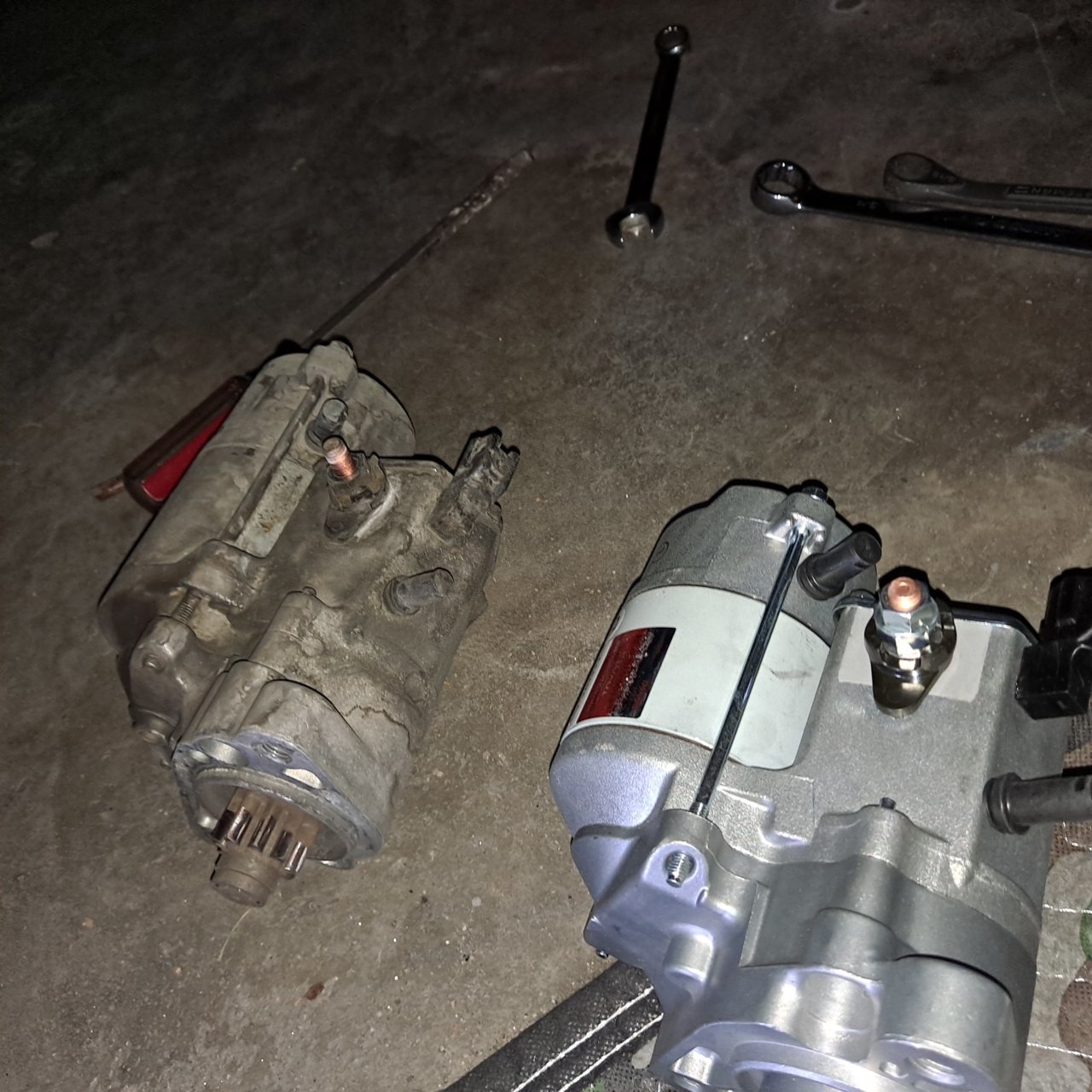

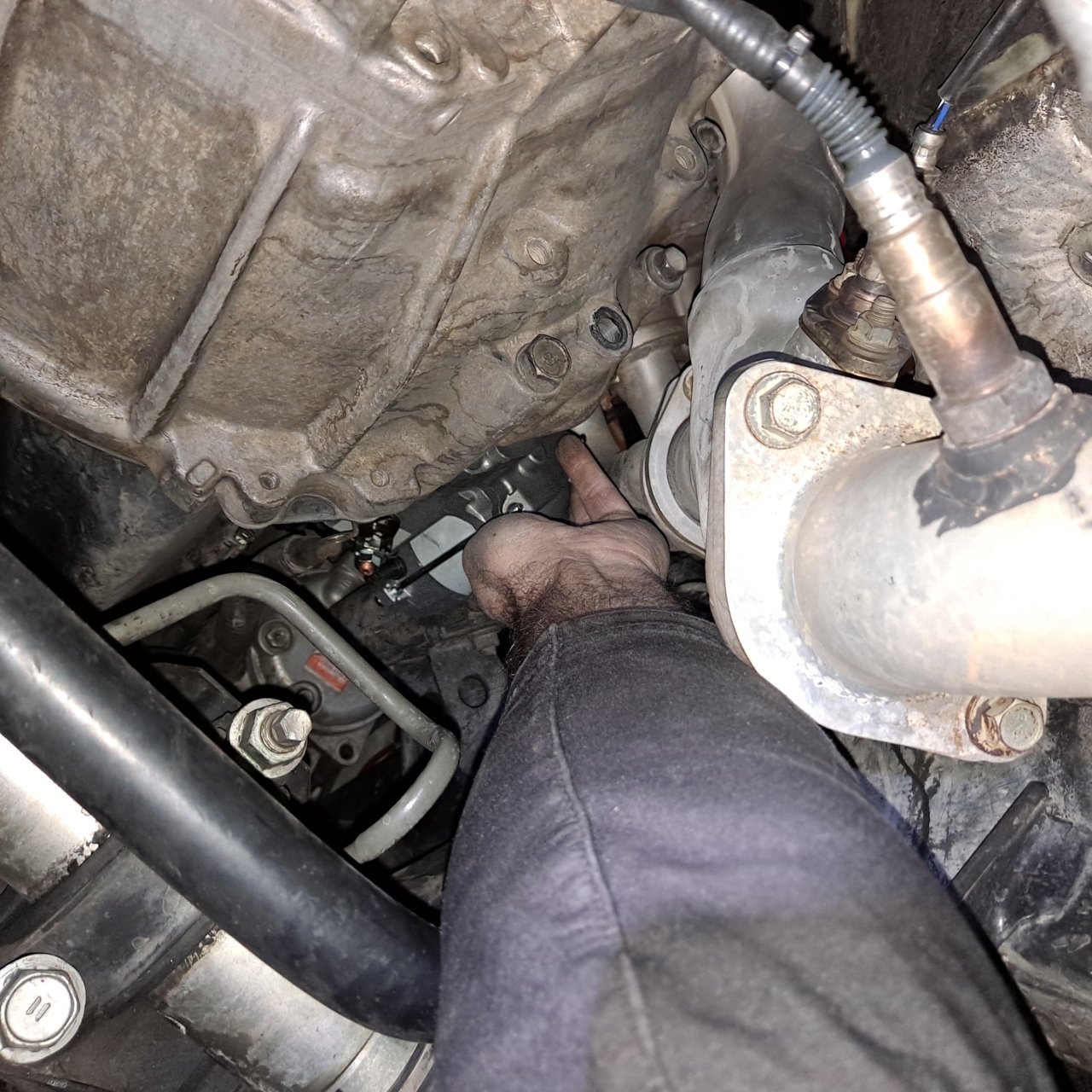

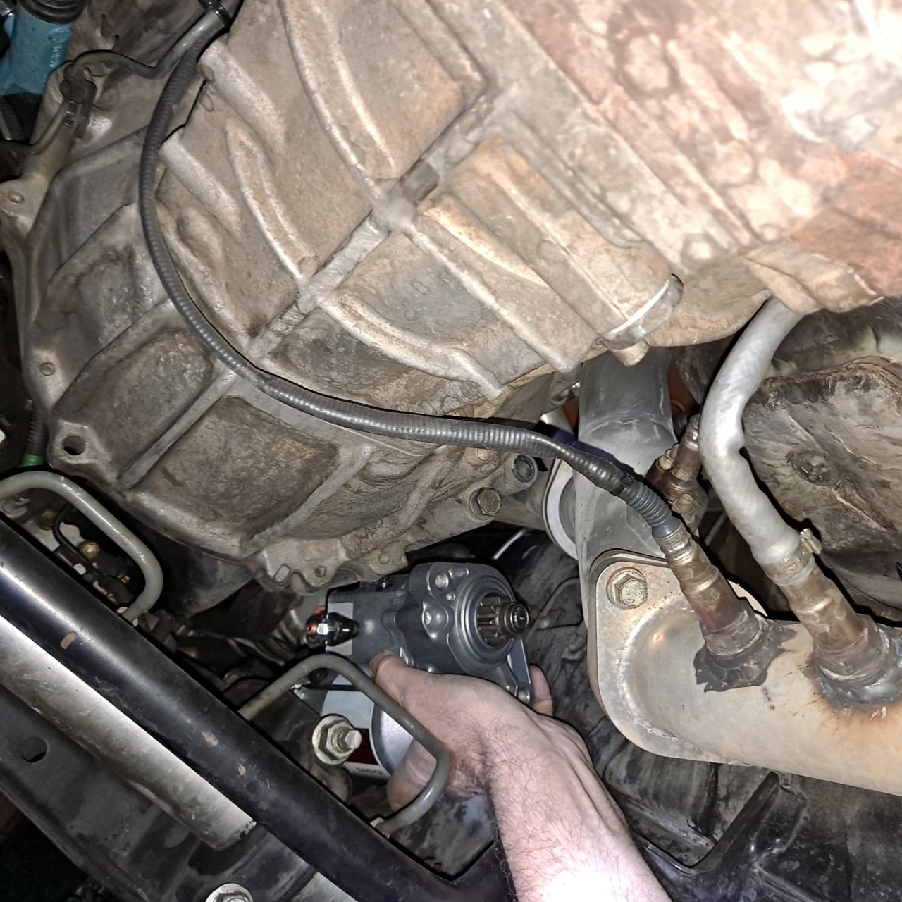

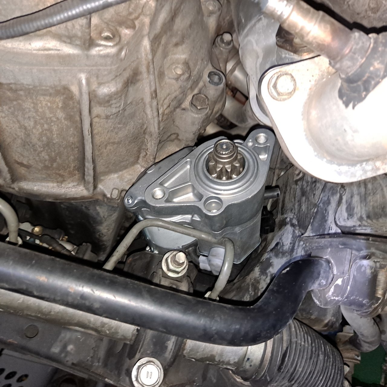

    Was a piece of cake, starter drops out the bottom with the 5 speed took a whole hour and didn't have to undo header.

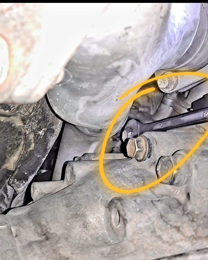

    The top bolt u need an open end wrench and can only turn the bolt a 1/4 turn at a time, That top bolt runs right into the header and a socket will not fit over it because of lack of space 1" maybe,
    Just used a 14mm wrench and a cheater wrench and both nuts came loose pretty easily.
    Did everything from the bottom of the truck.
    Didn't have to access from the passenger wheel well either,
    FYI , there's no way the starter with pass through the passenger wheel well with these headers blocking that path

    With the 5speed it literally took me an hour for removing + installed and had plenty of space to drop the starter out in between the exhaust and the rack,
    I was expecting this to be a nightmare thinking that I would need to remove the exhaust header section.
