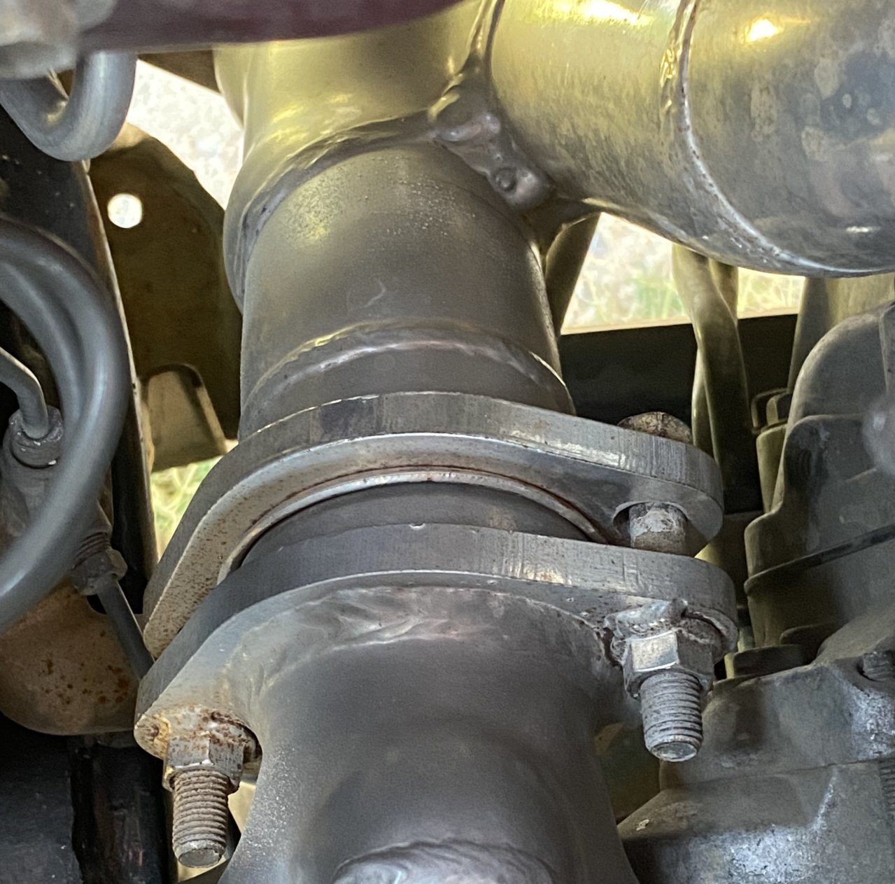

    461E362C-D497-4A67-8AB4-FA96054CDF8A.jpg Looking at this photo I saw the threads here are different. Just guessing that they would have to be tightened in sync . Maybe tighten the right side up first ?
    newb advice :)

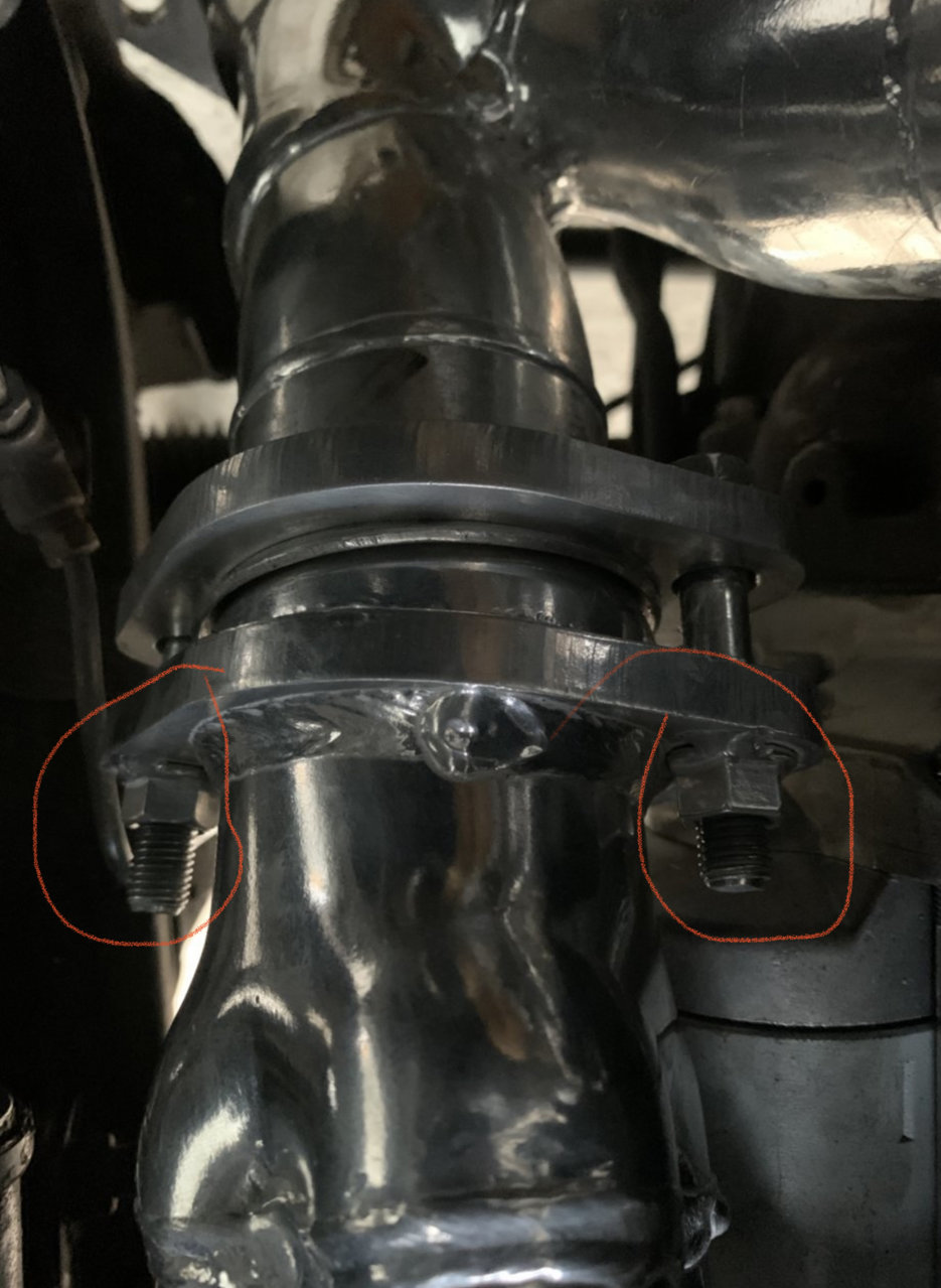

    I tried this many times. Because of the angle that it want to mate up it does not seem possible to get them even. It’s hard to demonstrate through pictures but I can assure you I tried.

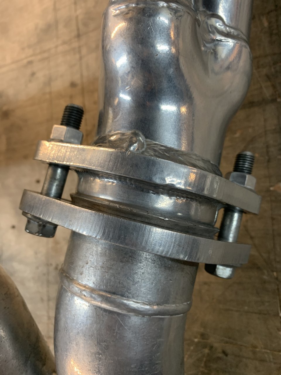

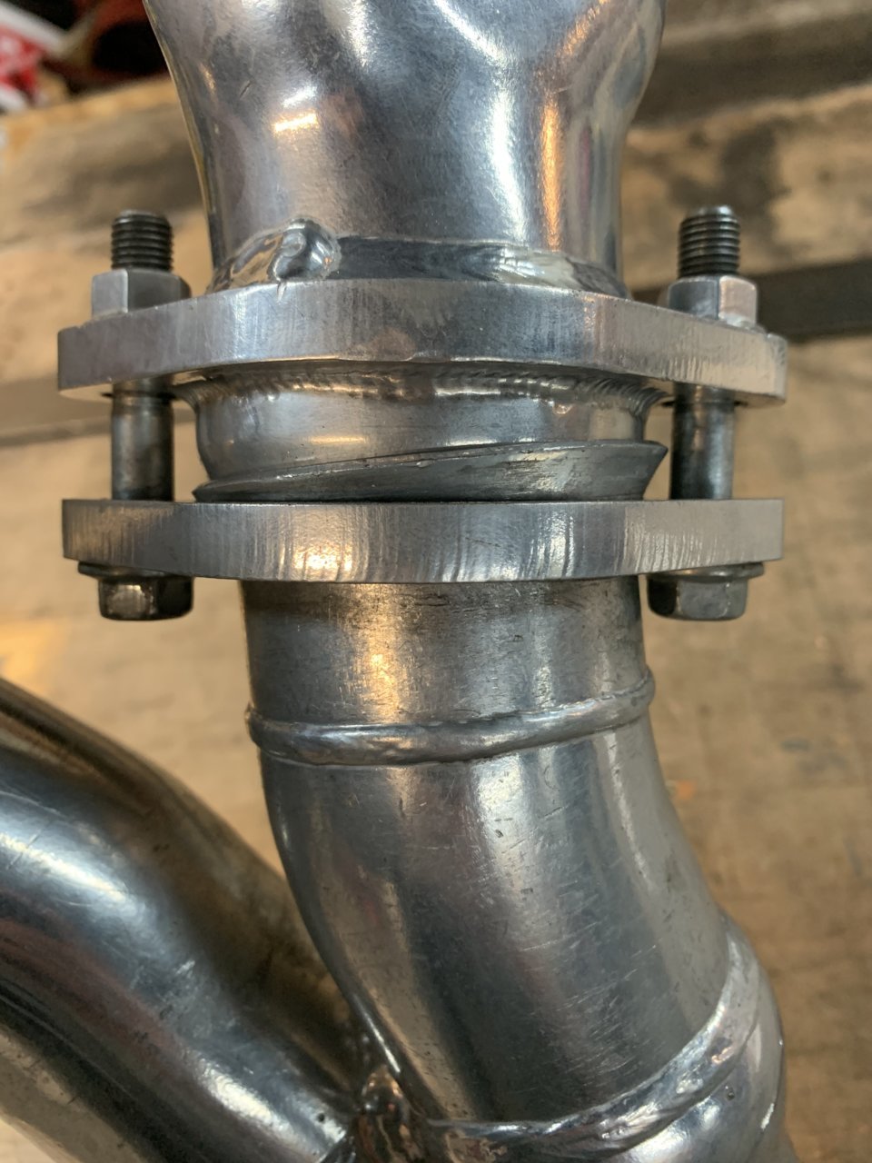

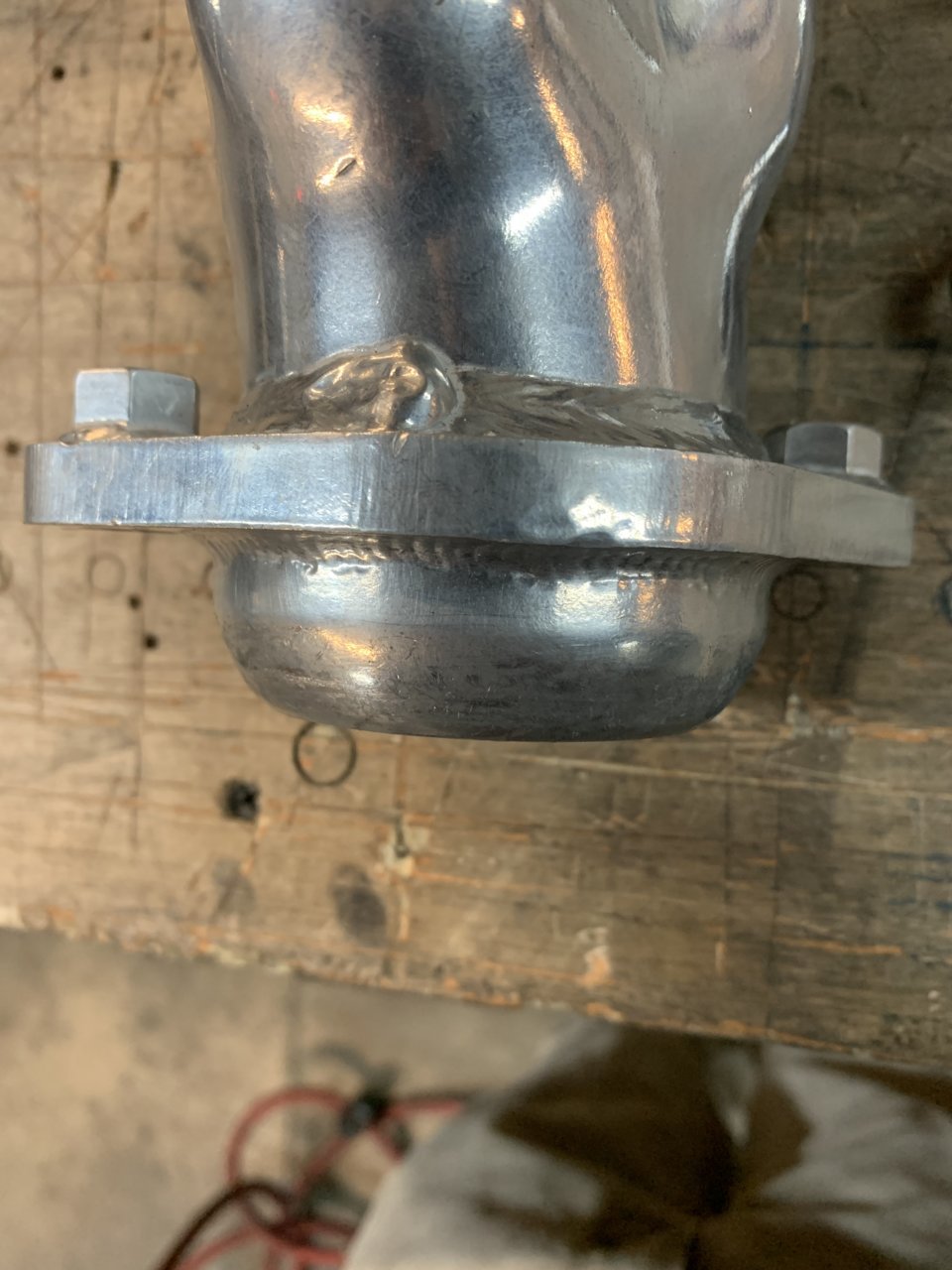

    here’s one of the original issues I had. This is one of the pictures I sent to thorley and the next email response was to send them in.
    It’s worth mentioning that I did not hulk these bolts down. I used a 7” wrench and got it hand tight. I do not want to make it so tight it stretches the female flange possibly making matters worse.
    But it also important to note that the flanges do not mate up straight on the truck no matter what I do. So I’m afraid that if I did end up hulking it down that it would end up creating a warped female side flange because of the way the male side is shaped.
    This may be sort an exaggerated example of what I’m getting but it’s a good example. Notice the bolt on the right side. Yeah, no matter what, because it always wants to rub the y pipe it’s a complete bitch to tighten. My ONLY option is an open ended wrench through the wheel well flipping it over after each turn due to limited space. If you used open ended wrenches in tight space you know what I mean by flipping it over.
    Here’s a good picture of the bevel you want that female side to mate up to. I’m not a flange engineer but I would assume you want that male side to slip right into that female side real nice and straight. If you have to really shove it in there like you just don’t care you might hurt something and that flange will never forgive you. You’d hear a constant noise every time you turn the truck on.

    Posts like these is exactly the reason my exhaust is still stock. I can’t see the advantage to all the aggravation. If they fit perfectly every time, I’d have a set. The test fit on an engine out of the truck on an engine stand, like you said you were going to do, will be the determining factor. If it fits the same as your engine, I’d take photos of every angle that I could, and send in. I hate to say it, but it’s the truth….you’re being too nice. I have this same problem most of the time. You’re going to have to squeal louder to get some grease….

    Here’s a pic of mine. The flange sits a little out and flush with bracket. 8A807C03-6C1D-4939-84EF-67883C65C295.jpg
