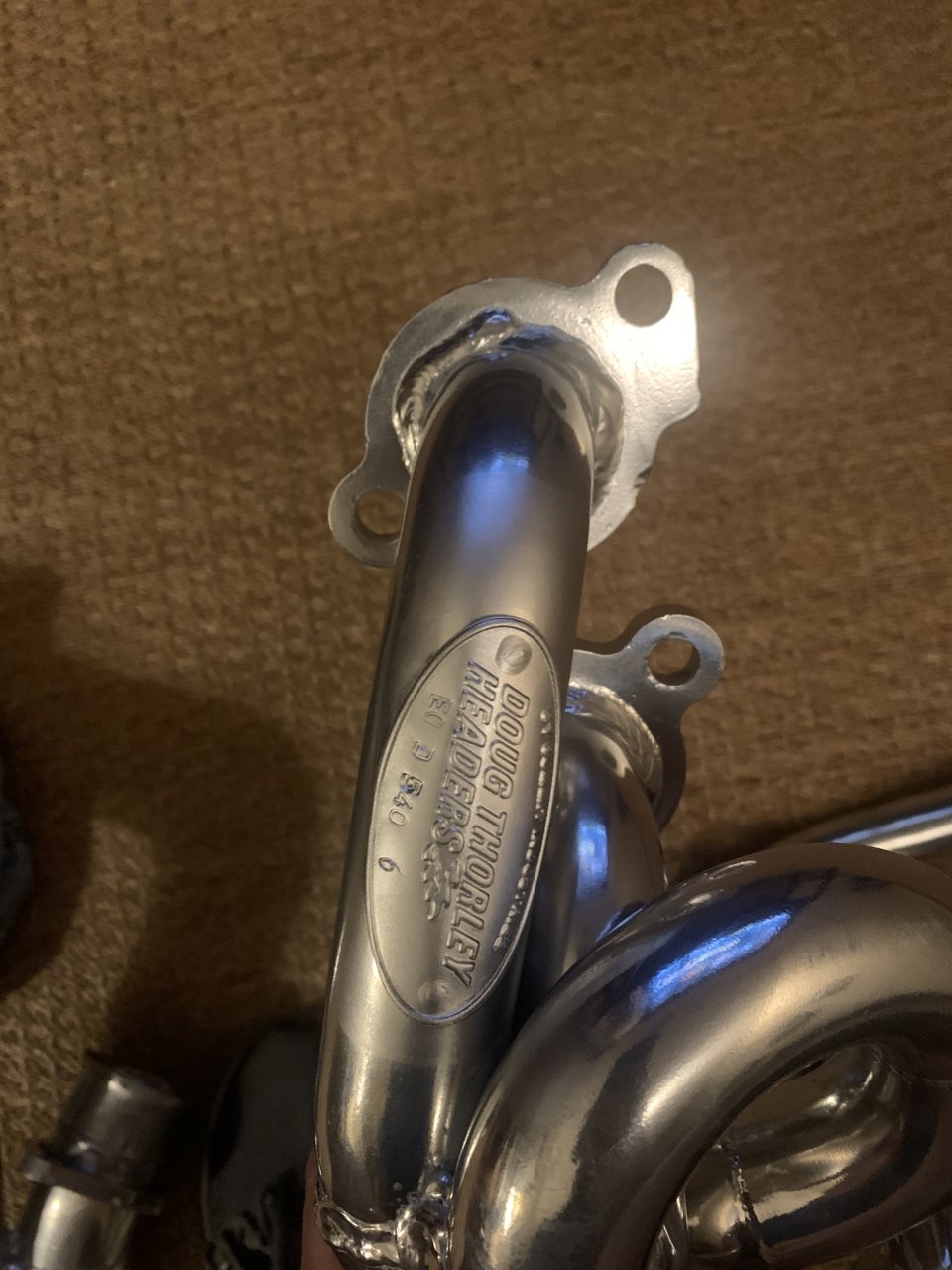

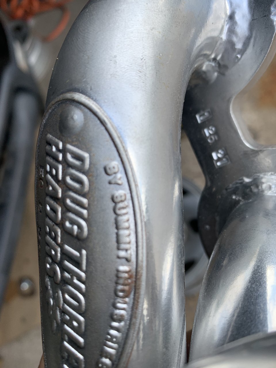

    I think they spray painted the name tag. Looks like everything else has the correct coating, you could probably clean that off with a clorox wipe and some elbow grease. But again you didn't pay for good money to have extra projects and requirements. If you wanted cheap parts you would have payed for cheap parts.

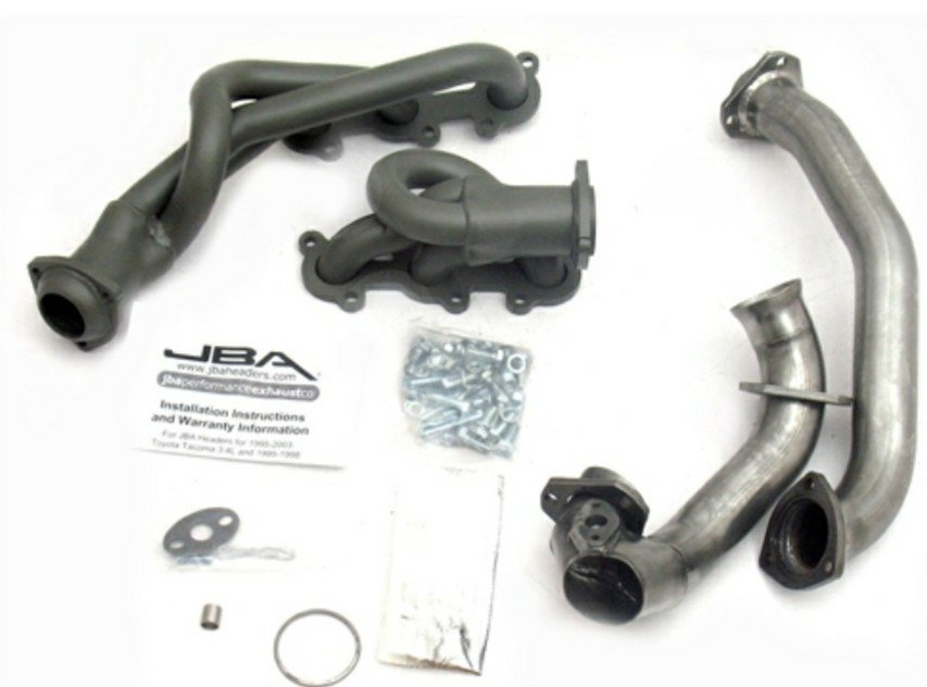

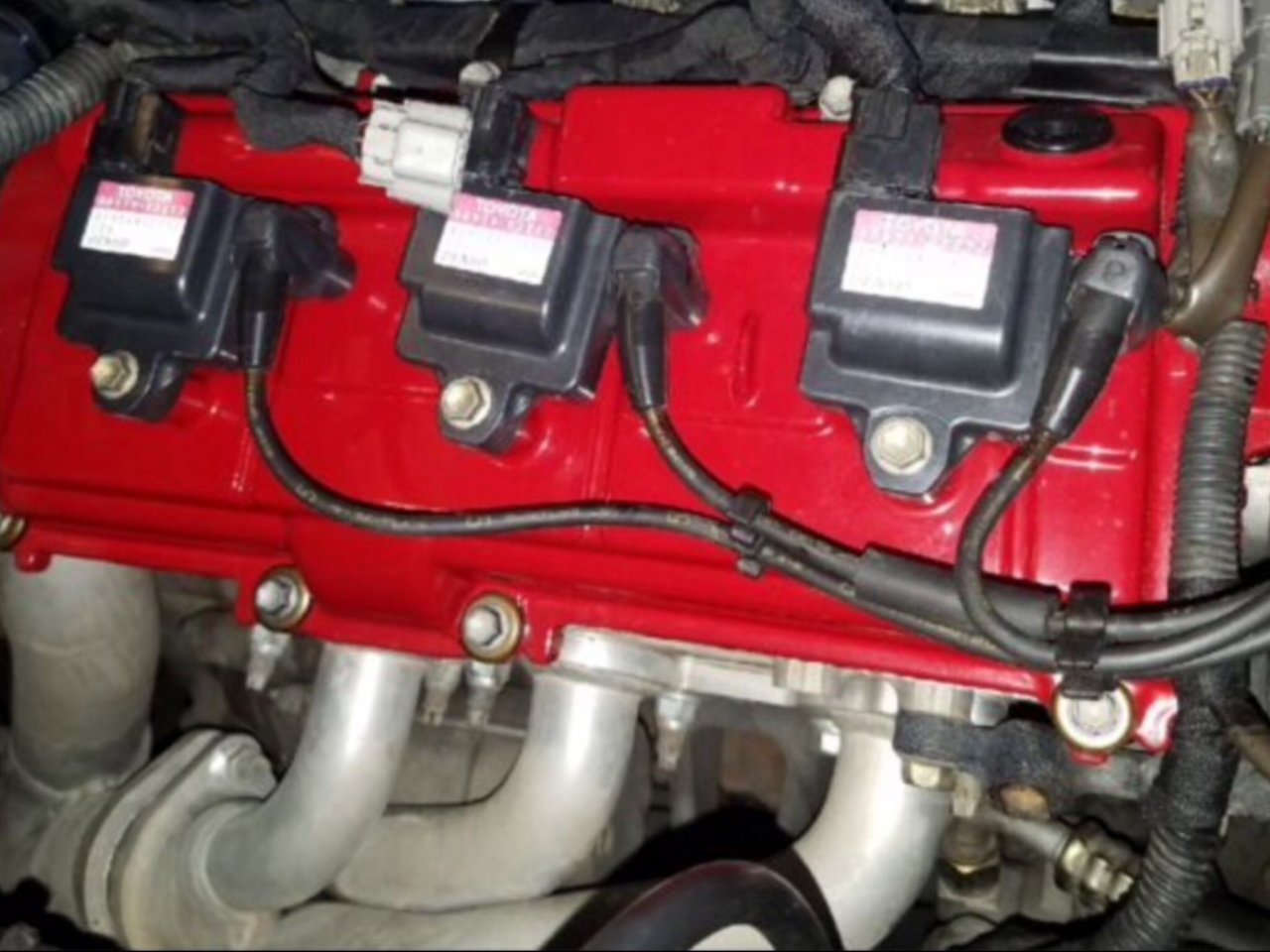

    You all three touched on the2 bolt flanges of the DT's headers and I can't help but to wonder if the 3 bolt flanges on the JBA headers are the way to goScreenshot_20210621-123708__01~01.jpg

    Sure. And that isn’t something I haven’t considered. However, brand new out of the box the plate is ceramic coated just like everything else.
    Also, within a short period of time I’d assume that plate would be rusted to hell with the heat cycling and humidity levels here. Especially for a spray paint that is so easily damaged by acetone. It won’t last long to environmental extremes

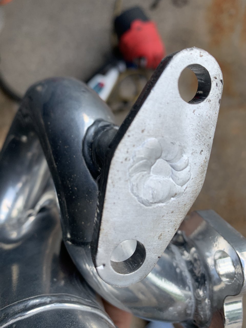

    The EGR port that they welded shut seems to have the same looking spray paint. So I just have a theory that they welded the EGR shut and changed the plate with the CARB number after it was “ceramic coated” or maybe it got knocked off and they did what they could.

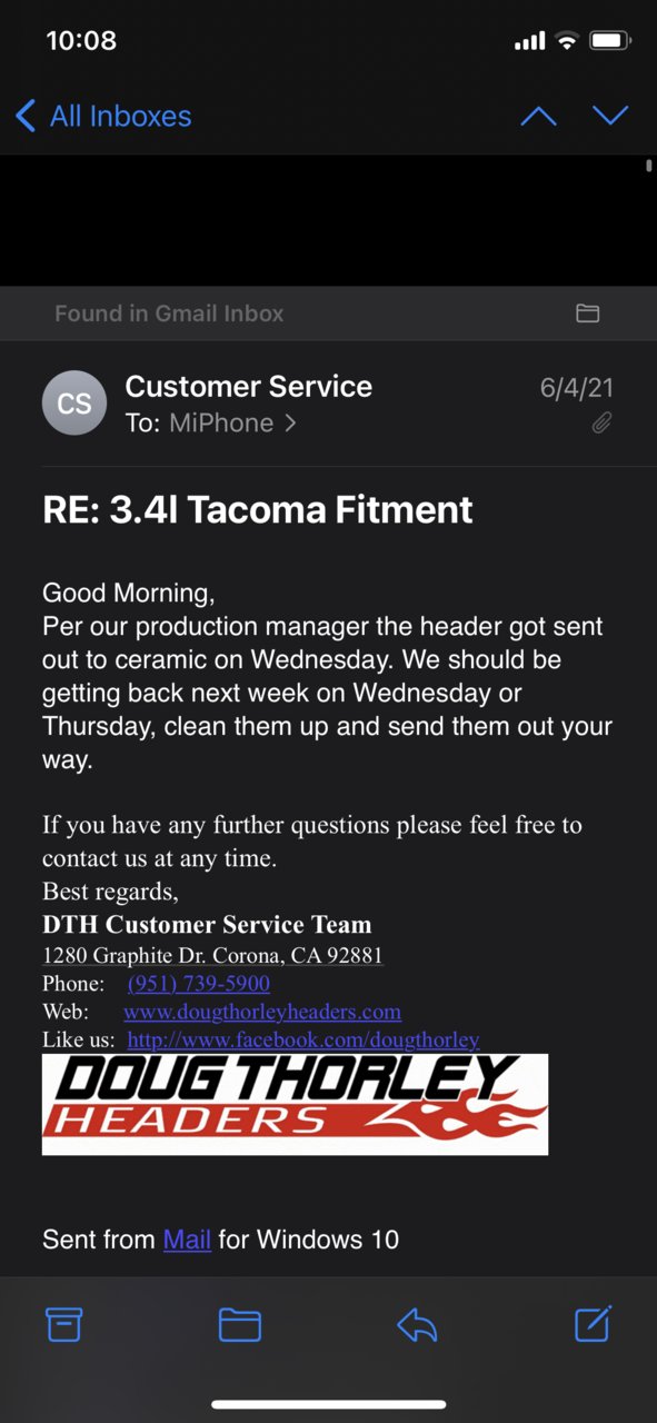

    Oh, and I’m still waiting on that call from DT like I was told was going to happen twice now.

    The flange design won’t do you any good if they aren’t properly aligned.
    Ritchie and unstpible[QUOTED] like this.
  12. Jun 21, 2021 at 12:30 PM
    #52
    Wulf
    Wulf no brain just damage
    Jan 30, 2015
    #147523
    61,812
    rock raisin
    They may not be fully welded. I have JBA knockoffs and the 3 bolt flange on the crossover pipe isn't welded to the pipe to account for alignment issues...
    of course the fitment is still trash and they leak.
    unstpible likes this.

    Here’s the driver side welded shut EGR header I was sent. Surface rust showing though less than a week after receiving it. Notice the dull sheen.

    I looked at the jba kit a while back, pretty sure welding is required to install them….just no. IMO.
    unstpible[QUOTED] likes this.

    The way JBA designed the 2 cat kit is that you cut the factory flange off of the cat and stick that tiny 2.25” end into the oval shaped JBA Ypipe.
    Purchasing $700 Headers that are supposed to improve flow to just then jam a restriction right into the end of the headers system.
    Rachelsdaddy likes this.

    To be fair you have to weld on the DT system as well. But they send you a flange to weld to the cat and it does not act as a restriction like the JBA does.

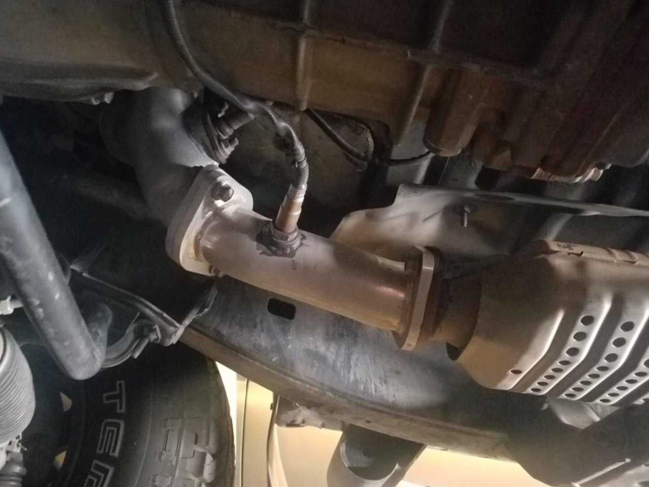

    When I installed the TRD system, same deal - had to find a guy to weld a flange

    Sorry to hear all your issues,
    Ive had mine on for about 30k,
    No issues, no rust,
    They bolt right up to the 1997 cat, no welding needed for my year except for the ERG tube for the early supercharger.

    Yeah, same here, no issues with mine either.
    FWIW, for anyone considering headers, IMO, DT is still the best option.
    There is no evidence that there is any advantage to a 3-bolt flange. It doesn't look like the problems Levi is experiencing are being caused by the flange type DT uses.
