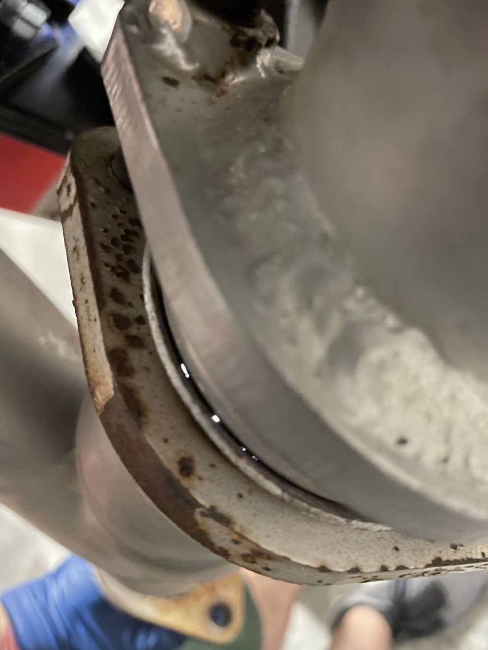

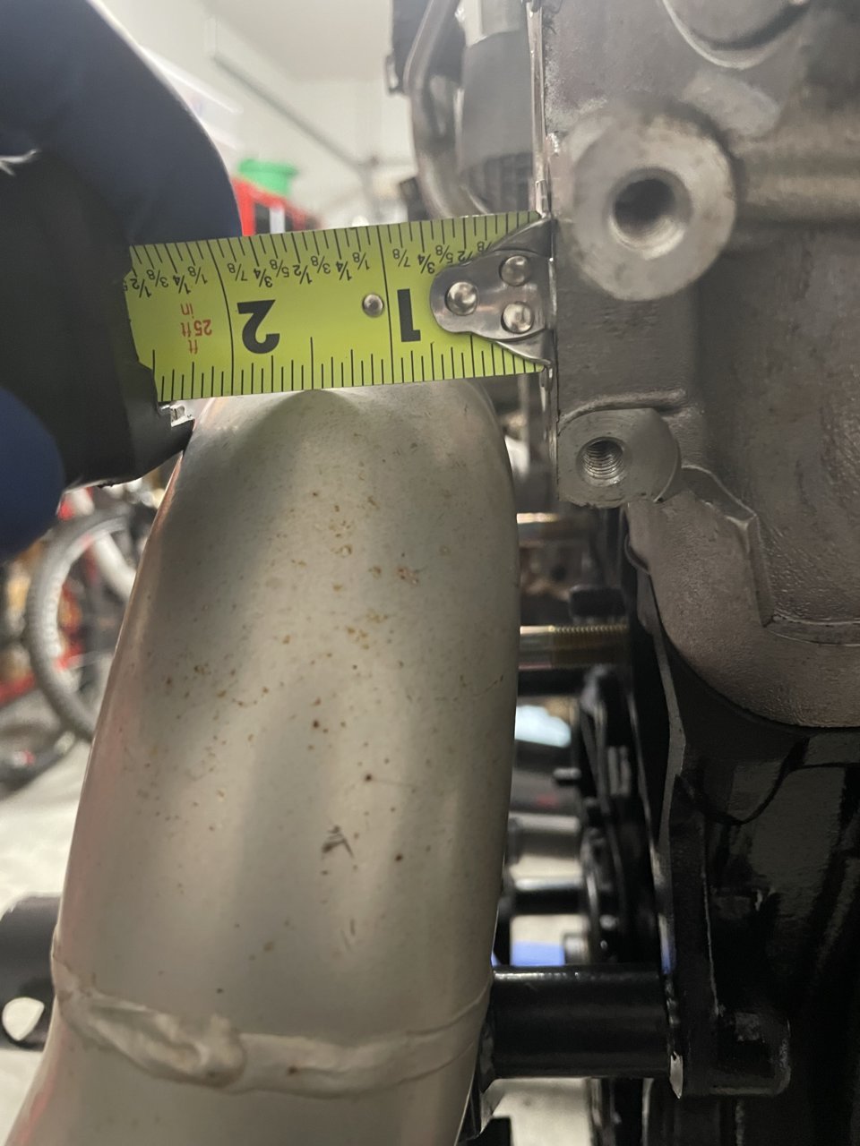

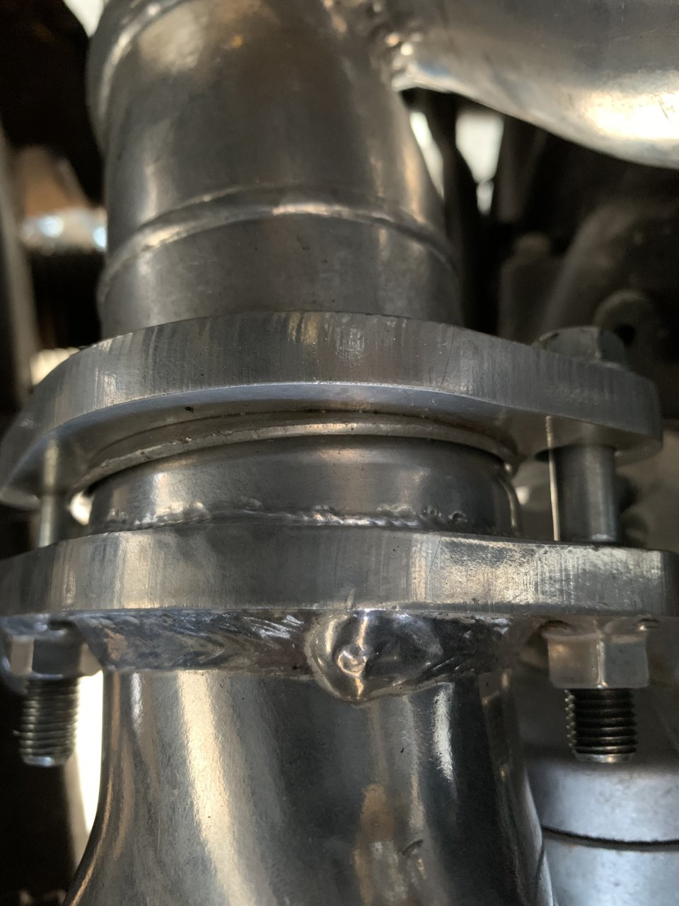

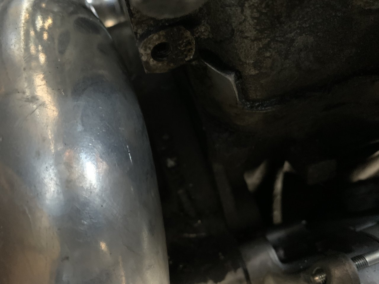

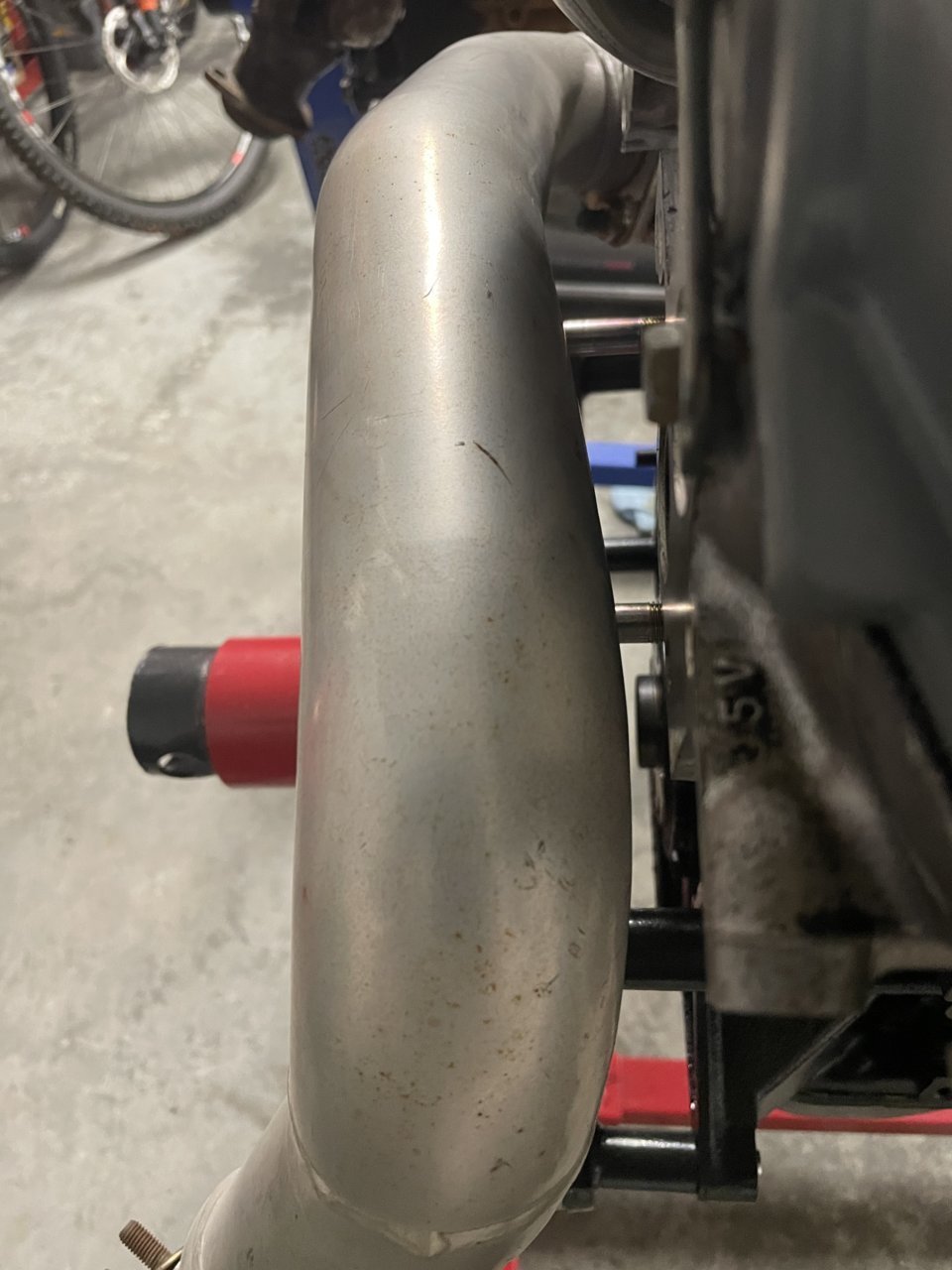

    As promised, below are some pics of the DT headers on an engine that is on a stand.
    Passenger side header/crossover connection:
    Visible gap between crossover and cylinder head:
    Same crossover gap with tape measure with reference:
    drivers side header to crossover connection:
    visible light at the pass. side header/crossover connection (flashlight shined upwards into bottom of crossover pipe:
    Edit to show the part number plate on the drivers side:

    I sent a novel of an email to them today and I finally got that phone call. Dude was nice and explained a few things but maintained that my headers fit the fixture when they had them.
    With the way the conversation went Im just going to have to install them and try to run them. I don’t have much of a choice really.
    And honestly this whole thing has left me so exhausted and im just so ready to get my truck back on the road and out of my backup ride I spent a few hours after work getting it together. Im just so sick of thinking about it.
    He was adamant that they they still have a warranty if I have issues after install and they won’t leave me hanging.
    Yours definitely looks more straight and exactly how I’d assume they should look though.
    I’ll admit that I’m able to get more room between the crossover and cylinder head. I used a 5GL paint stick stUck back there so I wouldn’t have to pay any attention while lining everything up But the flanges are noticeably wonky no matter how I do.

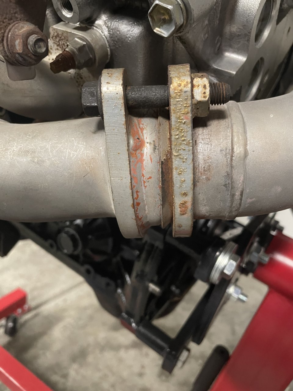

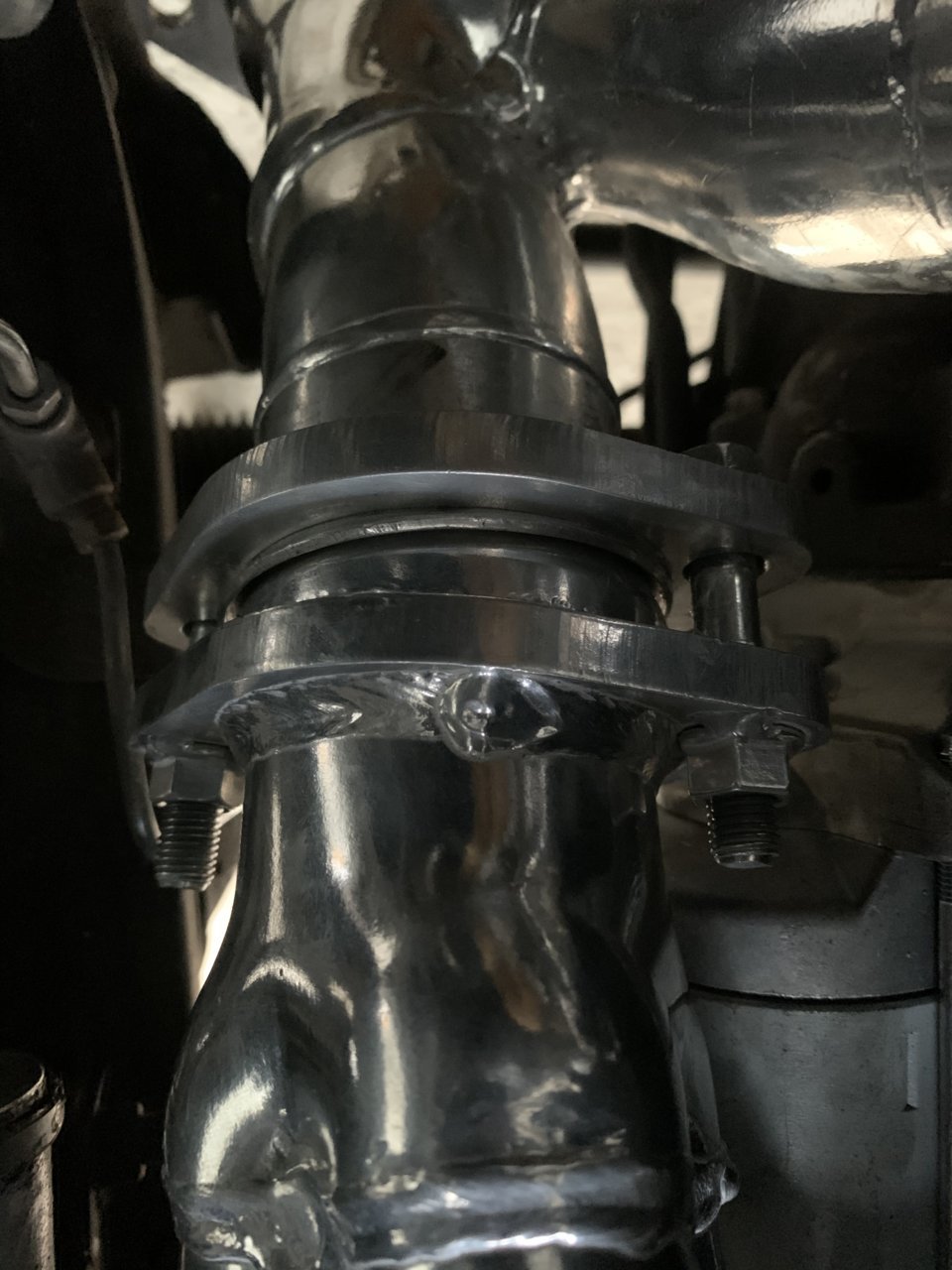

    This is just how mine is.
    The bolts aren’t uneven because ones tighter than the other. It’s because of the way that flare sits on male end. I have to crank down on the inner side to close the gap. I tried to explain this but Jamie at DT didn’t seem too concerned with it.

    Is it disconnected from the cats in this pic? That’s definitely a significant misalignment. Have you tried fully tightening the drivers side down first in an attempt to pull the crossover pipe over a little?

    Yes. Nothing attached further down.
    I don’t think I tried like fully cranking down but I did try snugging it up. Nothing seemed to change.

    I was told it fit the fixture more than once now. What does a fixture look like? How are they actually test fitting? Are they looking at every angle like we are? Or are they just holding the Y/crossover up to the flanges and saying “yep”
    I’m just going to try and run them. If I get leaks then I’ll have to go through this all over again. Hoping that won’t happen.

    If you have dicked around with these things enough you know what I mean when I say I can hook up the driver side and “swing” that Y pipe up and down. Or move it in and out of the passenger flange. No matter what, even if I leave the herders on either side sorta loose, semi loose, or no nuts at all I get that out-of-alignment flange.
    Hell, I can completely remove the driver header and it still will not go on straight.
    So I think either the passenger header is too short, the flange on the header side is crooked, or the Y pipe bends are not aggressive enough in the right places.

    got everything torqued and tightened the best I could. We’ll see what happens.
