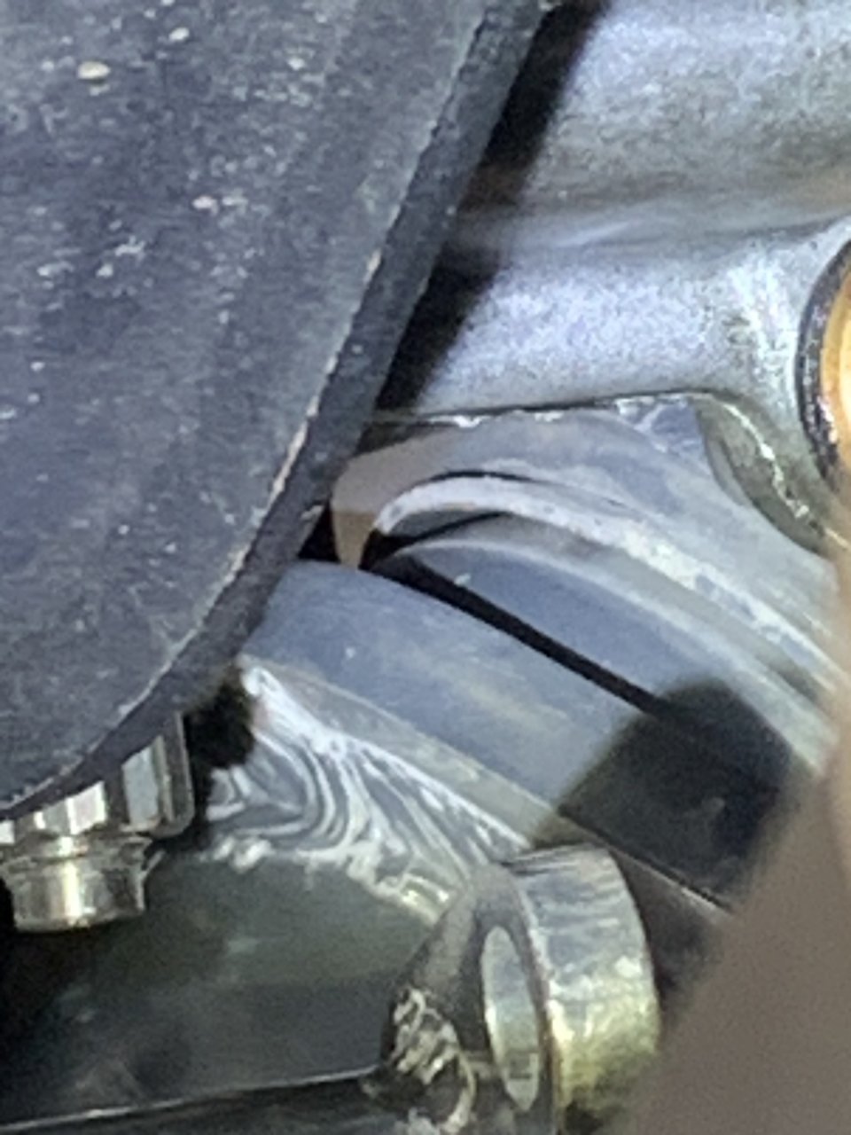

    Well here it is. This was predictable. Ball flange leaking on driver side blowing exhaust gas all over the #6 primary.
    Fuel trims have definitely been higher since the exhaust swap. This would explain my gas mileage being shit compared to before. Hopefully haven’t washed my cylinders from the false readings.
    I cannot seem to get these things any tighter than they are on the passenger side. I could bring out the breaker bar and really torque don on those ball flange bolts but I don’t want to break them either.
    I don’t know what to do. I had thorley on the phone trying to explain and they just act like it’s me and not the improper fitment.
    If I bring this is to thorley I’m sure they’d offer to replace or have me pay to send them back again for another look (again) But I don’t want to tear it all apart again just to have to go through this again.
    I knew this would happen.

    Man I know this just all around sucks! I wish I knew what to tell you to do, but I don’t know. You simply want what you paid for, and of course proper fitment without any leaks. I can’t believe that you’re still dealing with this! Maybe it would be easier to find a custom exhaust shop near you that can determine where they need to be tweaked and have them repair them.
    Maybe ask Thorley to send you another set? What’s the worst answer they can give you?
    You could play dirty and order another set, paying with PayPal, and sending the damn leaking ones back to them, after getting a good set.
    Maybe call them and ask them what they want you to do, other than shut up and leave them alone. Idk, without cooperation from them, you’re dead in the water. They should honor and take pride in what they build and sell. Mistakes happen, they should be the ones to eat it, not you. Just removing and replacing is hard enough as it is!
    It should be clear that their “building fixture” and your long block have some differences. Which one is wrong though? Tell them to send you a technician to install them the proper way, haha!!

    I’m not going to anything dirty. That’s Just asking for trouble.
    It’s not the block. It’s the wonky mating of the ball and socket flanges. Neither side mates up straight no matter how I angle it. I must have tried to fit the crossover a dozen different times taking it out and the in again.
    Anyone that says it’s the block or anything like that is just making excuses.
    I REALLY don’t want to pull this apart for any reason again. It’s lawful.
    So I’m thinking about what I could do to seal it up. Exhaust sealants tend to be shit. one video showed JB weld 2000+ degree sealant crumbling after one use. And the dry times are unacceptable.
    I’m thinking of taking graphite impregnated fiberglass rope cutting it thin and stuffing if in the crack as best as I can. Then taking some white fireplace and grill sealant and packing it in there. That way there’s something pliable in there with something to seal it in and if I get a leak I’ll be able to see it.

    It’s good for you not to do anything dirty, even though they aren’t exactly “playing pretty”.
    You might be heading in the right direction as trying to build a gasket for the flange. Some exhaust band clamps come with aluminum foil to pack into the cracks to seal it. You might could try to build a donut gasket out of aluminum foil, or find a donut gasket around the same size as the flange and let it crush into place.
    Just something to also take into consideration, I installed a pyrometer on my truck, it’s beside the upstream oxygen sensor. I have no idea what a safe exhaust gas temperature would be on a gasoline engine, as it’s not uncommon for the headers to glow on some gasoline applications. My truck is also supercharged, and just cruising around at 55mph my pyrometer hangs around 950-1000 deg F. The highest I’ve ever seen it running the truck at full boost over and over on a 100 degree day was around 1300 degrees. And take in mind, that’s on the down tube right beside the upstream oxygen sensor, and my catalytic converters are gutted….
    good luck!

    They need to switch to flex pipe over this ball flange, obviously. I dicked around for so long trying to get my custom crosspipe to mesh behind the engine perfectly, then decided I needed to consider alternatives. The flex pipe is a lifesaver.

    I ended up torquing the bottom bolt to 50ft lb. that’s the max you can go on a that size bolt 10.9 grade. So we’ll see how it goes.
    They get quite hot. Products I’m looking at are rated for 2000 degrees. So I should be good.
    Yeah. I guess if I have to take it out I’ll have to just add in flex pipes so I don’t have to send anything across the country again.

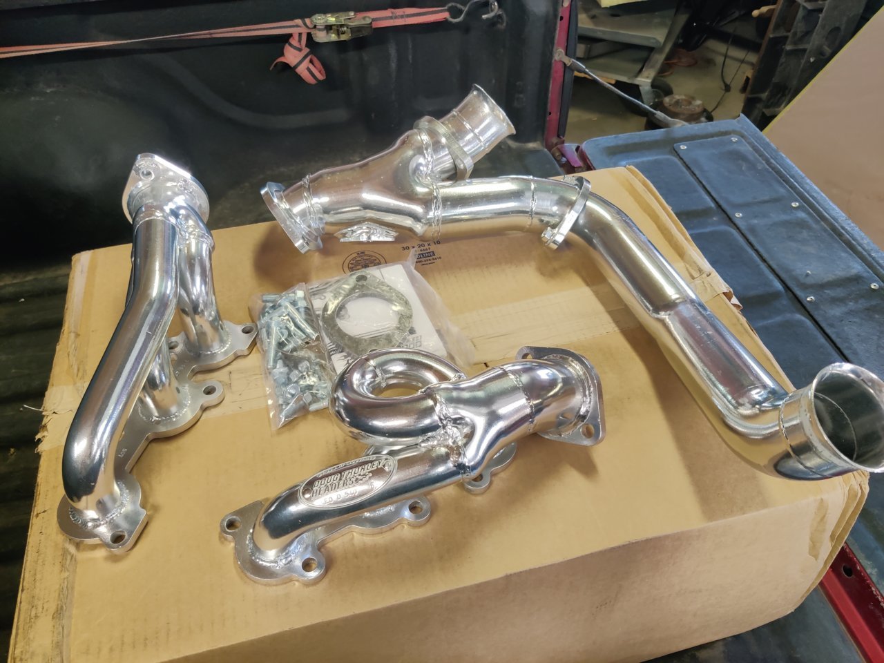

    My Christmas presents finally arrived
    Install should be next Monday :fingerscrossed:

    V6 5sp,RegCab,TVS1320 Supercharger, 56mm pulley, methanol injected Haltech ECU, AC Tvs1320 supercharger,(MUST DO) every 125,000- 150,000 needs rebuild Projector headlights HID 5 speed manual Amsoil for all drive train Smaller 56mm custom pulley, (MUST DO) 2004 DESNO fuel injectors, zero ping ping, 2004 side door mirrors Dick Cepek Rims, Michelin tires LTX, ATM Pathfinders Dynopro ATM ( that last 100,000 miles) Now running Dynopro ATM mud and snow tires KN cold air intake Cat back dual exhaust with ss exhaust tip, Raised exhaust tail pipe to 2" below body line Optima*dry cell battery,red top Alpine sirius radio, 200 watt amp, focal is165 split door pod speakers Focal door speakers Subwoffer behind seat Viper alarm, Electric Locks Dark tinted windows, bucket seats corbeau lg1 Tacoma Rubber floor mats TRD fender extenders, Bilstien shocks, King shocks JBA UCA trailer iv hitch, electric brake control, Drilled slotted brakes, High carbon steel (MUST DO) EBS green stuff 7000 series pads(MUST DO) TRD engine oil cap TRD stick shift, Marlin crawl shift kit. Rear sliding window 2002 4Runner functional hood scoop cut into Tacoma hood, 4Runner dual overhead map light Gentex Auto dim + Compass + Temp, garage,rearview mirror Snow Methonal kit stage 2 Custom 3 core aluminum radiator Linex bed liner Haltech stand alone ECU, Intake supercharger gauge. Stainless steel brake lines, Custom leather wrapped steering wheel, Haltech stand-alone ECU,
    Buying them was the easy part of this mod ,
    Good luck and no cursing,
    Make sure you retighten all the bolts in a month or two also,
    I had one that worked it’s way completely loose
