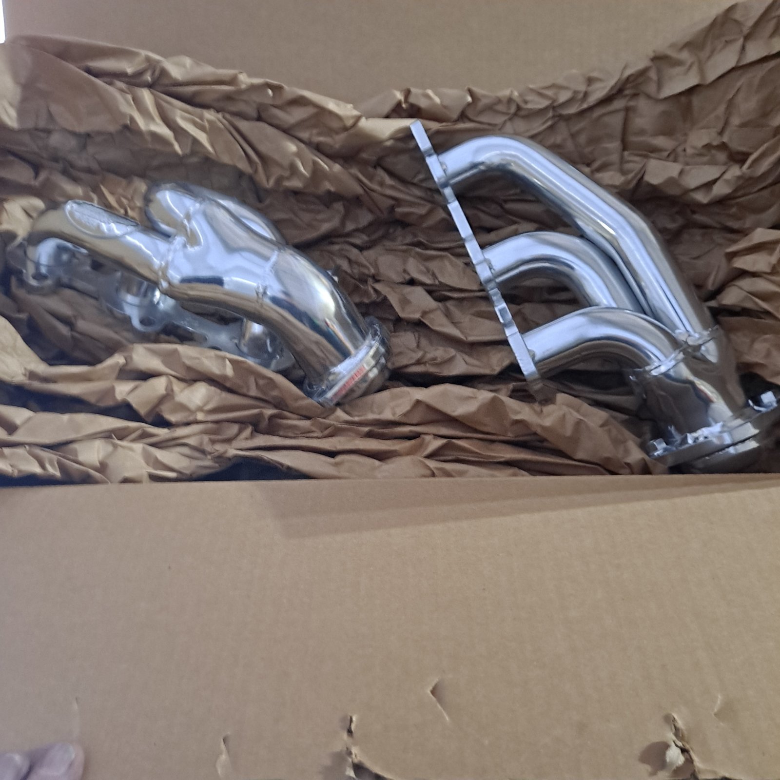

    When you say the bottom bolt, 50ft, is that the ball socket bolts?
    If not what should the ball socket bolts be at?
    I had the drivers side crack and replacing the two headers under warranty and I forgot the torque.
    I forgot what a pain and time consuming project this is and knuckle buster.

    This is disconcerting. Do you have any pics of the crack? How many miles are on the headers?

    It's the EGR connector, most don't have it.
    Got it all installed and torque the exhaust ball joints at 35 pounds.
    No leaks
    Warranty covered it.
    Probably around 80k on them

    That sucks. Yeah, I don't have one of those. '96 & '97 only for Tacomas. Broke at the welds eh? Probably from vibrations. Might need more support.

    I sure wish the headers would stay all shiny like that
