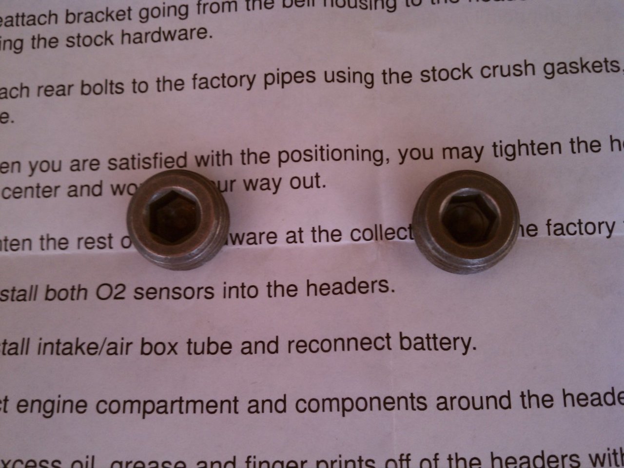

    I got my headers last week and i am going through the install manual and I am a bit confused.
    1. Where do the screws shown in the picture below go to?
    2. What are the factory torque specs for the nuts on the exhaust manifold and for the exhaust pipe?

    when u pull the old manifolds off, u have 2 o2 sensors. now, on your headers, u have 4 holes to put 2 o2 sensors into. to fill the other 2 holes, u need those screws

    What size allen wrench does it take? The largest one I have does not fit.
    I am also assuming the O2 sensor will go into the hole on the center tube, closest to the manifold and not at the end of the header. Is that correct?

    i am not sure what it is. maybe 6mm?
    yes, unless u bought the extension harnesses too. this is what i did, but most people put the o2 sensors into the "stock" location which is in the center tube
    you use the o2 sim on the sensors that are in the y-pipe that are right infront of the second set of cats.
