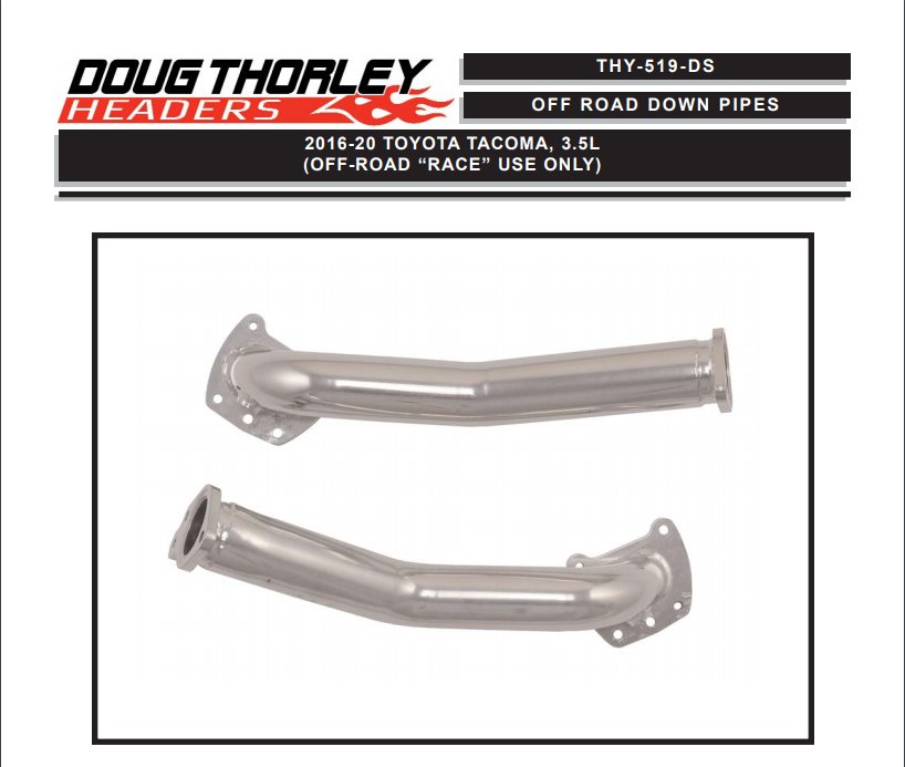

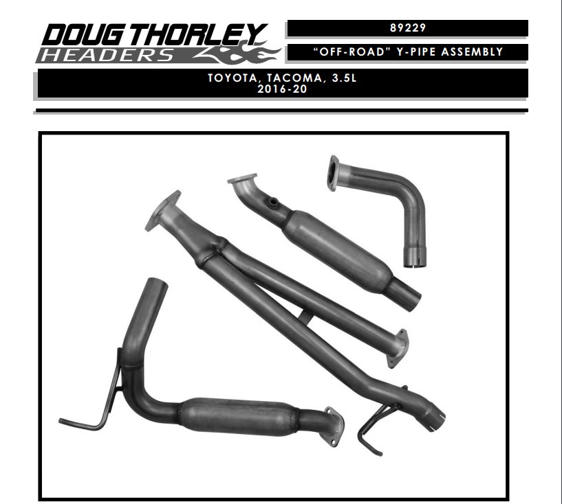

    So, I'm looking to complete my exhaust system and one of the guys I work with recommended this to me for down tubes and mid pipes. Has anyone in the tw ran these by chance im getting a steal 35% off on em cause he worked for them for 12 years. I know its a cat delete and would have to flash my ecu cause the truck will start running super lean but if anyone has any input feel free!

    Not CARB legal, you will fail smog with those installed

    Y pipes delete the rear cats but that kit looks like it has a couple catless downpipes, is that the case? that's deleting all four cats. is that your plan?
    i have the URD Y currently, rear cat delete and OV tune. i did delete the fronts for a day but i had a leak and couldn't evaluate so reinstalled the stock front cats but am still on the full Y& 3" mid.

    Yeah this is a full cat delete. But i mean is that just too much ? How do you like the sound of yours currently ? And how are you looking with fuel efficiency ?

    So back to this thread. On the 89229 One of my guys that works for me used to work there and I can get em for 320 but he told me to contact URD (Underdog Racing Development) To get new O2 Sensors because deleting the lower cats will cause a check engine and make the system think it running too rich/lean when it really isn't. Any take on this ?

    Yes, I am a '16 with a 2GR-FKS ! Talking to the guy over at doug thorley. From what I heard they were going to come out with a full exhaust system but never went public with it. I may be able to get my hands on this so we will see but my question still stands. I called them over there at URD and they stated I don't need to change the O2 Sensors Unless I do a full cat delete :confused:

    deleting the rear cats alone doesn't typically throw a code. that would happen with all 4 gone for sure.

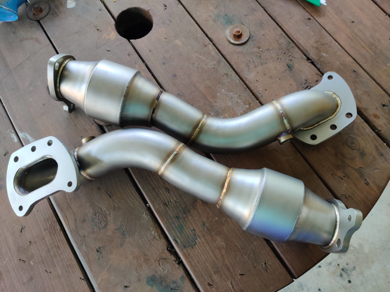

    coincidentally, my truck is torn apart right now getting the stock fronts replaced with the OV 200cell high flow cats. and some other stuff, should be done this week. if i have any codes I'll handle them in vF Tuner. but i don't expect them or tuning issues by now.

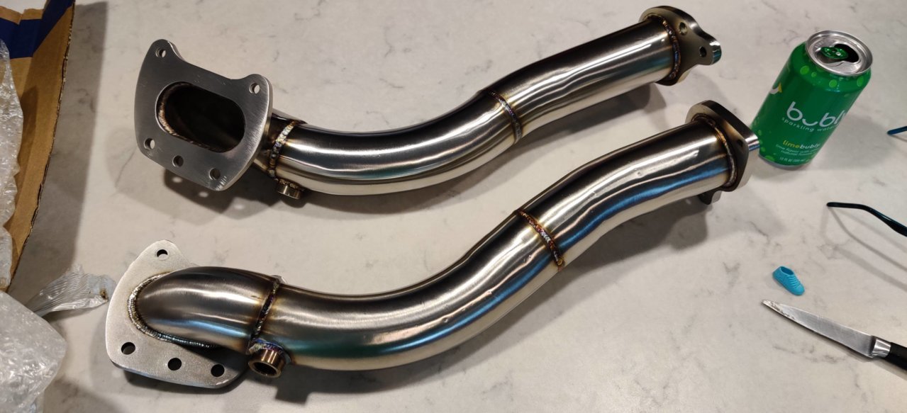

    the front catless below threw codes, yes, but i couldn't assess any tuning issues, because they were installed wrong and leaked in the cab badly, so were removed the next day.
