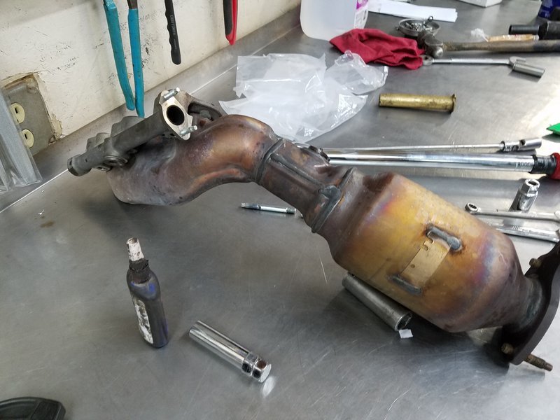

    The cats are welded to the factory manifold.
    Without the cats the sound changes a lot. You'll have a Check Engine Light too.
    Since you have an older 2nd gen you might get away with the URD O2 Simulator. It doesn't work on my 2015 though.
    You could have the cats cut off and welded onto your exhaust behind the headers though.
