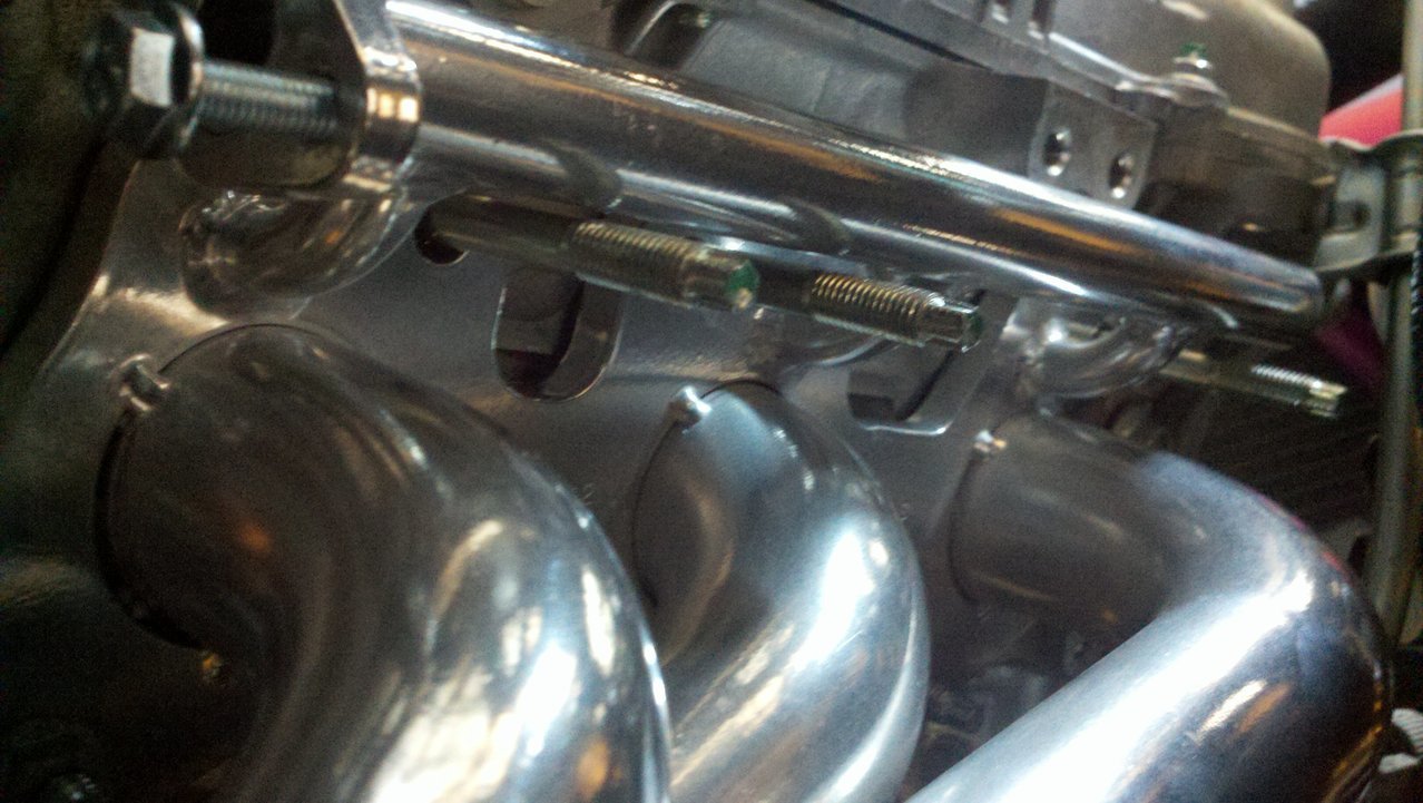

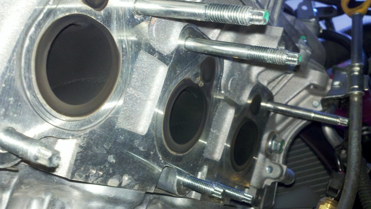

    I received new DTLT headers for my 2012 Tacoma but have an issue. The manifold studs on the top are too long for the DTLT header flange to be held on by the nut. Has anyone else had this issue with their install? For now I will tighten the lower nuts and use washers on top to fill the space up to the threads. Maybe I am missing pieces?

    Installed the passenger side with only the bottom nuts on, was planning on spacing out the top nuts with washers but the air injection tube is in the way. No way to secure the top unless I put the nut on and tighten it against the tube, which I'm not going to do. Oh well, hours down the drain and I still have to put the stock back on :mad:

    I replaced the top 3 studs with shorter studs that I got from AutoZone. They are a little longer than the bottom studes, but they work!! Passenger side is done, on to the driver's side.

    I wouldn't say that, they fit great once you swap out the studs. Everything lines up nice with the collectors and air injection system and whatnot. Just definitely not a easy swap like they were on my 2006. It would have been nice if they included replacement studs or at least documented that replacing the studs would be necessary.

    I (well, my mechanic technically) didn't go the shorter stud route for the DTLT's on my '13.
    We left the bottom studs in tact and replaced the top studs with high grade bolts and lock washers from HD. Once you yank out the top studs using a Torx socket, you can figure out just what length you'll need for bolts.
    ...or shorter studs will work just as well.

    I swapped out my stock headers for the long tubes a while back. The way I handled the long stud issue was to swap out the longer studs with bolts:
    • 6, M8-1.25 x 30 bolts
    • 6, 8mm lock washers
    • 6, 8mm flat washers
    Ive since put about 5k miles or so with no issues. I put the lock washer on first, followed by the flat washer.

    I got my shorty headers with all new bolts.. But you cant use the supplyed bolts on the top because there's no way in hell you can thread and tighten the bolts down.
    The best thing to do is use there new supplyed bolts on the bottom and move the shorter studs (the bottom studs) to the top. It works perfectly!
