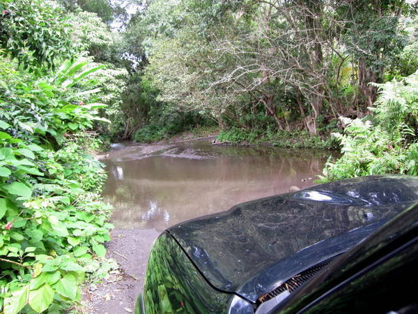

    Yesterday, I was off-roading in the back of a Valley visiting friends. I had to cross 7 rivers to get to their house, not deeper than a couple of feet, some as wide as about 40 ft across, most about 20ft. So, lots of water, but not too deep or anything. The road is dirt/pot holes/patches of pavement. On my way back from their house, at the last river to cross, there is a large paved hump then a steep incline to the drop off into the river. I stopped at the top of the hump to check out my approach, and then let off the brakes a little to roll down into the river. I was braking going down the hump, verrry slow I will add, and my brake pedal sunk and my brakes just stopped working and a loud weird kinda shuddering noise happened, and since I had no brakes, I slid into the river. Splash. Then I crossed the river and drove on muddy road for a few minutes, and was on a slight hill when I heard a car coming around the corner, so I braked to pull over to let them by, and my brakes did the crazy noise again and no more brakes, then I slid a little and then they worked again so I could stop. What the hell?!? What's going on with my brakes?
