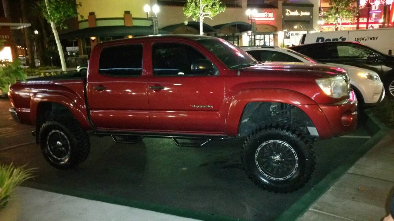

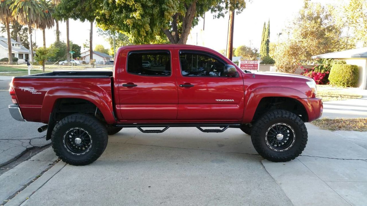

    My truck with 35x12.50r17 toyo muds6afecafe56e6f175d64307b7b5d1dfe6_55f09feb1aceee1fbf01011cf810cb9c1f04707b.jpg
    And then 33x12.50r17 micky thompsons177161585aa19e813ebdcb4dfdde0eff_7290f0203dc52bba2573b64373475d894bc72ea3.jpg

    Your best option for you would be to replace the front shocks with the rcd longer 5100s. This will put you at 5" in front with your stock coils. I know rcd has the lift advertised as a 4.5 but it actually lifts it 5 in the front. This will give you a better ride and lower it a lil plus you can run 33's and it will look fine. In the back just replace your leaf pack with some expos with will give you 4" in the rear. The p/n for the longer bilsteins is f4-be5-e122-to. I ran these same shocks on my db lift and then you won't have to run that big top hat spacer and the ride will be a lil better also.
    Please don't buy a rough country 4 or 6" lift. I have had a few people contact me with having problems with that lift. Because of the fabtech lift they cut the full length of the front and rear crossmember so you could weld in a new crossmember using square tubing. I have seen a member on here do this going from a fabtech kit to lt. It seems like alot of work to me to go thru all that just to come down 2 inches.
    Just run some 33" and if you do like i recommended above you shouldn't have any rubbing issues at all.
    I had a 4" db kit on mine and bumped it up to 6" while running 33's and liked the look of it.
    fyi If the previous owner had installed any other db kit on your truck bds/zone/rcd/procomp etc since your are 2wd they wouldn't of had to cut the crossmember at all.

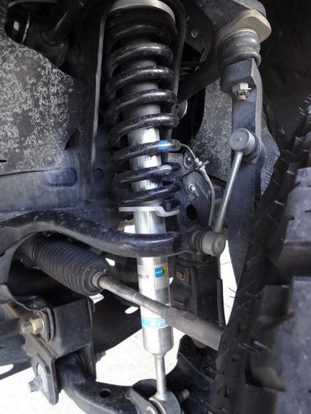

    No I was saying just change your front shocks with the bilstein f4-be5-e122-to which is the shock used on the rcd kit. This will also eliminate the top hat spacer on your kit now and lower you down to 5" in front. Link below to where you can get them.
    On the link the price is for 1 ea.
    http://www.cumminsperformanceparts.com/rcdf4be5e122t0.html

    Is there any pictures of this shock?

    Here ya go
