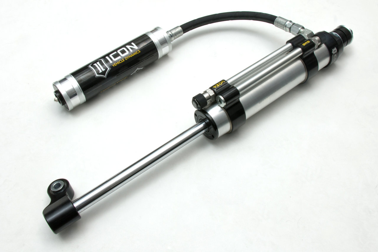

    The OEM design relies on the shock to limit the rear travel. Most aftermarket options are also designed the same and will use the shock to determine down travel. The leafs are usually capable for more travel then a shock mounted in the factory mounting tabs/shock mount.... Unless of course you get crafty with shock mounting to allow for added travel while still mounted in the stock location:
    http://iconvehicledynamics.com/shop/715-2016-up-toyota-tacoma-rxt-rear-suspension-systems
    It's common for a longer/"Ext" shock to be used to allow you access to the added down travel but it's trade off. A shock with a longer compressed length then stock will require a bump stop spacer or a longer bump stop to prevent the shock from bottoming out. So you can get more down travel by limiting compression but your overall travel remains the the same.
