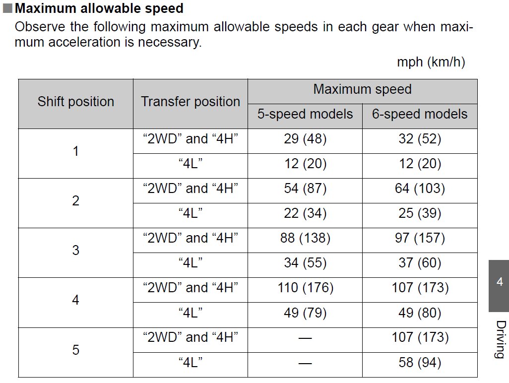

    I believe the owners manual has 25mph as the limit for 4LO.
    Same exact issue with grinding gears; I shift a lot slower an “ease” it into each gear when I’ve got it in 4LO. This seems to be normal based on my experience. I never grind gears in 2HI / 4HI
    I’ve been all the way up to 5th gear in 4LO; helps with steep descents (engine braking).

    My 2017 Owner Manual

    Anything over 20mph is 4HI territory.
    I hate the howling of the engine and trying to keep up with the trail mates.
    I use 4LO for challenges and hills. Not for entire trails.
