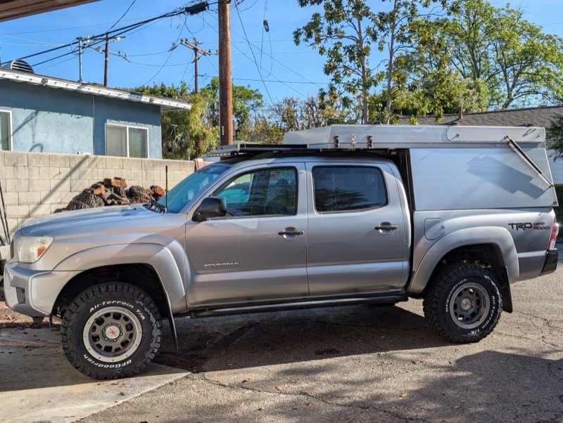

    I really tried not to make another 265/70/16 vs 265/75/16 thread, but here I am.
    I currently have 265/75/16 Cooper AT3 (C load range) tires on my truck. I have no complaints about the tires, they've worn well and have handled as well as I could ask off-road. I went with C load range because the truck has a full-time topper (AT Habitat) and is usually loaded with our camping gear--sure it meant a little more weight and the expected loss of MPG, but it's an old Toyota truck so I never really had high hopes for MPG anyway. I went with the slightly bigger 265/75/16 over the stock size because they fit without any modifications, and being just slightly bigger gave the advantage of slightly higher ground clearance without too much compromise in performance (gearing, acceleration, etc.).
    We're now switching our camp setup to a heavier slide-in camper and in preparation for that I'm making the switch to E load range tires. Obviously with the jump from C to E load range, there comes more unsprung weight and with that I expect worse acceleration and fuel economy. So I'm thinking I'll drop back down to the stock 265/70/16 size in an effort to reduce the impact of that added weight. I suspect that the smaller diameter may also help acceleration "feel" improved due to smaller gearing, but it'll probably be unnoticeable (if there's any truth to that hypothesis at all).

    Following in your footsteps essentially, going from an AT Habitat to a Scout Yoho.

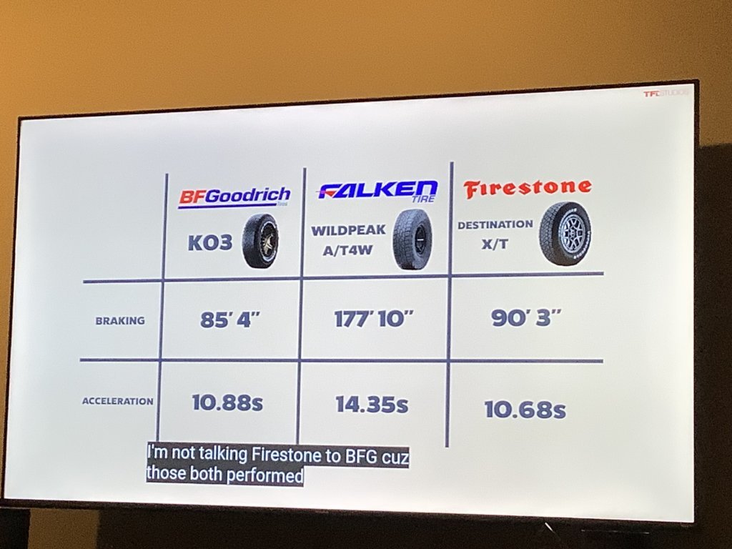

    I’m running 285 70 17 C load with a canopy, winch, small lift. On a non stop 283 mile road trip Kamloops BC to Jasper AB with 51lb KO2 285s and a 60mph speed limit I got 21mpg. Lots of hills, Truck felt great with 51lb tires.
    I’m now trying Falken AT3w in the same size and load range but they weigh 61lbs, holy chubby! On a recent road trip again from Kamloops to Tsawwassen Ferry terminal non stop 282 miles I got 19 mpg. 60 and 70 mph speed limit.
    Surprisingly not that bad considering a couple mtn passes and 10 pounds extra per tire.
    If your concerned about snow get the KO3 or check out the Firestone Destination XT, they kicked the Falken AT4 butt in snow and ice performance. I’d stick with 265 70 16 size tire but in E.
    Screenshot is from YouTube - The Fast Lane channel starting and stopping from 30mph.

    That's an interesting datapoint on the KO3s, thanks for pointing me to the FLT review! Tire Racks recent comparison that featured the Stronghold, KO3, and A/T4Ws up against each other in the "LT" all terrain comparison (edit: whoops apparently the Falken in this test was NOT an LT like the KO3 and Stronghold) showed the Falkens as a better performer than the KO3 and Stronghold--it's the only reason the Falken was on my radar. I'm actually surprised at how poorly the Stronghold did in their review because my AT3s have exceeded my expectations in every way but it seems the Discoverer Road & Track (sadly not available in E) is more of an AT3 successor. I do dig the the look of the BFGs weirdly more-so in the more modest sizes--I think subconsciously it gives me Marty McFly Toyota 4x4 vibes (thanks marketing!). My biggest reservation about the BFGs is that my brother has had KO2s on his T4R for and I've seen them seek traction on wet, mud, sand, and snow on the same lines where my Tacoma on AT3s had no issue; to be fair though, we're talking different trucks, loads, sidewall plys, drivers, etc. so my feelings are just more subjective than scientific. I'm still willing to give the KO3s a chance though, but in 265/70/16 they're only going to be D it seems.
    I'm envious of your mileage, looking back at the past 2 years of data I gave, I average about 13-14 mpg between fillips city, 15ish of mixed, and on a really good stretch of pure highway I might get lucky enough to see up to 19 if there's a fair amount of downhill haha.
    Tire Rack vid: https://www.youtube.com/watch?v=BCW5IXY_rIM
